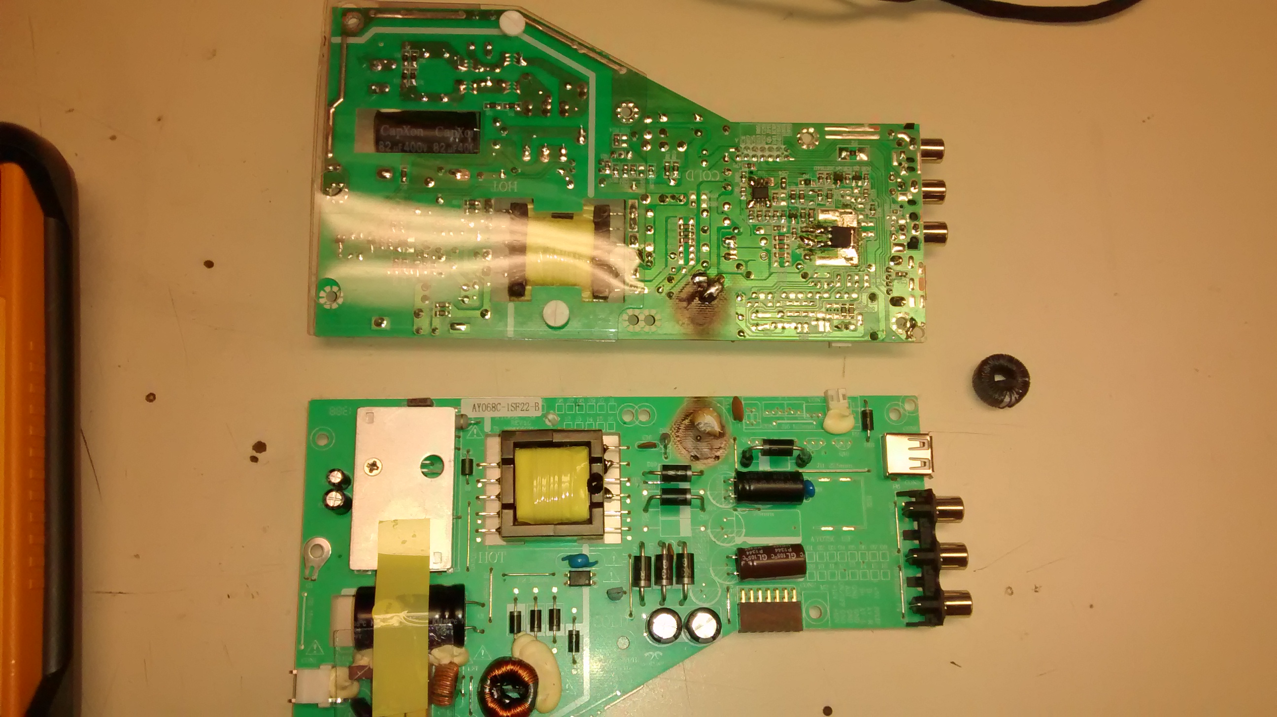

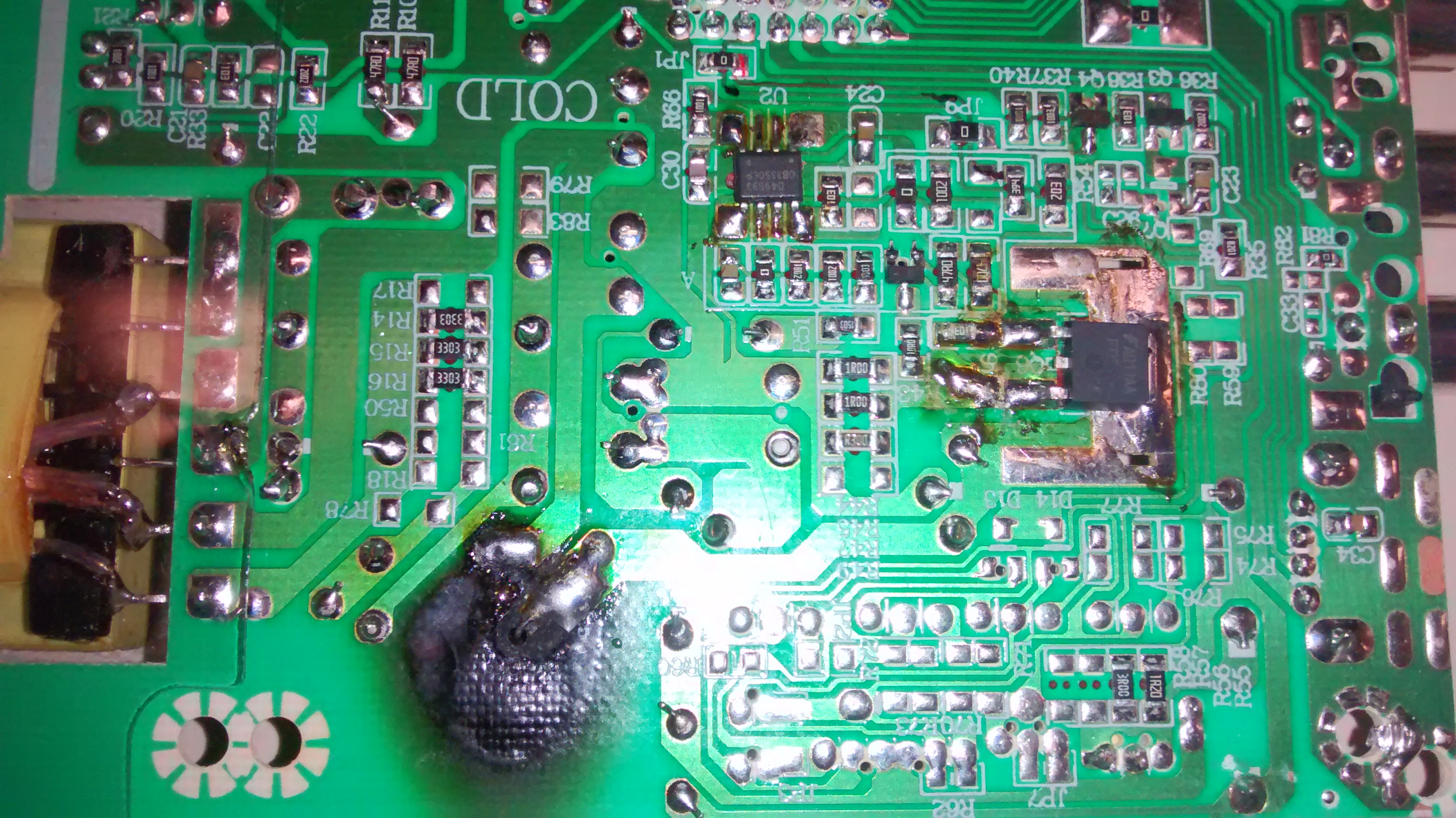

    RLDED3258A-F another crap TV from RCA
    Two TVs with exactly the same fault.
    The main inductor on the secondary gets extremely hot until it burns the solder pad and falls out of the PCB. It seems the OB3350CP LED controller doesn't work and the MOSFET stays on all the time.http://www.go-gddq.com/upload/2014-0...0611591515.pdf
    At least that's the only explanation I have, it's in a boost configuration.
    Recoiled the inductor and it worked for a minute then the inductor got to hot again. Mosfet burnt. Swapped the mosfet, nothing, swapped the OB3350, nothing.
    Blue light turns on but no Volts for the LEDs.
    The backlight LEDs are all good.

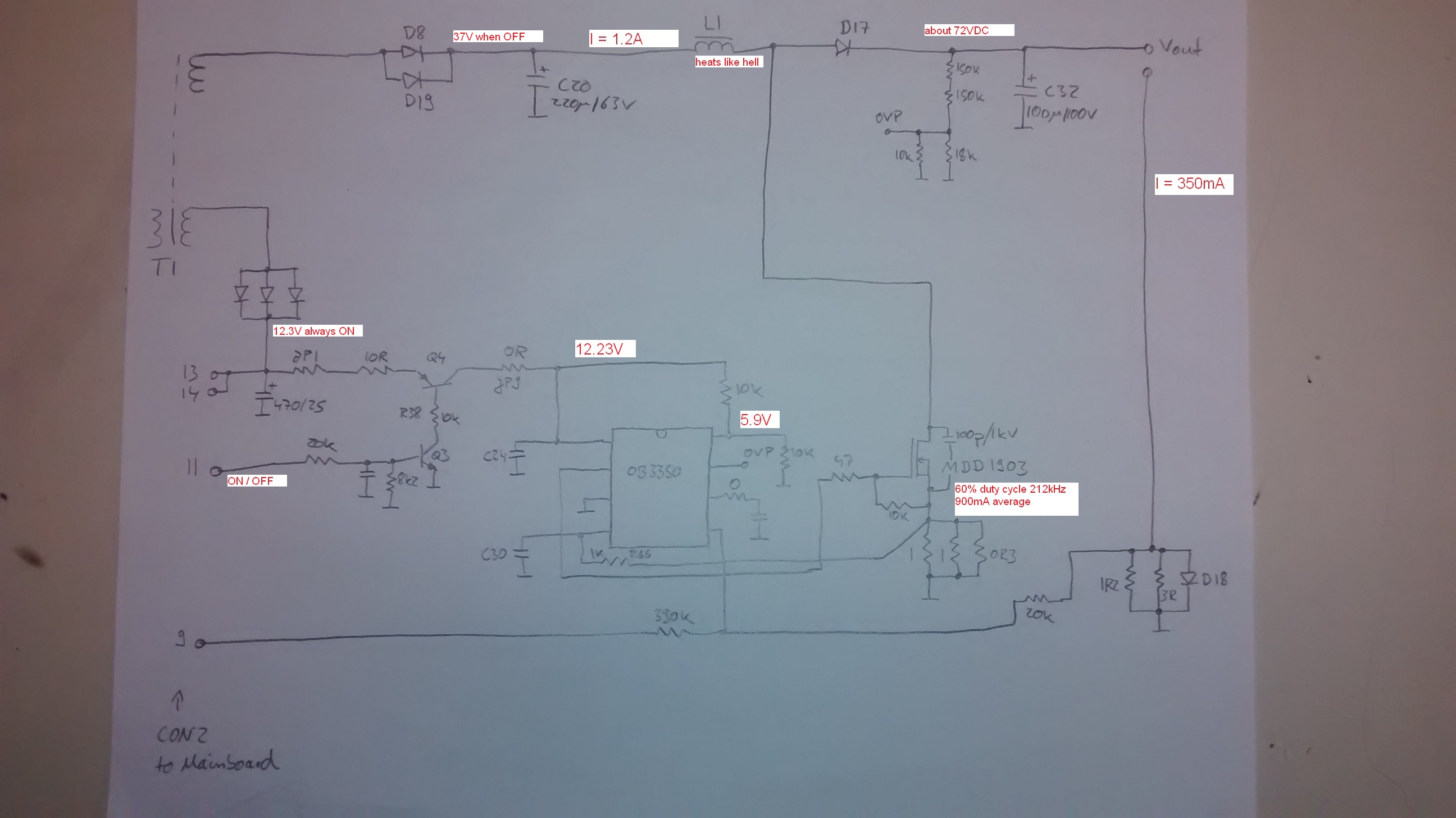

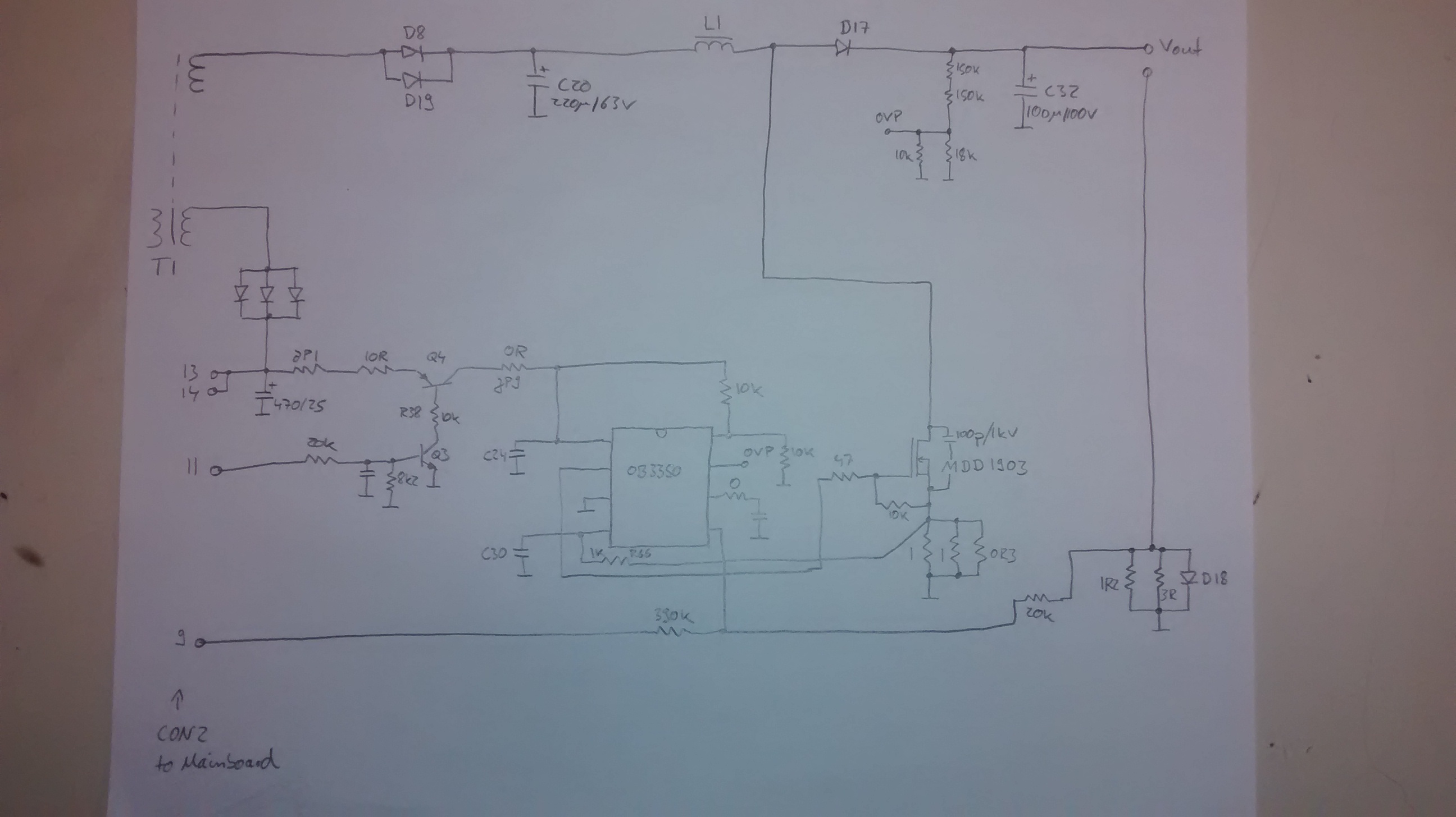

      Yes. The circuit is so small I will give it a try and draw it. Maybe it becomes clearer then.

          Yes, they are 3x 1206 packages in parallel. I guess they would support a couple of amps before burning.
          I attached a circuit diagram for others who have the same problem. From here I have to check a few things but have to stop for now. Maybe I continue on sunday.
          Not exactly sure why they would put in D18?. When the current rises above the diodes voltage drop it would limit the voltage on the FB input. Then the chip would "think" the current in the LEDs is lower than it actually is. Weird.

                  The mean voltage on the two parallel feedback resistors (1.2 and 3R) gives me a mean current of 128mA through the LEDs. Does this make sense?

                    I messed up:
                    On the resistors in series with the LEDs it's 150mV, therefore 175mA through all the LEDs.
                    The current sensing resistors on the source of the FET have a peak of 2.8V on them 500ns long at 212kHz. That would be 14Amps peak. Seems a lot to me. However it's a duty cycle of about 10%, so mean current is less than 1.4A... The inductor is 24 or 25 gauge.

                        Well in this set with the controller OB3350 the LEDs are directly connected to the booster output voltage.
                        It looks like the inductor I recoiled has a too low inductance. If I get 14A in 500ns that would mean it's 100nH? That's way lower than the 47uH in the datasheet.
                        Even though I recoiled it with the same gauge and length...

                            Yes, turn count is the same. However the first time I replaced the inductor it worked for some time until it overheated. I thought I had it repaired so I noticed too late that it was overheating.
                            I just replaced it again with the coil I had prepared for the second TV and yes it works. The first coil when overheated was shorted.
                            So now I'm at the same point as before, everything seems to work except the inductor heats up quite quickly to 80C.
                            The LED current would be about 350mA continuous...
                            Think I need to measure the real current through the inductor, there is no reason for it to heat.

                              I have about 1.2A through the inductor, 350mA through the LEDs, the rest through the MOSFET. Everything looks good, except for the heating.
                              I wonder if these inductors are just poorly designed and I should just use a heavier gauge. They don't saturate or anything it just seems that 1.2A for a AWG25 is too much.

                                  I applied 1.2A DC to the inductor, it doesn't heat AT ALL. An ESL meter shows 386uH.
                                  Therefore it must be the core that's heating not the wire, due to the switching (212kHz)
                                  350mA through the LEDs seems a lot but is consistent with the calculation for the resistors in series with the LEDs. The datasheet says 300mV. That's what I have at those resistors (3R || 1R2).
                                  However, 1.2A in the inductor vs 350mA in the LEDs looks like an awful bad efficiency to me. The 900mA difference can be measured at the FETs source resistors. Nothing strange there.
                                  In short, the inductor seems to be ok. There is too much AC current through it heating the core IMO.
