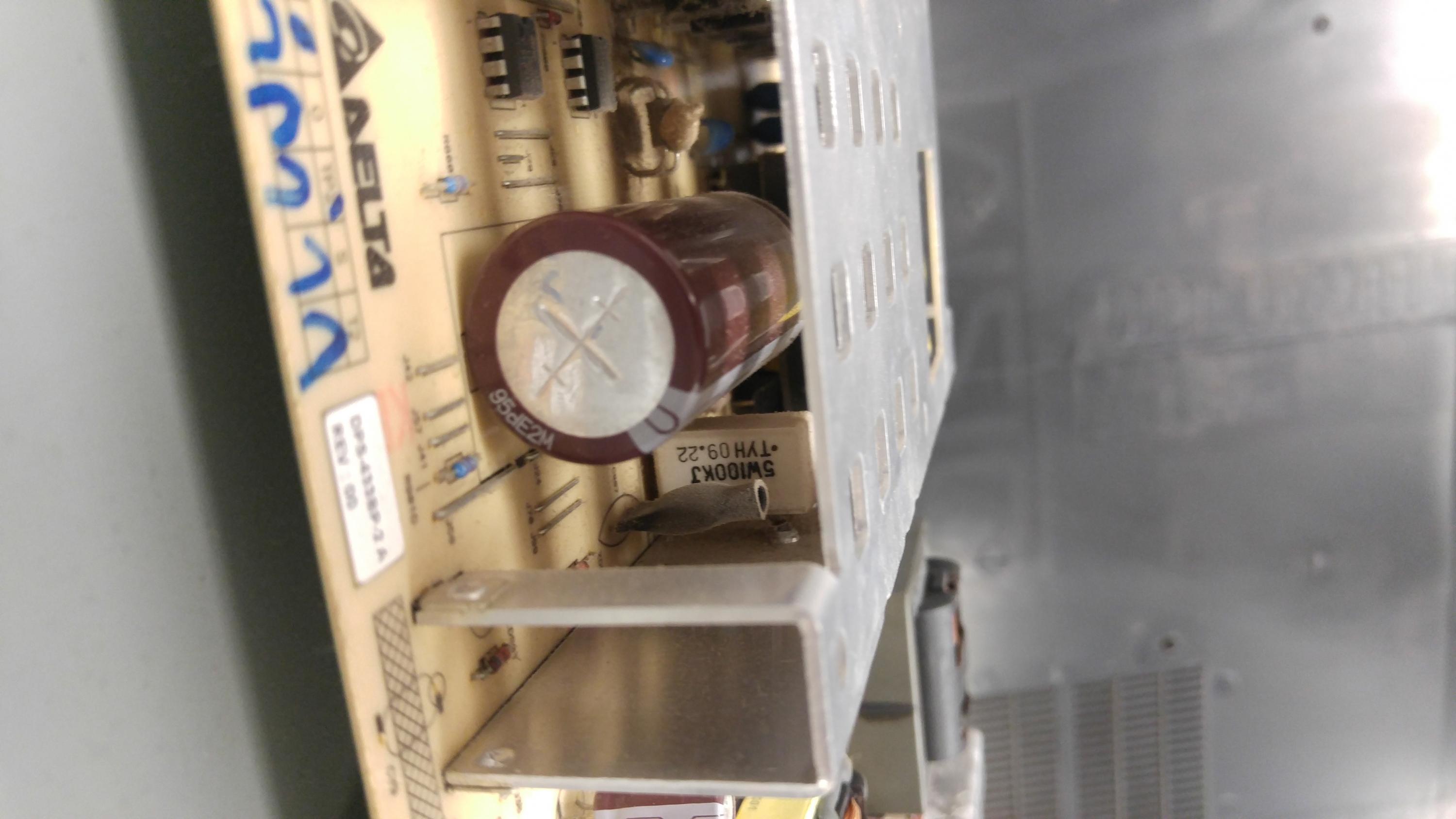

      One thing I am unsure of is the white ceramic thermal fuse R817 rated 5w 100KJ is not measuring like a fuse. I think it was about 6Mohm. Does this mean it is out or is it due to its extremely high KJ rating?
      Picture attached of the component I am talking about.

        Re: General ? concerning PS_On and other DC voltages from PS to MB
        For some reason the other computer I was using was not allowing the picture to load so here it is.

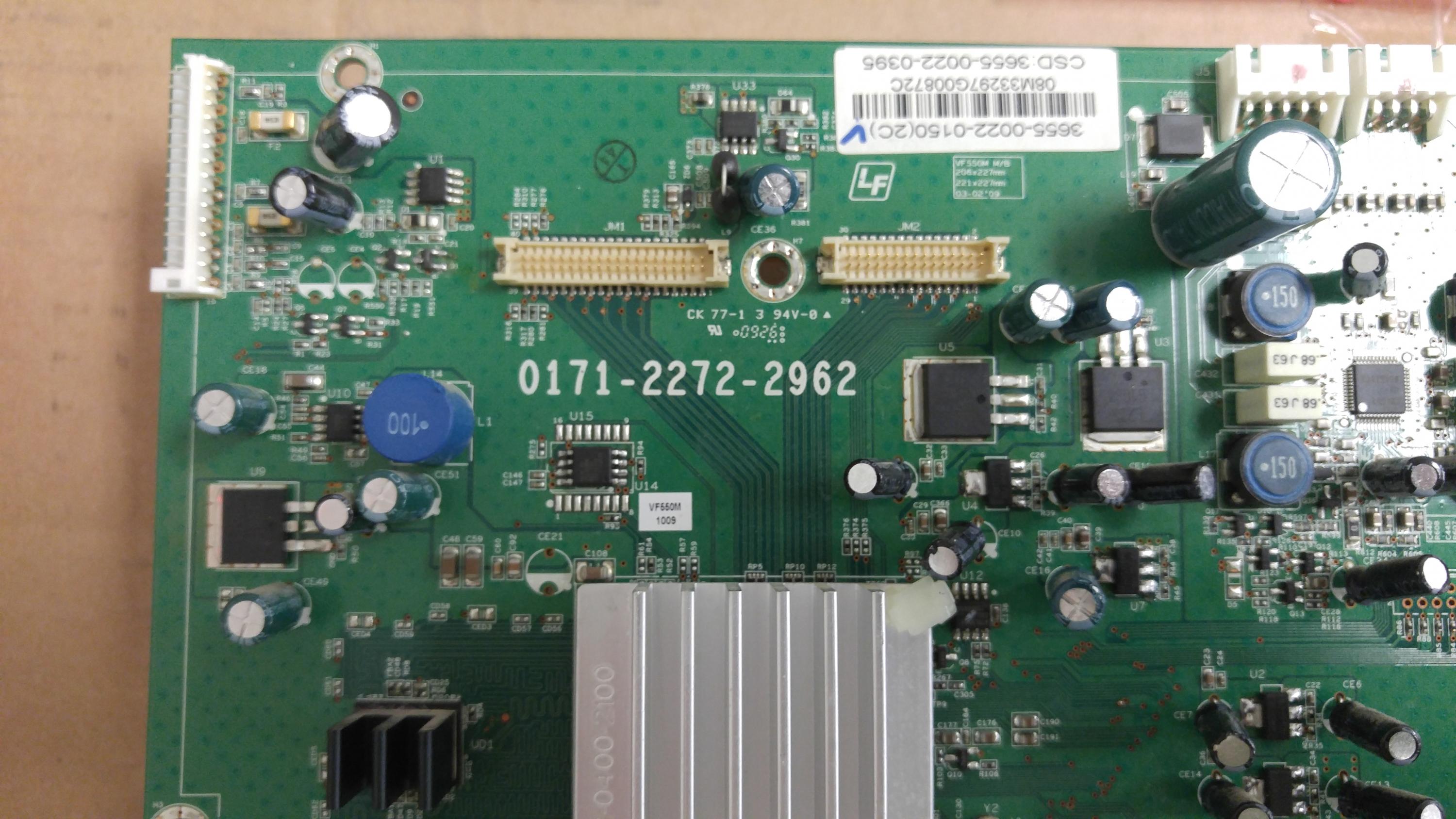

                        I am pretty good with component level trouble shooting on any board except mains, logics, and t-cons. I don't usually trouble shoot main boards very often so I will need some guidance on this one. I usually run to the repair kits and EEPROMS which I already have done.
                        Main board part# 3655-0022-0150
                        Link to picture:
                        http://assets.shopjimmy.com/media/ca...0150-TOP_2.jpg

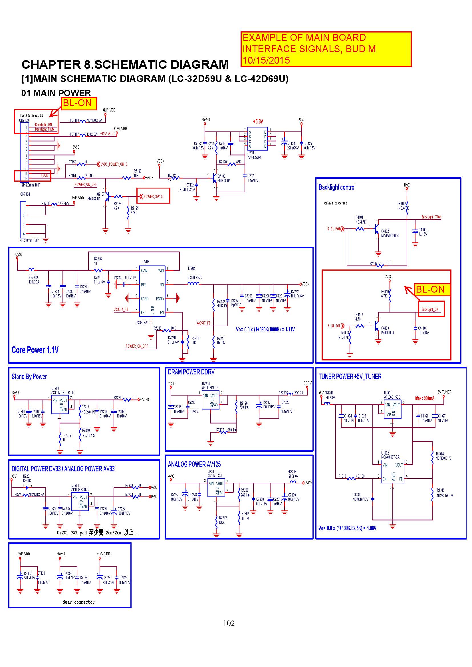

                                Next step will be tracing out the connection on the PS-ON pin on the main board side, there is switched Transistor on the main board that controls the PS-ON signal, it may be leaking and not allowing the PS-ON to go high enough.
                                See example circuit on how it is done.
                                  Ok I have tried to follow the path, but am clueless at this point.
                                  I checked some of the transistors and took one out of circuit to measure it, but I got nothing.
                                  Attached are a few pictures. if you could guide me just a little more here.
                                  Thank you
                                    I cannot trace the connection from the pictures but what you can do is to test the DCV between GND and the Collector (middle pin) pins of transistor Q1, Q2, Q5, Q7 when TV is off and when TV is on to see if you can see the DCV at the Collector change state and how much changes.
                                    https://www.badcaps.net/forum/attach...5&d=1455308553
                                        Take DCV reading on R11 (buffer resistor case pin 1 is accidentally got shorted to GND) right pin, it should be higher than 1.2V (on the left pin of the resistor which is connected to pin 1 connector).
                                        I also expect the right pin of the resistor to be connected to the Collector of one of those 4 transistors through another resistor, It looks to me Q1, Q2 are for the PS-ON circuit.
