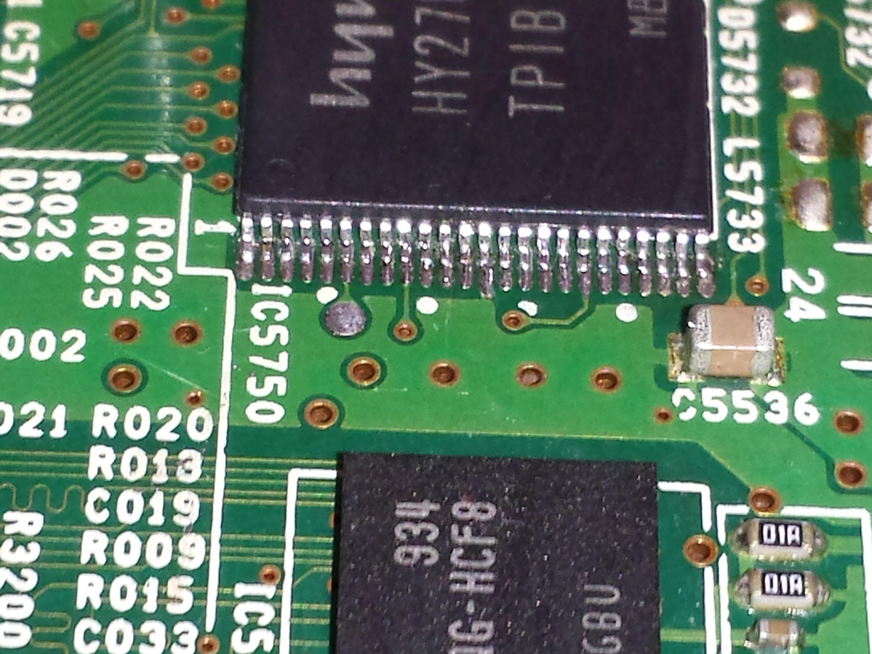

    My next step was going to be ordering the ICs on the sustains, definitely. I actually put in an order with Digikey for some other stuff and forgot to see if they had them. Glad I forgot now. Sleep would be nice, but I think it's not happening. If I sleep now my whole schedule will be out of whack.

                  Have you gotten the service manual yet? And I suppose I'll need that firmware too. Do you have a link for it?
                  ------------signature starts here------------
                  • lookimback
                    • Aug 2013
                    • 1489
                    #29
                    Re: Sanyo DP50749 (Samsung PDP version) No picture. Screen tries to light.
                    Service manual says you only have to if IC5700 is not manufacturedv by Samsung, or if the TV is a 52". I still didn't see how though. I know on some TVs, you put the new firmware on an empty USB thumb drive and, with the TV off, plug it into the TV. Then the TV will load it and update when it boots up. Not sure if Sanyo works that way. Tom66 would probably know.

                        • lookimback
                          • Aug 2013
                          • 1489
                          #32
                          I'm still waiting on the IC. If I'd known it would take over a week, I'd have just ordered it from China for a fraction of the cost.

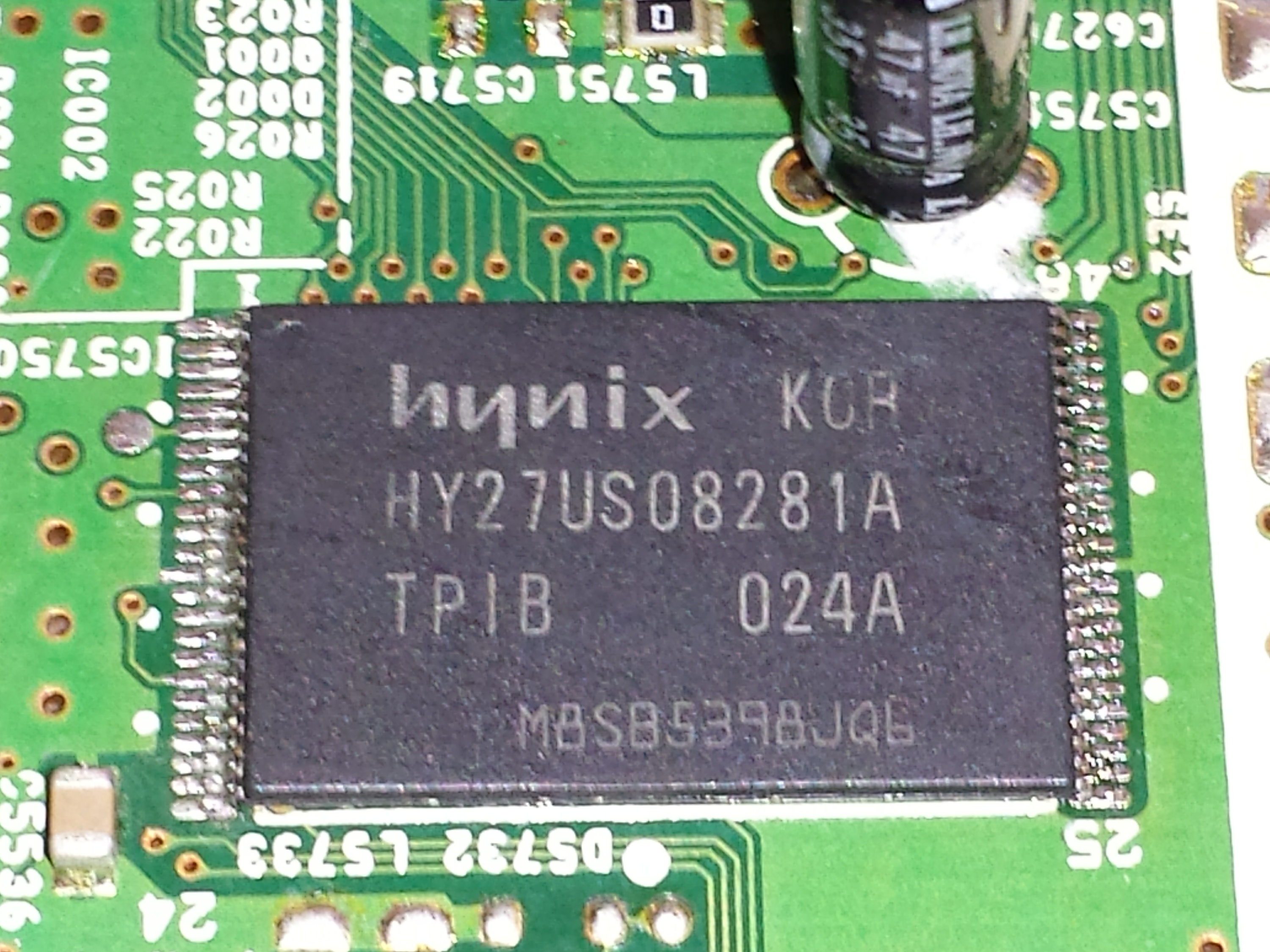

                            That'd be a blank chip though?
                            • lookimback
                              • Aug 2013
                              • 1489
                              #34
                              Yeah, I think so. So then I'd have also needed to program it. How is that done, jtag?

                                • lookimback
                                  • Aug 2013
                                  • 1489
                                  #36
                                  Fixed! Thanks again for the help tw2005!
                                    Beautiful, glad you worked it out to be eeprom. nice job

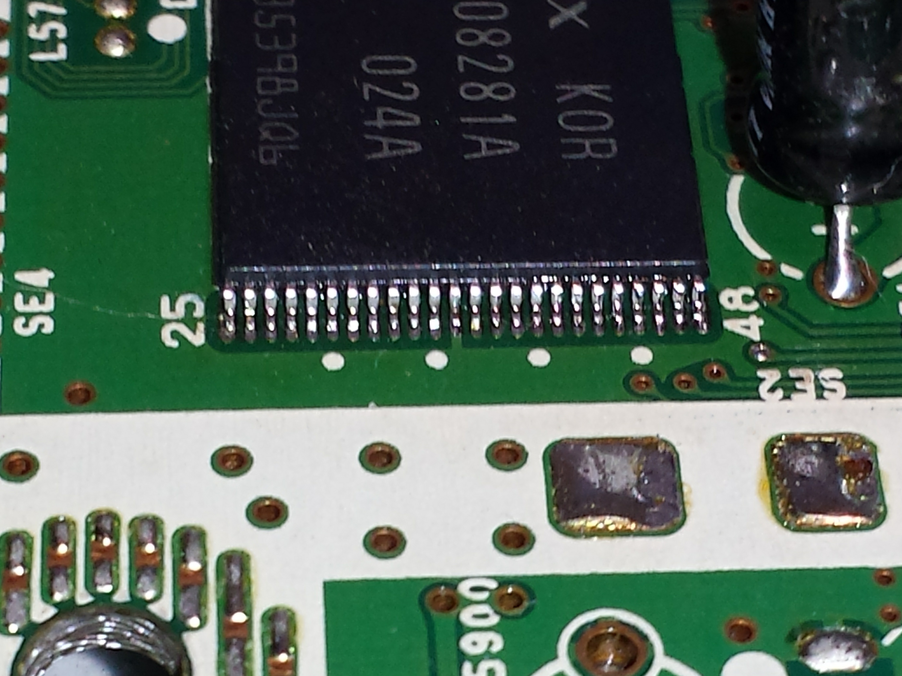

                                      • lookimback
                                        • Aug 2013
                                        • 1489
                                        #39
                                        I'm looking into a universal eeprom programmer now. Unfortunately, none of the cheap ones support this chip. Cheapest one which does is around $700. That sucks because there are some really good cheap ones for under $100. But now I'm thinking about JTAG. I see JTAG test points on the board, and eeproms can be programmed through them. I still think there must be a manual way of programming an eeprom though. If you have a datasheet, and know the pinout, it seems like it should be possible without the need for a $700 programmer. As for software, you read that from a good IC first.
