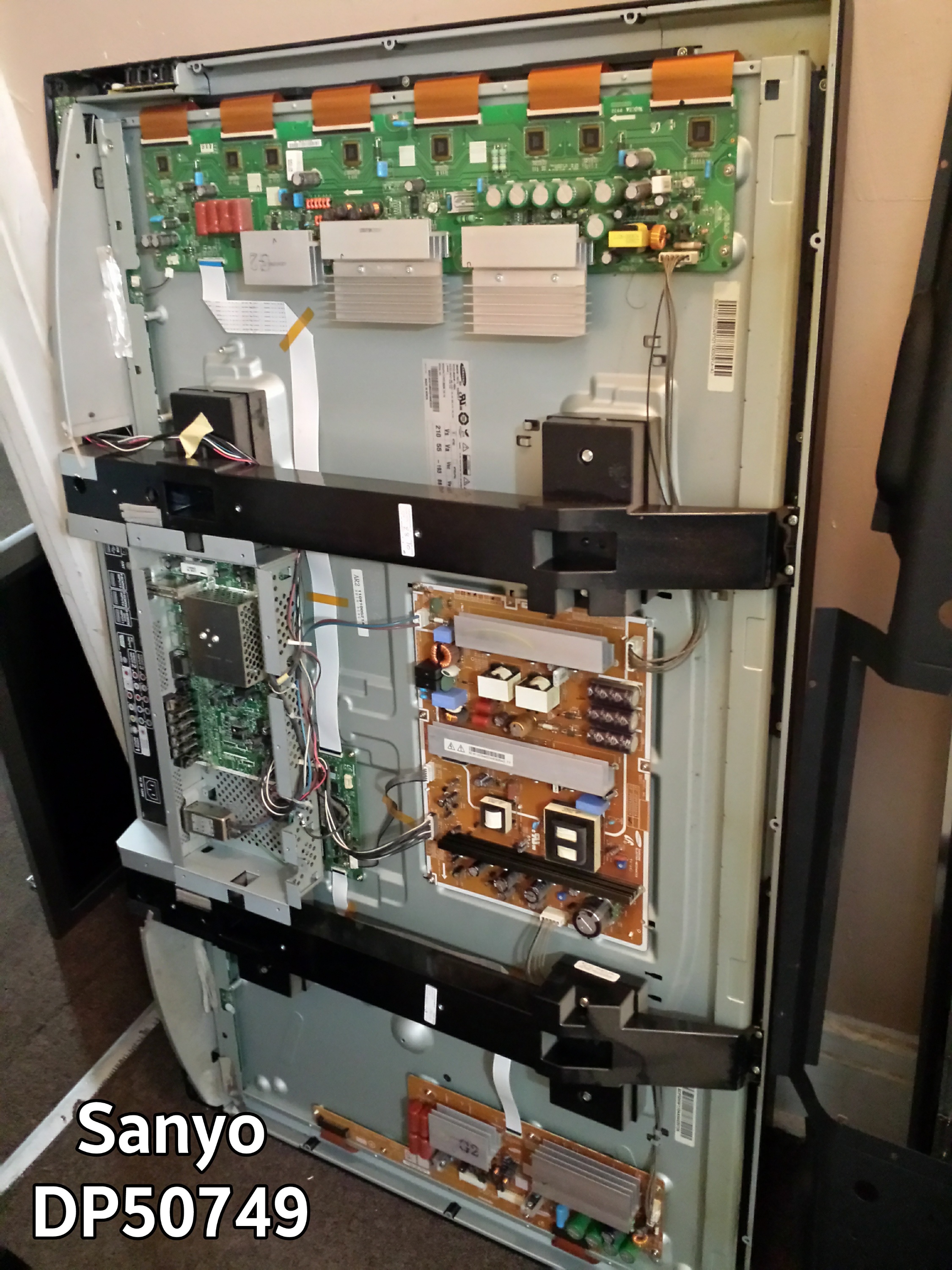

Sanyo DP50749 (Samsung PDP version) No picture. Screen tries to light.
  • lookimback
    • Aug 2013
    • 1489
    I VA and VS in specs with the panel sticker. I have no way to know if there's sound or not. My only AV source is HDMI from my laptop. The back story I got from the previous owner is that his kid kept clicking the power strip on and off for about a half hour and finally, the TV wouldn't turn back on (I'm shocked that someone would let their kid play with a power strip, as if it were a toy). It clicks on, I get a momentary flash on the screen, and then about a minute later it cycles off and back on. It will do that repeatedly. My guess is that it's a sustain problem. I checked all the MOSFETs and IGBTs on both the X and Y sustain boards, albeit without removing them, and find none to be shorted. Disconnecting either sus board makes no difference. Both sustain boards are expensive, so I'm looking to do component level repairs. I'm guessing it must be one of the ICs on one on the sustain boards. Any ideas? I can upload any pics necessary later. For now, I have the one of the TV with the back off so you can at least see which version it is.

    Re: Sanyo DP50749 (Samsung PDP version) No picture. Screen tries to light.
    May be worth trying isolating the main board, jumper the logic ctrl board for the test patterns and force the PSU on.
        Bugger, I was hoping you knew. What's the part number of the ymain? I'll have a look and cross it to a samsung although I think th eprocedure is fairly generic. better look at the logic board number too as I think some have 4 or 6 jumper pins.
        I've never done it but it does get mentioned here a bit.
          Samsung BN96-09736A (LJ92-01600A) X-Main Board
          Samsung BN96-09738A (LJ92-01601A) Y-Main Board
          Samsung LJ92-01617B Main Logic CTRL Board
          Sanyo J4FE (1AA4B10N22900) Main Board
          Samsung BN44-00274A Power Supply Unit
          Panel Sticker Number S50HW-YB04
            looking like,
            PN50B430P2DXZA, PN50B450B1DXZA
            Also read clicking on/off could be protection cct.
            I was thinking along the lines of corrupted eeprom if the kid was repeatedly plugging it in and out?
            pg25 for forced operation
              I'll try that in the morning. If it's the eeprom, that would be on the main right? Can it be fixed(reprogrammed), or would it have to be replaced? (the eeprom not the entire board)
                              Ok, I couldn't sleep. I got up and tried it. I used a jumper from an old doorbell button. It works. So it's definitely the main. Thanks.
                              Edit: its a little sparkly on certain test patterns, but I'll address that after I fix the main if they persist.
                                      I wish I really did have a never ending supply. Lol. This is my third fix today though(diagnosis anyway), credit to you on this one though. First 2 were inverter transformers, and replacements available for both. They come in waves. Couple weeks I'll only find a couple, then bam, 7 or 8 in one day. December, I think I only found 2. I post ISO ads in FB groups, most people have them and don't even know they have value. I get more with broken screens than anything, but parting them out allows me to have money to fix others. I really enjoy this work. I'm planning on going to college for EE in a couple years.
                                      I pulled the IC. There was a small cap real close to it so I pulled it to avoid damaging it. That took longer the the IC. No adhesive. Hot air made it lift right off.
