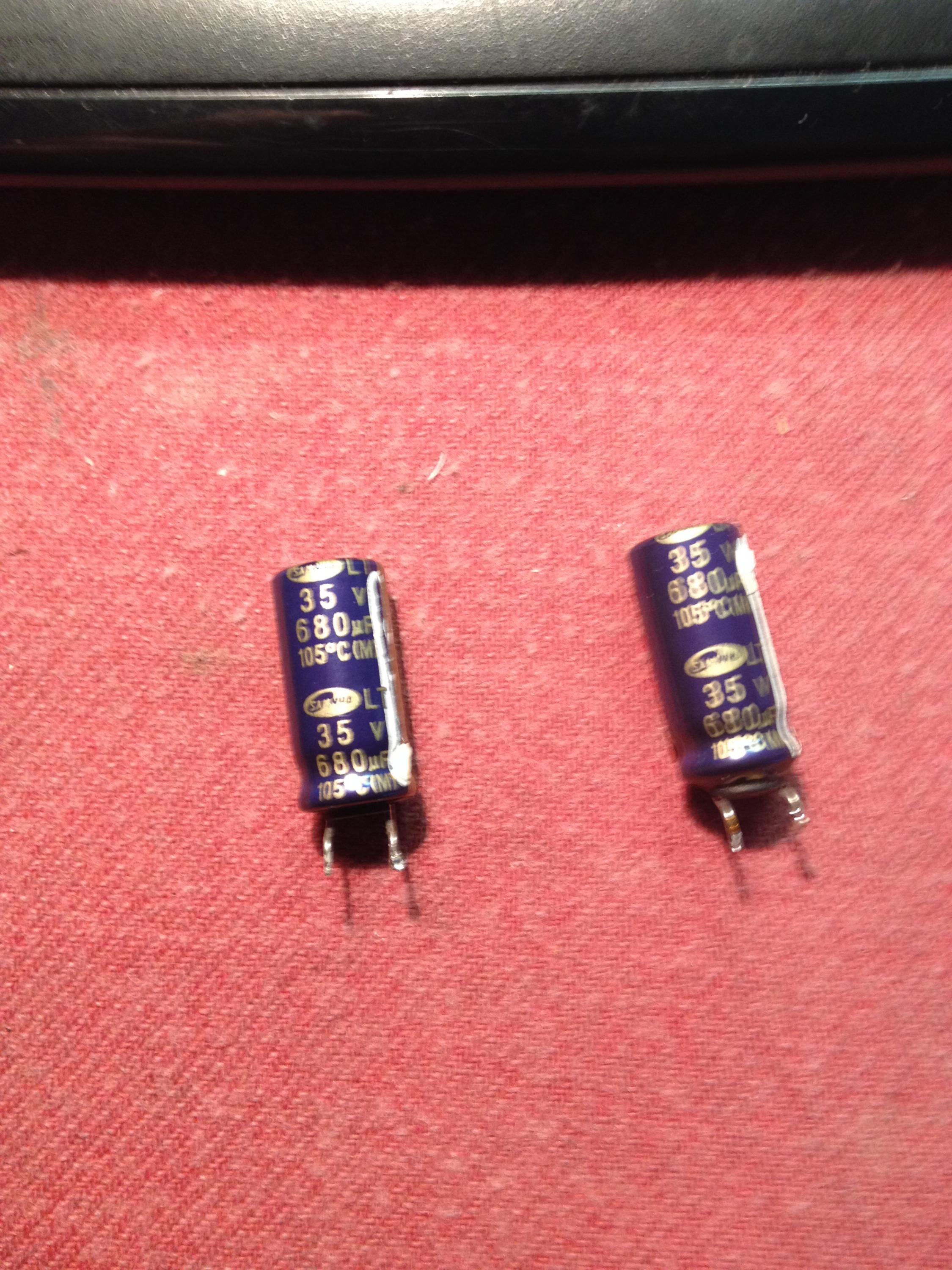

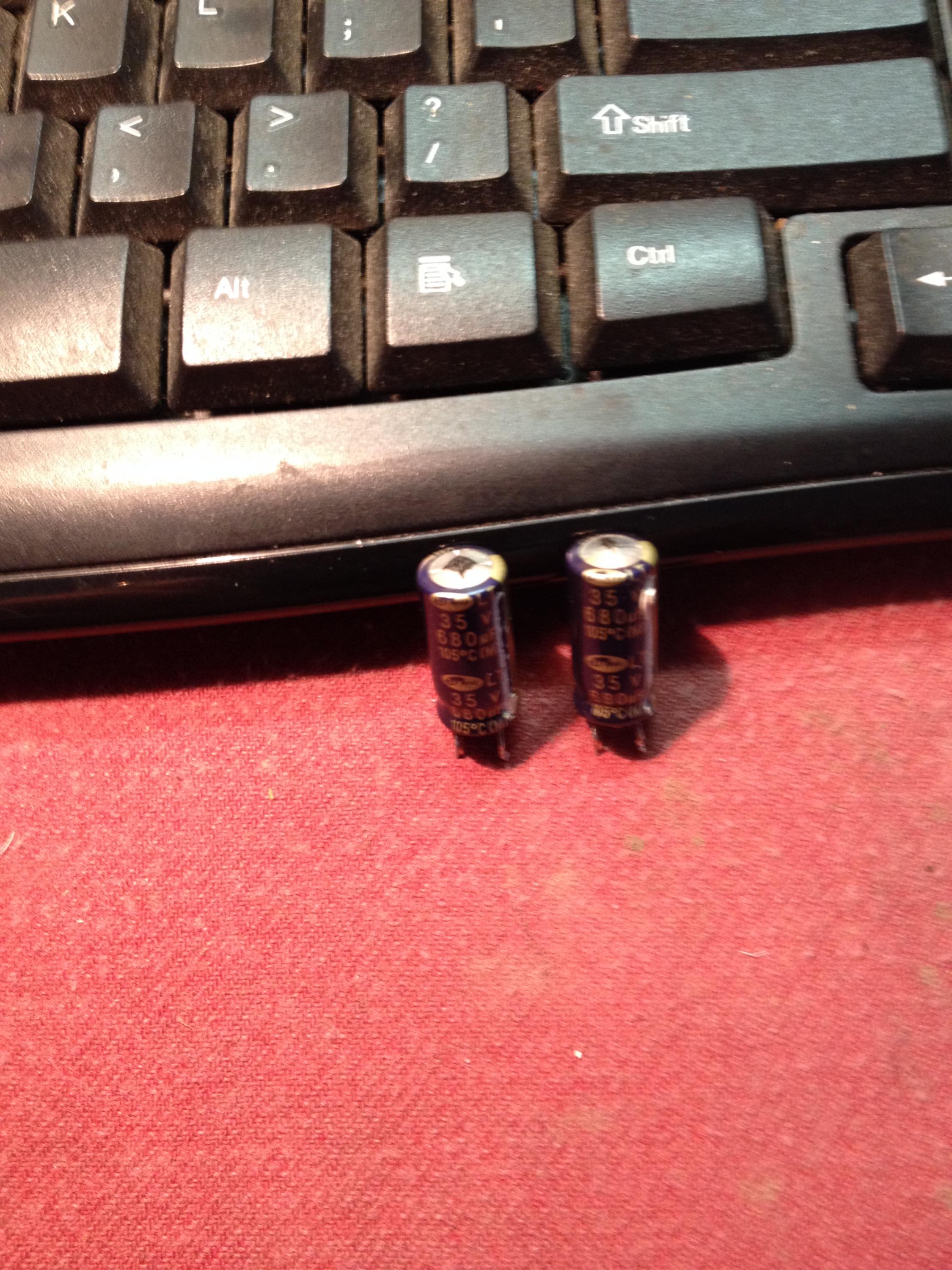

Just thought I would post this on what I found. Two caps on inverter board slightly bulged and leaking. They were 680uf 35v. They read only 118uf after removal. All I could find today was 680uf 50v in town. Slightly bigger diameter but still had plenty of room with shield installed.
Vizio 47pfl7432d/37 screen flickering
Re: Vizio 47pfl7432d/37 screen flickering
Low ESR/impedance type?Never stop learning
http://www.badcaps.net/forum/showthread.php?t=24809 -
Think budm means what did you put in not take out.Please upload pictures using attachment function when ask for help on the repair
http://www.badcaps.net/forum/showthread.php?t=39740Comment
Another bad SAMWA cap, and yes I mean the new caps, the general purpose cap will not have high ripple current rating either to be used in this inverter circuit.Never stop learning
http://www.badcaps.net/forum/showthread.php?t=24809Comment
No brand name or symbol on the cap body or package they come in?Never stop learning
