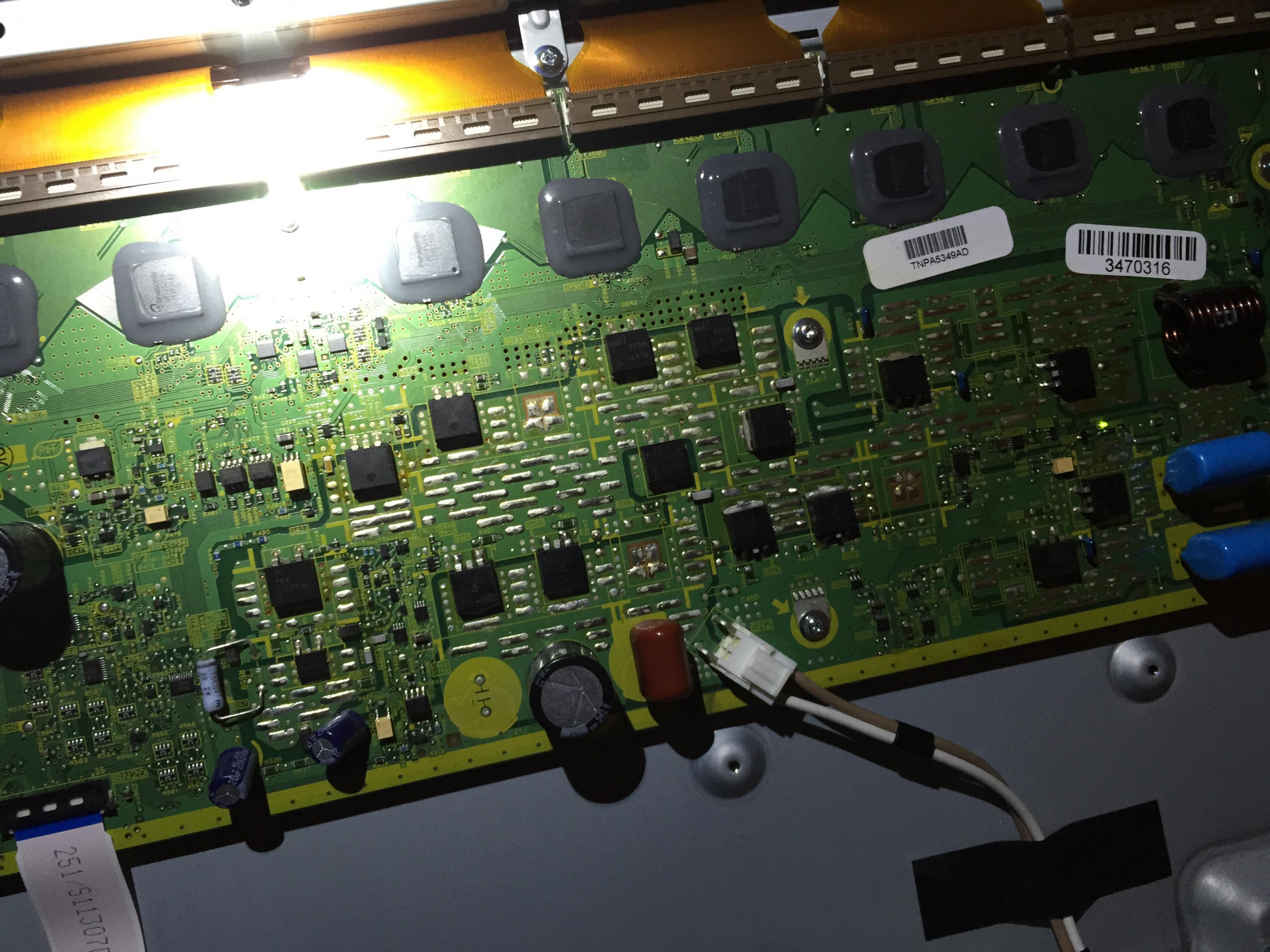

    I have a tc-p42st30 the tv makes a buzzing noise on the sc board i checked the screws and they are tight.Also the brighter the screen the louder the noise.Could it be something is getting to much voltage.i am gettin 220.05v on connector of sc.

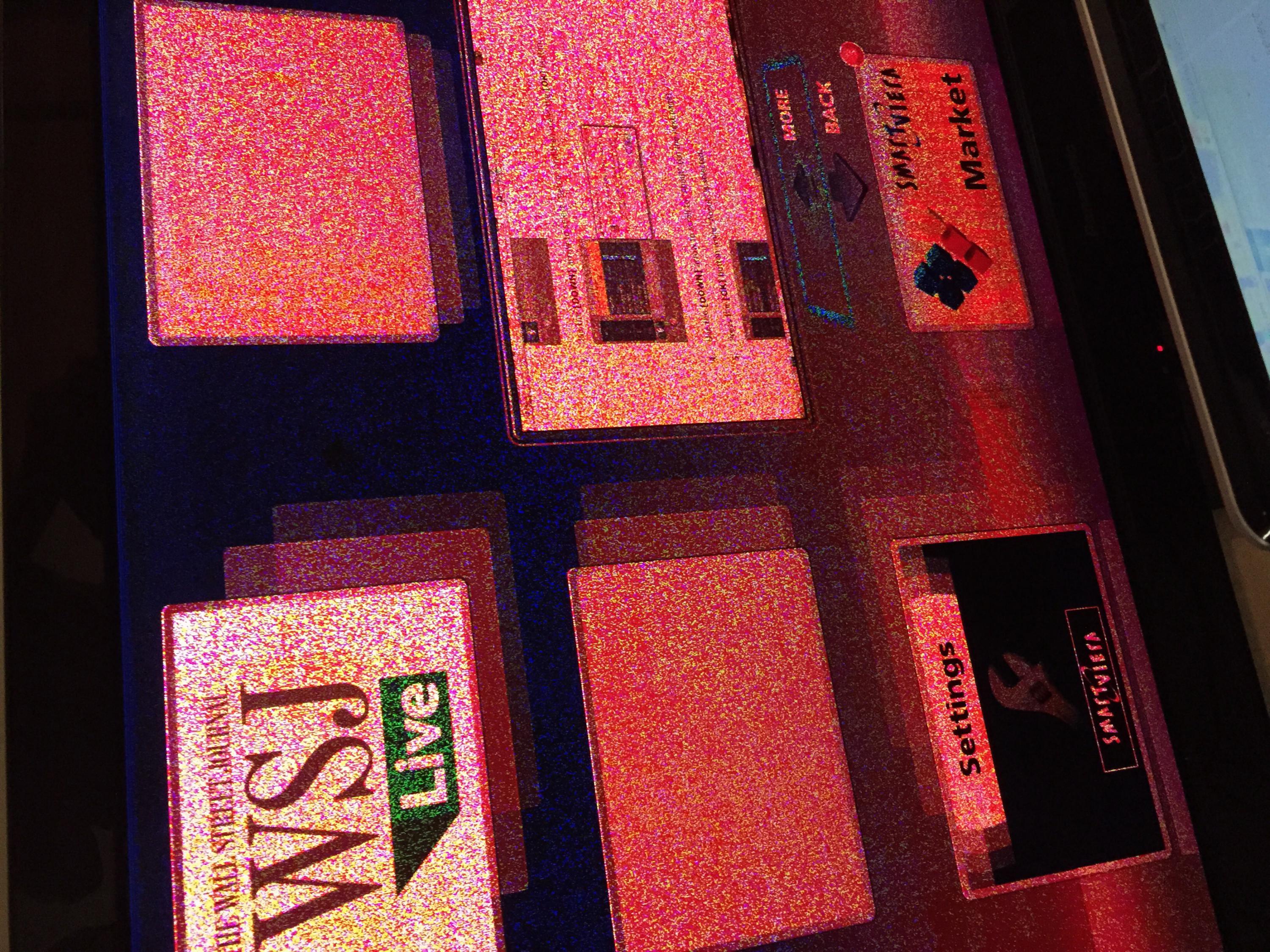

    Here is a pic
      Re: Tc-p42st30 making wierd buzzing noise the brighter set it the louder

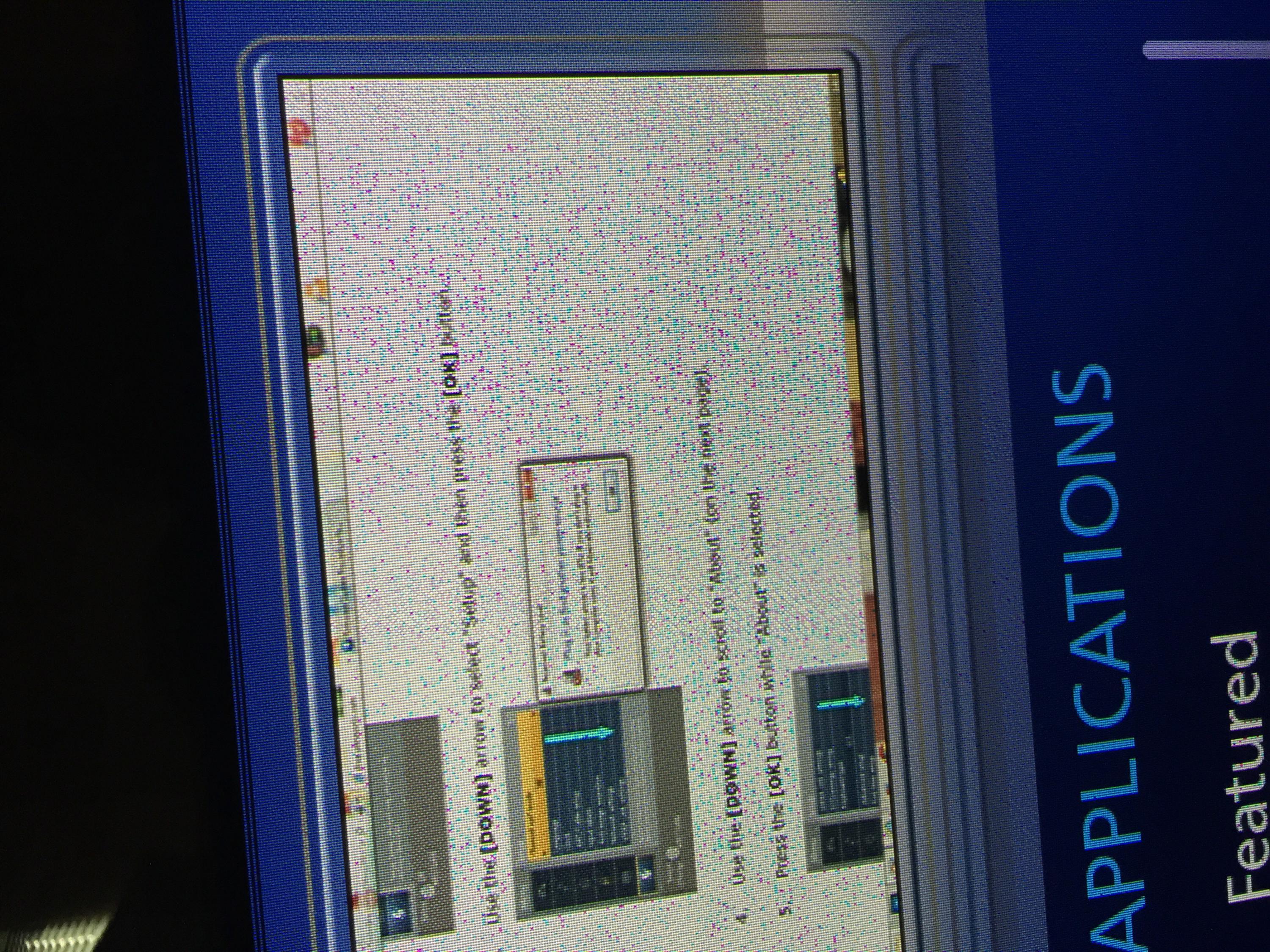

      it is like something is causing interfernce look at red dots
        On this one you can really see it

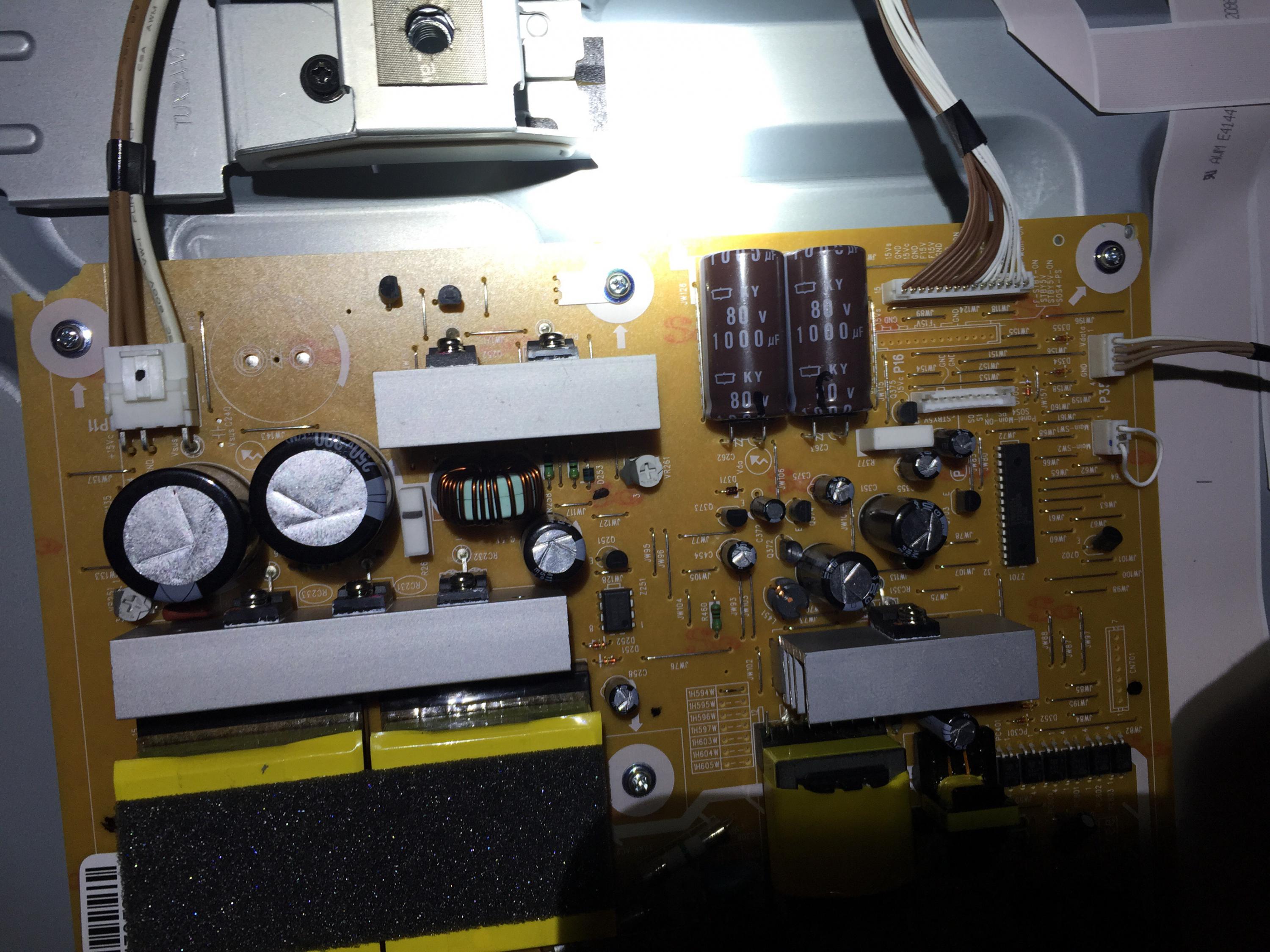

          So is this a previously repaired SN board by the looks of the photos? 220V seems very high, how accurate is the meter? You could mark the trimpot on the PSU and note the current level, then try lowering the voltage.

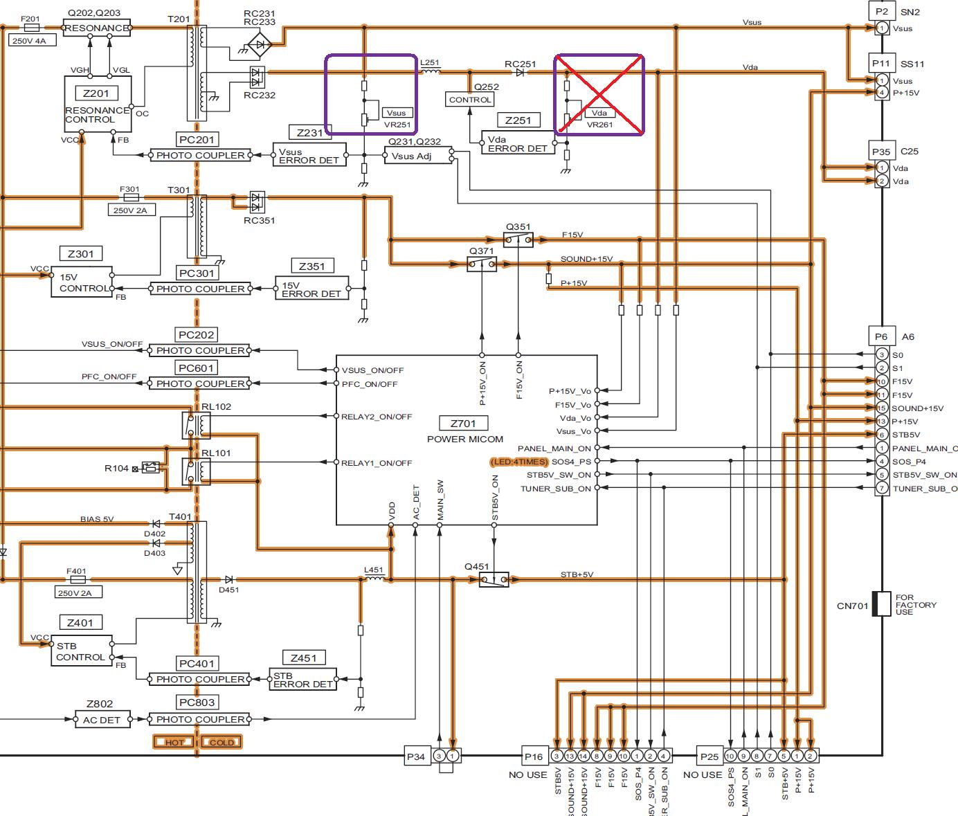

              There are two pots one is vr251 on top and vr 261 .which should i adjust.in post says he thinks it is vr251 on top but he does not say which one he adjusts

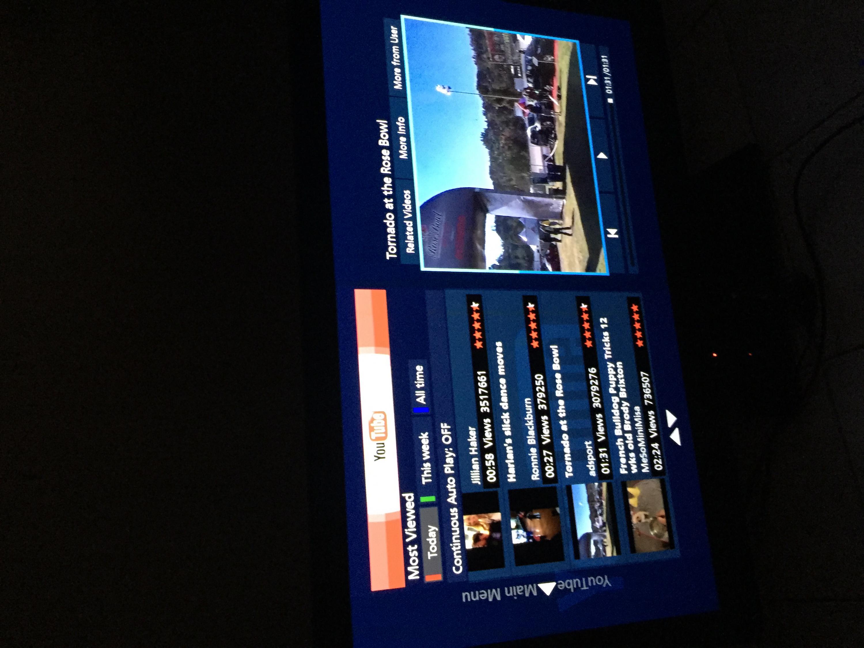

                I adjusted it to 212 v looks lot better
                  He is picture after adjustment still here a little buzzing noise i guess it is normal panasonic to make it

                      Hope you left VR261 alone.

                          I did not touch vr261 just vr251 lowered to 212v there is where i could get the best picture.
