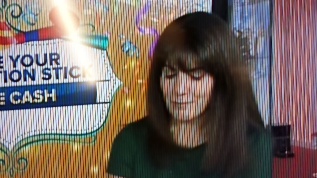

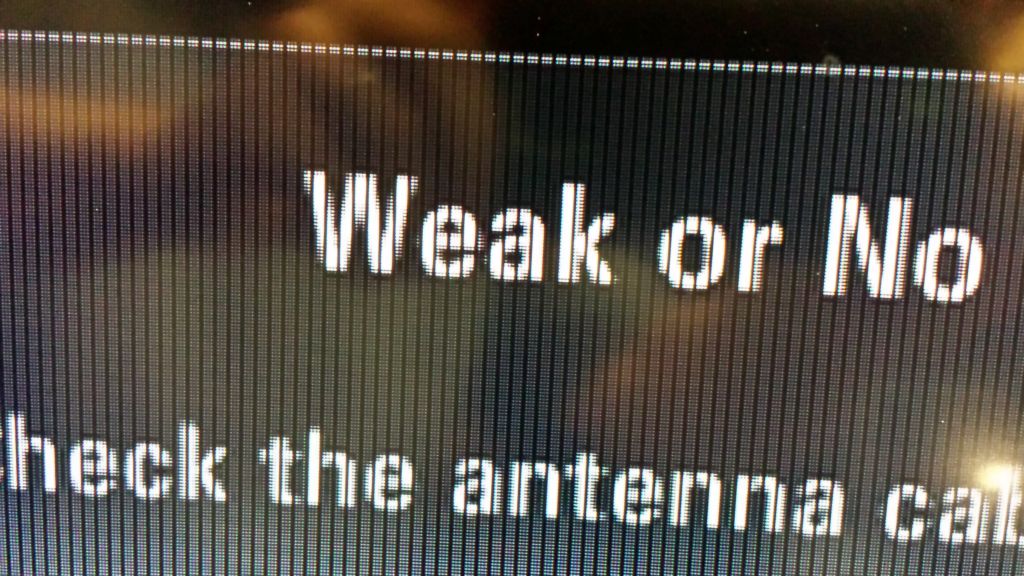

    Samsung LN46C630 has Thin Vertical Lines on entire screen.
    Checked connections looked ok
    anyone seen this before?
    Attached photos of problem
    Thank You for your Time

    Re: Samsung LN46C630 Thin Vertical Lines on entire screen
    Looks like a bad main board to me. Try to heat up the main processor on it with a hair dryer to see if it improves.

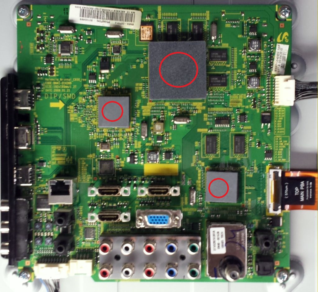

        Pictures of the boards ? Have u tried gently pressing on the processor with the end of a insulated screwdriver could be a bad panel though ?
        • twilliard
          • Aug 2014
          • 29
          • US
          Attached Board Photos
          • twilliard
            • Aug 2014
            • 29
            • US
            Pressing and tapping on main board did make a change Lines, some times they disappeared and came back, they are not there now, but if I tap again its back
                          After reading about REFLOW I decided to give it a try
                          Placed spacers under board to keep it off the pan
                          Placed pan and board into oven
                          Checked to make sure the board was level
                          Turned the oven and heated it up to 300°F, once at 300°F stay at that Temp for 1 minute
                          Then up to 350°F, once at 350°F stay at that Temp for 1 minute
                          Then up to 390°F, once at 390°F stay at that Temp for 1 minute
                          Then up to 450°F, Once at 450°F, stay at that Temp for 5 minute
                          Then Turned off Oven,
                          I Did NOT MOVE UNTIL IT COOLED DOWN
                          Put back into TV now it's working Fine now( For how long , who knows)
                            It did not deform the plastic parts on the board at 450?
                            Please let us know too how this TV works out for how long.
                                No deformity of the plastic parts
                                Note: I Covered all plastic components with aluminum foil.
                                The board did change in color slightly from the heat.

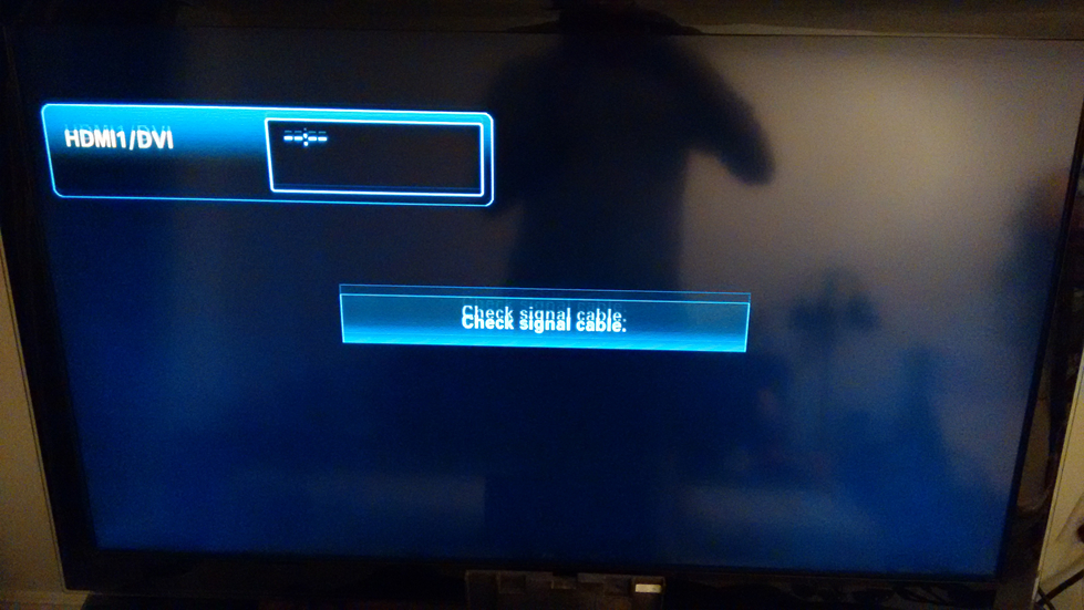

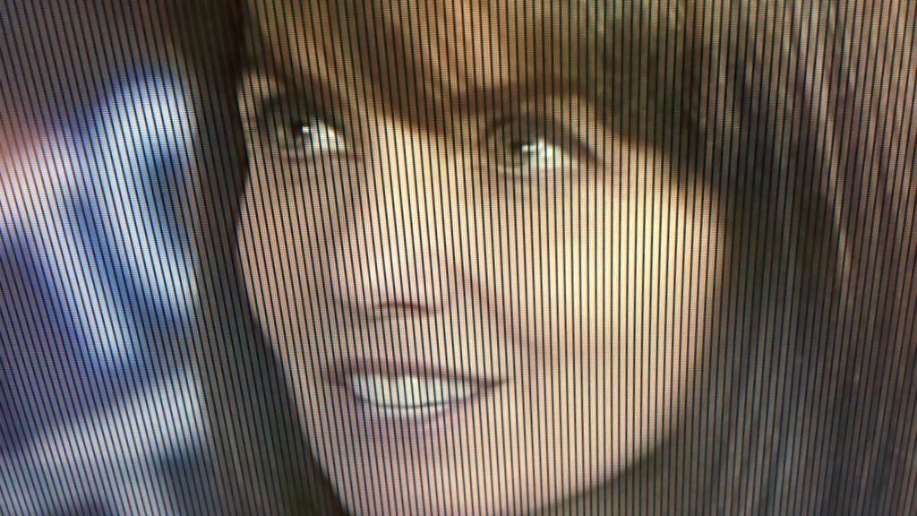

                                      Here are some pics showing the the problem with my LN46C630.
                                      When I turn on TV everything is OK for a several minutes. Then after it warms up first I see some flickering then I see vertical lines.
                                      Also when a test picture turns off you can see that "no signal" message doesn't properly moves on the screen. There is a lag.
                                      2 pics show how everything looks like BEFORE my TV warms up and another 2 pics show the problem AFTER it warms up.
                                      I also made a small video and will start uploading it to YouTube right away.
                                        That looks like tab bonding issue.
                                        What happen if you try flexing the panel?
