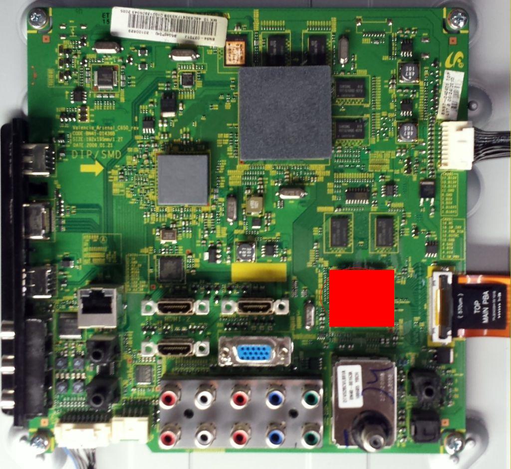

                            I have a Samsung LN46C630 with the same exact symptom of thin vertical lines (about 4 mm spacing) across the entire screen.
                            I have played around with it and found that if I flexed the LVDS cable at the connector on the main board, I could get the lines to disappear. The flexing exercise involves pulling the cable near the connector away from the main board.
                            I took a wooden stick about 1/8" in diameter and 2 inches long (about as wide as the cable) and wedged it between the cable and the main board. This provides upward pressure on the cable,
                            This has solved the problem temporarily.
                            I've order a new cable (BN96-12723D) and will report back when I've installed it
                            • n1iwv
                              • Jun 2013
                              • 20
                              #34
                              Re: Samsung LN46C630 Thin Vertical Lines on entire screen
                              Well I tried replacing the LVDS cable and that did not solve the problem.
                              I found that pressing on the IC chip (see RED IC on the Main board photo), I could get the vertical lines to disappear.
                              It would appear that the BGA is in need of a rework. Maybe re balling.
                              I am not set up to do this type of work.
                              Anyone out there know a good reputable service and an approximate cost to re-ball the red IC in the photo?
