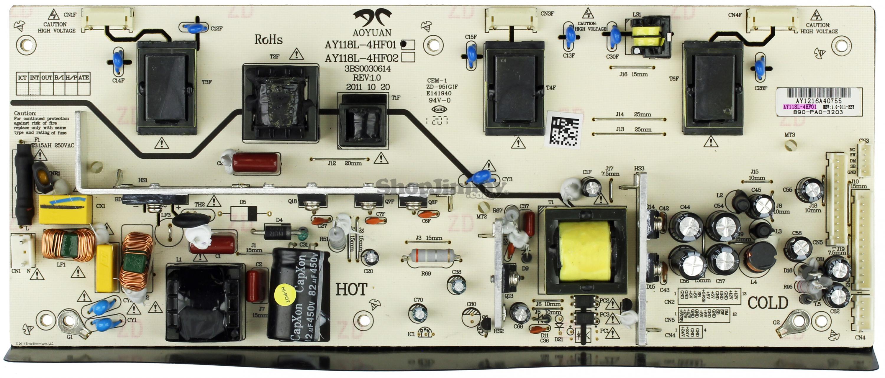

            This is the power supply/inverter board.

                  Re: Element elcfw328 broken CCFL and 2 seconds to black?
                  Just how smashed it the panel?? You say it flashes bright then goes out?
                  That suggests that at least one bulb is working.
                  You also say there are 2 sockets/lamps but there look to be 3? is one just not used - really need a picture of YOUR power supply. (Front and Back)
                  First try this - note - the lamps will not stay on during this test.
                  Switch off unplug all but one lamp connector switch on does it flash?
                  Switch off unplug that lamp and plug in another one (If it will reach preferably in the same socket as the first) Switch on - does it flash?
                  Switch off if there are three unplug the second then plug in the third.
                  This will tell you which/how many bulbs are totally dead.
                  Next when you have a known bulb that flashes test that one in each socket.
                  (Switch off between plugging/unplugging) This might indicate if there are major problems with the inverter transformers.
                  If you have a spare panel with similar size bulbs you can also try those in the sockets - if lucky you may get 3 that stay on.
                  Alternative is to mak up one or two budm test bulbs from a cfl

                    selldoor: thanks for the reply! I did a test like that with the backlight late last night, but I think I'm going to try it again. Will post a picture of my PSU. It seems the power led could turn "on" blue , but the set may still not operate properly due to a problem with the inverter psu board. I think I'm going to check the voltage at all the psu output pins, and if there is a problem maybe try to troubleshoot.
                      O.k. on this being a learning curve set. So fire it up and check the voltages on the ribbon from the power supply to the main board. On the pic bottom right. There is the pin out printed on the board too. All voltages there, then it should be good. Power supply done. You can try if there is a difference while the lights flash on, or disconnect them all together, but I doubt that.
                      For the next step (checking the main board) I use an oscilloscope, not sure what others use, when the screen is damaged like that, but that's what I do.
                      Remember that only the 5v vsb is there all the time, all other voltage rails are only there when all of the power supply is turned on.
