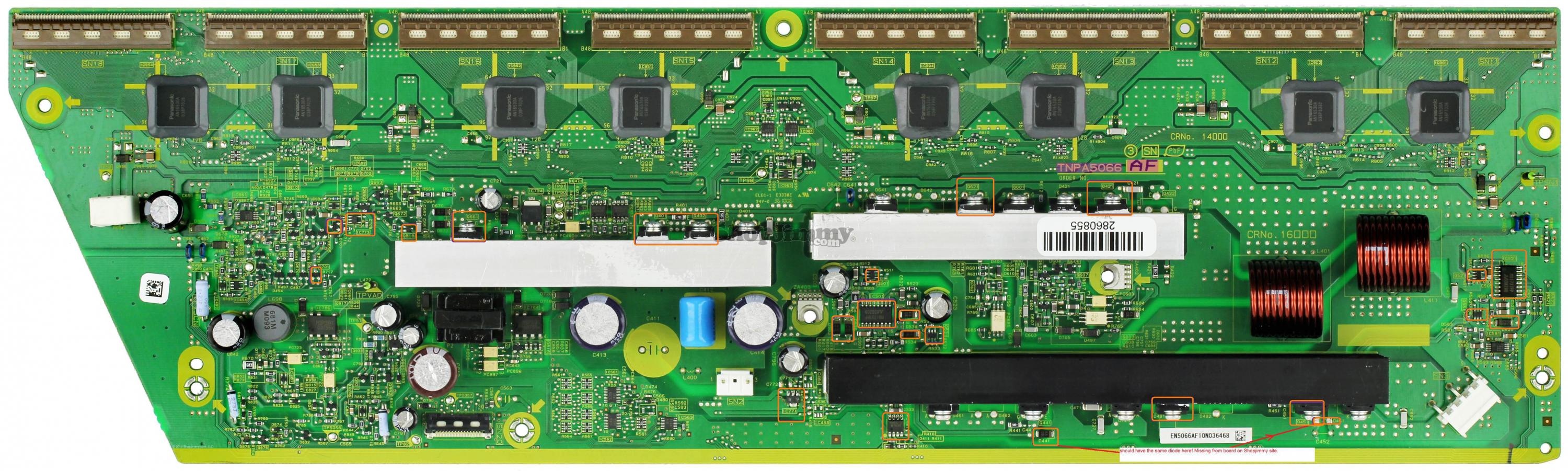

Panasonic LSEP1287 4 blinks
  • tw2005
    • Oct 2011
    • 6458
    Re: Panasonic LSEP1287 4 blinks
    parts of interest although I've highlighted parts also that may fail as well
    • Russ300
      • Dec 2014
      • 20
      Ahh right, thanks tw2005, I just set email notifications of when someone replies to a thread i have started.
      Anyway, two panasonics have come up on ebay from the same seller with broken screens
      TX-P50X20B and TX-P42G15B, would these have the same or compatible boards in i require ?
      • tw2005
        • Oct 2011
        • 6458
        no, the x20 may have components the same but uses sc/sd/su boards. yours is all in one SN. Just because the screen is cracked, does not mean those SC boards are good and I find often the buffer boards (SD) are blown from TVs with cracked screens that have been powered on.
        Done any deeper fault finding on the board?
        • Russ300
          • Dec 2014
          • 20
          quick testing with components still soldered to board:-
          D451 - shorted both directions - diode test function on multimeter
          D441 - OK
          IC771 - appears ok
          D503 - shorted
          D536 - OK
          D522 ok
          D534 ok
          Q701 ok
          D701 shorted
          Plus the three pther FETS shorted.
          I think this is uneconomical to repair
          • tw2005
            • Oct 2011
            • 6458
            D441 - OK
            IC771 - appears ok
            D503 - shorted
            D536 - OK
            D522 ok
            D534 ok
            Q701 ok
            D701 shorted
            well the parts are cheap to get but it could be a mine field. D701 shorted most likely will be Q702 shorted and that puts ic773 most likely short between vcc-gnd and if you look at the cct these drive q661.
            • flocko
              • Nov 2012
              • 1121
              • uk
              Hi been were you are with one of these. the parts are not expensive less than £15.00 most you can get over here in uk (eBay all SMD parts on here ) the bigger parts if you can wait I buy from China (www.utsource.net) if you order on line they will be with you in about 10-12 days. I buy in bulk just had some parts today ordered on the 8/1/15. There are some posts that are tagged to a TW thread that will be of help to you, showing the parts that I replaced to fix my TNPA 5066 board, It was not all plain sailing as you will read but could be of help. Flocko
