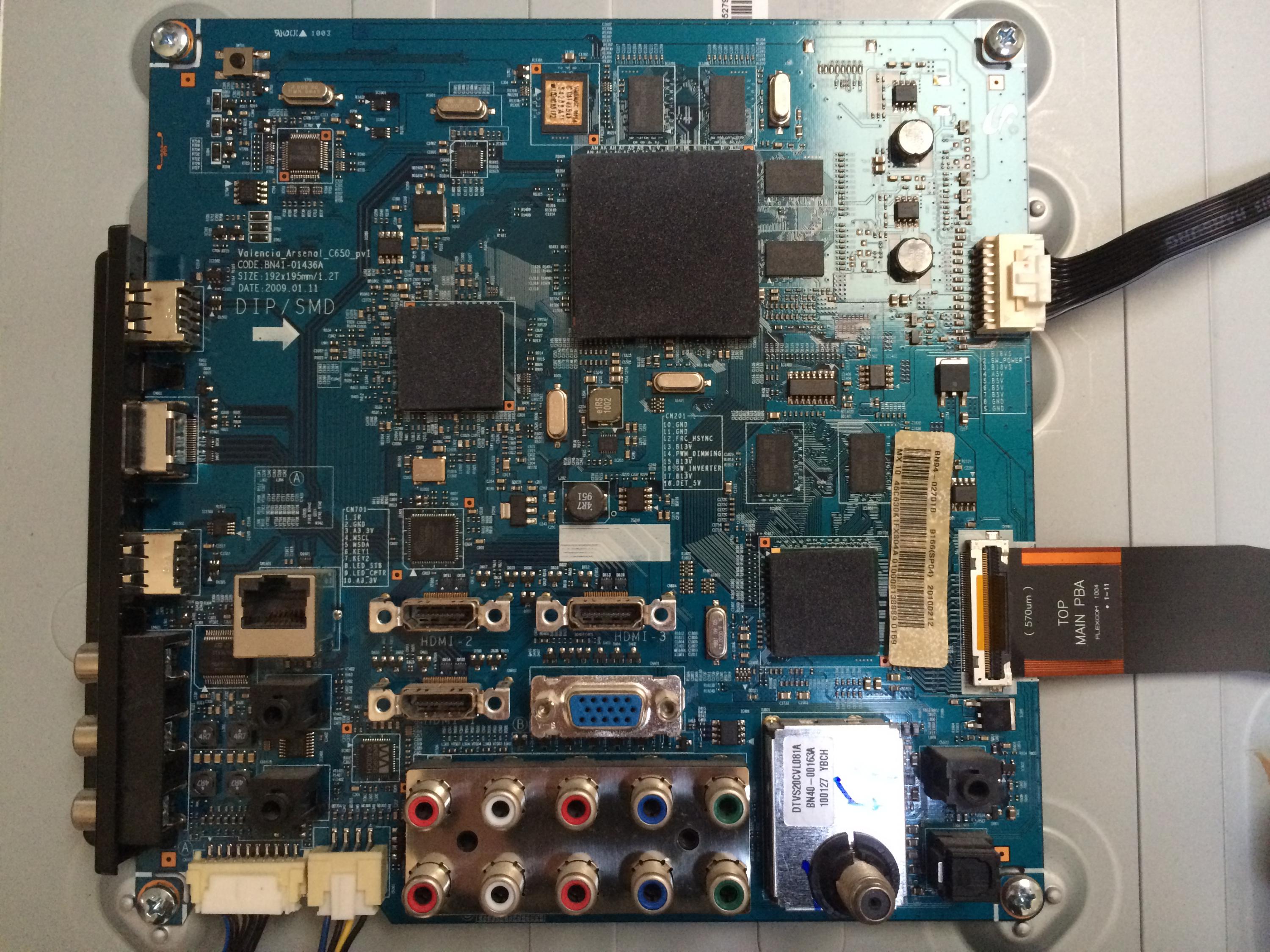

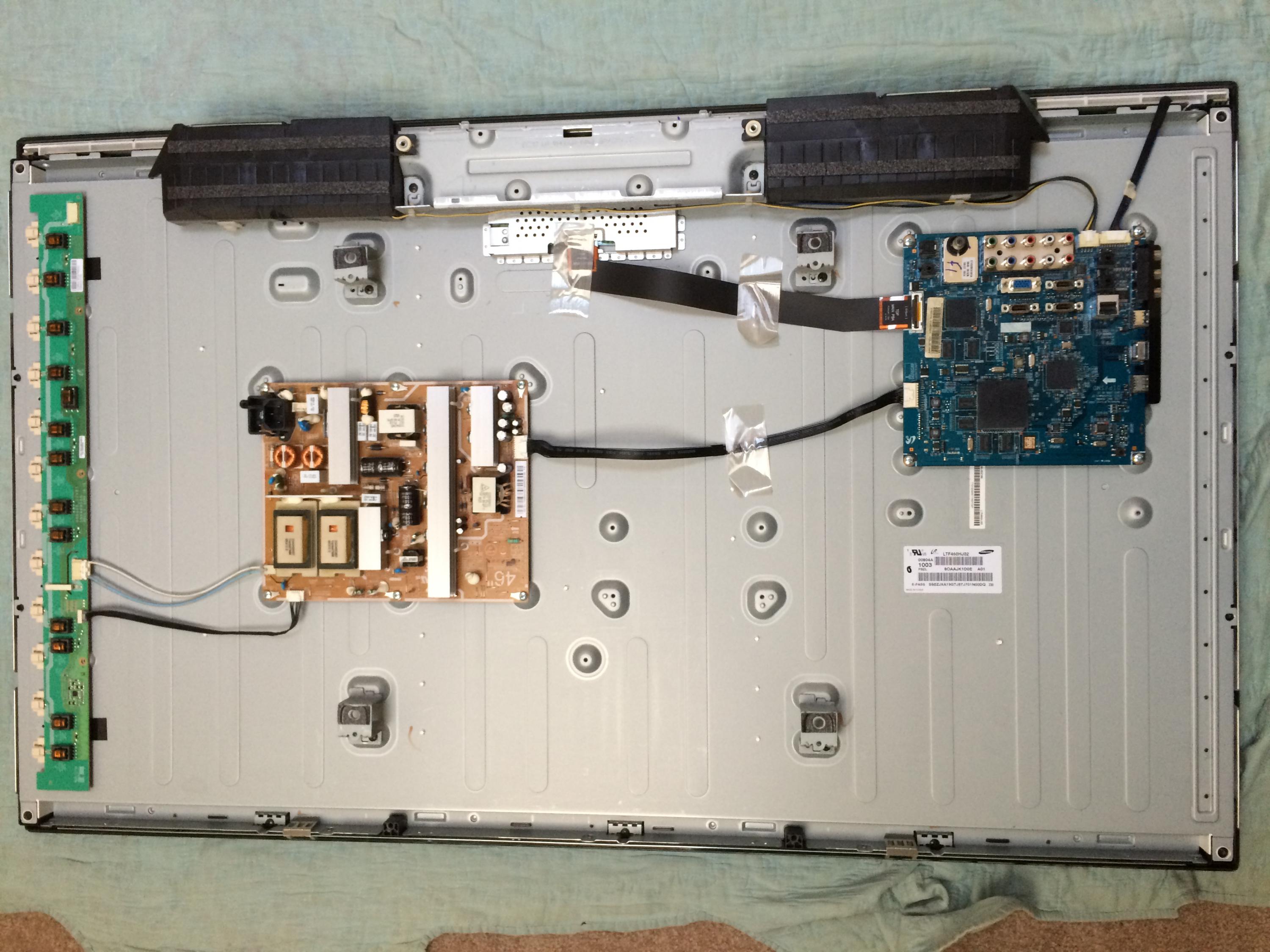

    Pictures showing your tv parts may help you more with fixing your problem

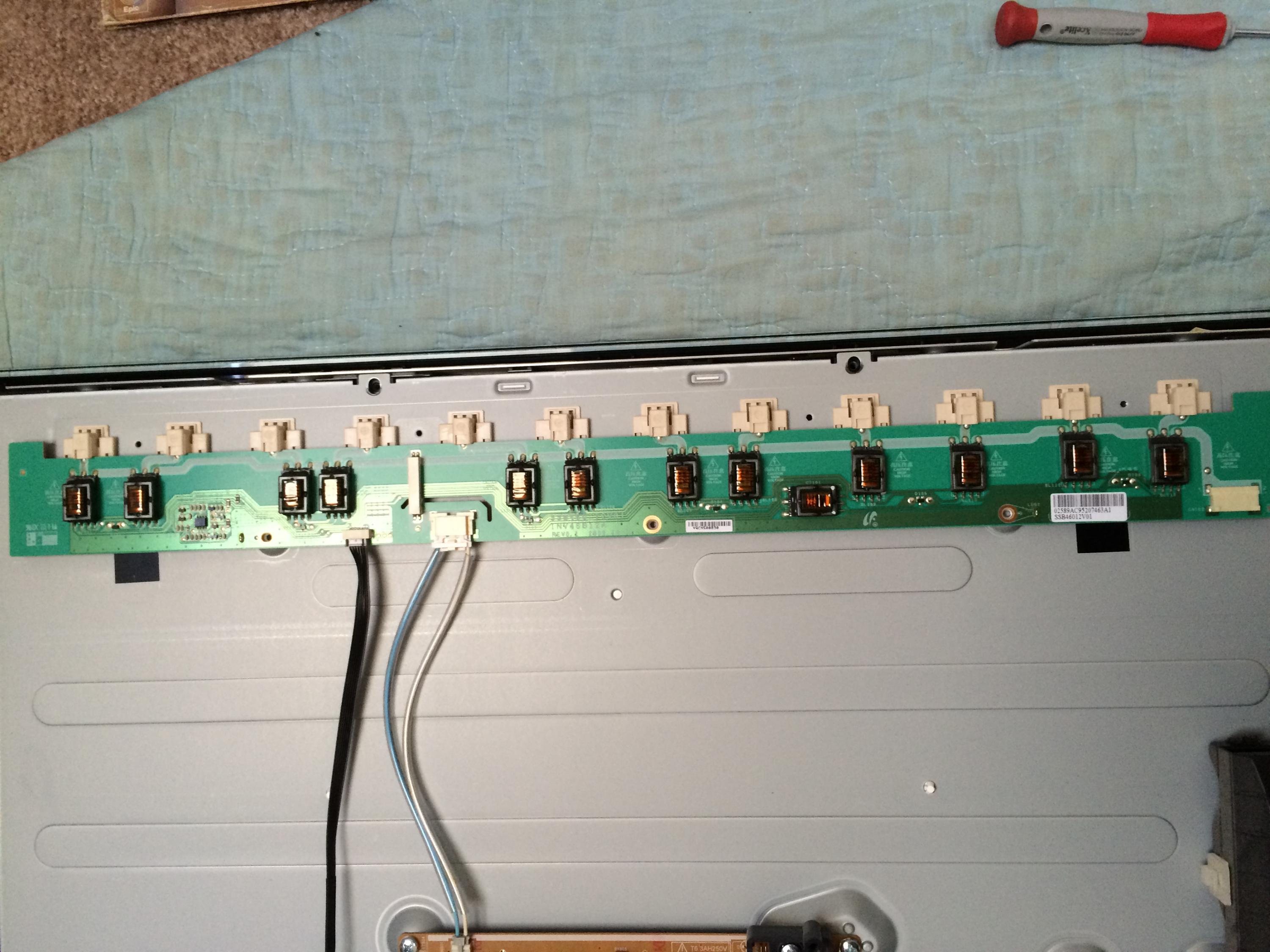

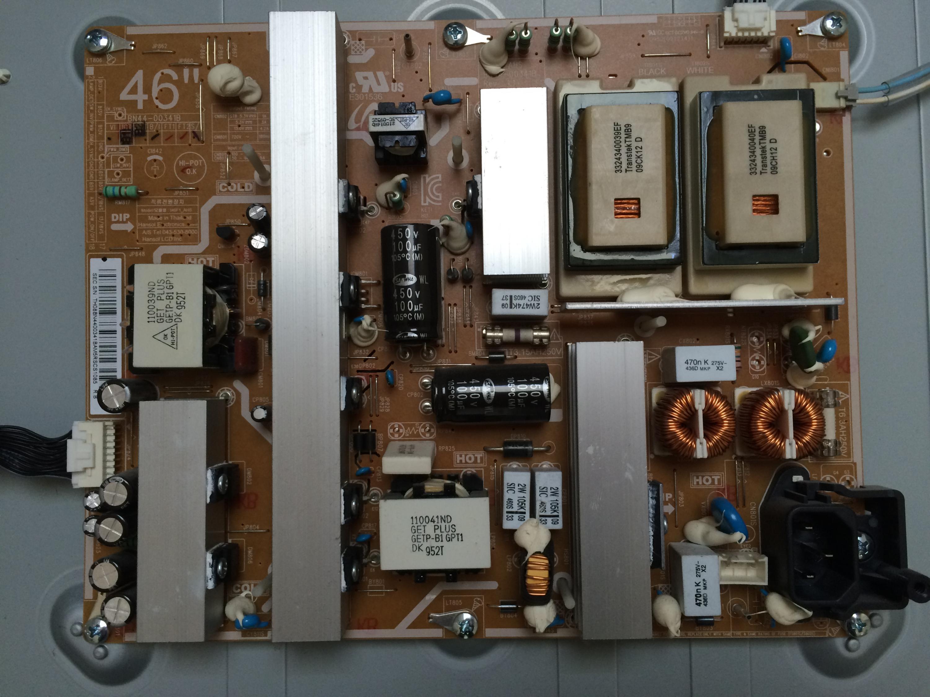

        Pictures are attached. If needed i can take closer pictures of certain parts as directed.

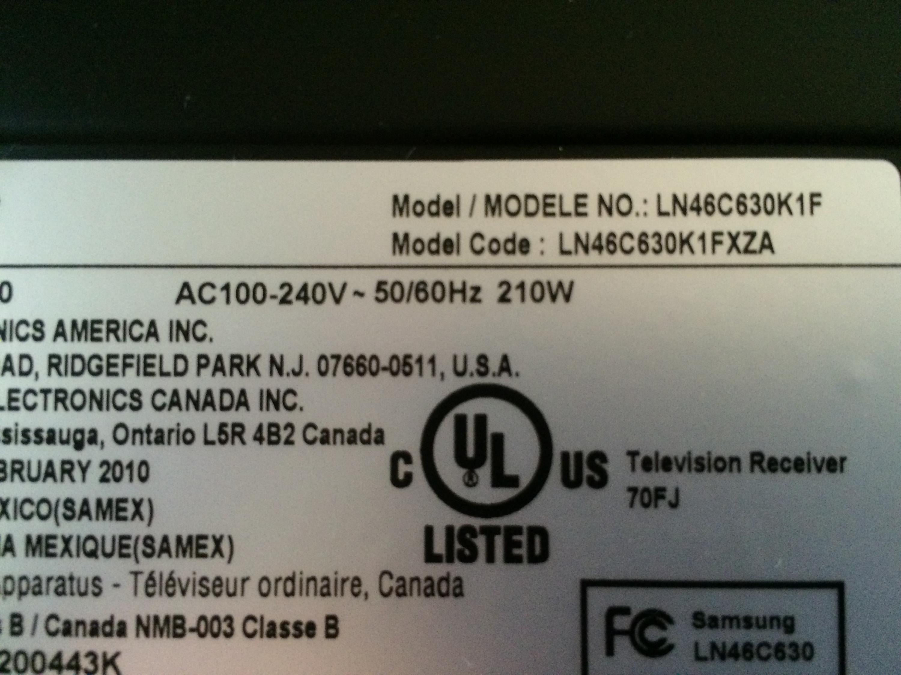

              The model number is not the same as what you posted in the thread's title. This particular model is known for having PSU/inverter issues. I'd start by checking PSU output voltages. Also, I'll wait for a definitive response as to whether an image is visible when a flashlight is shined at the screen.

                Re: Samsung LN46C60351FXZA No Picture
                Sorry, it was a type, 5 instead of k!
                Also, should i be able to see anything with an iphone flash light, or will i need a heftier one? I will grab a multimeter from work when i go back on Monday.

                      maybe check the fuse on tcon board.
