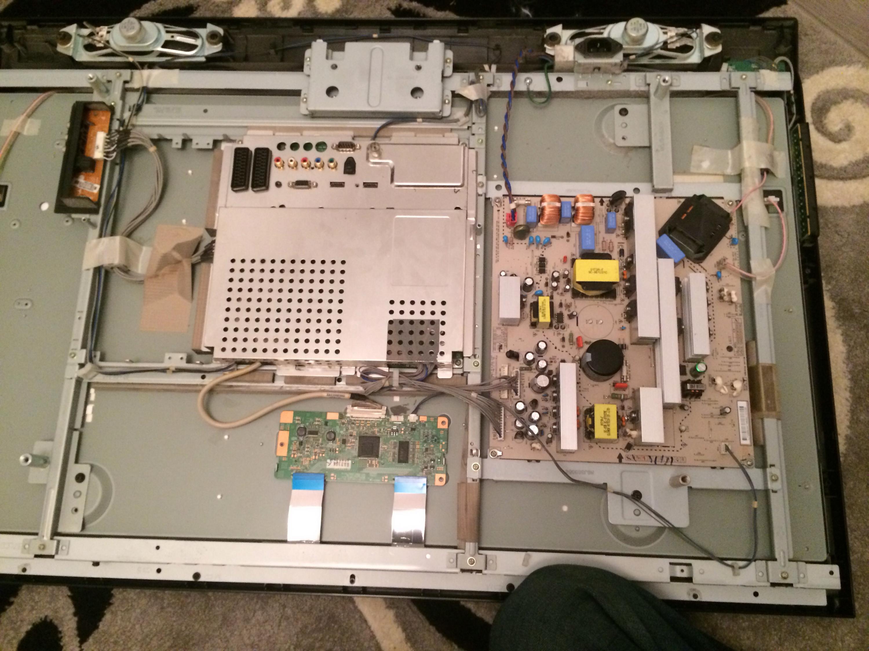

    Hello all merry xmas
    Ive got an lg lcd when i power up everything works as normal for the first 15-20 mi s then the screen starts to flicker or pixelate ive checked for bulged caps and checked ribbon cables but not sure were to go from here ive got a video can it be uploaded here? Then u can see what its doing it gets worse the longer its on
    Thanks for any help

    Re: Lg lcd flickering screen after 15 mins help
    can you post good clear pics. of each of the boards, and one of how they are all connected, what is the model number?, use caution when working with power supply HIGH VOLTAGE on primary side.

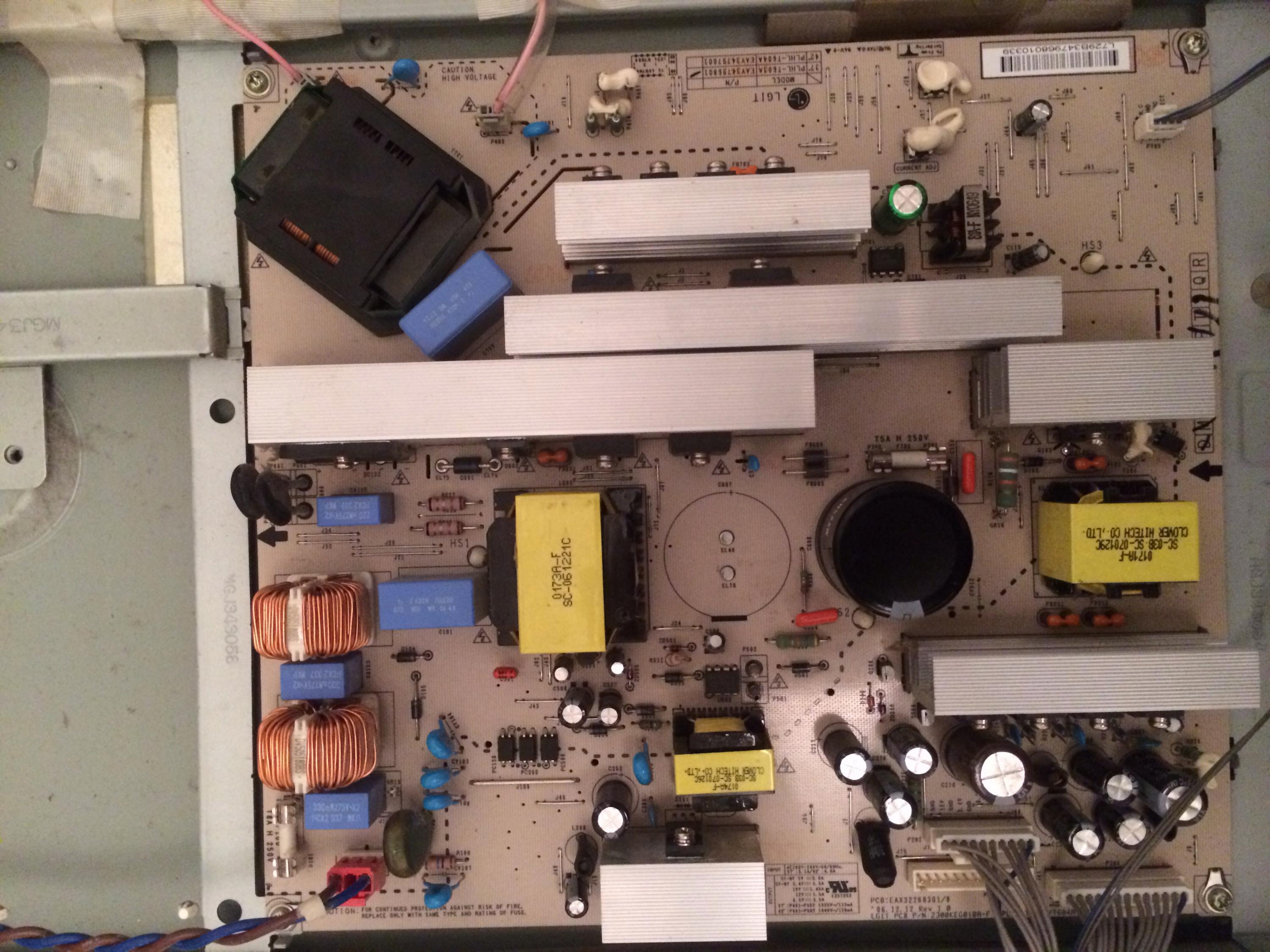

      Check P.S. voltages on P.S. accoring to silkscreen legend near connectors. 24vdc to inverters should be stable. check backlight on command , PS-on, standby voltage then tell us what you have. Also check the larger capacitors on the inverter boards that power the backlight bulbs. Use a DVM with negative (black0 lead) on chasis gnd
        The model no is 37lc55-za
          Here is some pics
            Close up of psu
              take the power supply off the TV and check for cold solder joints on the transformer the main inverter transformer the one on the top right
                Surely if it was the inverter then i would loose backlight? I tried upload a vid but was taking like 20 mins from my fne then i cancelled it the backlight doesnt flicker or go out its just pixelated like when u have a bad signal on freeview the picture gets lines through it
                  sorry missed that part yes it does sound like a main board problem. is it doing this on all inputs or just one?
                    Ive checked all voltages they all seem to be what is stated and are all stable
                      Doing it on all inputs when i first turn it on it works fine for about 20 mins then starts flickering a little but gets worse as time goes so must be heat related
