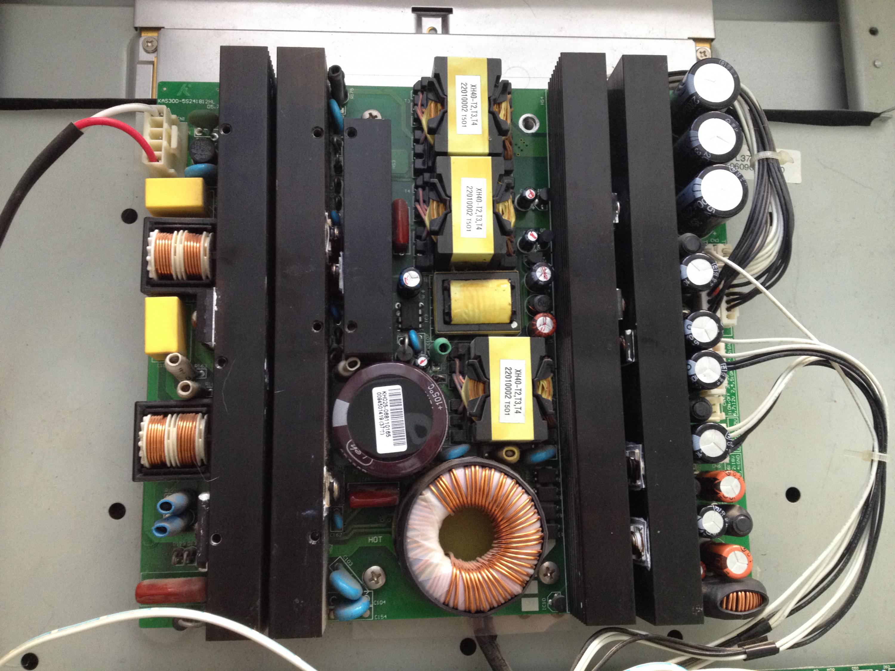

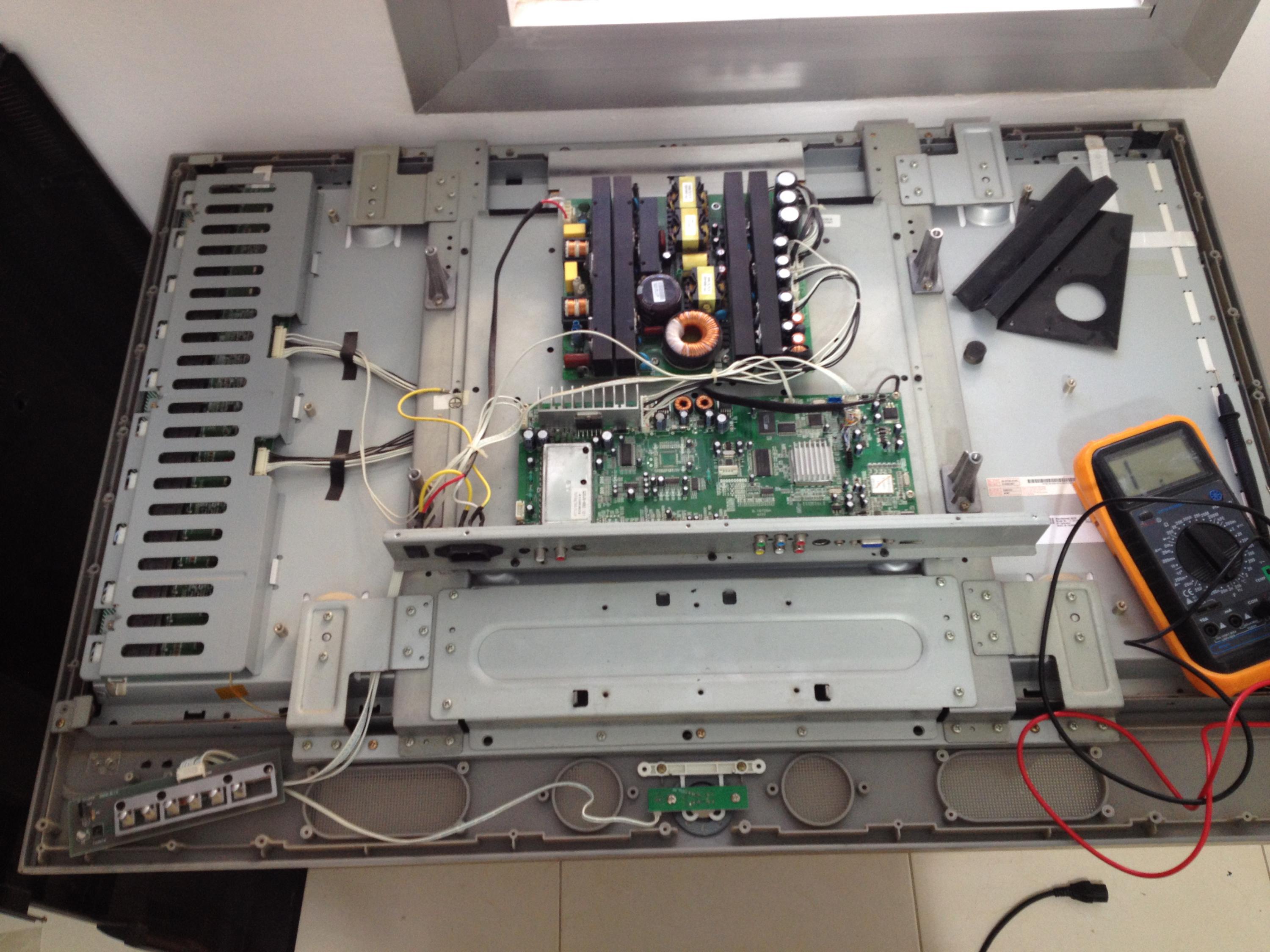

    Hey all,
    I found this TV on it's way to the trash..
    It had been opened and the speakers were missing.
    It got no power at all, so i found and replaced 4 bad caps:
    1X220u 25v-> totally open
    3X22u 50v-> high ESR
    I got standby voltage!
    But didn't manage to turn it on
    I don't have the remote but there is 3.8v on the power button.
    Got 315vdc on main filter cap.
    Power supply board:KAS300-5S241812HL
    All of the other caps looks pretty much fine
    3x1000u 35v were missing some of their capacitance
    almost 900 instead of 1000.
    i am going to replace those as well.
    Any other tips would help me out.
    im not sure if its the PS fault or the Logic board....

      I tried force power it by jumpering
      pin 1 ON CNR4 connector its ON/OFF with GND with mainboard and inverter disconnected.
      i can hear it's trying to start but i can hear some clicks as i have a short on something...
      i checked all of the small diodes, all seemed ok.
      the next thing is to check the transistors which is a pian,
      i hate to wick them out....
      any more ideas?

        Re: Pilot 37" LCD : PIL37AV Stuck on standby
        what voltage are you getting on the 2 middle pins of the bridge rectifier?,the voltage on the main filter cap seems to low
        fixed so far...376 lg lcd tv's,24 onn tv;s,24 panasonic lcd,16 jvc lcd,12 marshall jcm800 amps,refurb of various disco equipment lighting,old style disco decks ,and a flymo!
        please let us know if everything works ok if your tv gets fixed, as it will be and aid for anyone else having the same problem and wishing to fix it.it would save people clogging up this site with topics that are duplicated,and can be found easily using the search function.,and taking up valuable space.enjoy your fixed tv!,hopefully!

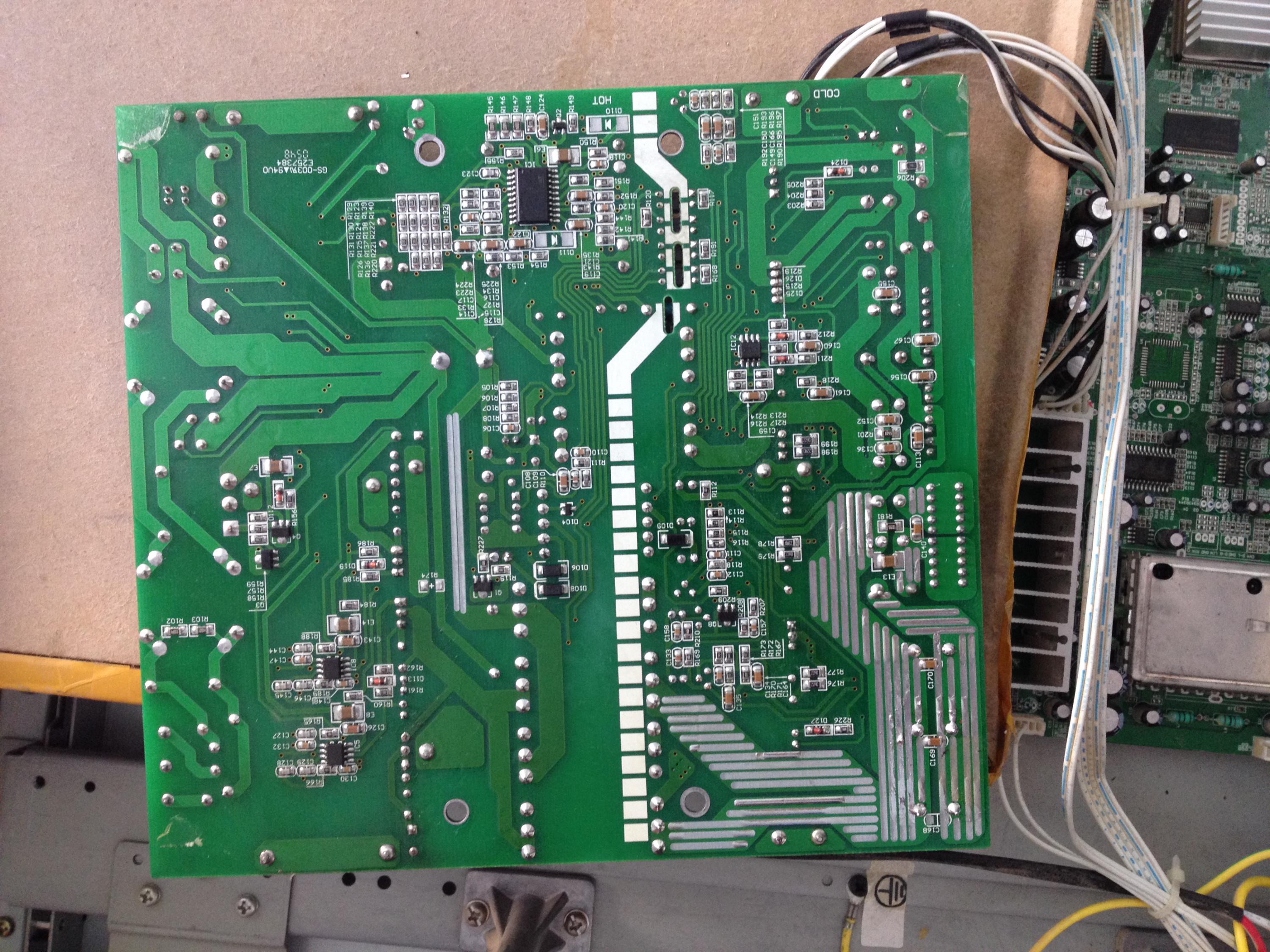

          testing this board with ac on, is a pain... there is some residue on the back side,
          and in order to test anything, i need to press real hard with the probs,
          haha im afraid to slip....
          just to clarify one pin on the middle pin of the bridge and the other on hot side gnd?
              i added some fresh solder, now the contact is better,
              i get 222vac between the middle brigde legs.
              never had the chance to thank you multimeter :-)
              what next?

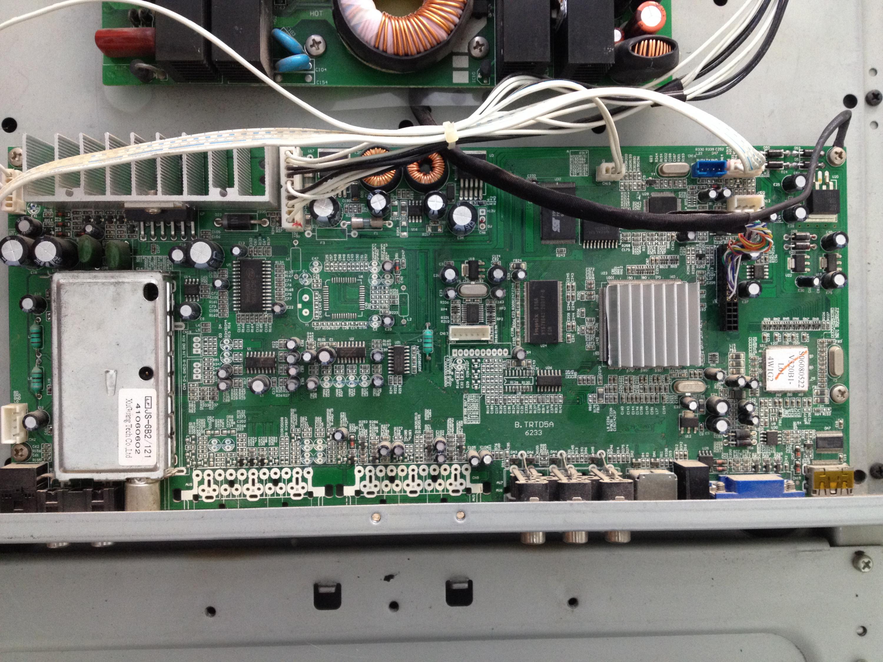

                    Could it be that the jumper i connected wasn't right, that caused the clicks?
                    Because without it (mainboard and inverter connected) there isn't any sound...
                    CN4, CN6 goes to the mainboard,
                    CN2,CN3 goes to the inverter.

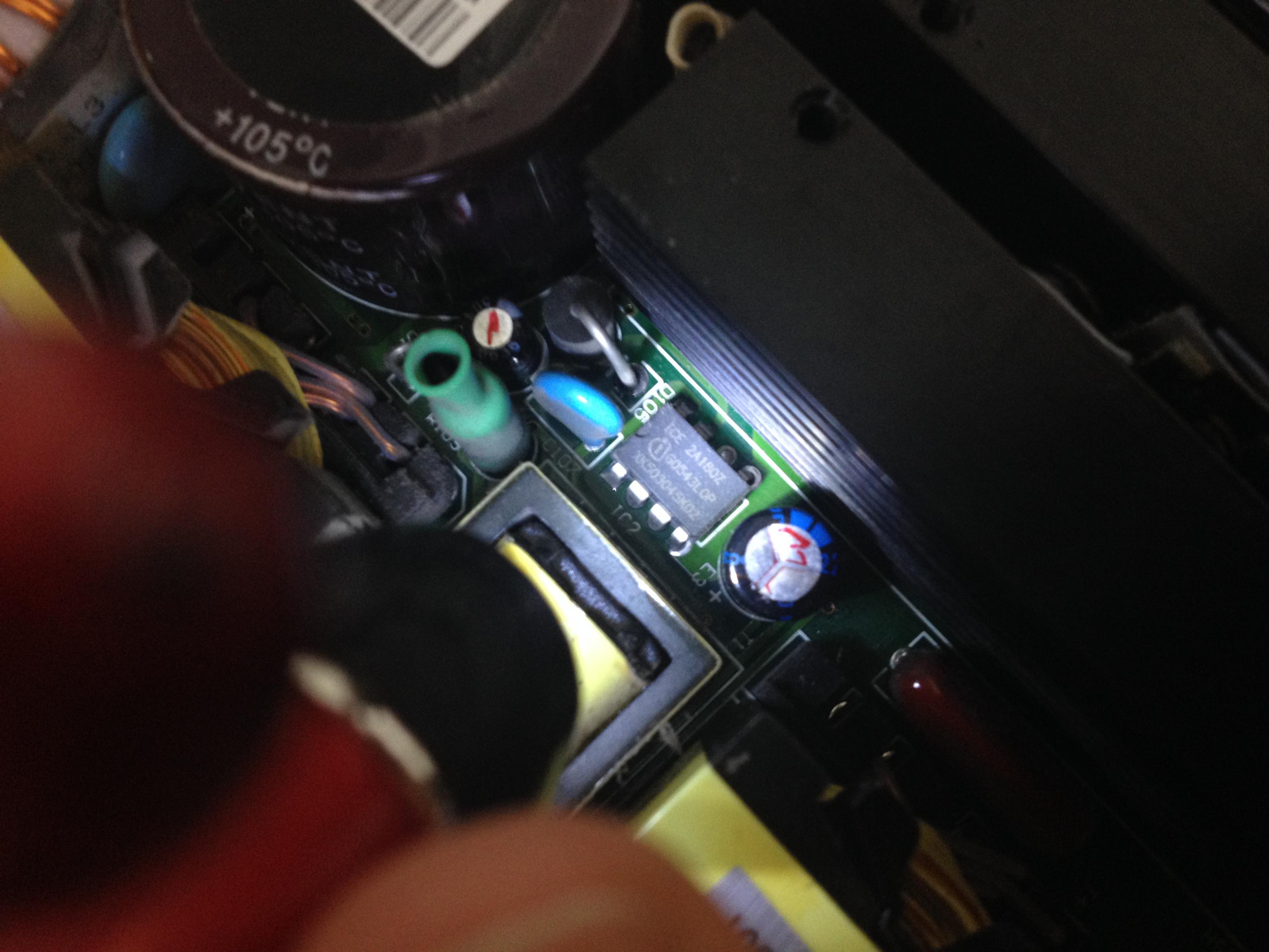

                        What is the part number of that 8 legged IC in the middle of the board just above the BIG cap in your picture
                                IC is: 2A180Z
