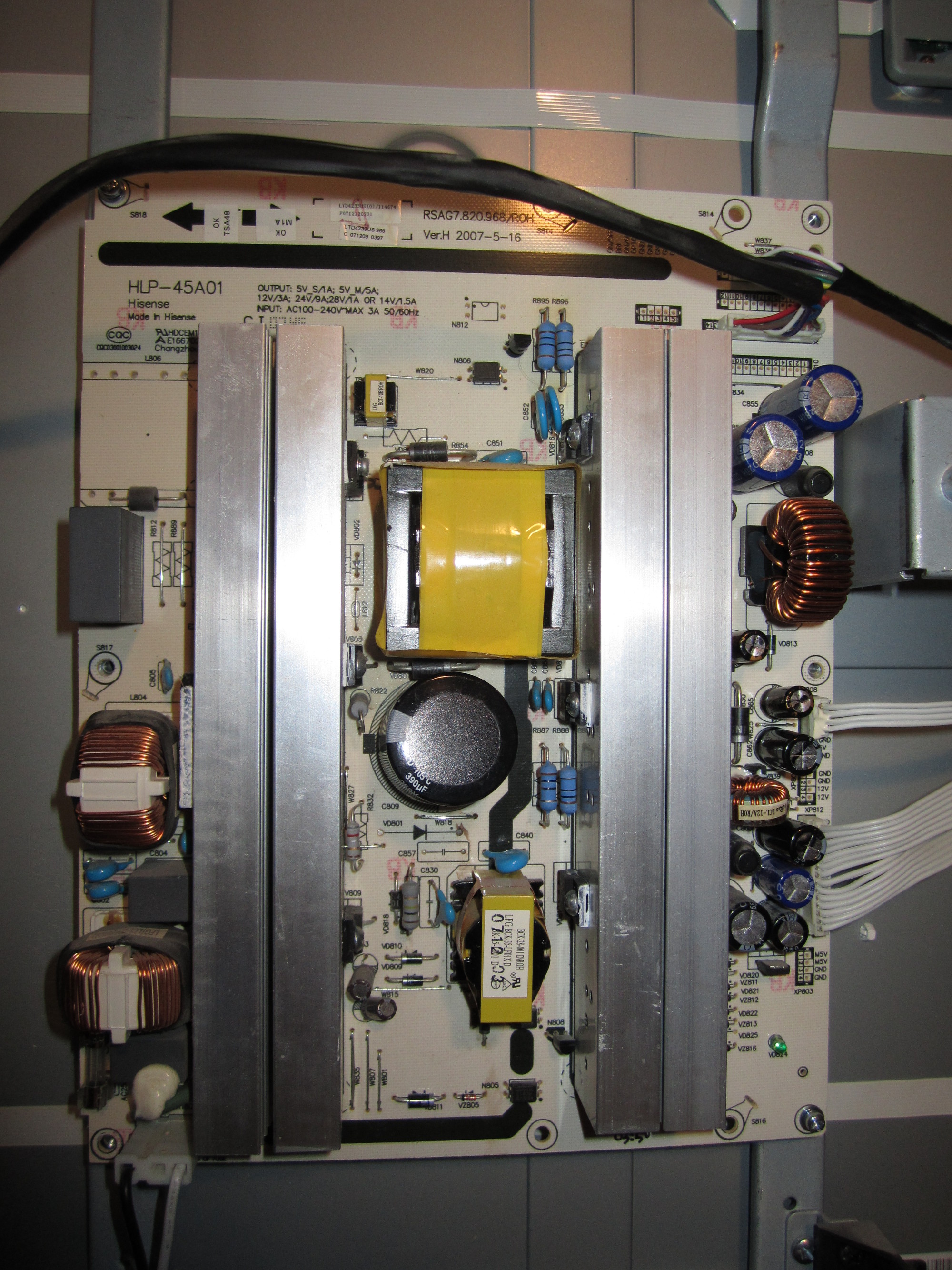

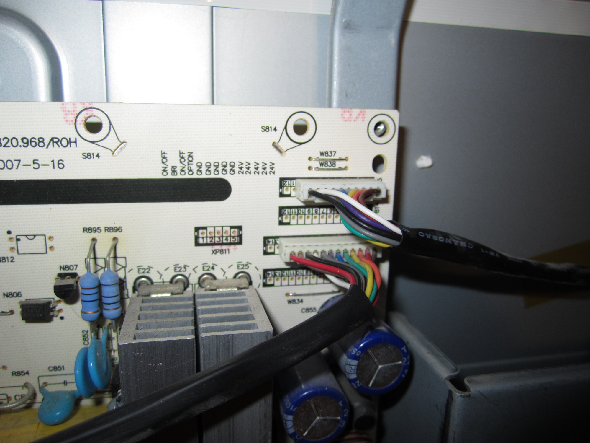

    Greetings all,
    I picked up a 42" Proscan 42la 45h that was reported not to have sound. Upon inspection, it powered on and was buzzing really loud, video is good. I fixed the buzzing - it was the big 450v 150uf capacitor that was bad. Now I am able to hear some sound, but it is very faint on max volume and it is crackling. I did replace some capacitors on the power supply since I had them, but none of them did look bad(Replacements have line trough them diagonally). No improvements though.
    The power supply board is: (HLP-45A01 or RSAG7.820.968/ROH ver. H
    The main board is: E/RSAG7.820.997A Ver. D
    Troubleshooting done:
    With TV on, I get 24v as expected on the top right. I believe these are for video/ inverters. Half way down on the right side, i get good 12v, 5v, but where I am supposed to get 28v I only get 15.72v. I am a bit unsure about the 28v, as I thought there are only 5v, 12v, and 24v generally in TVs. The 28v is printed on the power supply board...
    There is no other obvious damage on the board or components
    See attached pictures.
    Glad to take more pictures in more detail or do troubleshooting steps.

    Re: Proscan 42la 45h low power supply voltage and no sound

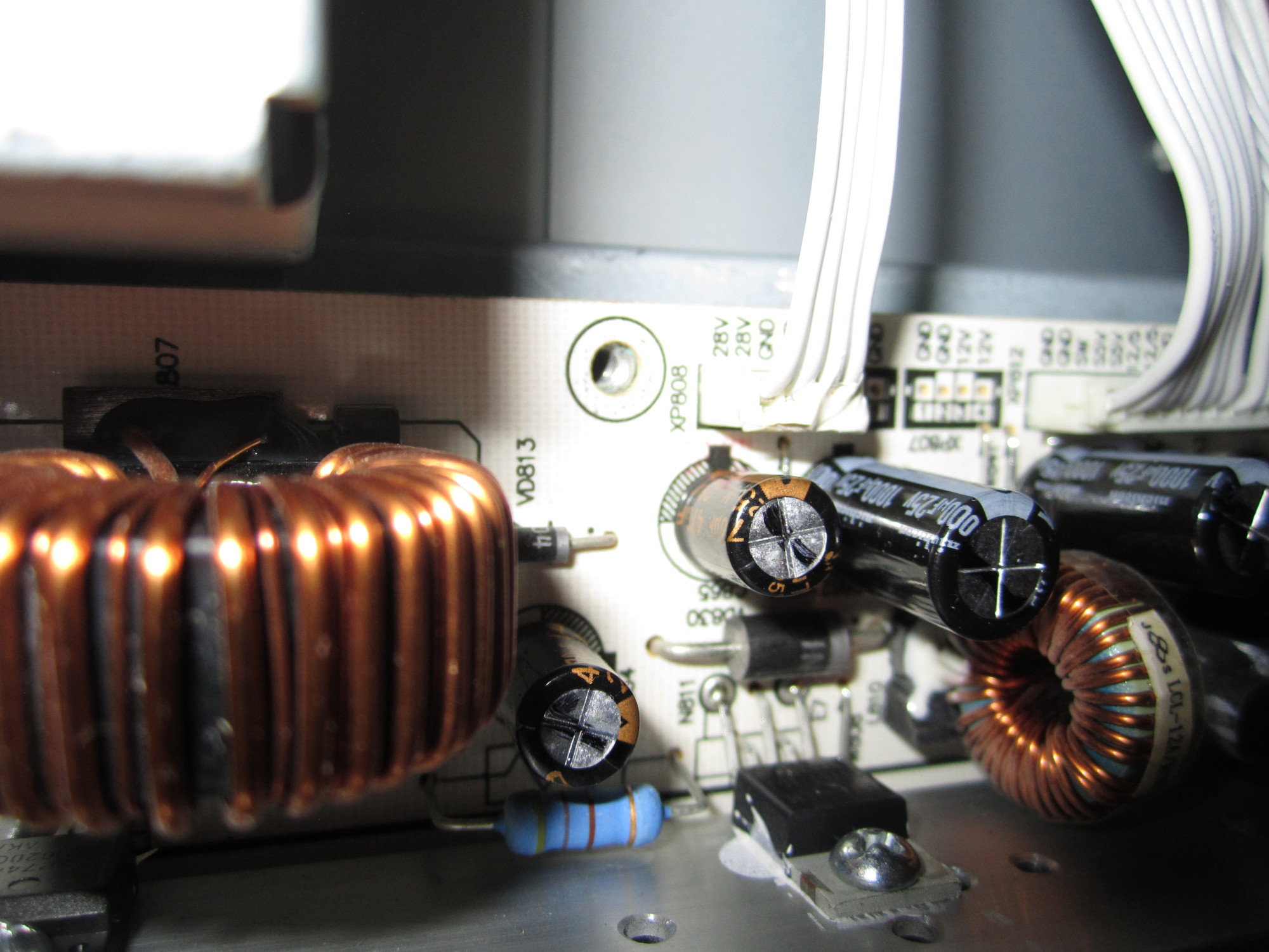

    Does the 28v go to the mainboard ? If so it will explain why your audio is acting up.
    You may have more capacitors to replace yet.
              Disconnect the 28V on the main board and turn the power supply back on. Force it on, if you have to and check if the 28V are back. Maybe something is dragging the 28v line down on the main board.
                I did that and I get a minor improvement, now I get 16.96v instead of the 15.72v.

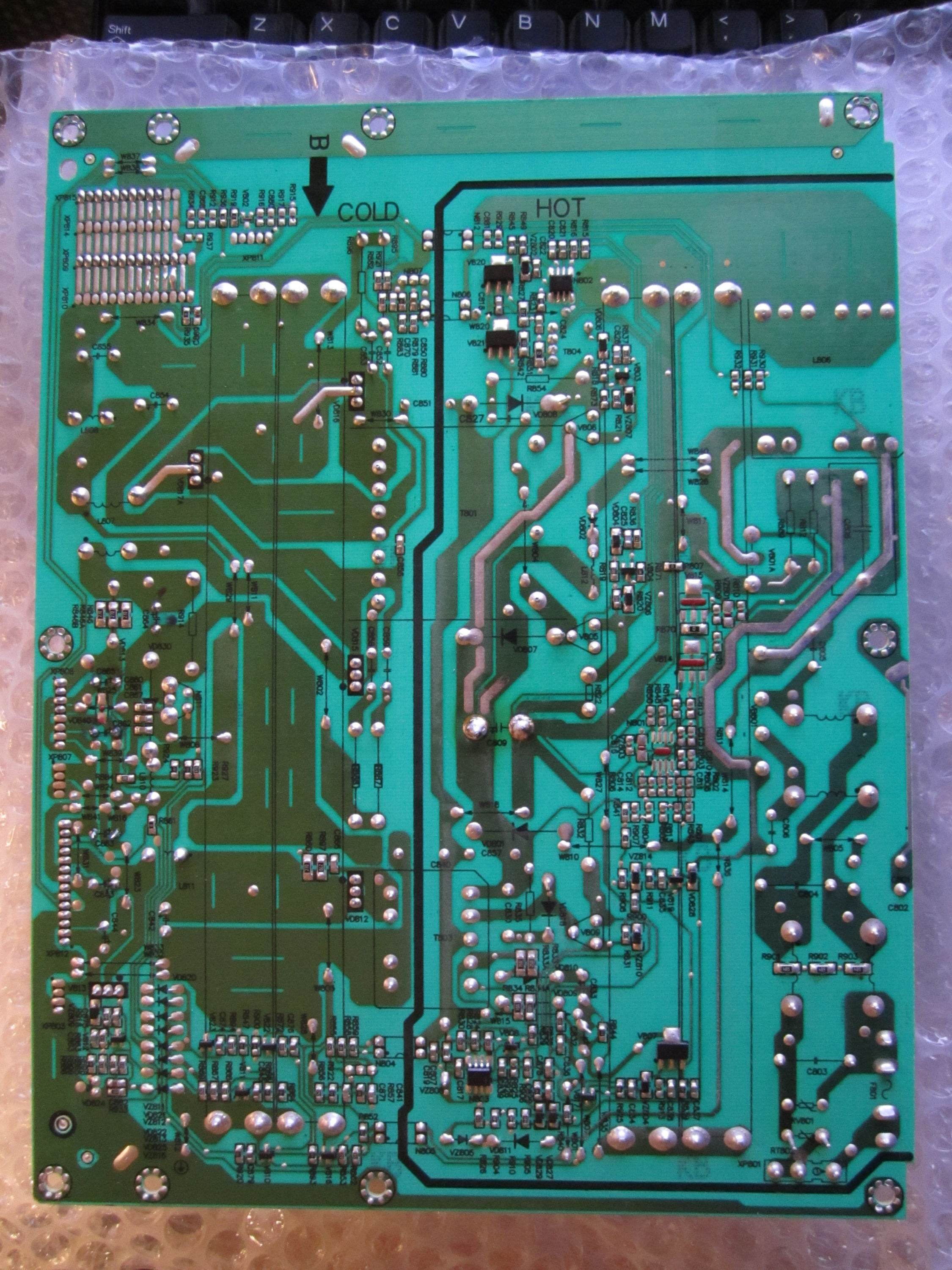

                  Can I see good clear picture of the bottom side of the that clearly show the traces?
                  As shown on the board, the label shows it has 28V output at 1A or 14V at 1.5A this output is not regulated, that is lots of power. I wonder if it is used for the Audio power amplifier circuits.
                  You should check the current draw on this output.

                      Here is the board for now. I will check the current draw tomorrow.
                        Thanks for the bottom view picture but I cannot tell which pins are which, I cannot see the pin labels on the top side of the board due to the cables are in the way. I am trying to see which winding of the transformer generates the 28V.
                            Back side of the board pic, right under the middle board mounting hole, the first 2 pins from top to bottom are the 28V, next two pins are GND.
                                    Problem solved. I managed to fry something on the main board (the volume amplifier while testing there). Got a replacement board from eBay and the sound is back.
                                    Appears that the power supply was good, even tough the voltage seemed lower...
                                    Thanks for all your help. I learned a few things for future troubleshooting.
