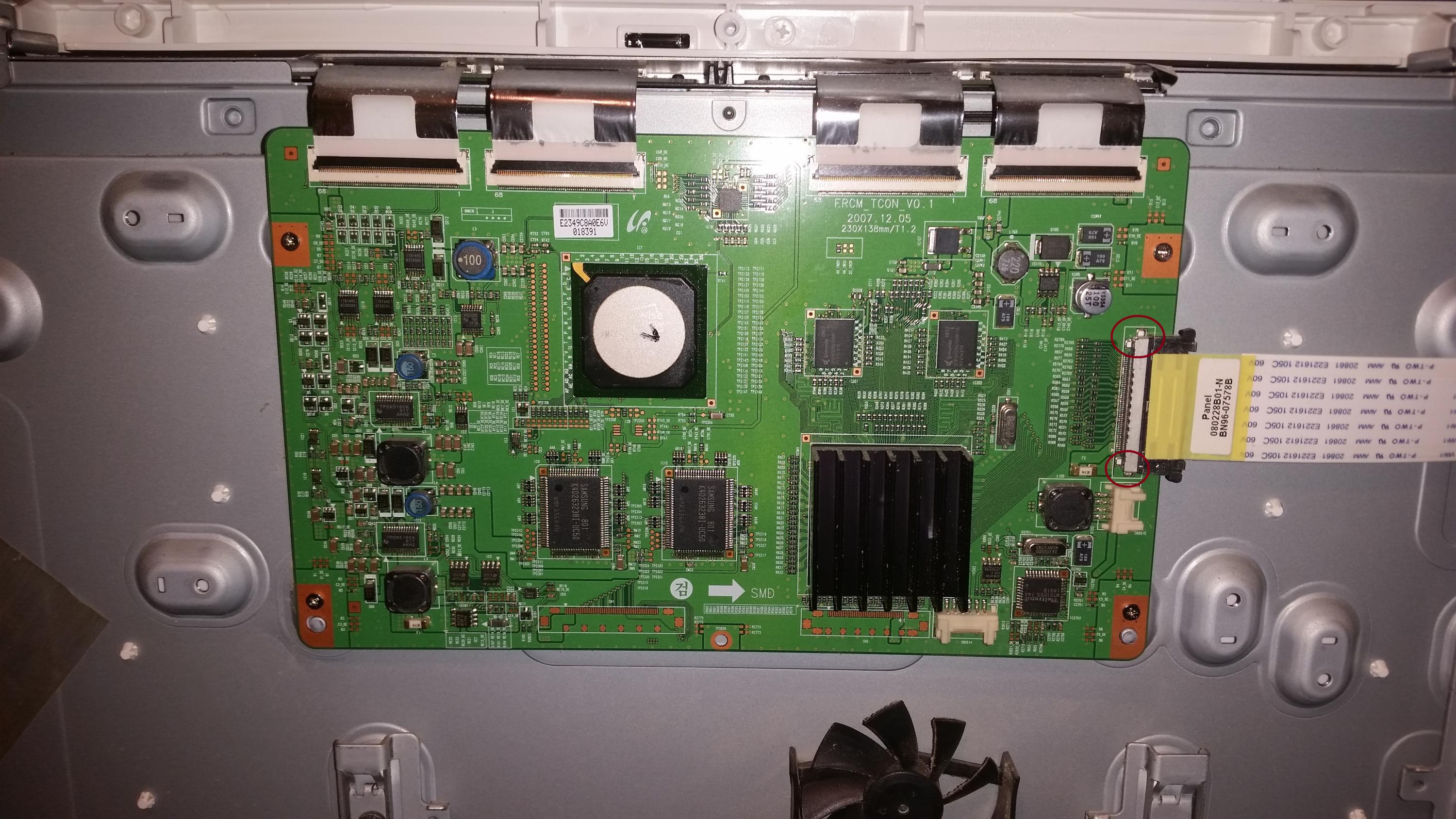

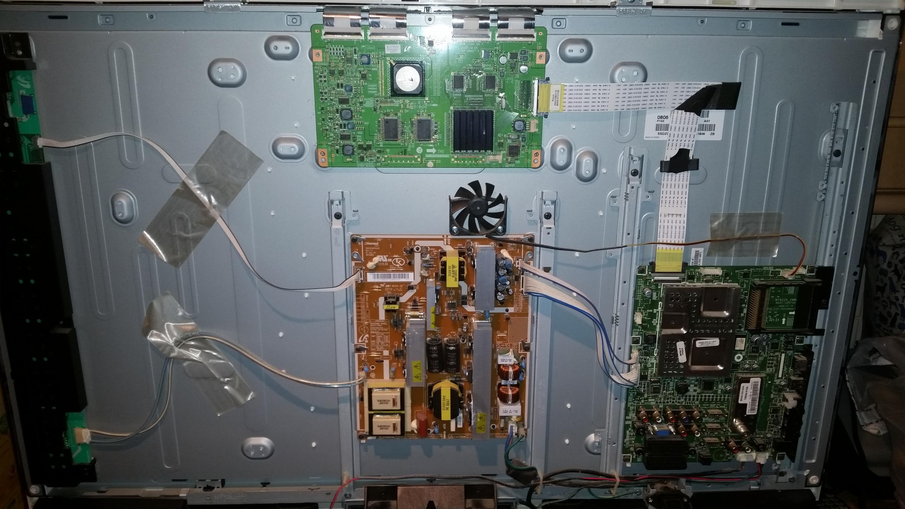

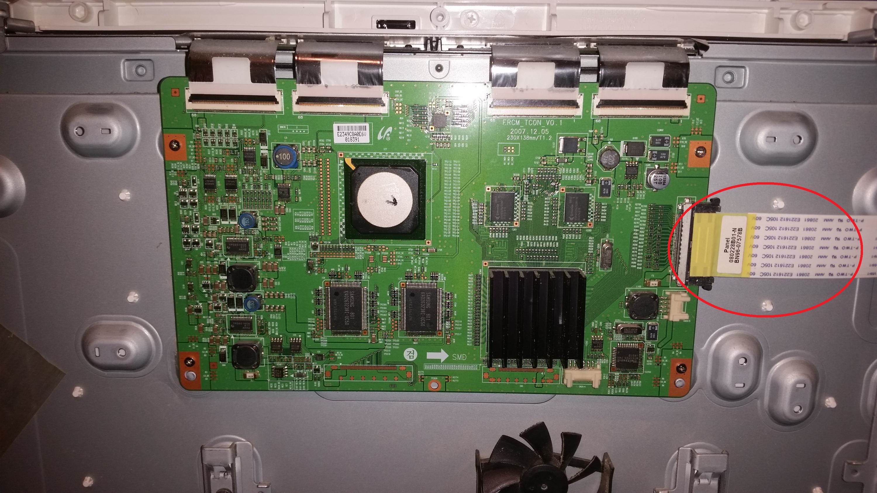

    Hello guys
    so i picked up the tv today with solarized images cleaned the lvds cable and reseated which made the tv picture go ten times worse,upon cleaning a second time to the tv would just keep restarting so tried a third time and now everything is ok picture is fine
    intermittent fault somewhere or is it just tricky getting the lvds cable right sometimes ?
    thanks
    Re: samsung le40a656a
    Could be main board fault-- I would run it for some time before calling it fixed. Not encountered dodgy LVDS on models using the "rigid" cables myself; it's always the flexible ones that are failing.
    I had a non-intermittent LE40A656 picture fault, bad T-con board. Mine was a repeated pattern across screen, every other 1/8th of screen was solarised. https://www.badcaps.net/forum/showth...light=le40a656
    I've also had bad tabs cause a dark blurry pic but I'd guess that's not what you've got.
    • sordids999
      • May 2013
      • 2158
      • uk
      its a strange one if i just wiggle the lvds cable going into the tcon the solarized images come back im going to search around to see if i have another spare cable
        Try pressing on that black heatsink to see if the same thing happens.
        • sordids999
          • May 2013
          • 2158
          • uk
          pressed on heatsink nothing changes tom
          update: change the lvds cable and resoldered on some points in the picture now it does not do nothing now once i wiggle the lvds cable at the moment but ill test it still

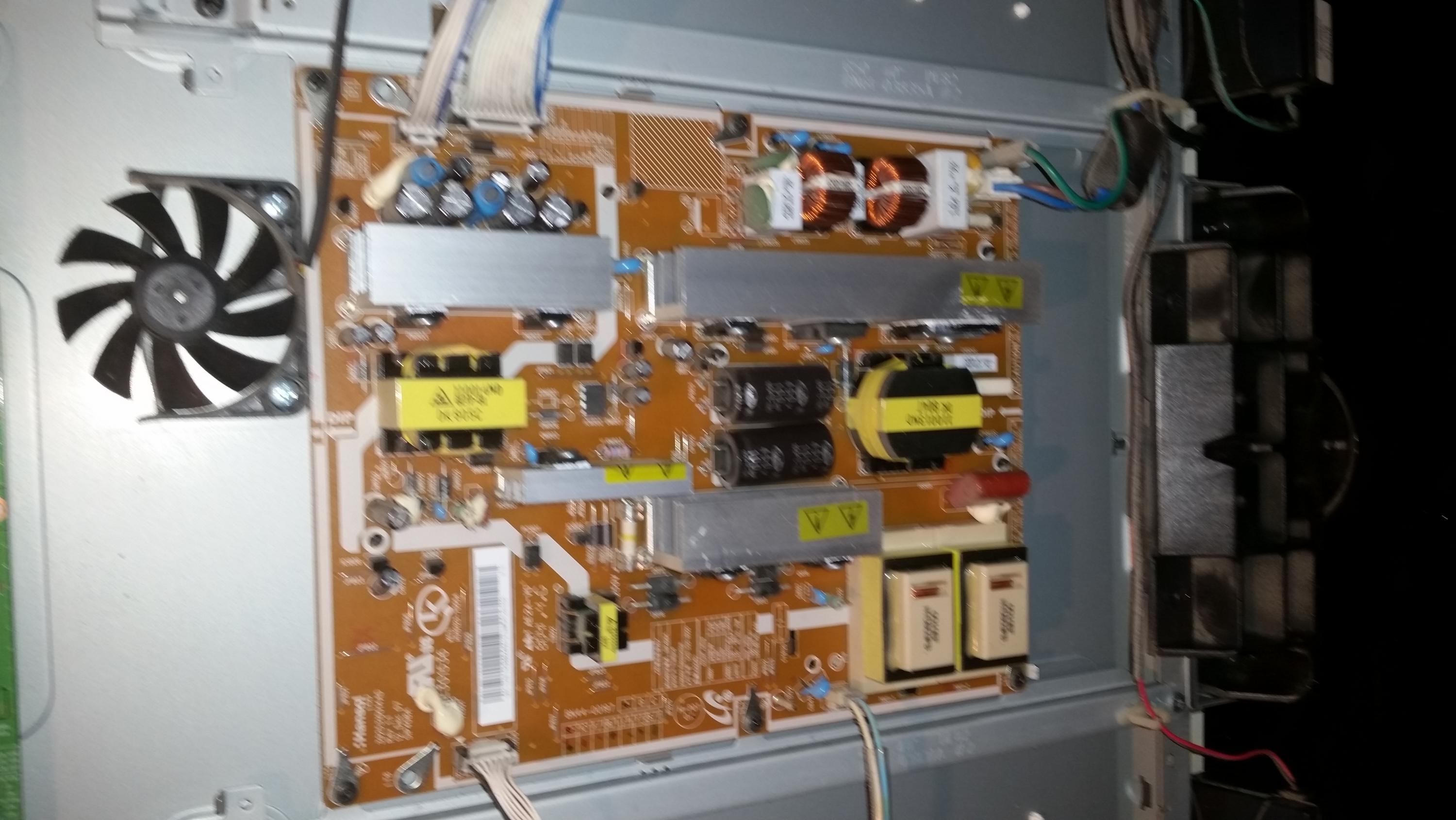

            While you're at it, worth cleaning the fan as it can make a loud noise sometimes while operating.
            • sordids999
              • May 2013
              • 2158
              • uk
              already done tom
              • sordids999
                • May 2013
                • 2158
                • uk
                tom
                question the tcon cover i ripped the silver tape while removing the tcon board which covers up the ribbons does it matter or get some more to replace ?
                  It is for EMC/EMI compliance. i.e. radio interference. Not a major issue, just try to stick down as much as possible.
                  • sordids999
                    • May 2013
                    • 2158
                    • uk
                    Thats the problem it all ripped while trying to remove it
                      It should be ok... just be more careful next time.
                      • sordids999
                        • May 2013
                        • 2158
                        • uk
                        yes boss i will in future and thanks for the help
