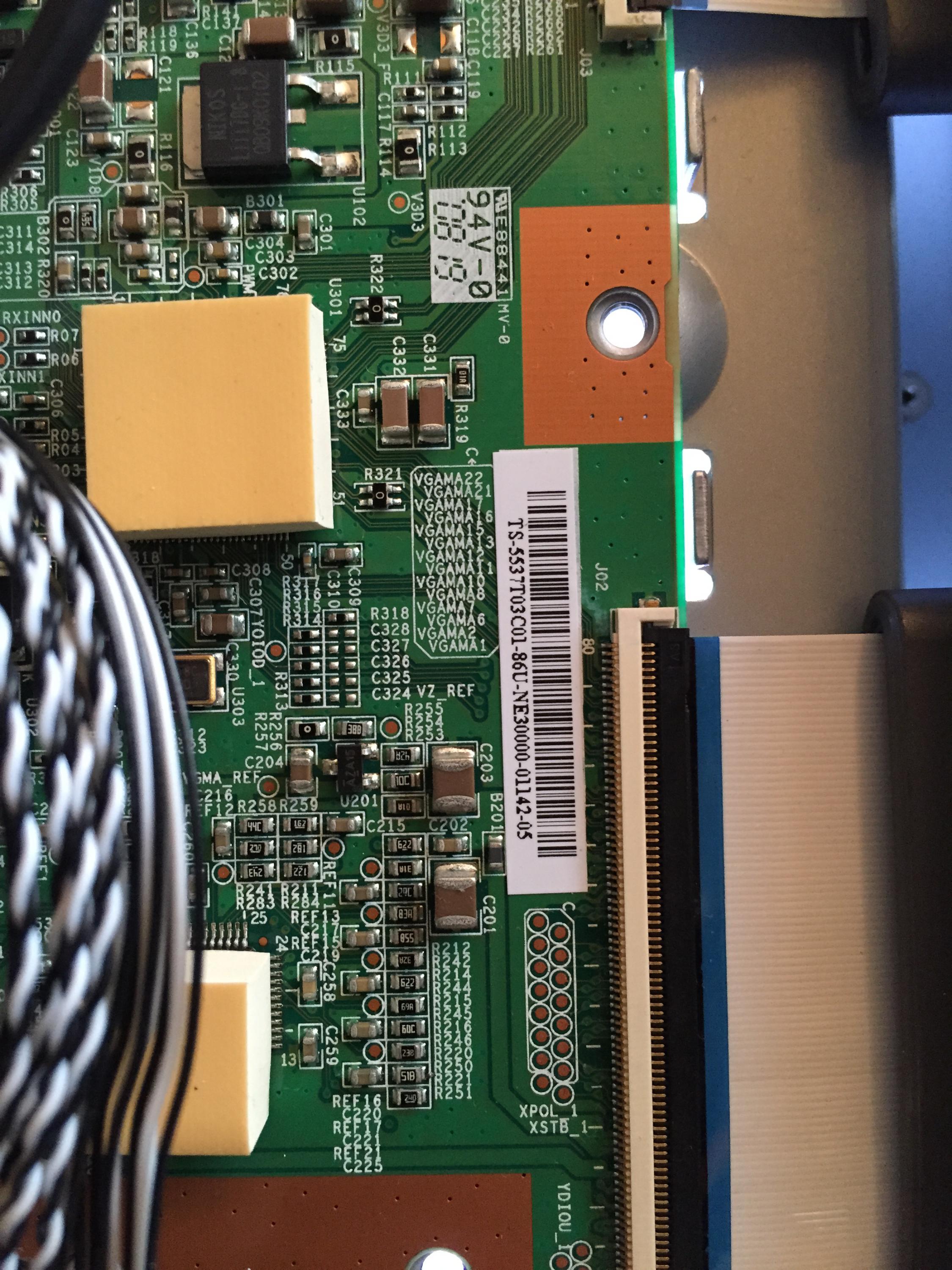

    I measure:
    XPOL 1 - 1.66v
    XSTB_1 - 0.19v
    1 - 15.16
    2 - 14.96
    6 - 10.45
    7 - 9.77
    8 - 9.70
    10 - 7.75
    11 - 7.48
    12 - 6.72
    13 - 6.45
    15 - 4.75
    16 - 4.45
    17 - 3.92
    21 - 0.49
    22 - 0.35
    If it's a bad gamma chip, which one on the board would it be?

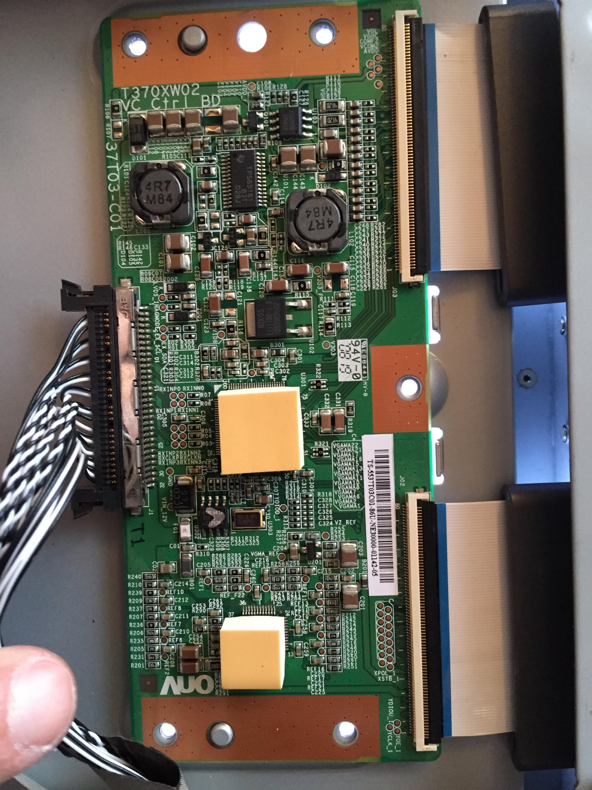

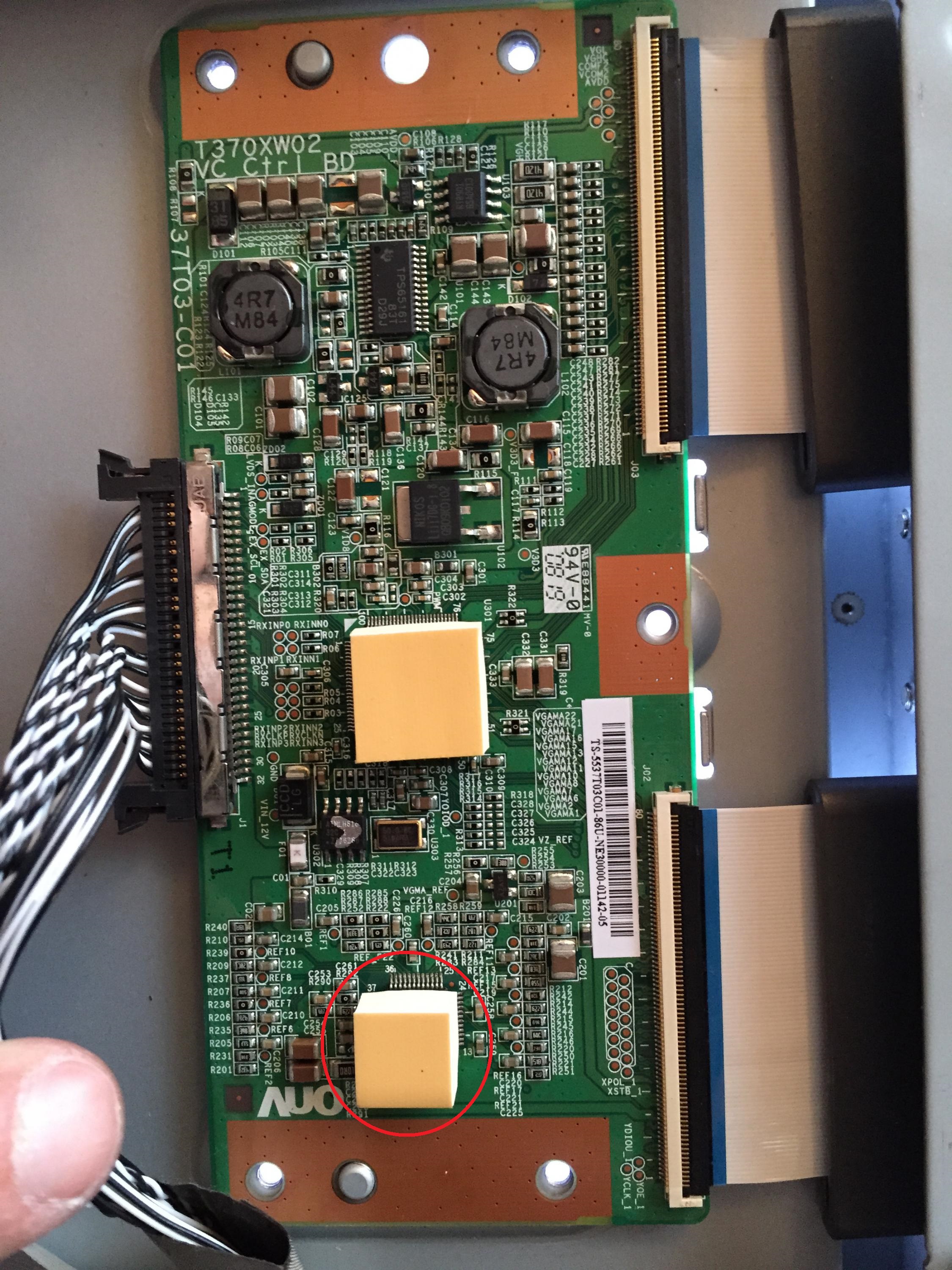

    Re: Samsung LN37A450C1DXZA - Gamma chip problem?
    It should be that chip underneath the pad. AS15

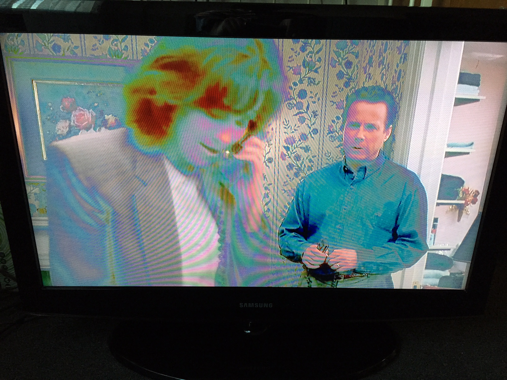

              Odd, I removed the foam pad and the picture looks normal now. It'll occasionally change like before but it's not constant
                      Update: replaced the chip and same problem persists
                            Check the soldering on the AS15 for shorts, but if the symptom is exactly the same, go back and check the voltage references and generator.
                            Check the gamma reference U201 both input and output.
                            Check Q101, D102, and the dual barrier diodes D104, D105.

                              Fixed: it was a bad replacement chip. Tried another and all is well.
