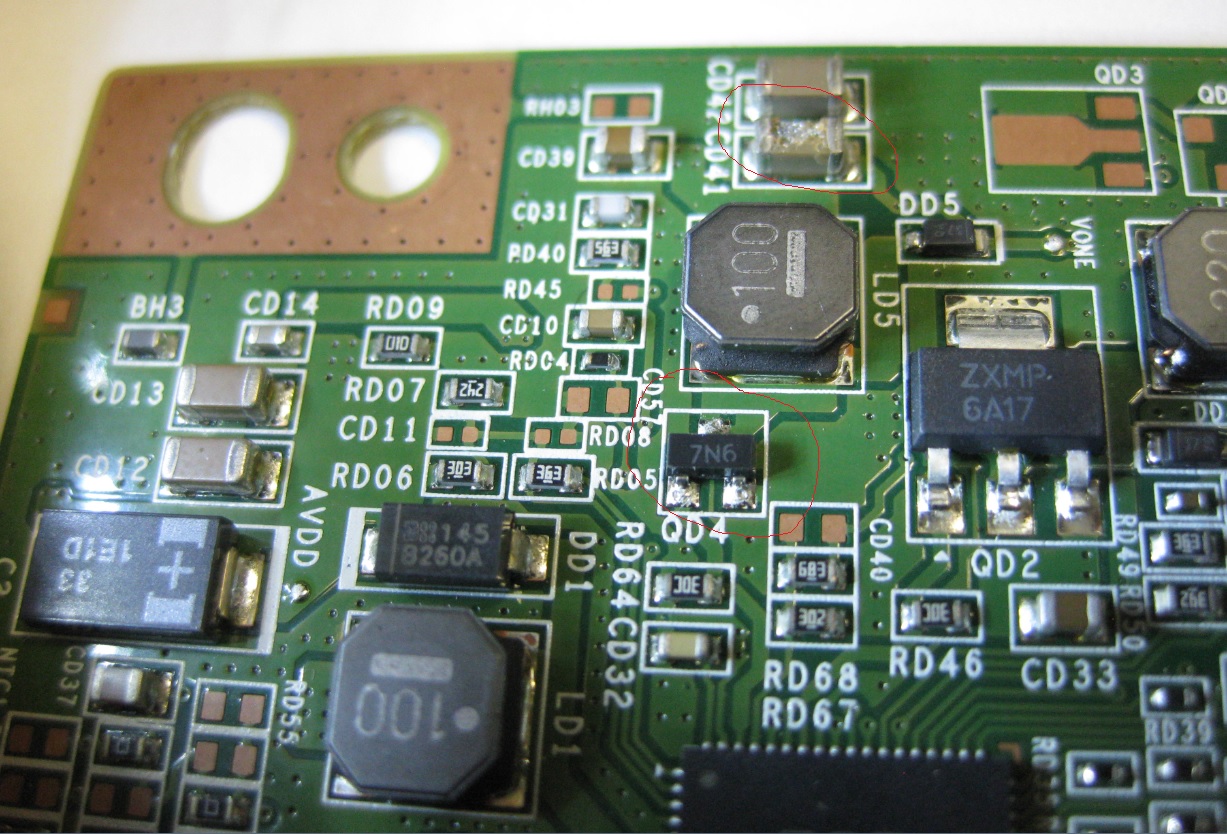

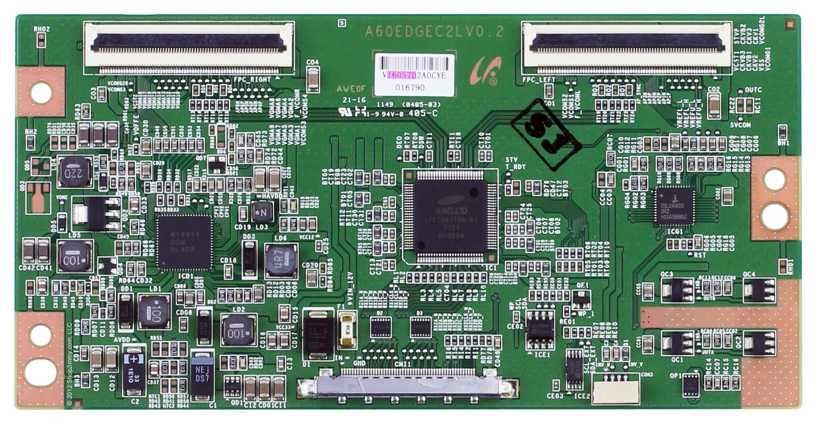

    Hisense 46" TV F46K20E, has backlight but no picture, found the 3A fuse on the t-con board was open. replace a good fuse but burnt again. Check T-Con Board: A60EDGEC2LV0.2, one transistor (DQ4) was shorted, part number only printed as 7N6, what is this transistor, are there any general equivalence ?

    If you look up 7n6 is referred to a N channel mosfet.
    ZXMN6A07FTA
