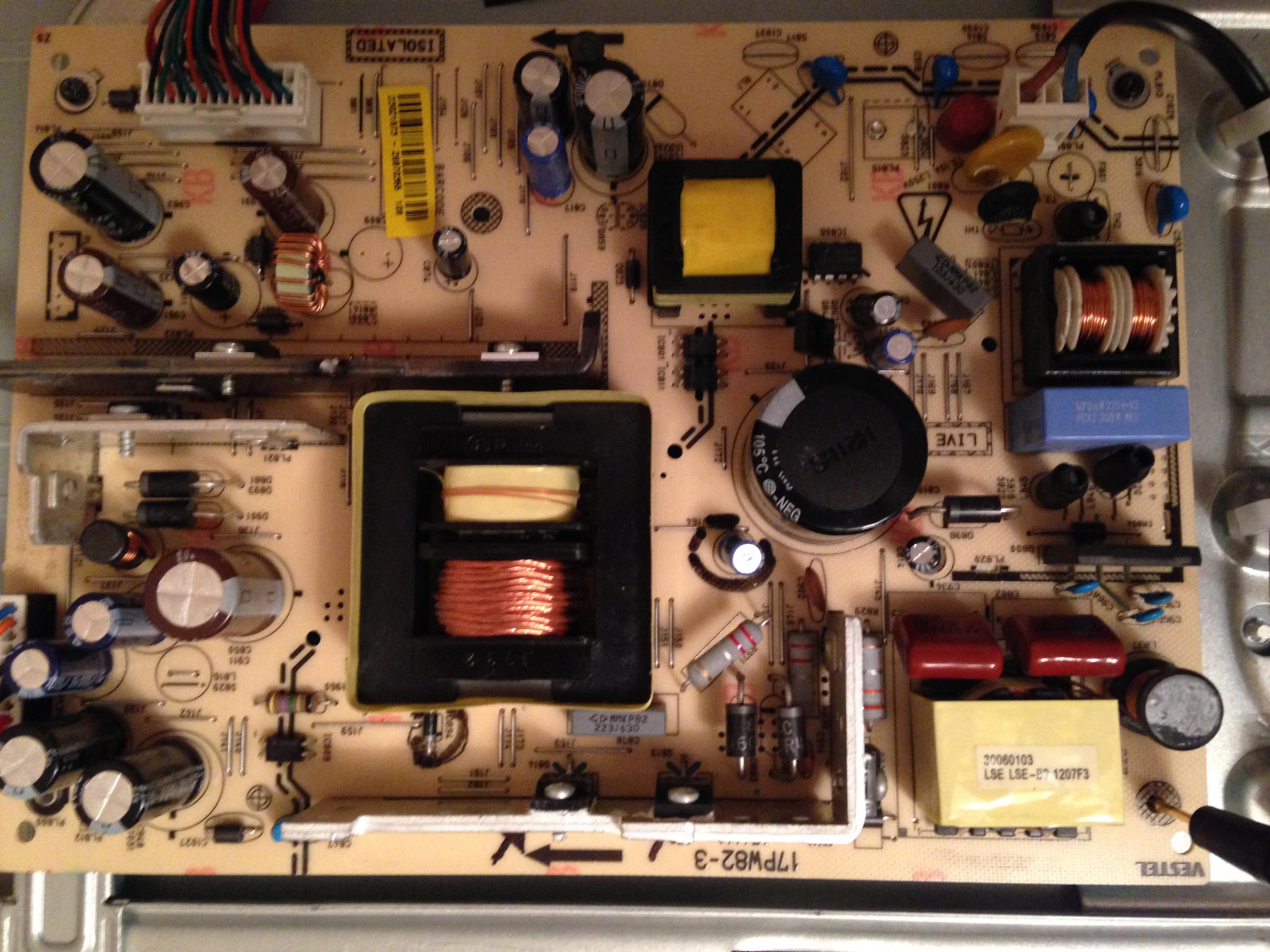

    I've inherited the above tv. It has vestel gubbins, specifically a 17pw82-3 psu board and 17mb65s-3 mainboard.
    When I push the buttons on the front of the tv there is a beep so 5 volts is there somewhere.
    Am I better off starting diagnosis with the mainboard?
    I can't see any poorly caps with my esr meter and have checked the components found in the online repair kits for the psu board.
    Has anyone had experience with these TVs or these vessel boards?
    Thanks in advance.
    Dave.

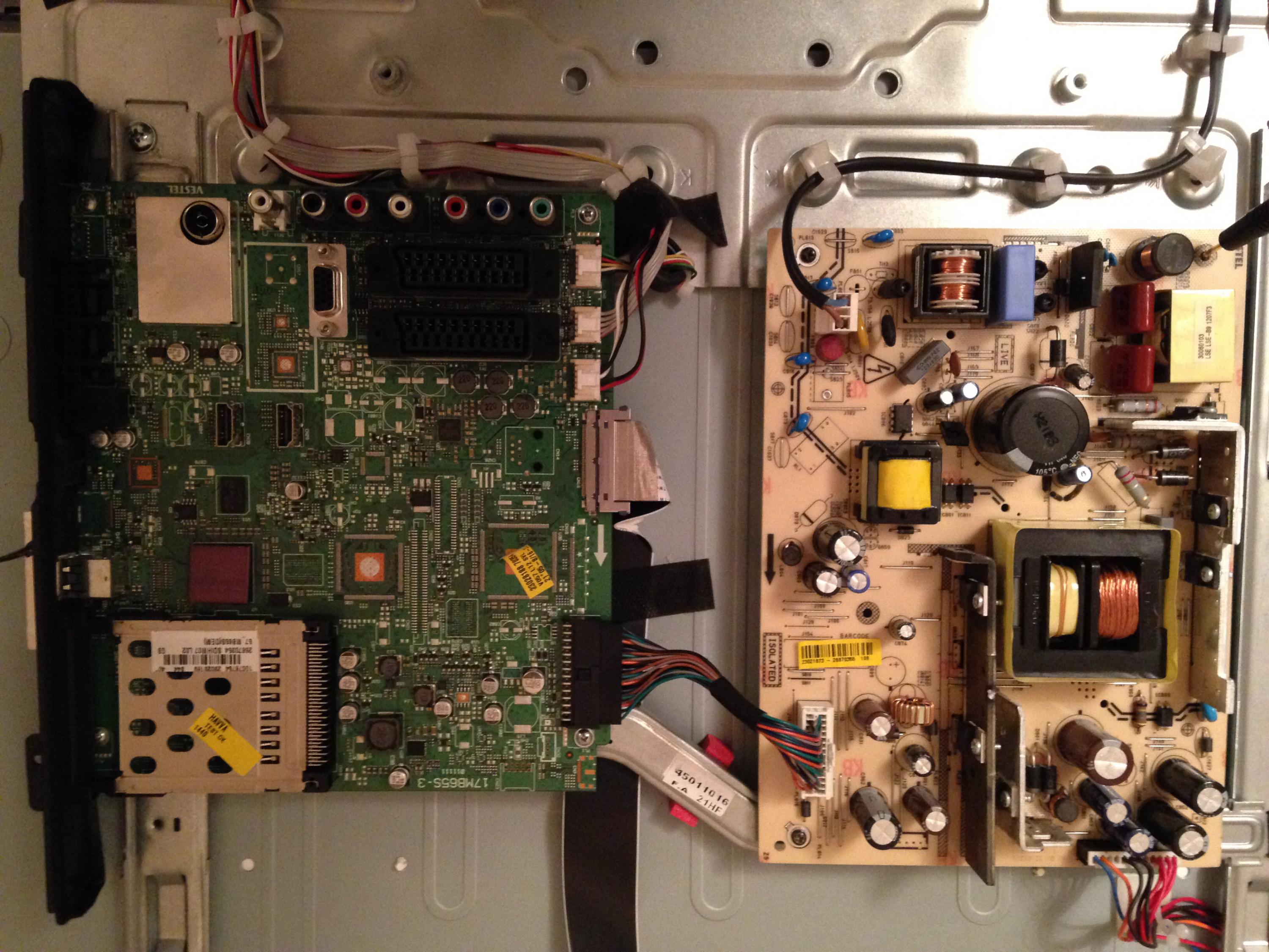

    Having trouble with pics I'm afraid.
    • Daveatfernie
      • Nov 2013
      • 70
      Re: Polaroid P40LCD12
      Other pic.

          Have you checked voltages on the psu 24v,12v,5v etc ?
          • Daveatfernie
            • Nov 2013
            • 70
            Hi thanks for the reply,
            I've checked and found 5V present, What looks to be 3V3. There is no 24V but it doesn't seem to have tried to get that far. I'm thinking mainboard at the moment. There are a few voltages generated on board so I'll see if I can probe for these.
            I was interested to see if these particular Vestel boards had any known faults.
            I get a beep from the buttons on the front when pressed and there's 5V to that PCB.
            As it stands I've found the datasheet for the Boards and will try the voltage fail test points to see if it's complaining about any one in particular and will have a go at reflowing the SoC and memory chip on the off chance that it's a bad ball on the BGA. I can only hope.
            It seems that this TV may only have been £200 new so am a bit reluctant to throw 60 pounds at a new maonboard and PSU board.
            Thanks again.

                Ive only been able to find 5 and 3V3 present on the power board.

                  Basically you have to find the 5V STBY and check if that voltage is going to the main board (which I think it is). Then you have to figure out, if the STBY voltage is coming back from the main board to the power supply, which turns on all other power supply voltages, while you "turn on" the TV.
                  So in other words: The only voltage always present is 5V.

                      On the output connector I can see:
                      SW_Switch output 7.425V
                      5VSTBY 4.8V
                      3.3VSTBY 3.3V
                      and no other voltages on the board conector.
                      As far as inputs I've found the ST_BY which I assume is the power supply on connector.
                      Everything else is an output from the PSU rather than an input from what I can see.
                      (Other than BL_ON, DIM, and A/D DIM).
                      Do you think I can 470 Ohm link ST_BY to 3.3V or 5 without the mainboard connected to see if it powers the board on its own?
                      Thanks again for your reply.

                        Either next to the ribbon cable that goes from the power supply, or in the schematic diagram of the power supply... there should be a pinout indicating name and voltage.

                          I have seen power supplies were there was no writings on top, but rather on the backside of the board.
                          Sure you can jumper the power supply on, to see if power supply puts out all voltages.
                          I would do some more checks on the mainboard first, before I powered up the main board like that.

                              did you try unplugging the bl-on connector from power supply to main board, to see if back lights go on?
                              • Daveatfernie
                                • Nov 2013
                                • 70
                                Yeah, Nothing at all. With the any of the cables removed or not the PSU Never tries to power anything other than 5V and 3.3V.
                                I'm looking to buy a PSU and a mainboard but at the moment don't know which I'll need. Without testing that the PSU comes u pon it's own I can't tell.
                                David

                                    I've tried to force the Sower supply to come up without any other board plugged in by connecting the ST_BY to 5V with a 10K.
                                    I'm going to recheck the PSU board to see if I can see anything.
                                    • Daveatfernie
                                      • Nov 2013
                                      • 70
                                      I've double checked all I can (electrolytics and such) but to no avail.
                                      I'm surprised if it is the PSU board that the ST_BY would not be at 5V or similar though trying to get the power supply to fire up.
                                      I'll buy a PSU board and then a logic board.
                                      Hoping that the screen itself is in good nick after this

                                        Try to force the power supply on with a 1k Ohm resistor, if that doesn't work try just a jumper from 5V. 10k seems a bit too high.
