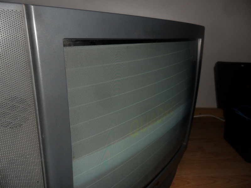

    Hello, so I have this TV with the problem that on screen are these white lines .. so i tired to look around board but everything seems okay except some bad soldering joints that was resolder but problem is still here, this is not a priority repair i just what to learn something about CRT TV's. About CRT TV's I know only basic working principle from school. So thanks guys i can post more pictures of board,electron gun and so on.
    Re: (CRT)QUADRO CTV-5525 ,Horizontal white lines problem
    This is usually caused by a fault in the circuit that blanks the electron beam during the vertical re-trace stage of the CRT scanning.

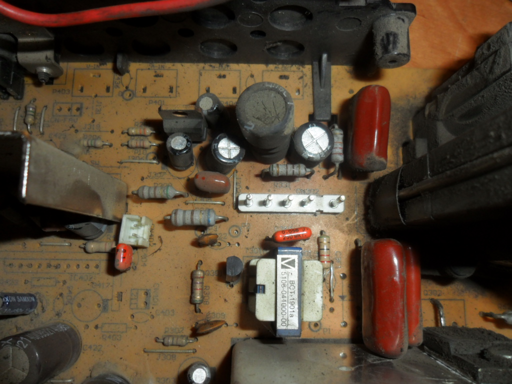

                  Look for a capacitor near the flyback or near the vertical circuit. should be a low value 2.2 3.3 10 or 22 uf at a high voltage 200, 250 volts, It won't look bad but most likely is, ther may also be a couple bad caps arount the vertical output that could be weak
                  Looks like it could be C706 1uf 250v

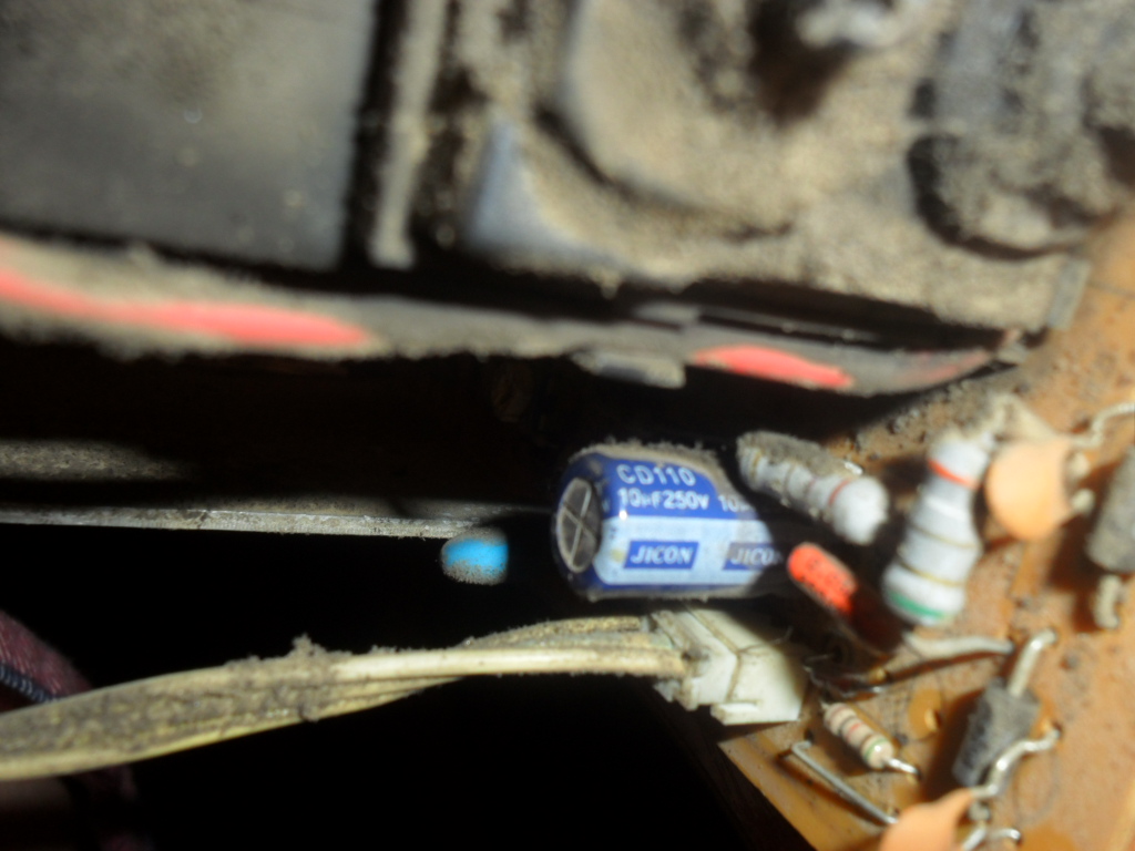

                    at the output to the electron gun board it is 10uF 250V. It is very dusty trying to clean that..

                        It looks like this might be a closer diagram, the dust won't cause the problem. on this diagram its c303

                          I change that cap, but no results still is the same screen with lines as before

                            TV works after testing resistor R322 0.68Ohm to find out that it is an open circuit , and i replaced R322 with new 0.51Ohms. It works fine.
                            Thanks guys for help
                            • R_J
                              • Jun 2012
                              • 9588
                              If that cap C303 was bad, then there may have been excesive current through d305 causing R322 to open, Bet the cap was bad I have replaced this cap. in more sets than I could count for having retrace lines in the picture.
