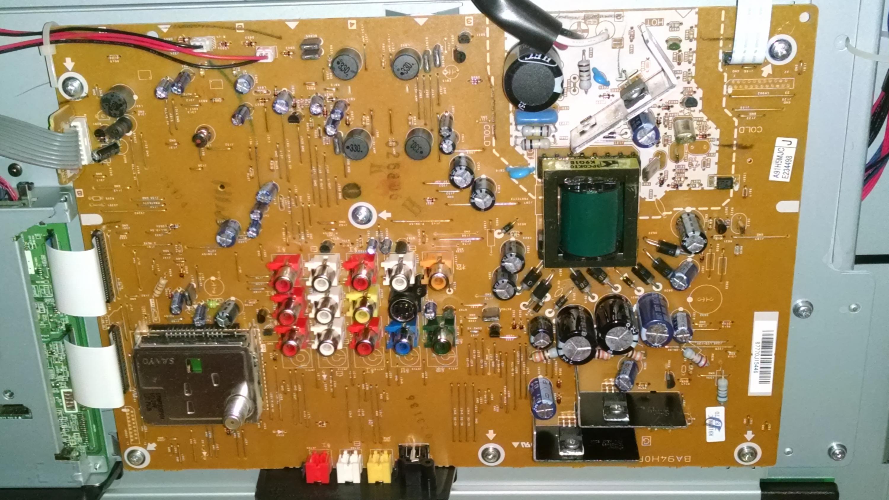

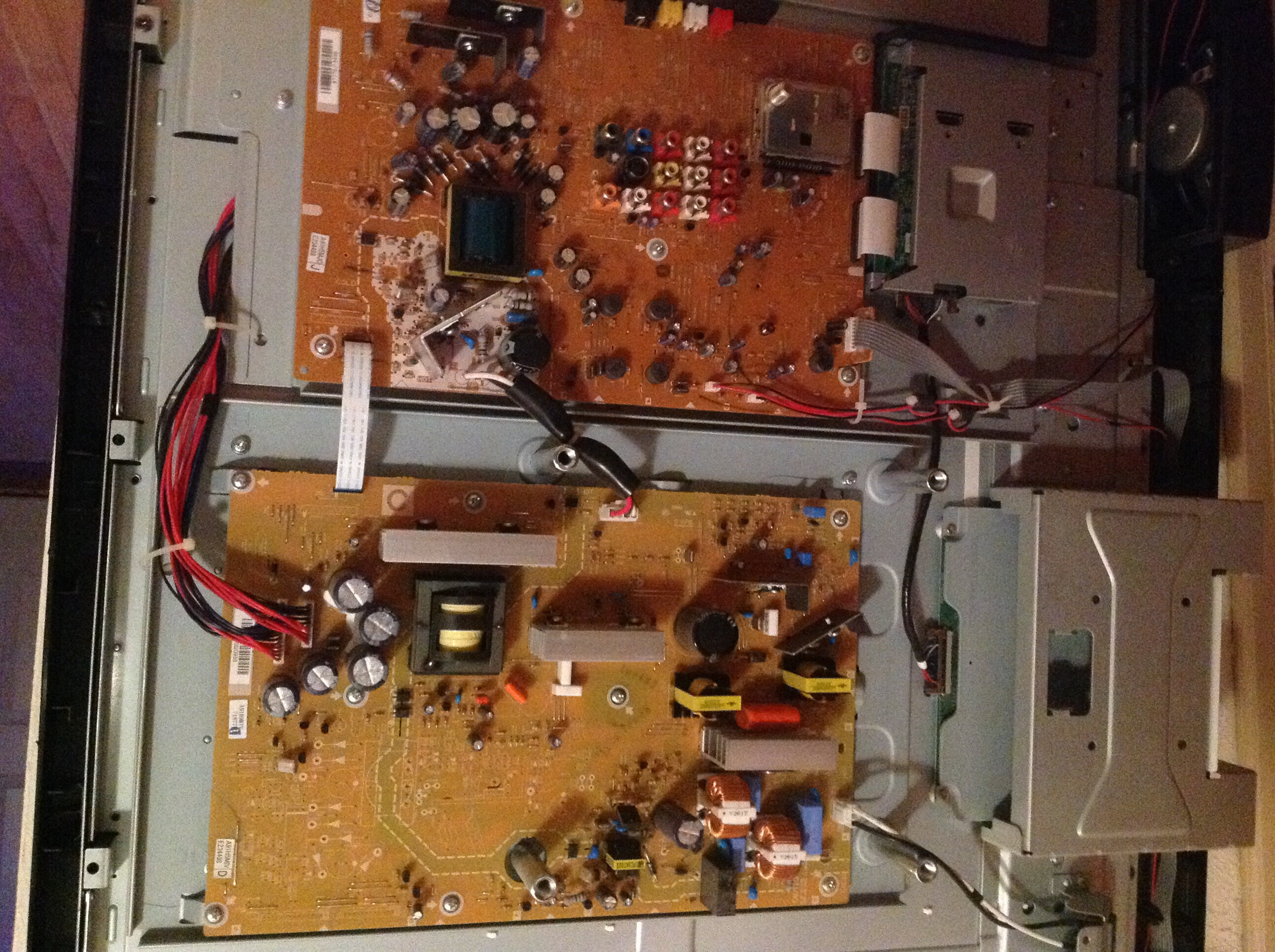

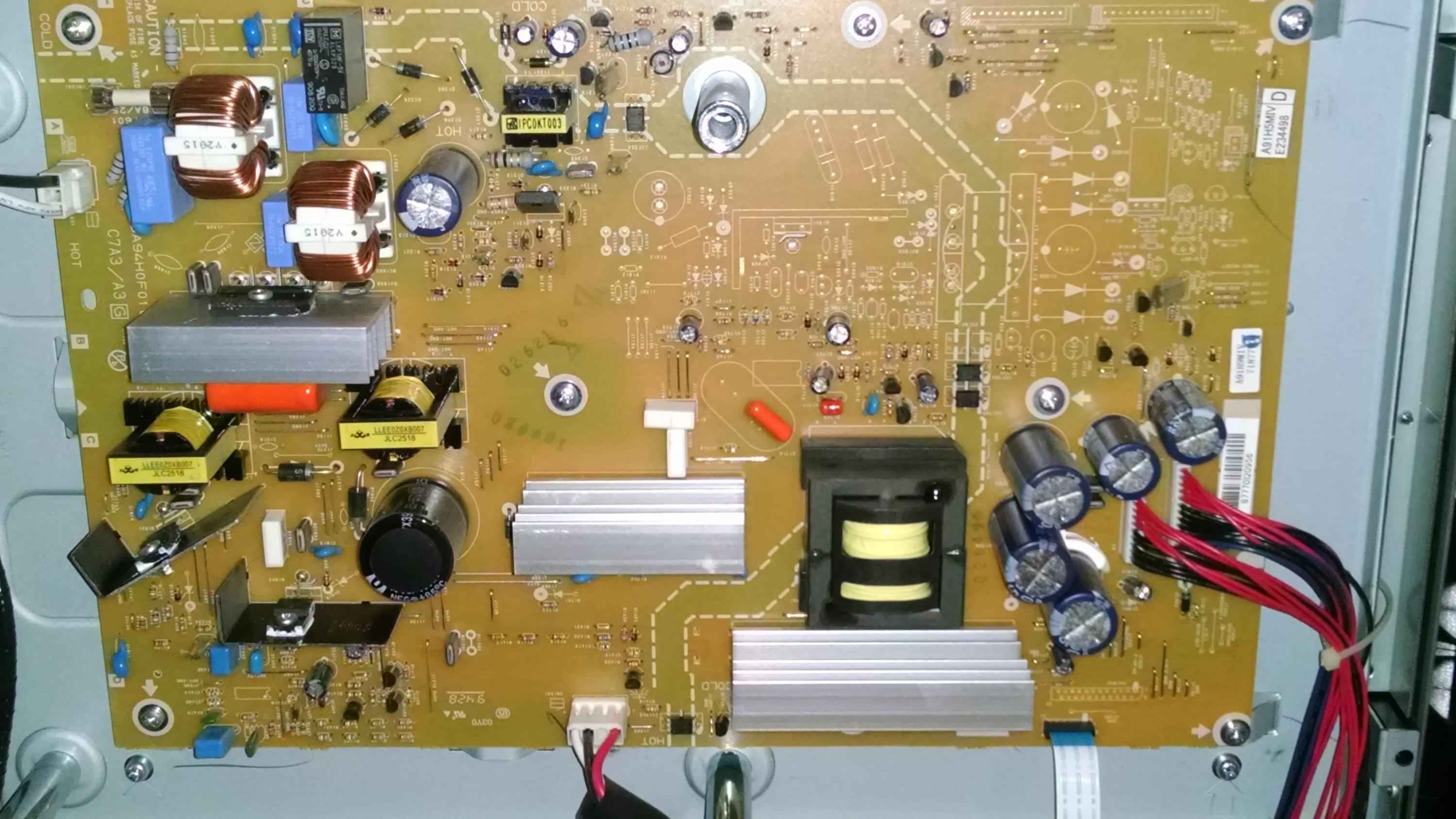

              Thanks for the replies. I attached a picture & hope it tells you a idea what may be wrong.
              • barryra
                • Aug 2013
                • 107
                Re: Phillips 42OFL3704D/F7
                I thought I better post clearer pictures.
                • barryra
                  • Aug 2013
                  • 107
                  Did the pictures give any ideas what the issue may be? Thanks

                          There doesn't look to be much info on this set. If your power supply has labels at the connectors for the expected voltage, I would prove each pin at each connector to look for that expected voltage. Personally, I suspect your main board, without knowing what the expected voltages on each pin are, I can't really help you with any guidance.

                            Please upload the pictures of the whole back side of the TV so I can see all the boards.
                            Check to see if you do have 24Vdc on any one of the red wires (black probe on the chassis) on the white connectors which should go to the inverter board.
                            https://www.badcaps.net/forum/attach...0&d=1418779596

                              try to grab a manual, if the power supply board isn't labeled with expected voltages where connectors go, if the voltages are correct, then power supply is prob. good.
