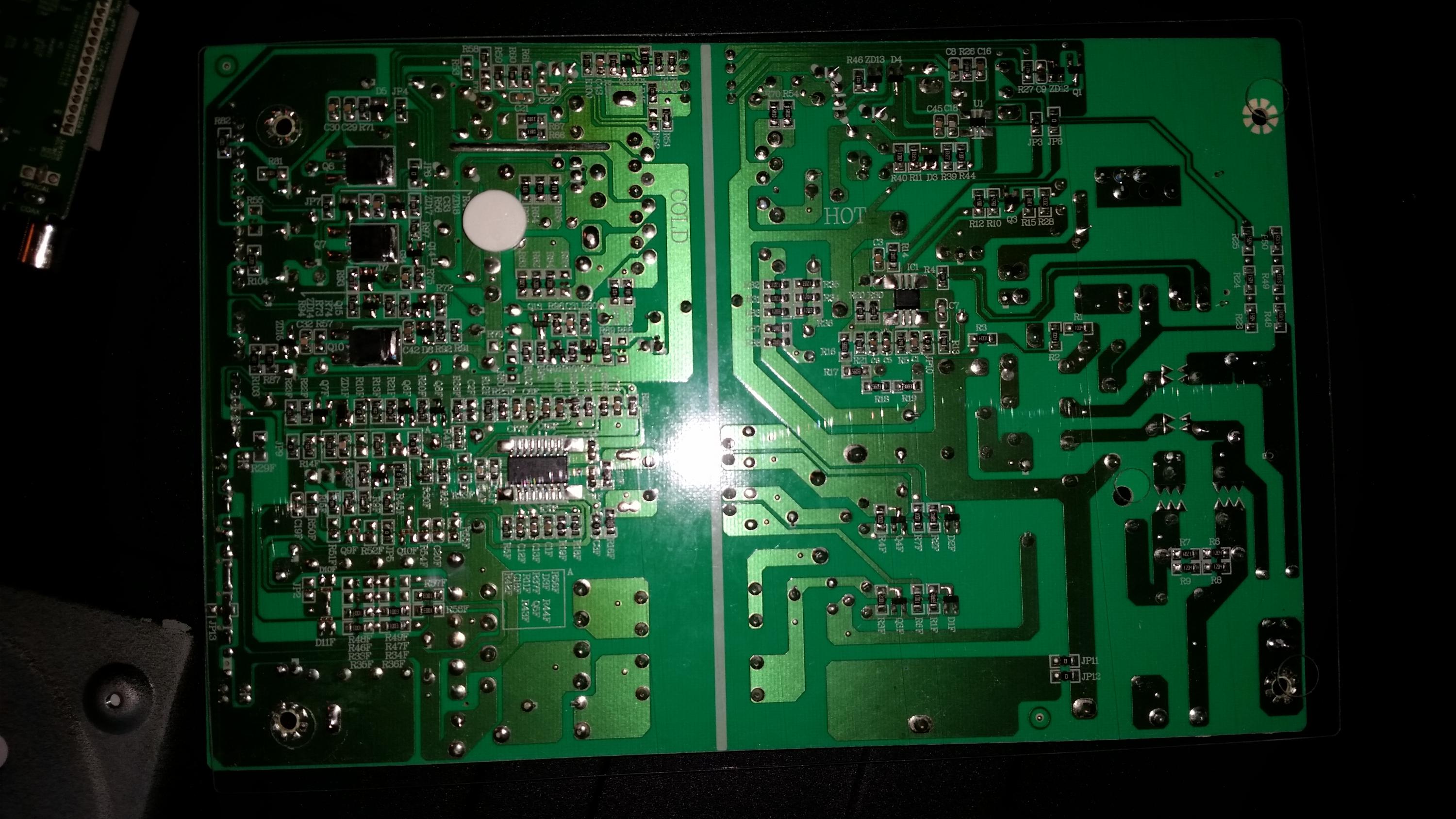

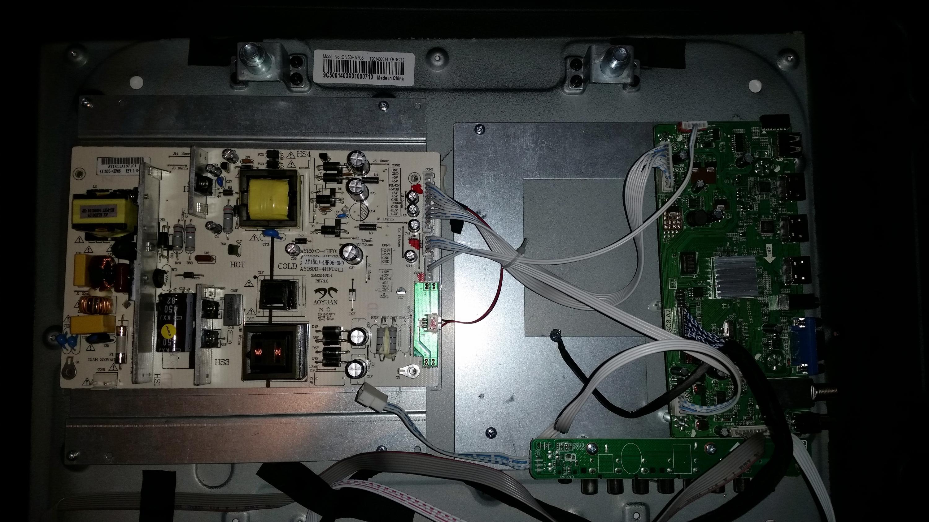

        Sorry for the extreme delay. The friend who I'm doing this for put it on hold and forgot about it. Here's where I'm at now. I still need to test voltages but here are the photos. Visually everything looks OK unless I'm missing something. Indicator lights, sound and picture is working (minus the backlights)
          Re: Sceptre X505BV-FMDR
          Please upload the pictures of the whole back side of the TV so we can see how all the boards are connected together.

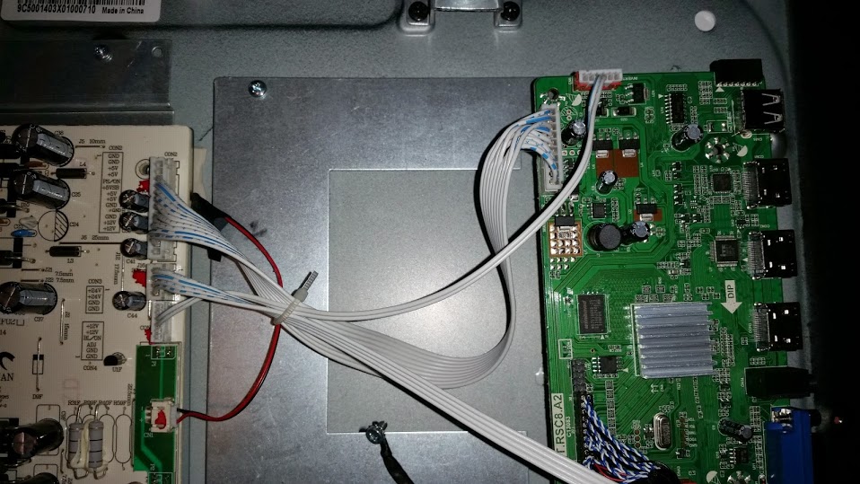

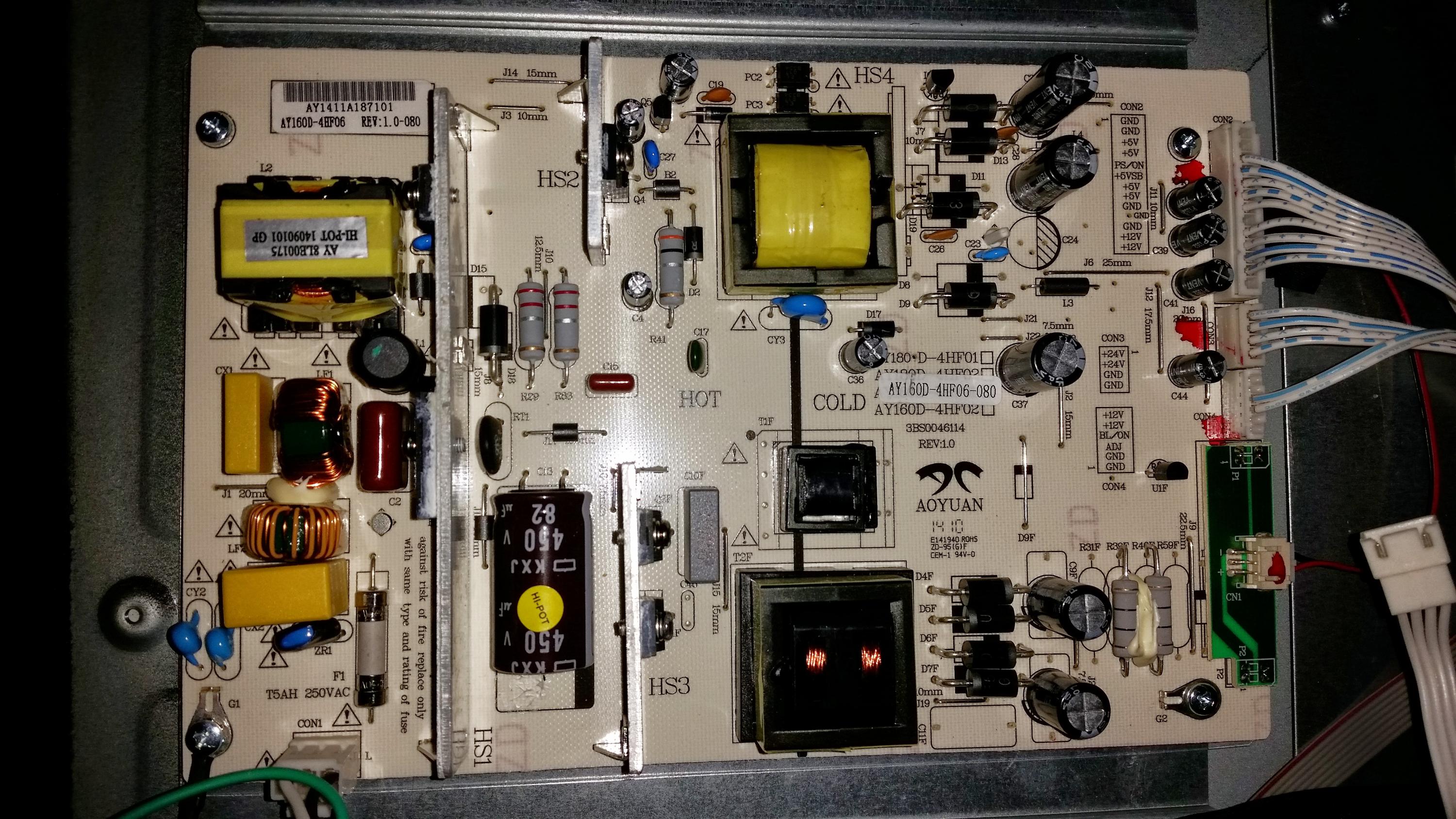

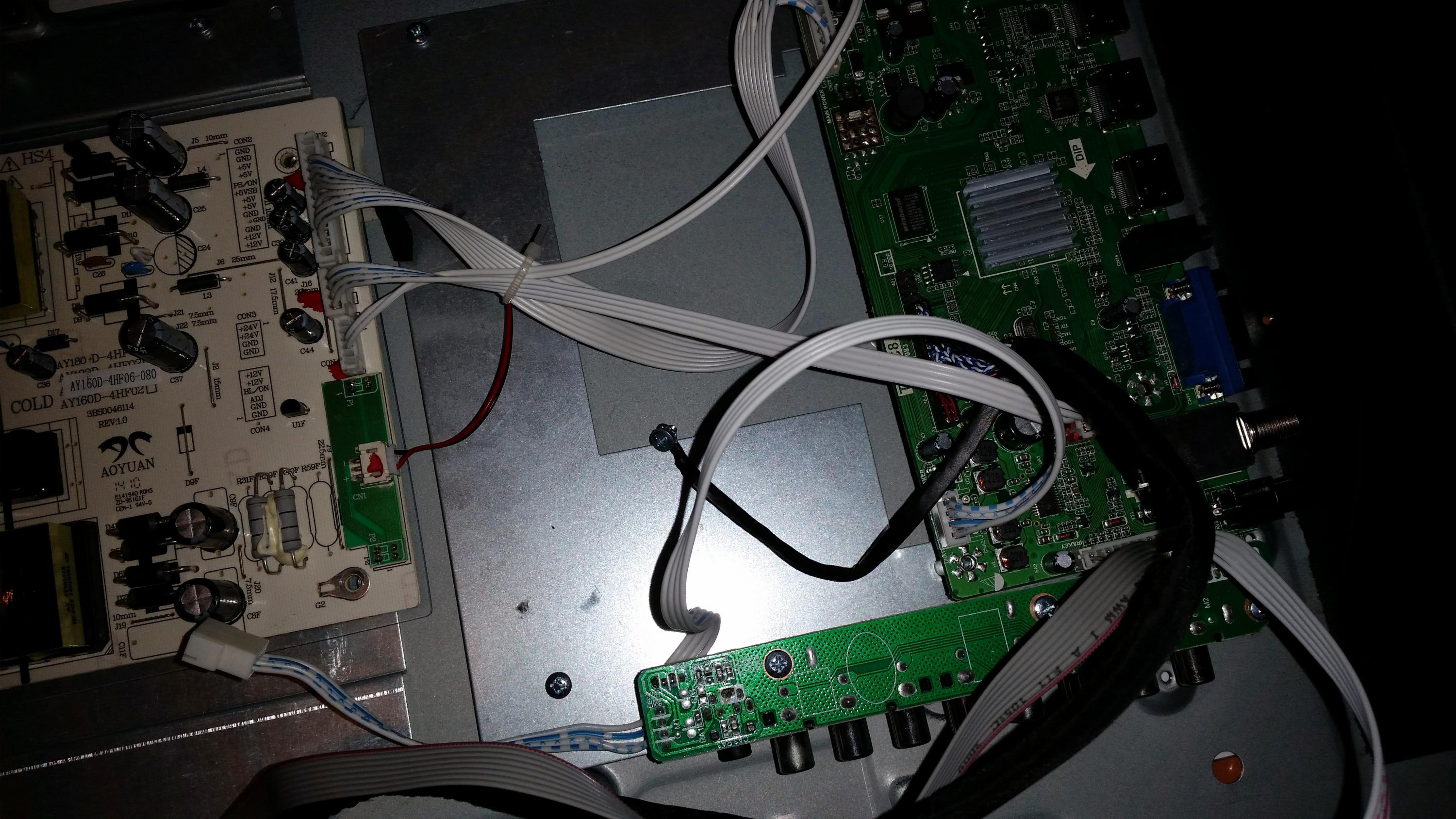

                                        And he delivered quicker than I thought! Ok. Here's the wiring.
                                        EDIT: All voltages coming off the supply are correct.
