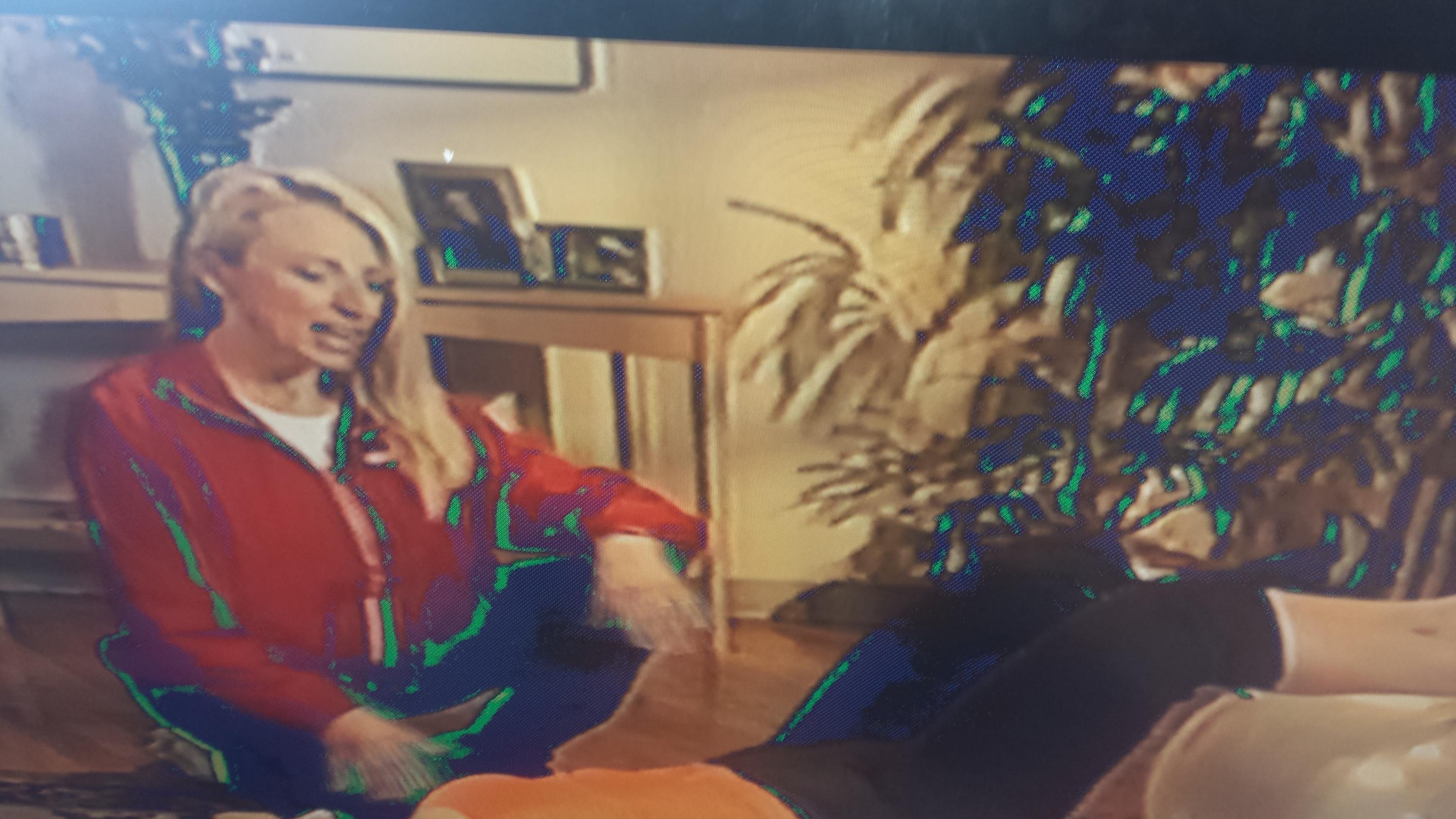

Defective Image, please see the pictures
Samsung LN40B530P7N

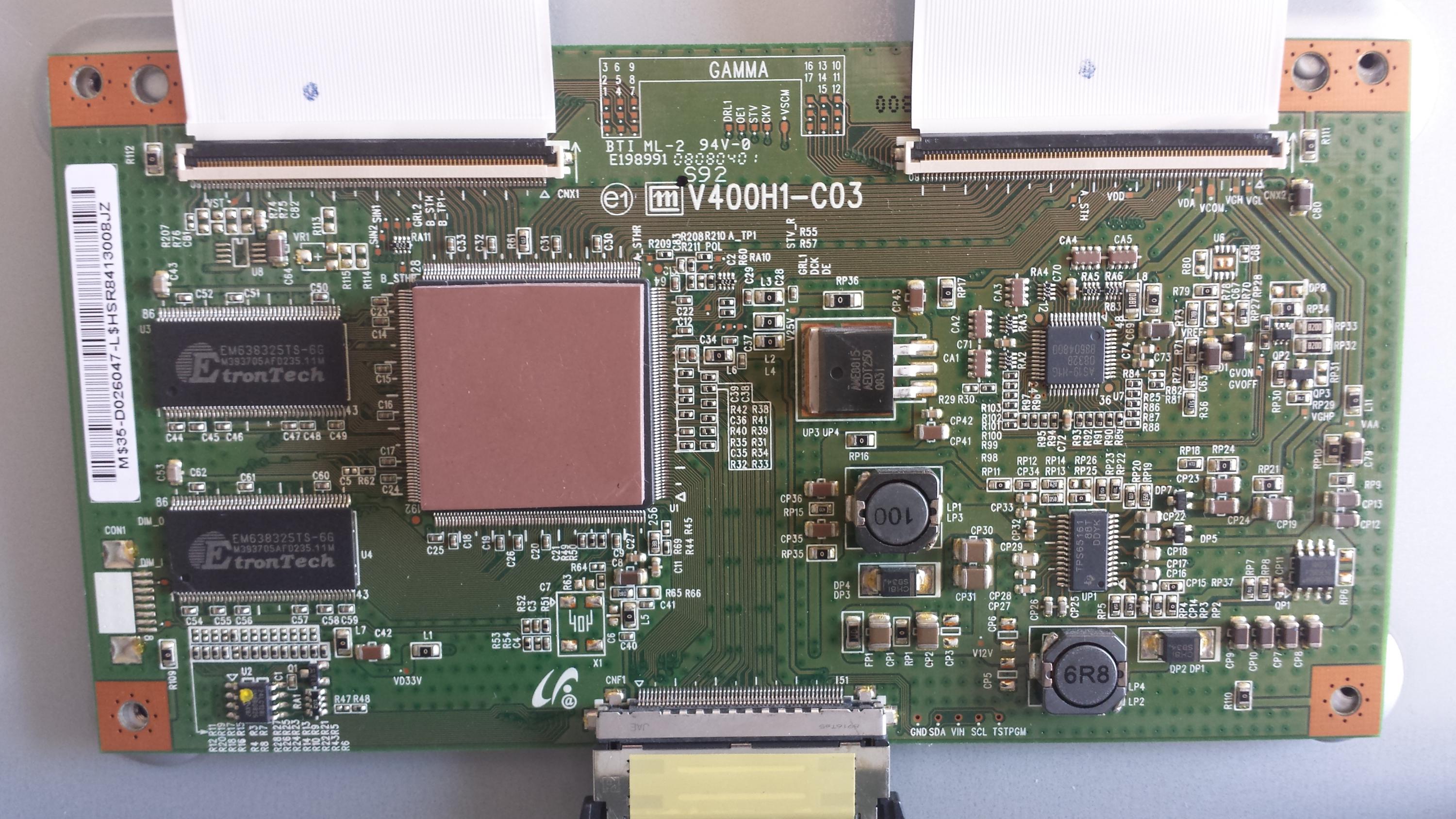

Any good clear pictures of the T-CON board?

More likely to have bad GAMMA Voltage ref IC AS19 (U7), same common failure as AS15 series IC.
You can take GAMMA DC Voltage on the test point 1~17 (Top middle section of the board) and report each reading.
Your T-CON PCBA # is 35-D026047
http://www.shopjimmy.com/catalogsear.../?q=35-D026047Never stop learning

From 1 to 8 decrease gradually from 14.95v to 9.76v, but 9 going high to 14.35v.
From 10 to 17 decrease gradually from 6.68v to 2.6vComment
Re: Samsung LN40B530P7N
Please list each one, it will easier to see the pattern, but it looks like you will need new board or send the board to SJ for repair.Never stop learning

1: 14.94, 2: 12.78, 3: 12.00, 4: 11.10,
5: 10.70, 6: 10.40, 7: 10.03, 8: 9.74,
9: 14.33, 10: 6.88, 11: 6.25, 12: 5.52,
13: 5.06, 14: 4.70, 15: 4.33, 16: 3.42,
17: 2.60.Comment
OK, thanks, time for a new board.Never stop learning
