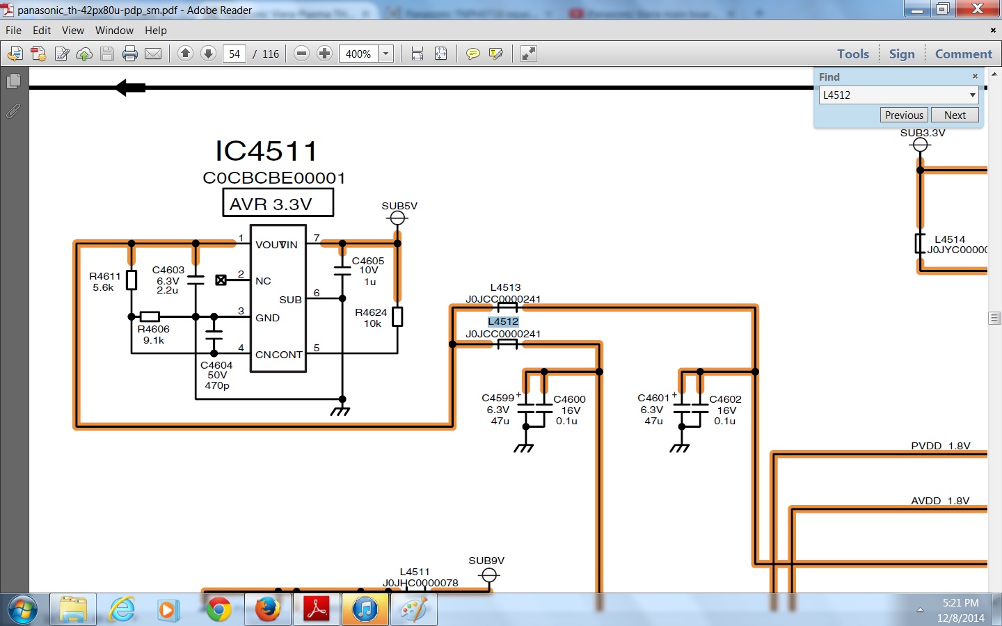

      Interesting. C4599 and C4601 both show shorted. Should I pull L4512 and L4513?

        I pulled out only the L4512, not sure what will happen if you pull both.

          I pulled L4512. C4599 is still showing shorted. No change in the symptoms except the remote powers on and off. It may have done that before though. I was going off memory when I wrote the original post.
            Re: Panasonic TNPH0716 repair, anyone know what's wrong?
            Pull off L4513 too.
            Could be bad IC4511, or shorted MLCC C4603.
            Does IC4511 get warm/hot?

                  Jhonboy1313, same thing happened to me, the C4599 will stay shorted since the short come from the IC4510 (pulling the L4512 will insulate the C4601 but not the C4599). Sorry it didn't work with you but removing the L4513 might help.

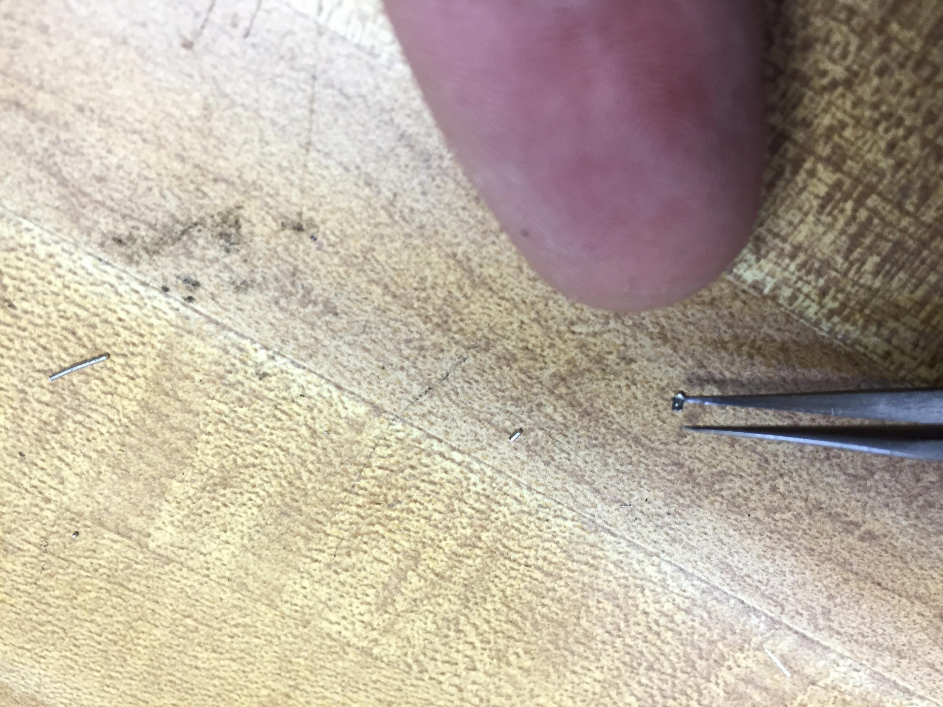

                          Yes, absolutely. I'm already planning on making a video as well. In the meantime, here's a pic of the inductor I pulled. Its stuck to the end of the tweezers. It's a big one. That's my finger for reference.

                            Does the inductor have a polarity? I should have marked it prior to pulling it but I forgot. If it gets installed backwards will it cause any problems?
                              No polarity for normal inductors. If it is a coupled type (more than two pins) then it might matter.

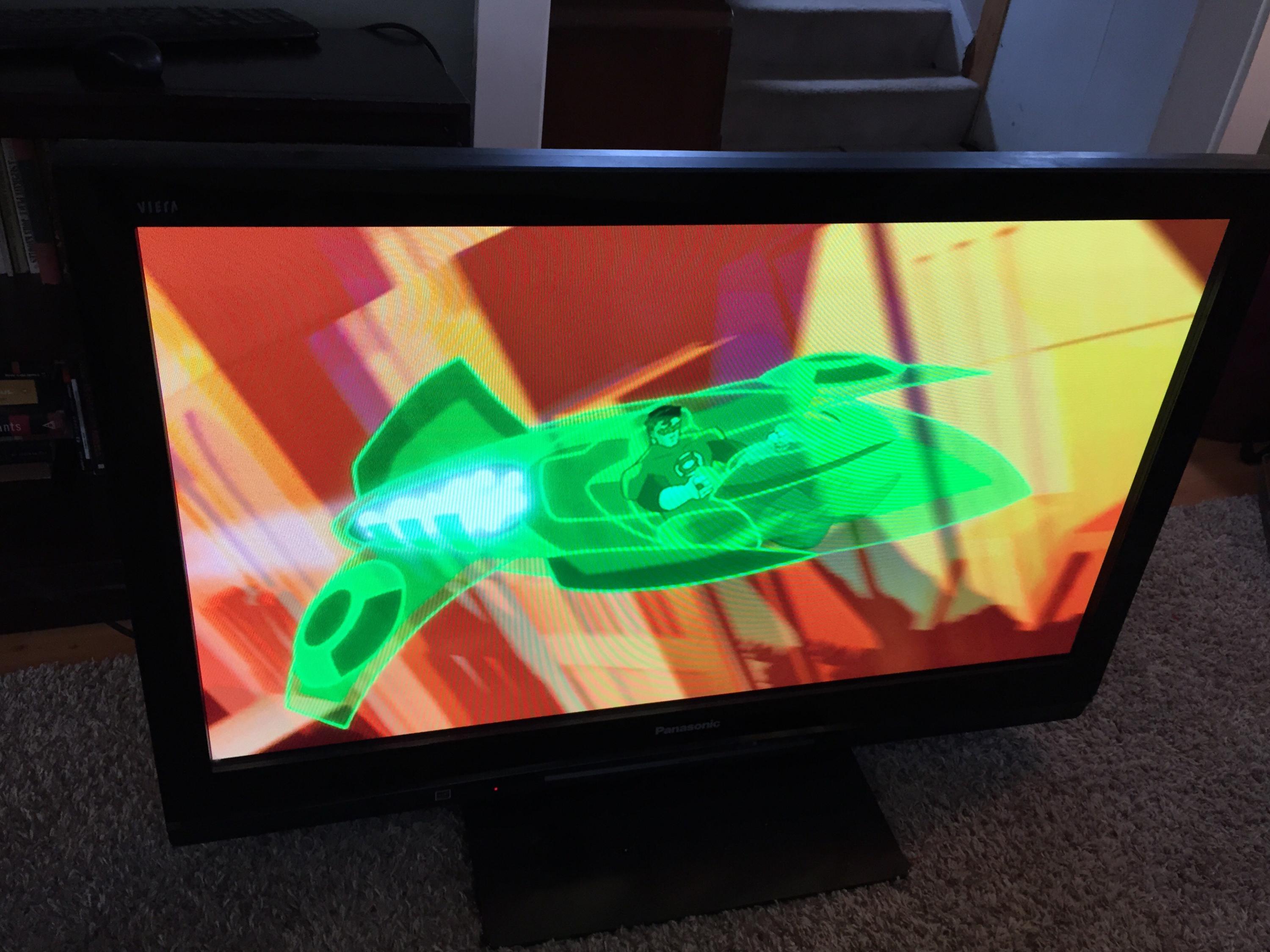

                                  The chip arrived this morning and I quickly went to work replacing it. The old chip came off with no fight whatsoever. The ChipQuik is amazing. I couldn't be happier with it. I wicked all of the pads and the new chip went on without a hitch. I put the board back in and fired it up. HDMIs 2 and 3 both work fine. HDMI 1 doesn't work. I went back and looked at the chip. None of the pins are bridged and all pins are soldered to their appropriate pads. The two caps, C4599 and C4601 are no longer shorted. At this point, I don't know if it's something I did or if HDMI 1 has a separate issue. I wonder if I didn't get that little inductor soldered on correctly, though it appears to be.
                                  Here are the pics from the IC replacement.
                                    I checked the inductor and looked at the IC again. I touched up a few pins that looked questionable. Still no HDMI 1.
