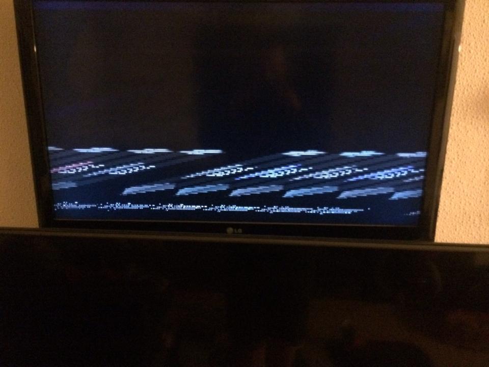

    Hi guys
    just wondering if anyone has seen this fault before i cant post pictures until tomorrow of the boards due to not picking it up until then but i can post a screen shot of the screen
    thanks
    Re: Lg 42ld490-zb
    The one thing it reminds me of is a 720p main board being installed in a 1080p TV. Since the system menu would appear inaccesible, it would be quite hard to reset (short of installing a new board)

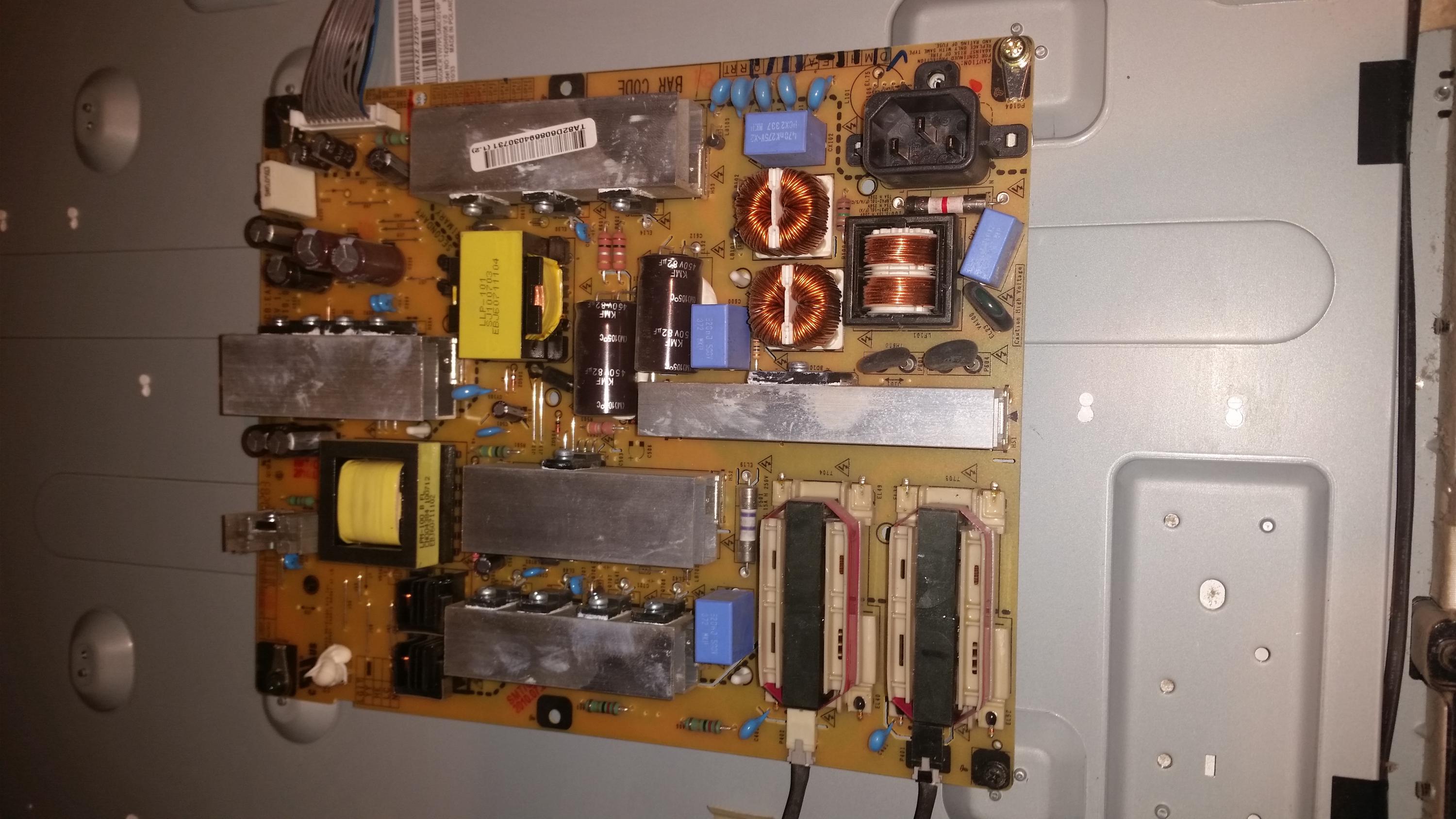

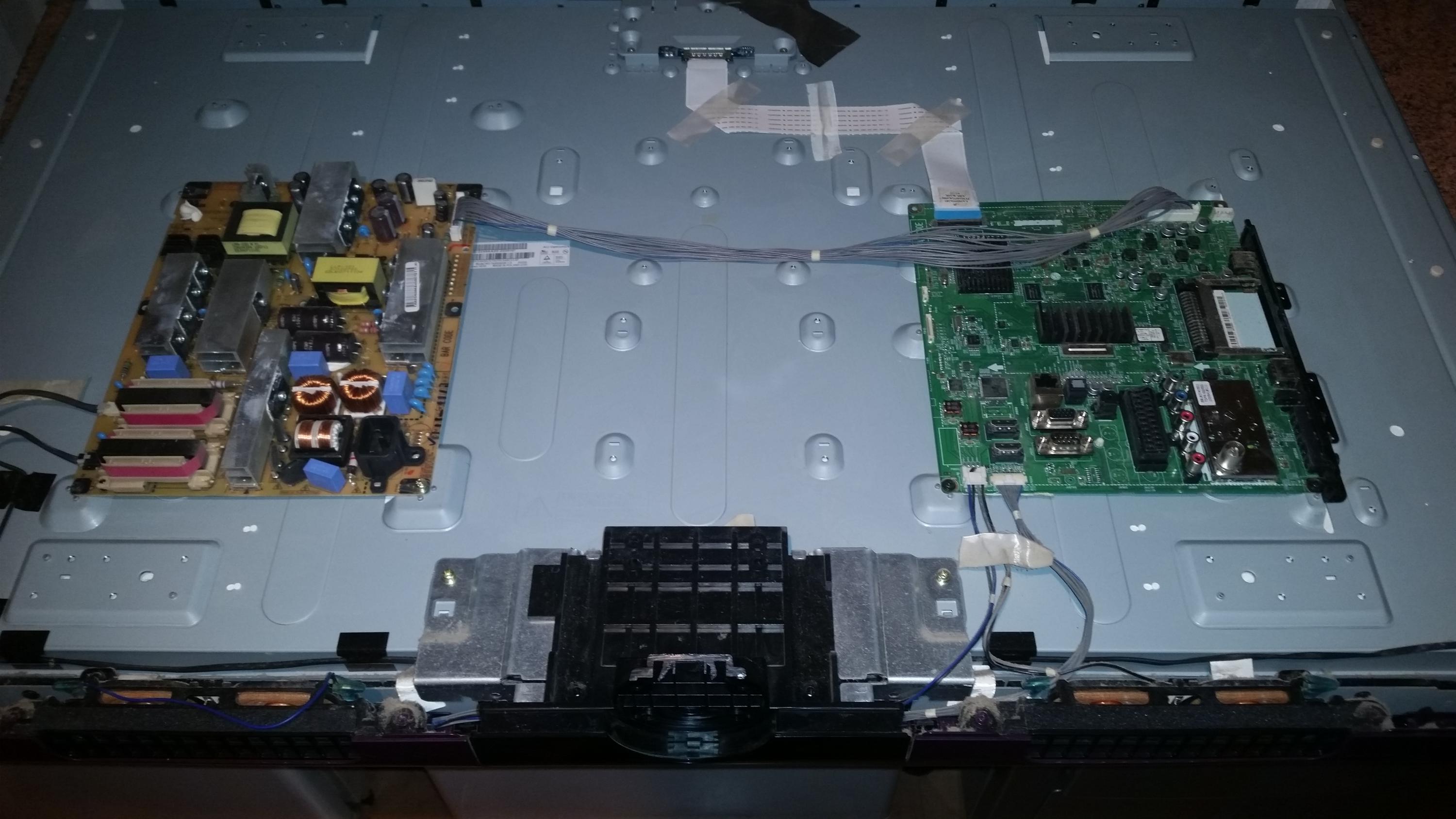

        right pictures uploaded i have tested the tcon voltages which are fine
        voltages are good as well
        NC 0.00 ERRON 0.00
        12v=12 volts P-DIM=1.0 volts
        12v=12 volts A-DIM=1.4 volts
        12v=12 volts INV ON/OFF 2.8 volts
        GND GND
        GND GND
        3.5v=3.2 volts 3.5v=3.2 volts
        GND GND
        GND GND
        20v=20.6 volts 20v=20.6 volts
        20v=20.6 volts POWER-ON 3 volts

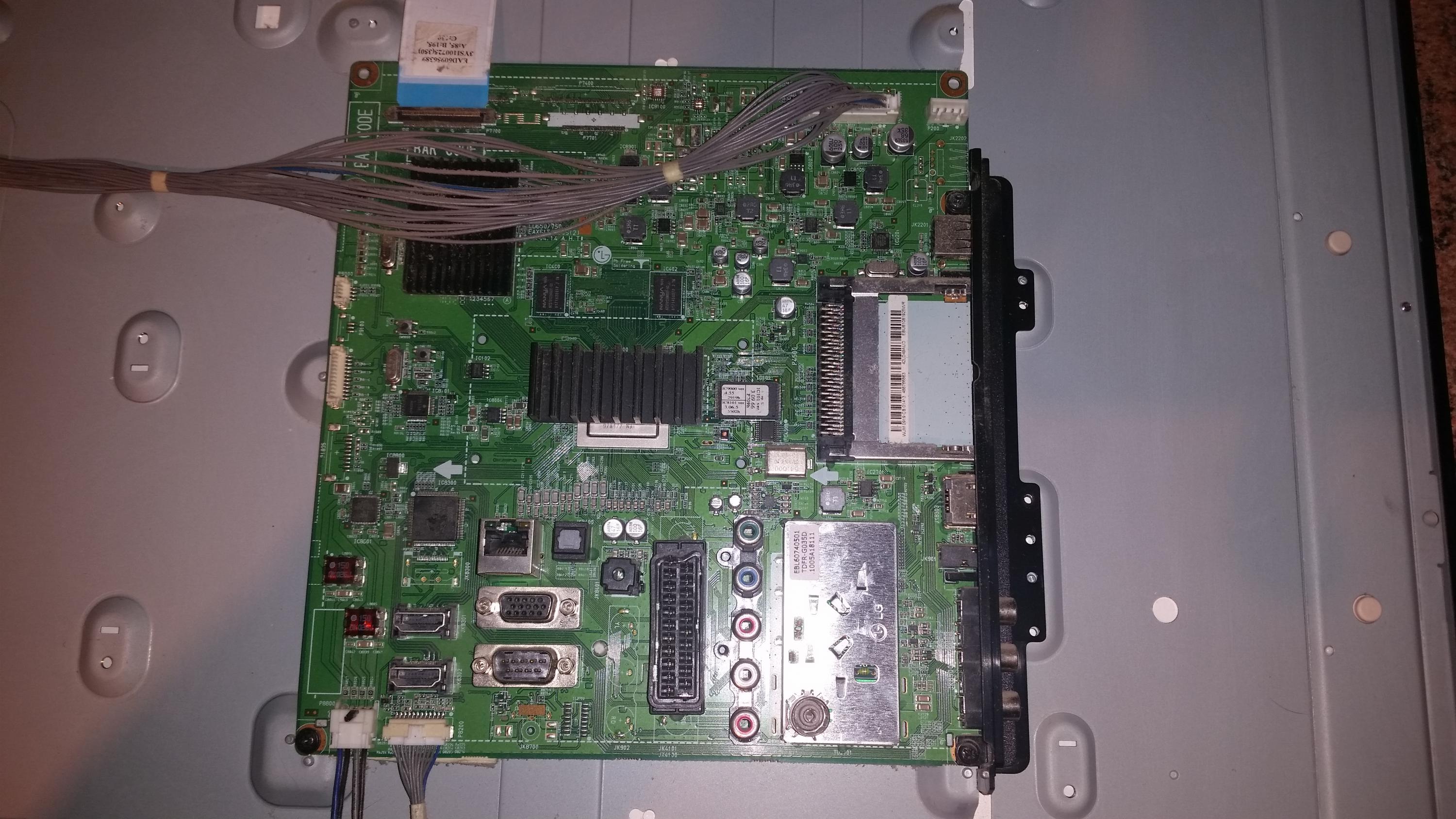

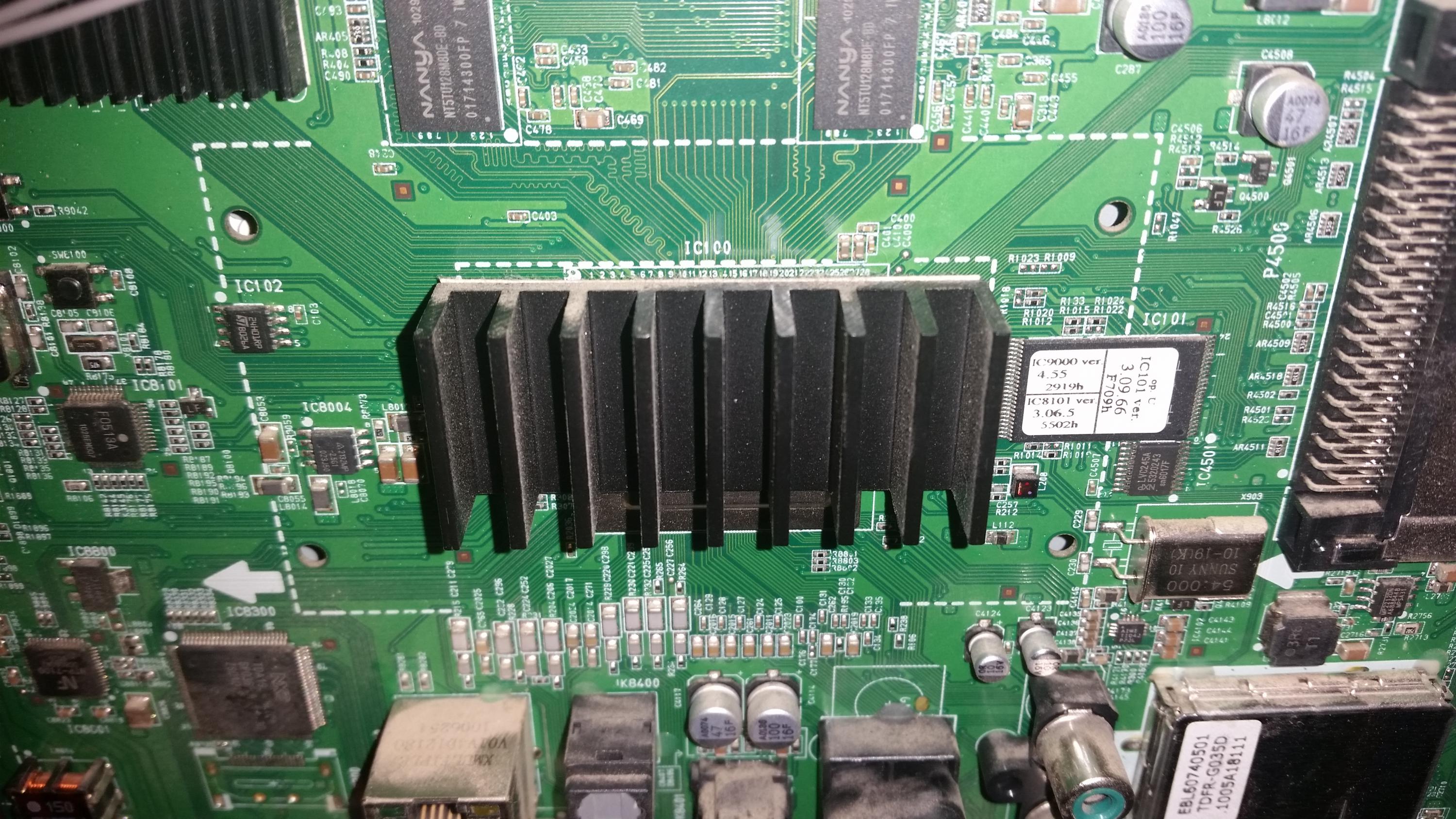

          update: if i use a hair dryer on IC100 then the image comes back it seems once warmed up
          so question easy to change ?
          struggling to find a replacement board anywhere though
          • sordids999
            • May 2013
            • 2155
            • uk
            Re: Lg 42ld490-zb
            picture uploaded
              Re: Lg 42ld490-zb
              Not at all easy to change. You could perhaps get it reballed if you know someone with the gear, similar repair to Xbox360/PS3 lights-of-death symptom.
              • freakaftr8
                • Oct 2012
                • 3743
                Re: Lg 42ld490-zb
                I've had some luck reballing and using a hot air rework station that I have. I've had hit or miss issues with the older lg 720p plasma logic boards when the blue red and green vertical bars that show up. But it's iffy. You could always try if you knew someone that had a rework station if not just buy a new board

                              So due to still not finding a mainboard for this tv i done a reflow today and the tv is now working fine,so anyone had any experience how long this will last until i find a replacement board ?
                                Re: Lg 42ld490-zb
                                I had one reflow on my graphics card last a month. Some have lasted years, others only days.
