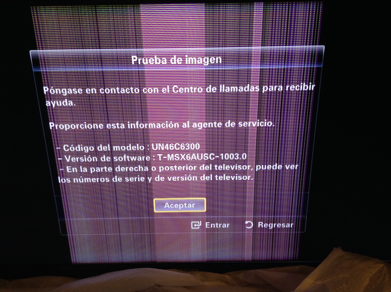

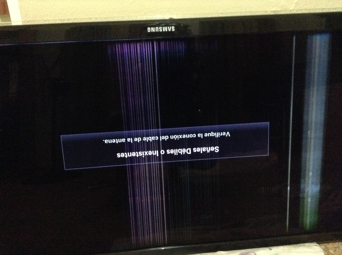

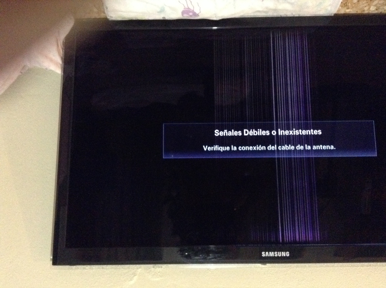

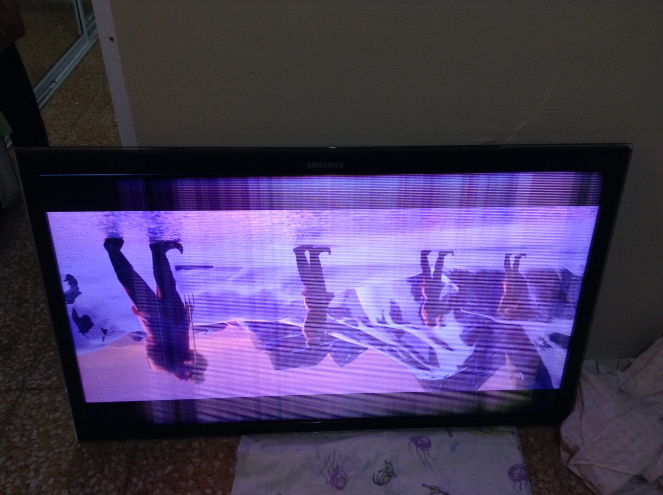

    Hi, My friend gave me a damaged tv, I wonder if the Panel or the t-con, disassemble and tighten the tab but does nothing, has vertical lines that appear and disappear in different areas of the screen.

    Re: Samsung UN46C6300 Bad Panel strange lines
    https://www.badcaps.net/forum/showth...t=42068&page=3
    Looks like the same problem I was having mainboard fault maybe
        This is almost certainly a bad LCD panel, unfortunately.
            I've an A-series Samsung doing this. Not sure on exact cause, but think it is related to VGL being too low, or VGH too low, haven't got around to fiddling with mine yet. If you set the image contrast down, does the image look better (excluding the menus)?
              Looks like Tab bond problems on the display to me. Take a look here.
                Tom answering your question, no, low contrast when the lines are more marked. when more brightness or more colored lines disappear or not noticeable, but the entire image is very poor quality like a CRT monitor. strange.

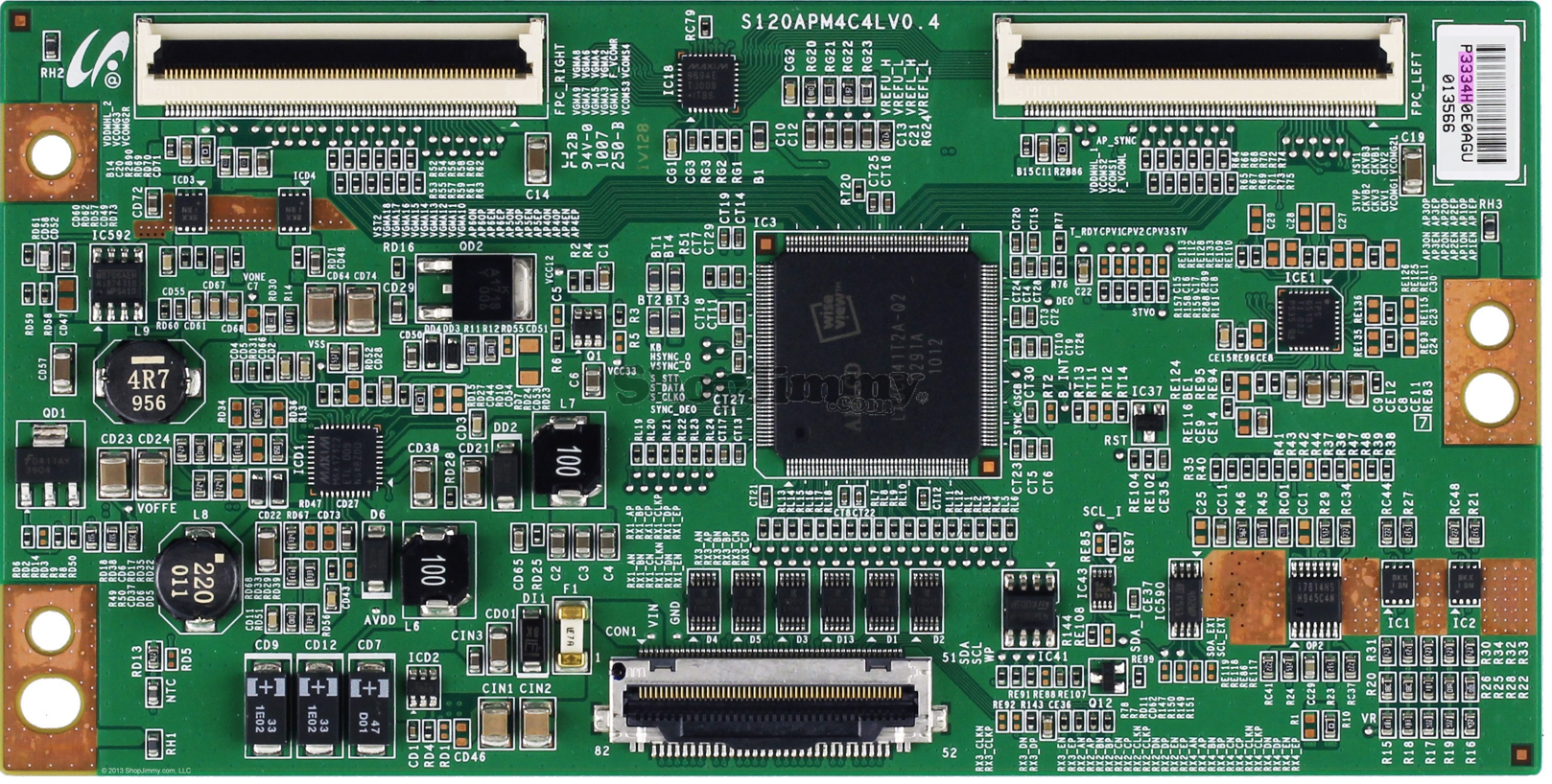

                  this is the t-con for this tv, what the test points and voltages?
                  Panasonic Viera TH-42 PX70B PLASMA-TV 42 The best TV 7 year and counting.
                    Points marked AVDD, VOFFE, VSS and VONE.
                    • piposarcade
                      • Dec 2014
                      • 17
                      • PuertoRico
                      Sorry only find VEREFU_H VEREFU_L VEREFL_H VEREFL_L and the voltages range?
                        Bottom LH corner of board.
                        AVDD ... +14 ~ +18V
                        VOFFE ... -5V ~ -10V
                        VSS ... Half of AVDD±1V
                        VONE ... +20V ~ +30V

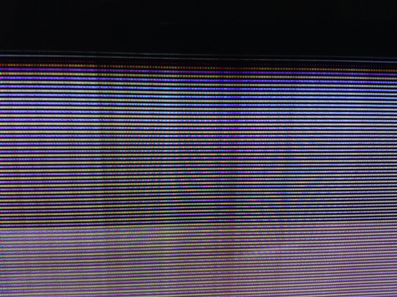

                              UPDATE** I could eliminate the fading lines, adjusting lower the sub bright in the service menu and the picture looks ok, but still very thin horizontal lines across all the screen. and the image looks like 480p low definition.
                              I found this video of how. with the same problem.
                              https://www.youtube.com/watch?v=E4S1TIgDkds
                              I have still doubts whether the screen or tcon
