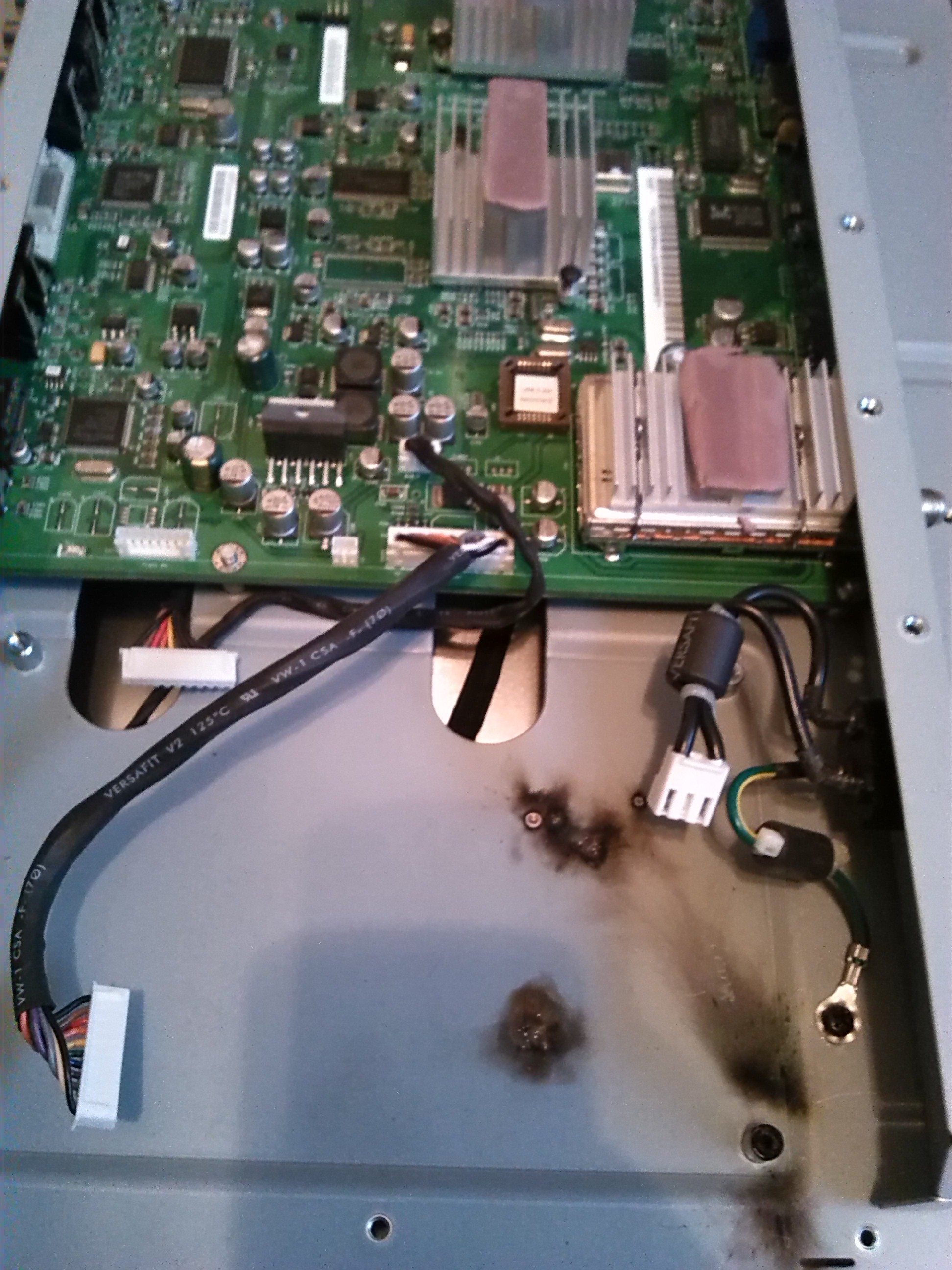

    I started to check voltages and look for cold solder joints, etc. All of a sudden, I decided to look at the power cable and it was missing the grounding lug on it. I grabbed a spare computer PSU cable and used that. The symptom changed. Now, pressing the power button would turn the backlights on for a couple seconds, and then it would turn to black. I pulled the back case to check for voltages and decided to use a flash light to see if there was something on the screen, I hit the lights and plugged it in and the power supply catastrophically failed.

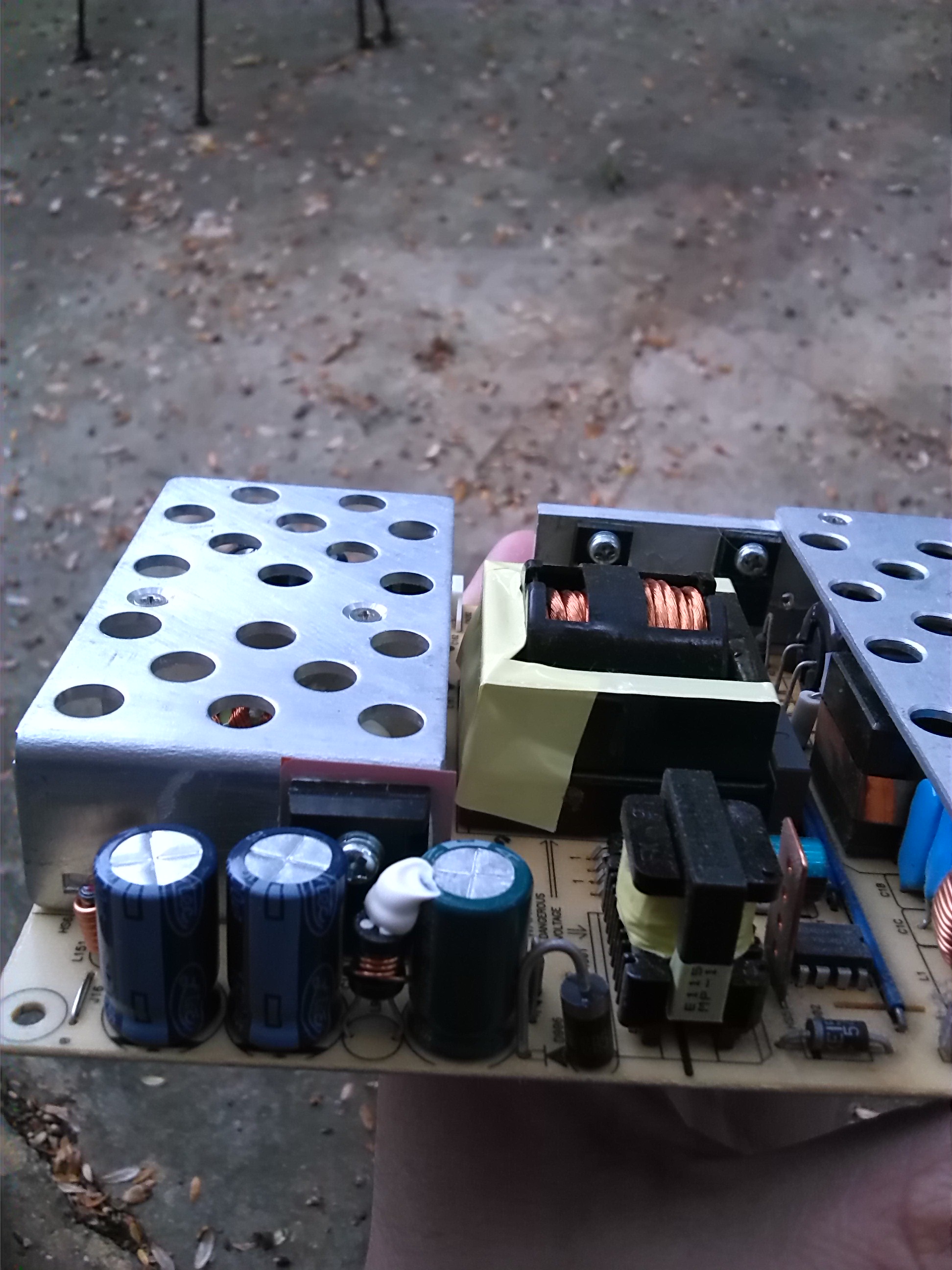

    Is it worth pursuing a repair on this unit? It seems I have two problems now. A shorted out PSU and then the original problem. Also, I am not exactly sure how safe of a TV it would be if I did repair it. It's a shame that they made these tv's with the cheapest parts possible. The screen was actually really nice for playing old school games on while I had it, and the sound was decent for what it was.

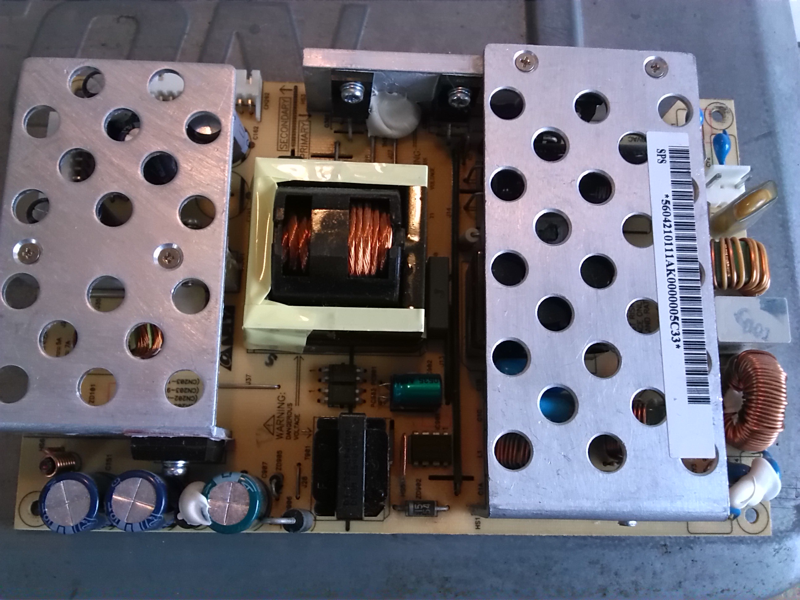

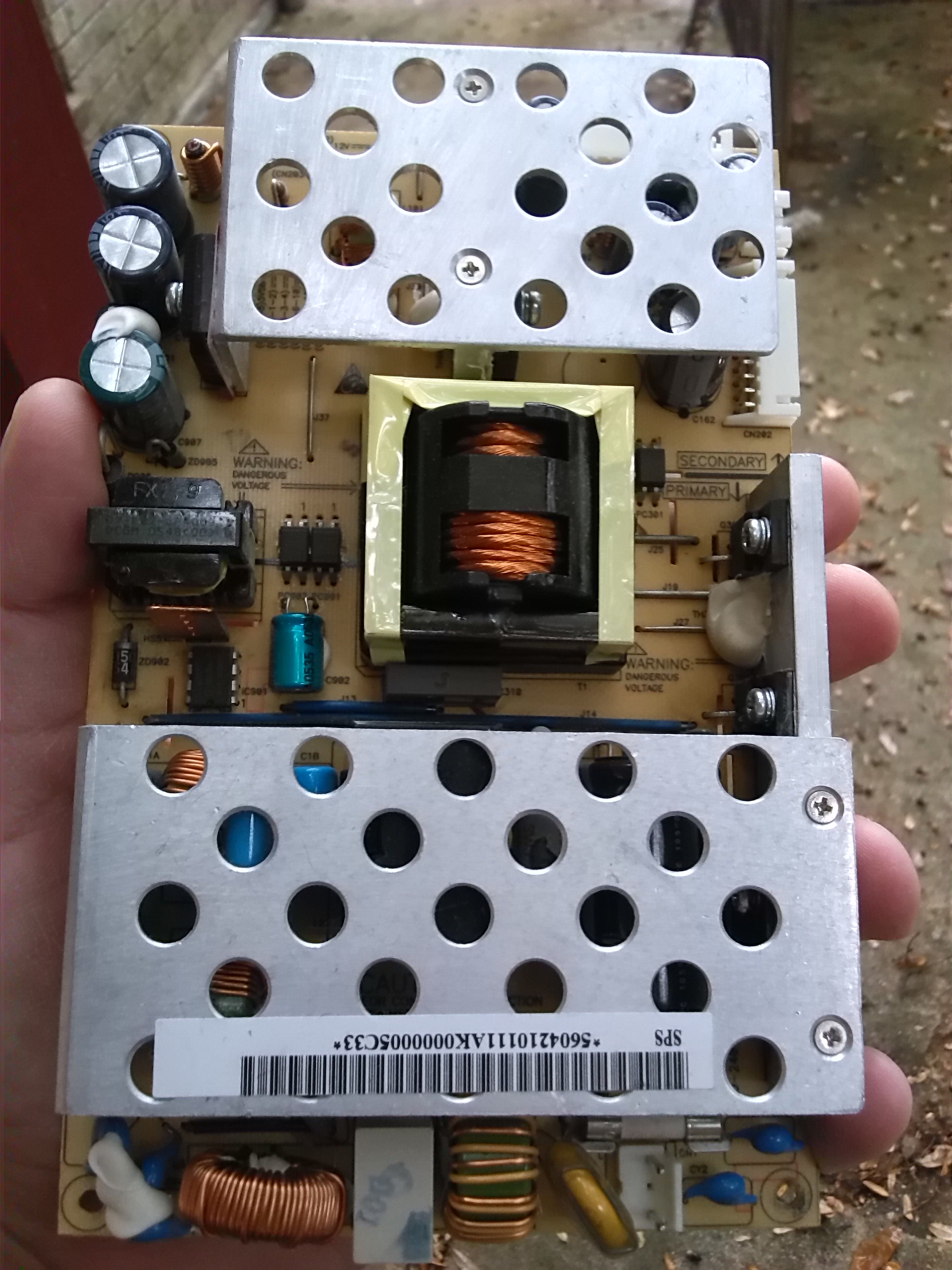

    could I have the picture of the other side to see the components on the other side
      Re: Westinghouse LTV-32W3 worth fixing? (power supply shorted)
      how much money did you get the tv for
        It's foggy today, and overcast so this is the best lighting I could get. I think I paid $40 for the TV.

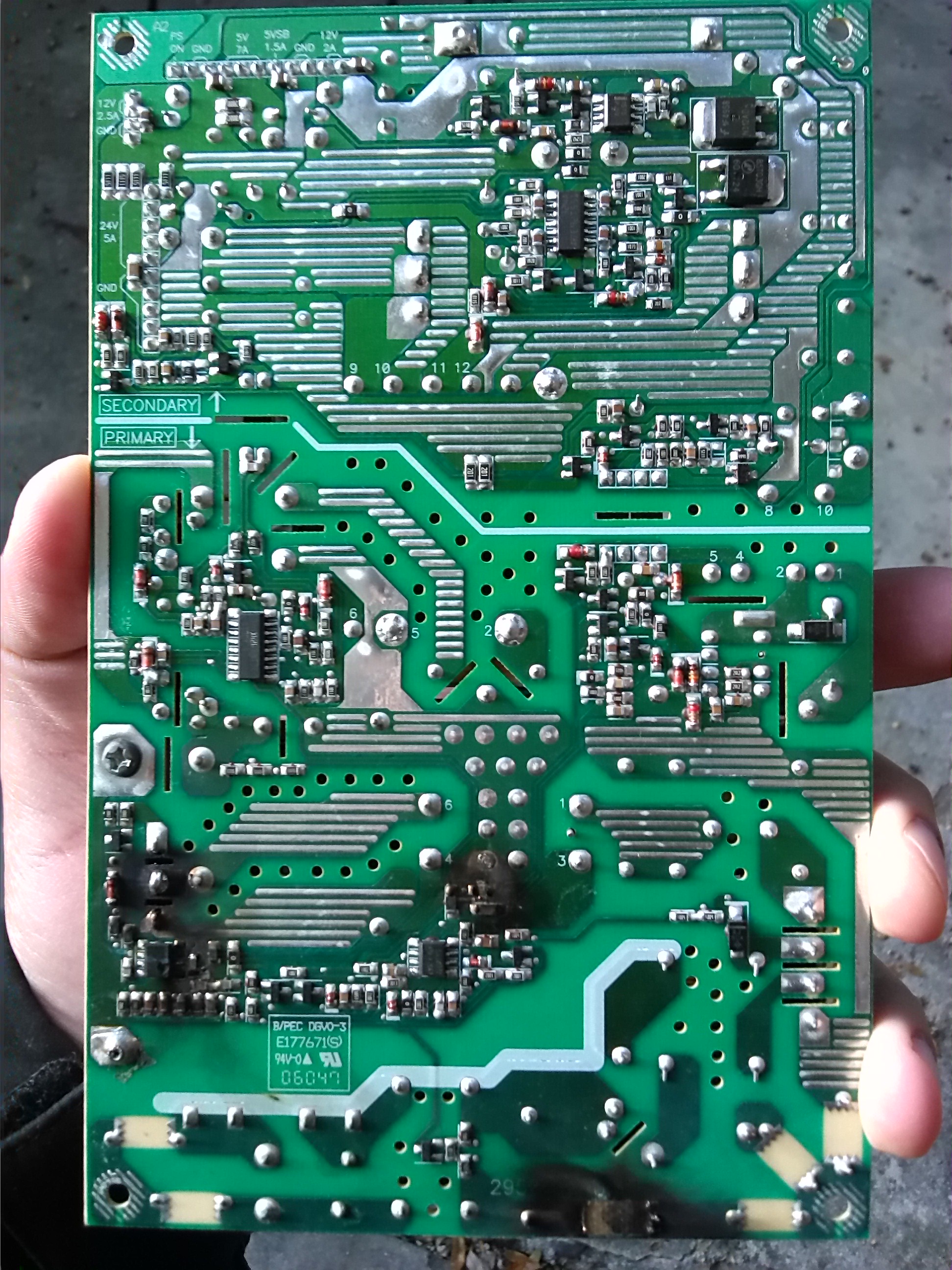

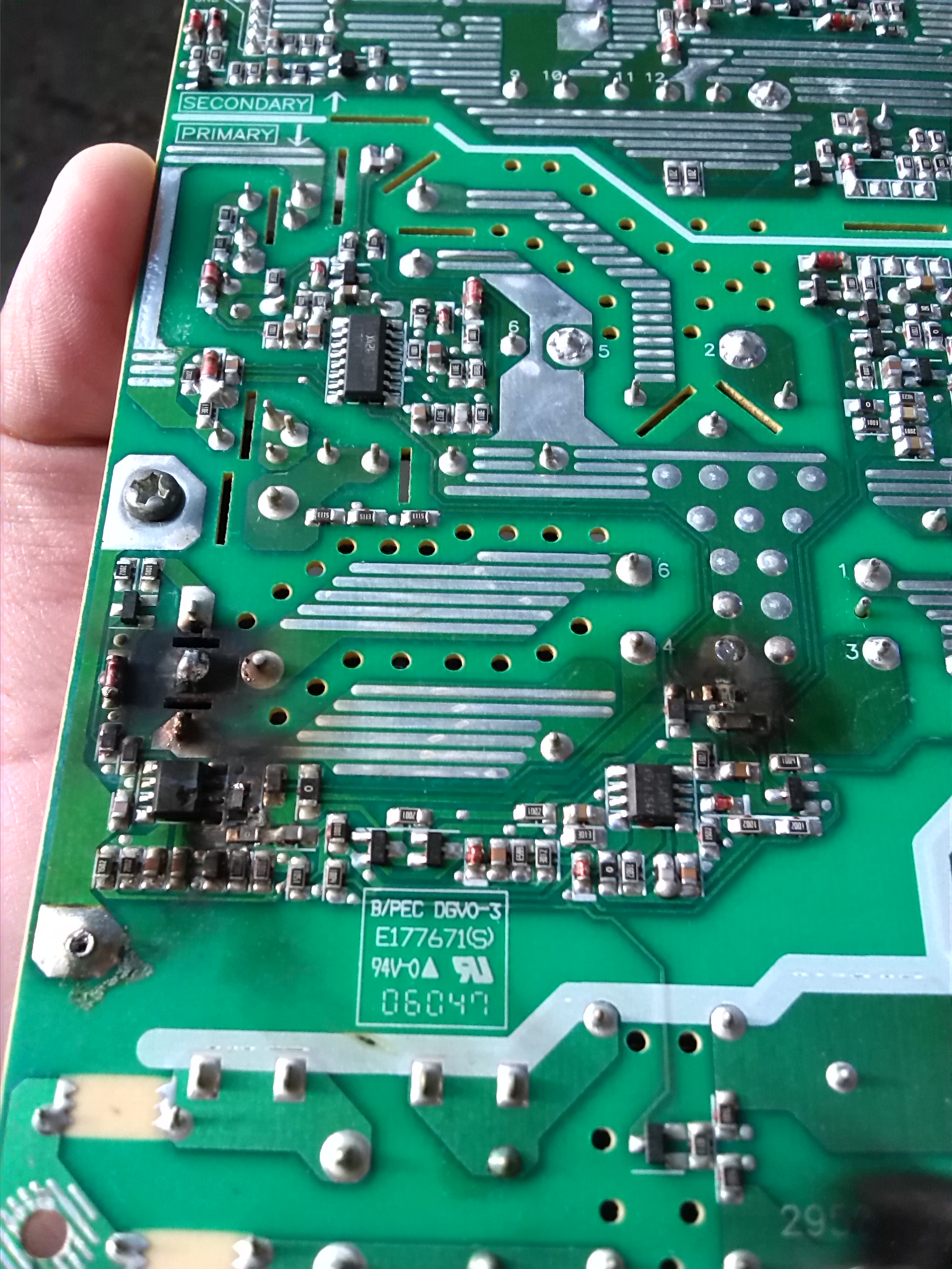

          i would replace. the PMW controller is shot (SMD IC), the switcher is probably shorted, it probably went into an overvoltage state doing so and that would kill my things to top it off.

            Oh sorry, I didn't make that clear. I would not try to resurrect the Power Supply Board. I am asking if it would be safe to install a new power supply and go from there. I think maybe when I had the board connected, I think it shorted out/arced on the standoff on the chassis.

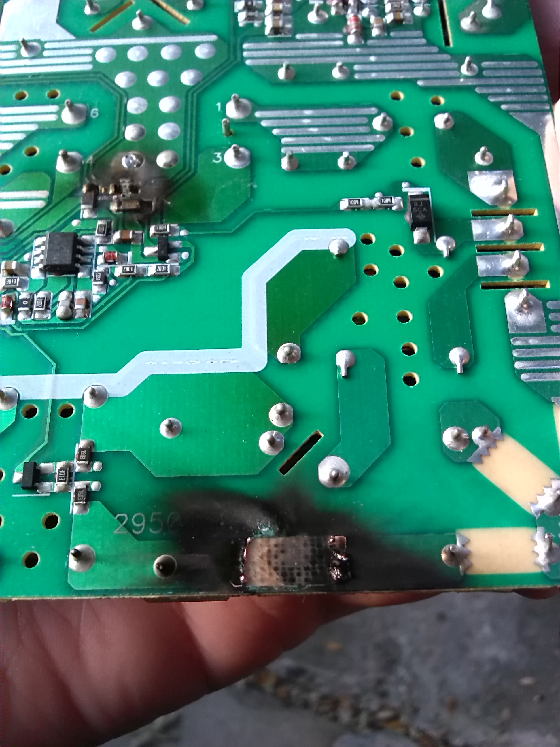

              Hmm--I'm wondering What Caused That....?
              In your fault-finding--when it went bang, Did you have the set propped up against something--or even worse resting on the PSU when you applied power...?
              Looks to me like that board was shoved up against the steel chassis--and shorted....
              Had that fault where a set owner had mounted set on the wall. Someone nudged it--whilst falling over pissed, shorted the PSU to chassis--Bang, A new PSU restored full operation....

                I think it did short out and I think it was my fault. I was turning it to shine a flashlight on the screen and the PSU wasn't secured. I didn't see it touching anything but it's possible that it still arced on a standoff.
                I think I am going to get a replacement DPS-210EP-2 on Ebay. I know there is the original problem to deal with. I cleaned off the chassis and it looks a lot better now, it doesn't look as scary.

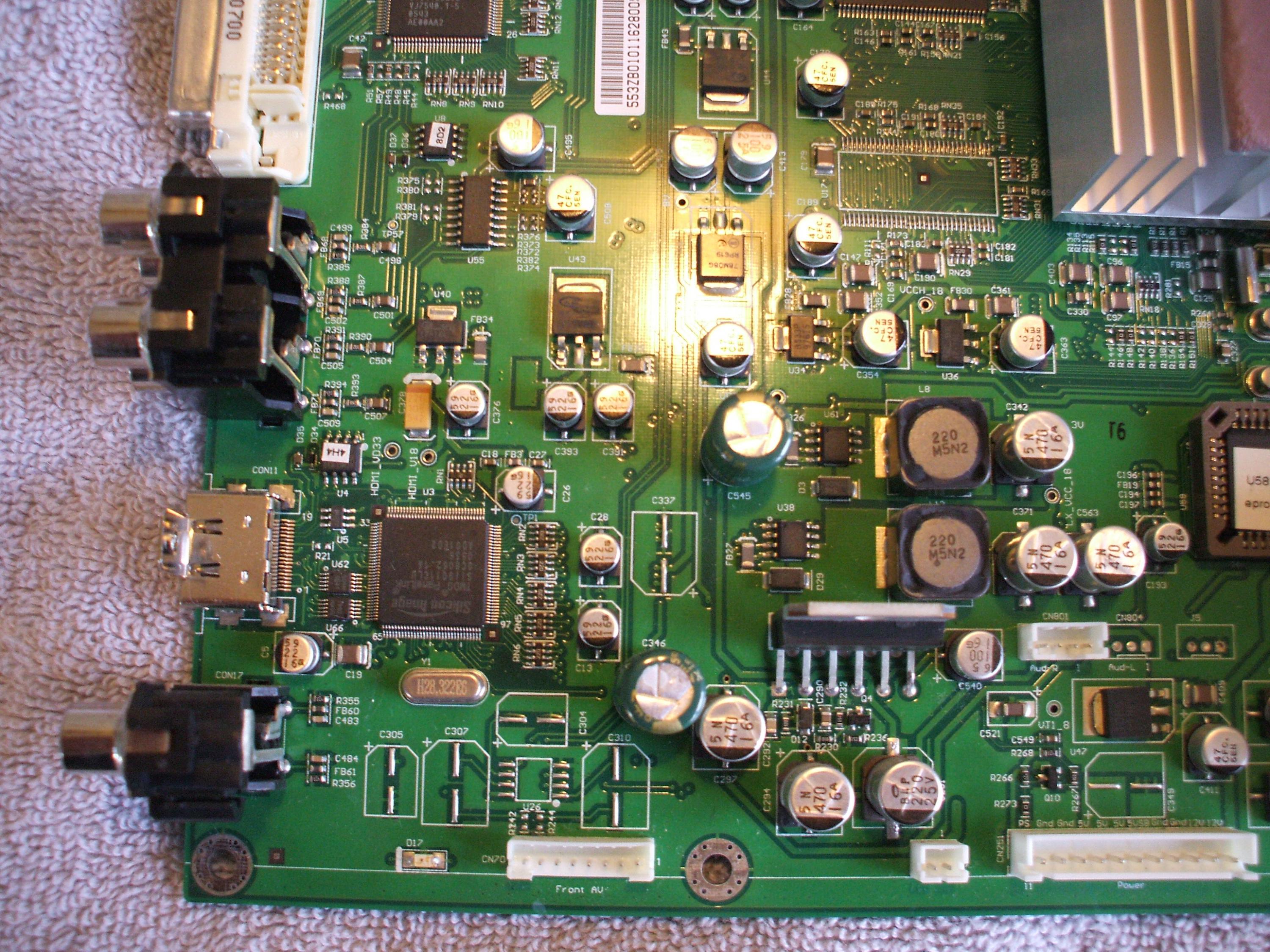

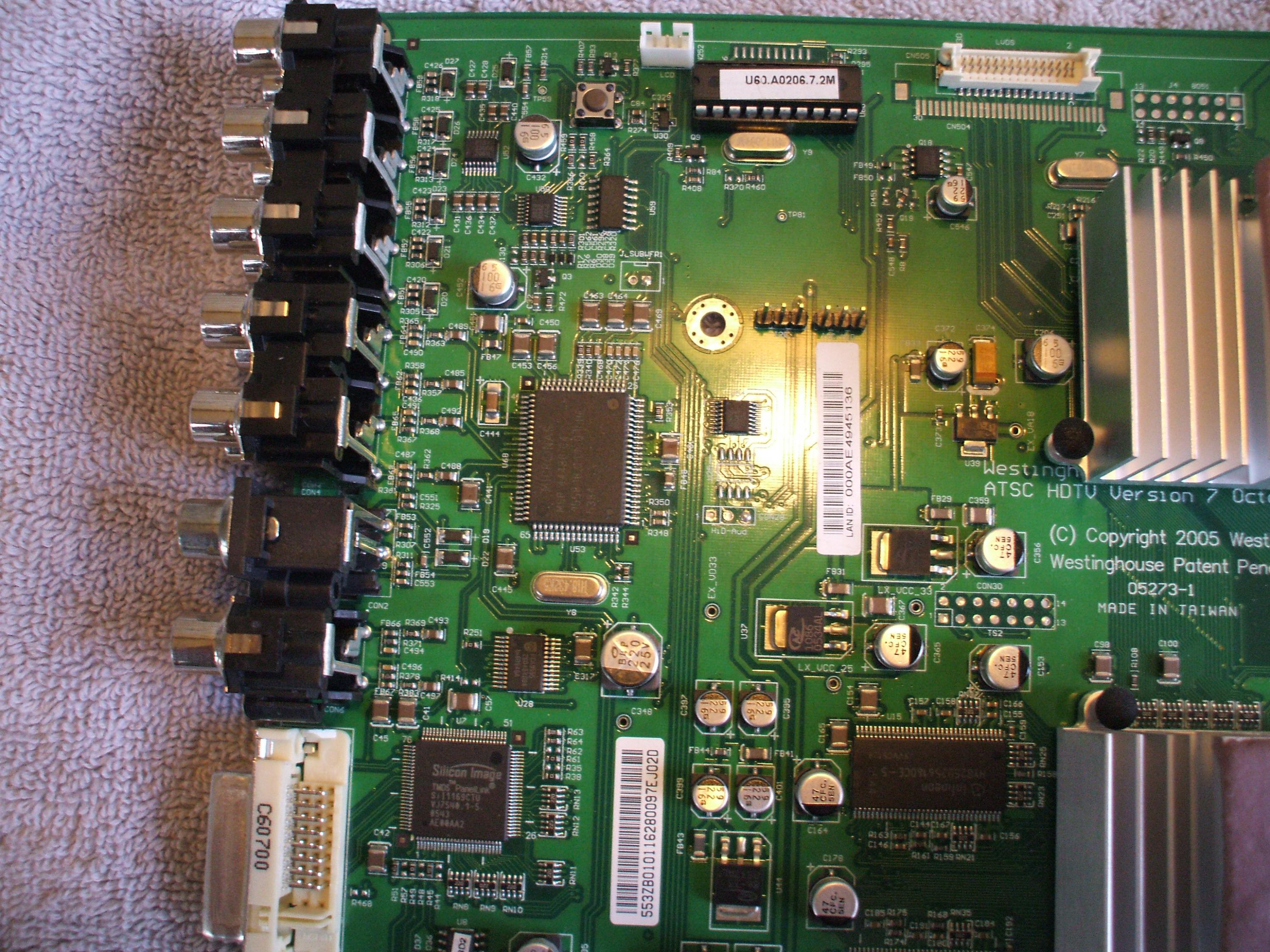

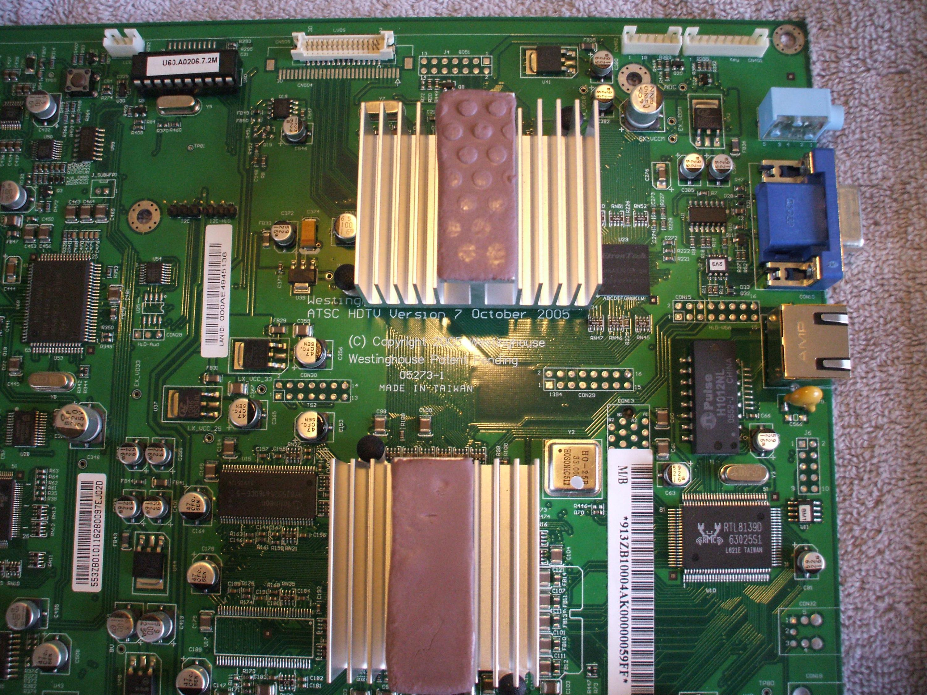

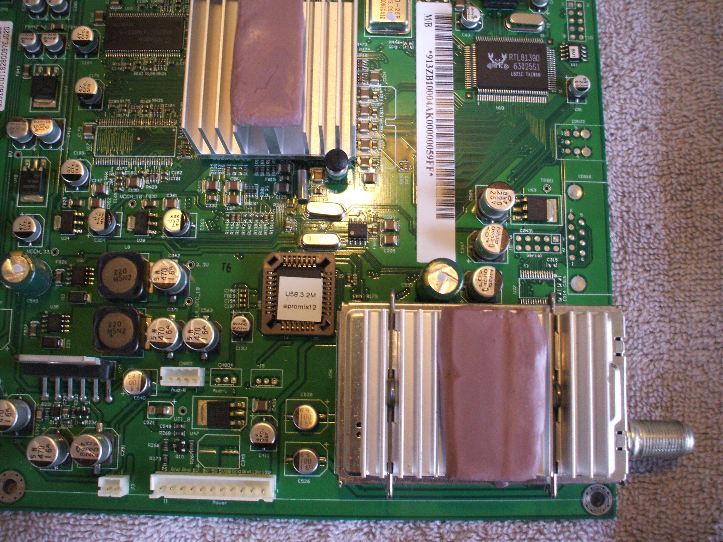

                              Here are some pics of the main board. Most of those larger SMD capacitors tested around .07-.08 ESR in circuit, using the ESR-micro v4.0s but two of them showed around .33 ESR. They are both marked B4P 220 25V.
                              I really don't see a fuse anywhere.
