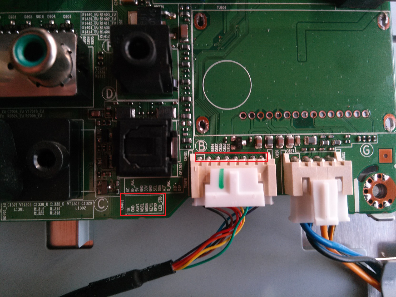

    A friend on mine brought me this set. The problem is that when the TV turns on, it starts changing channels alone, from 1 to 99 .Doesnt respond to remote , neither touch keys.
    It also changes volume, and it's impossible to change input etc.
    Opened the set, power board is OK , all values OK.

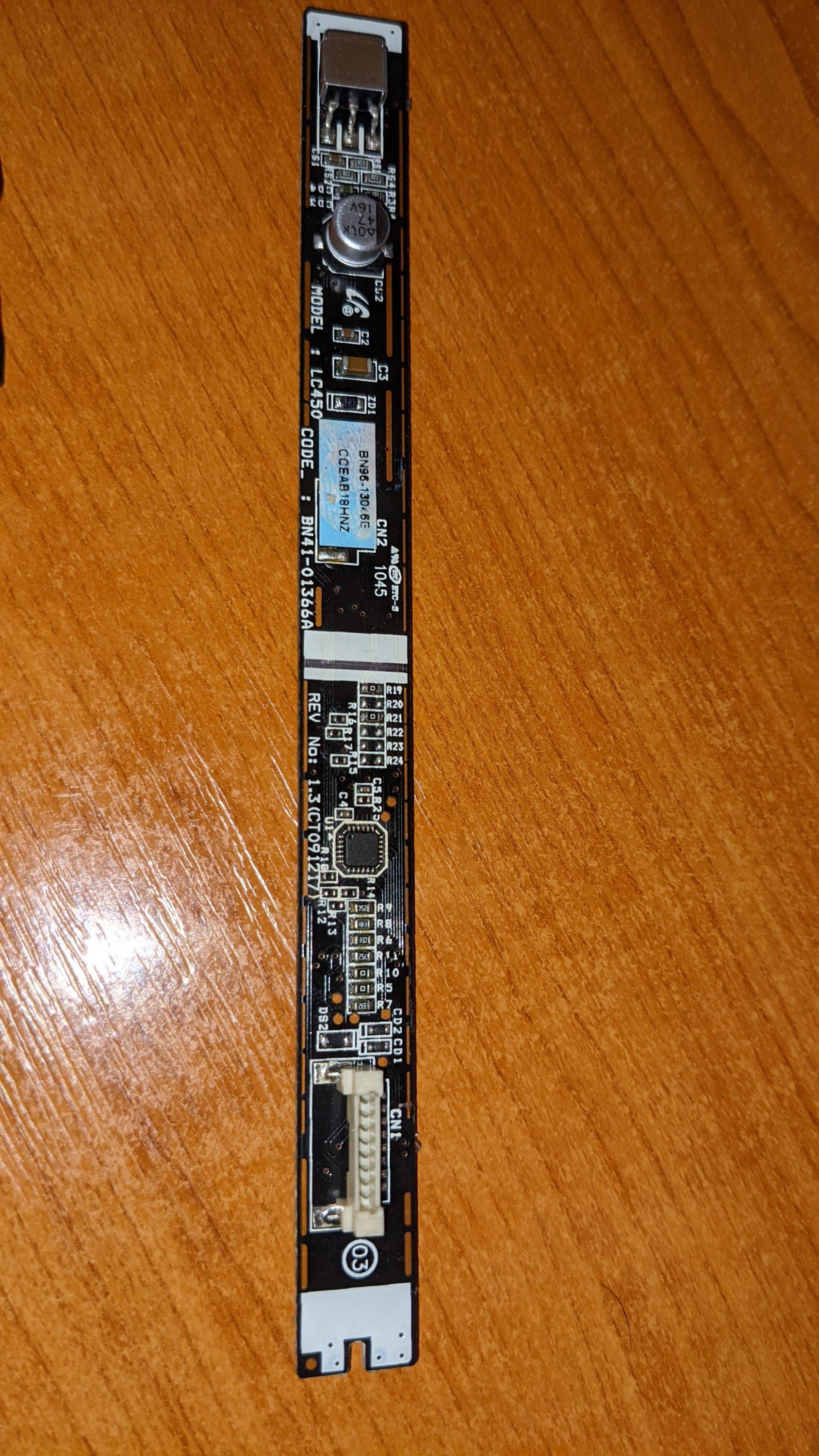

    Disconnected the ribbon from mainboard to touchpad, same behavior.

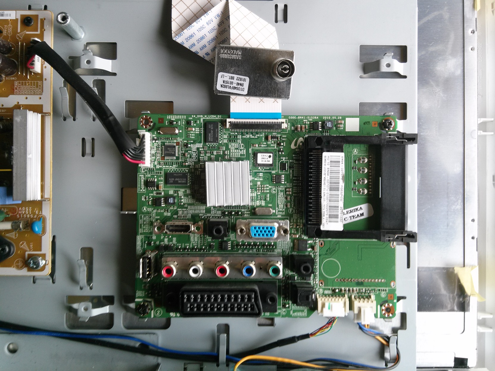

    Mainboard - BN94-02707U code : BN41-01538A
    Mesured values on CN401. Photo attached with labels.
    TR- 3.3V
    GND
    A5V1- 3.31V
    MSCL- 3.3V
    MSDA- 3.3V
    KEY1- 3.3V
    KEY2- values changing from 0.6V to 2.6V (+-)
    LED_STB - always changing values cant even read it
    The LED is allways lighnting up when the cable is connected, as when it does when recieving remote commands, but in this case just by herself.
    The A5V1 has only 3.3V, what seems to be a problem.
    The value of key2 is the one promoting this behavior I suppose.
    The other values seem OK to you guys?
    The set was connected to antenna, so I removed the Tuner to check behavior.
    Still persists.
    Any one got any set with these kind of issues?
    Or any suggestions?

                this may not be an EEPROM issue, I will trace the keyboard input circuit, something maybe causing the circuit to behavior like a button is being press. an schematic will be very helpful, or simply replaced the main board will fix the problem.

                  The first thing I should do is find out why I'm not getting 5V on A5V1.
                  Anyne got any schematic?
                  Thanks!

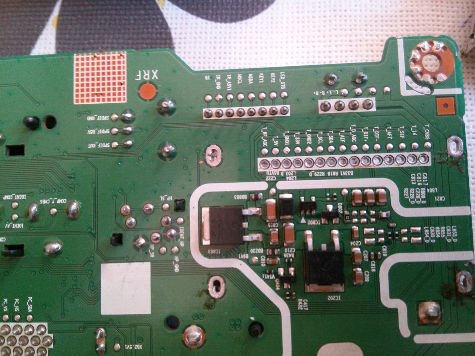

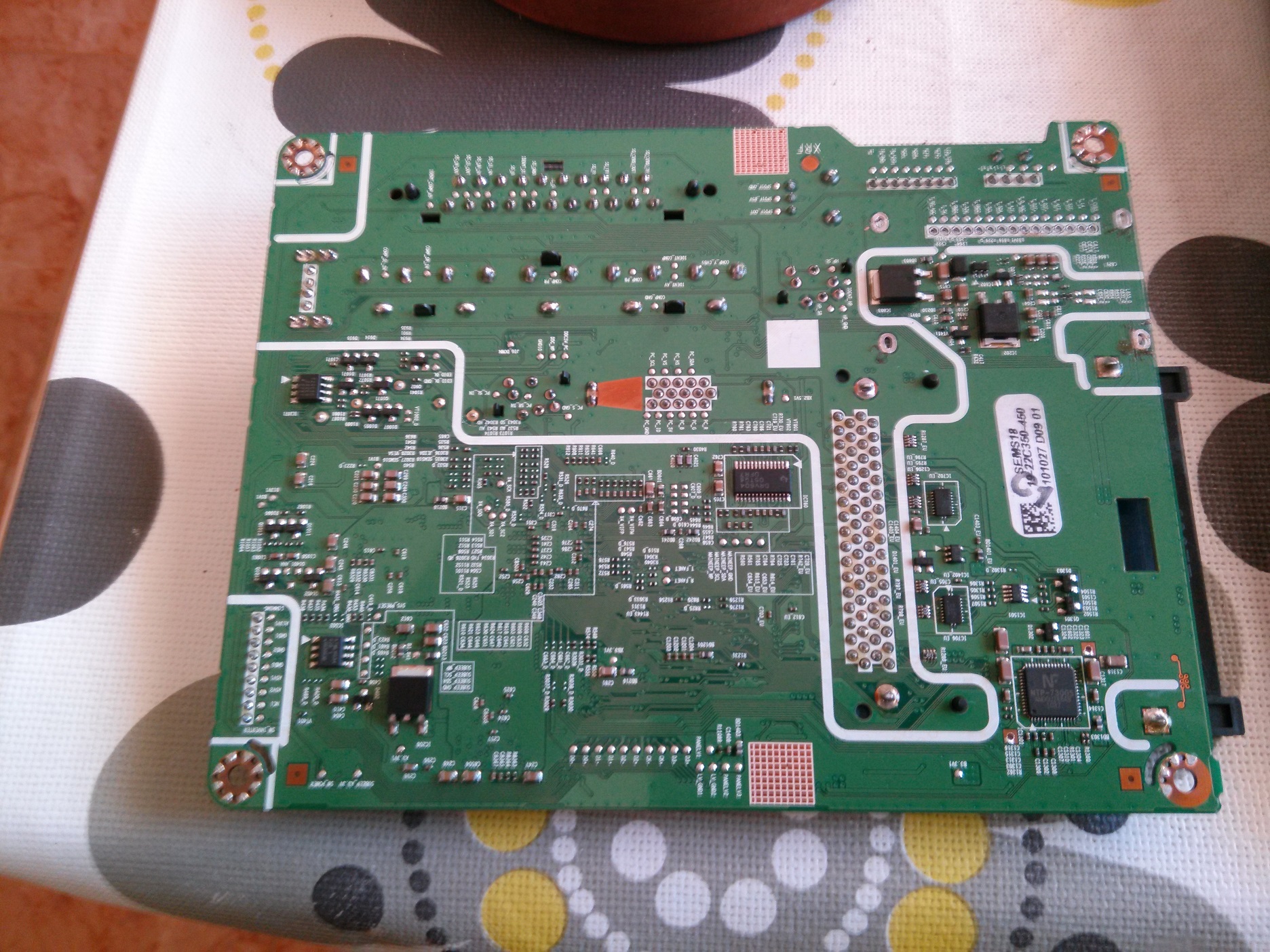

                      Here are 2 photos , top and bottom.
                      The inductor+ceramic cap , the DCDC converters , are those that I marked on the photo?
                      Later!

                        Re: Samsung LE22C451E2W Changing channels alone
                        Hello guys!
                        Am I going the right way?
                        Should I check these outputs marked on the photos?
                        Thanks for any inputs!

                            On key1 and key 2 , there is pull-up resistors , key 1,2 must have constatnt 3,2v to work , so mine problem was one of pull-up resistors , key 2 had only 0,4v , so it didnt works, put 1kohm to 3,3v , solved my problem of channel changing itself

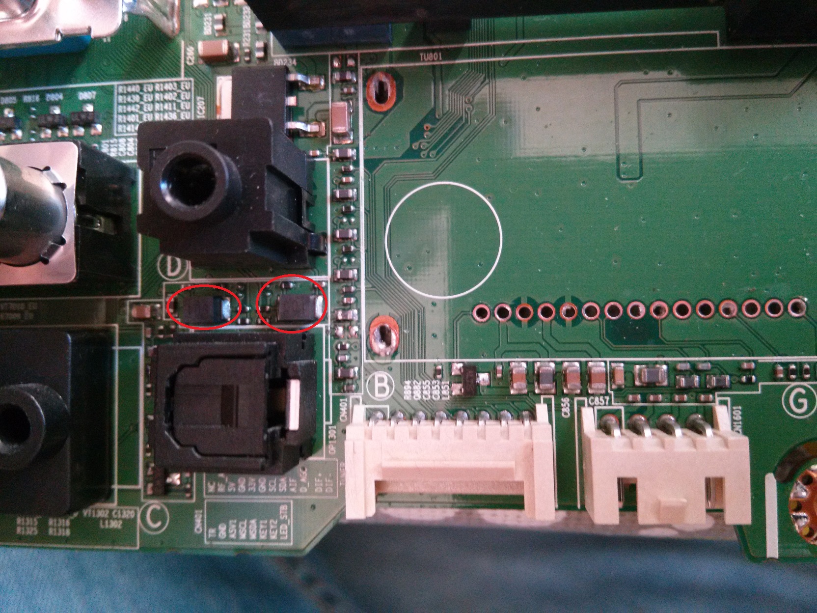

                              Hello,on pins #6 and #7 of the keyboard connector on the main board there are 2 diodes (on each one separately) connected to GND;remove them!
                                Hi, can you please mark them on the board where they are?
                                  Are those diodes marked with CD2 and CD1 on the board near the main connector?
