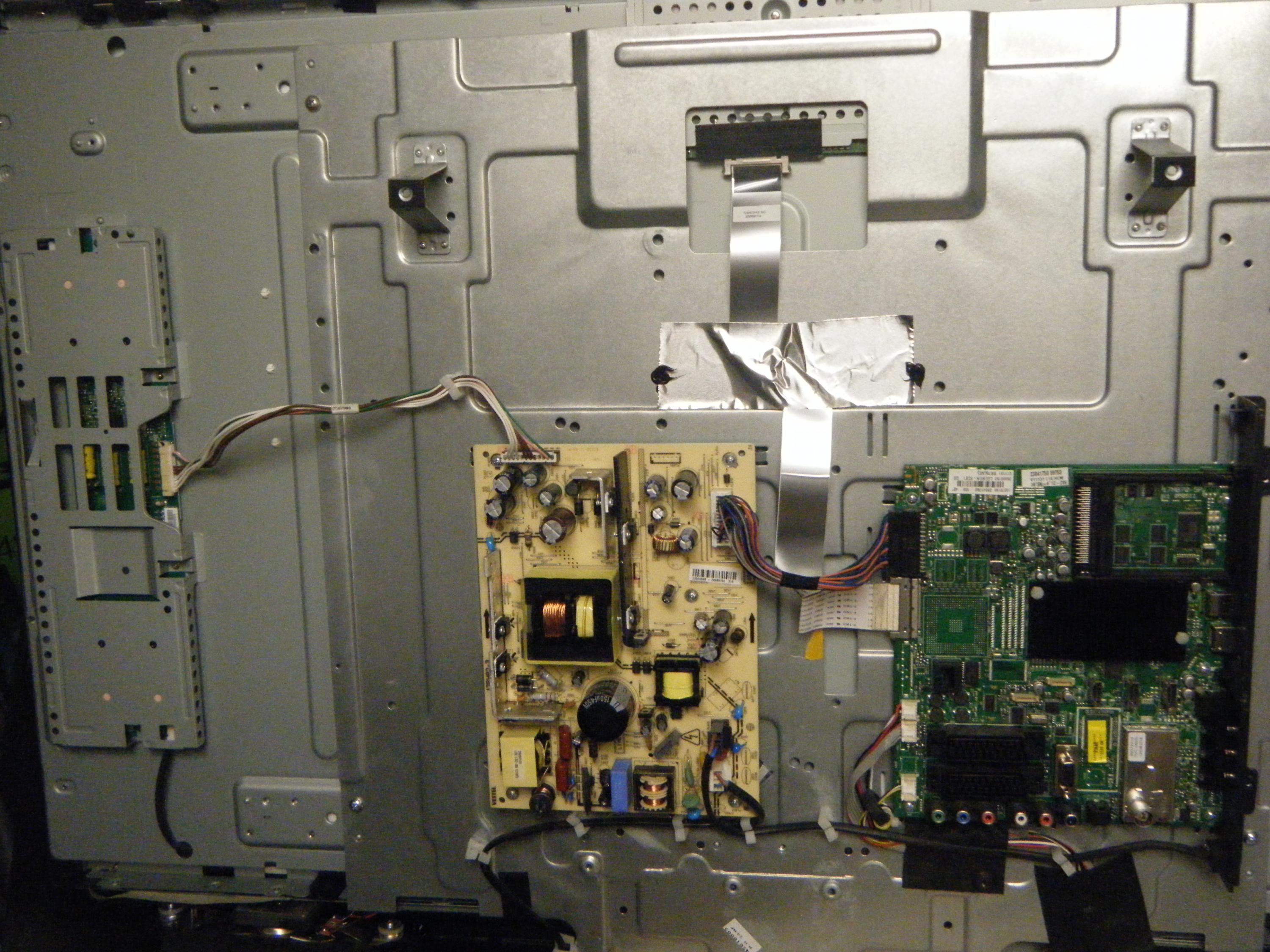

    Hi Guy,
    I have a JVC LT-42TG30J, if you add power to it and touch the "on" switch on front panel you get a tone from touching the "on" but no sign of life at all.
    Am I right I need to check for the 5V standby voltage?

    Re: JVC LT-42TG30J no sign of life at all
    ops!! Forgot the pictures The PSU is a vestel 17PW82-3
      This is probably a main board issue as you will not get a beep without 5V but worth checking PSU voltages anyway
        Hi Tom,
        Can you help with expected voltages on particular pins on the PSU please.
          The PSU is:
          Vestel 17PW82-3
            Don't have a schematic so you'll have to wing it. Usually looking for 3.3V/5V/12V.
