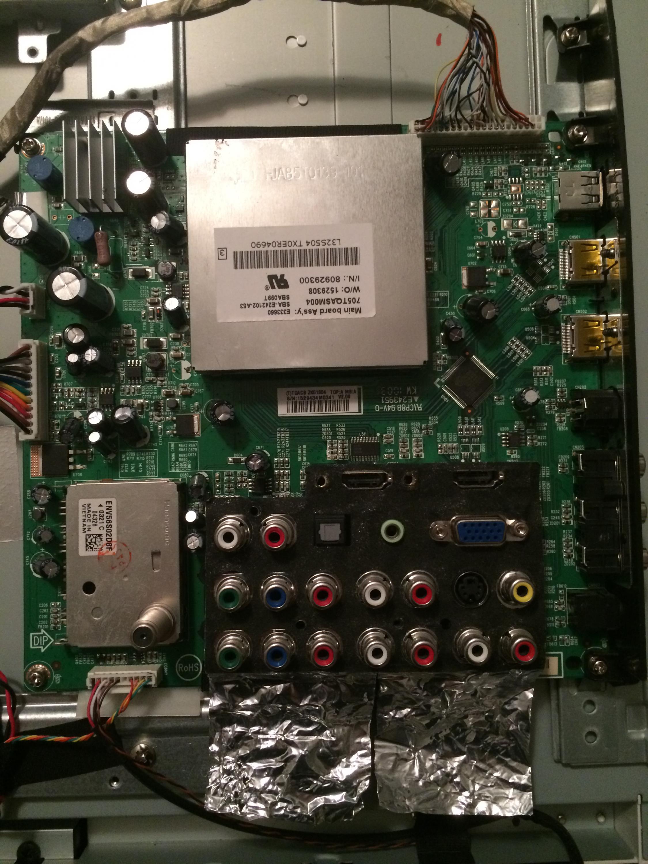

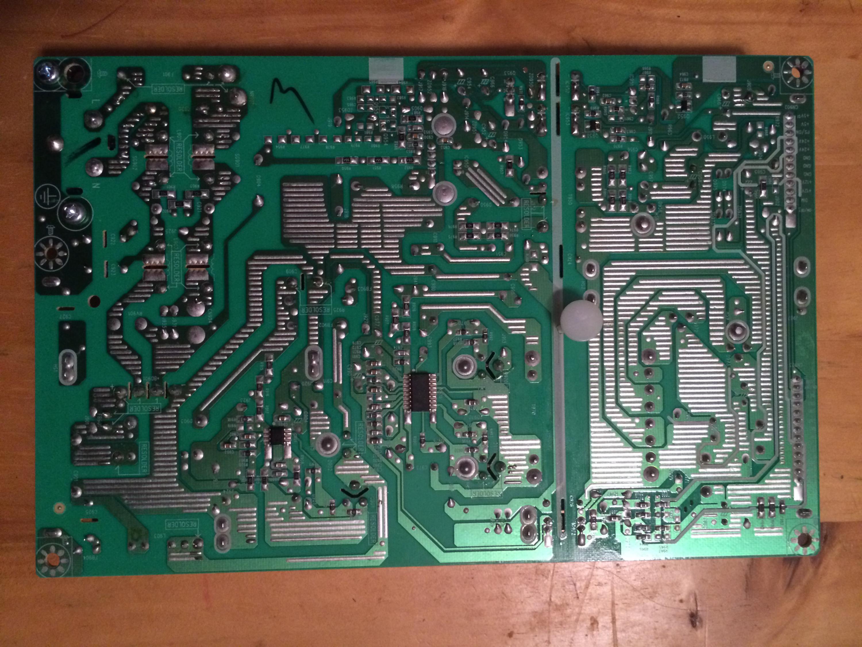

    I was given this TV and thought it would be an easy fix (bad caps or other components). I was wrong. This is my first thread so I hope I am doing this right. I am sort of still a novice.
    I opened the set to check the components on the Power Supply. I checked for bulging caps. None. Checked the fuse. It's good. Then I checked most of the diodes and transistors and they are fine.
    From lurking around these forums I learned how to check voltages of the connectors. I get 5V standby but nothing else (no PS/ON). After a little more research lead me to short the 5V pin with the PS/ON pin (with main board disconnected). With this set up I am getting 12V on both of the 12V pins but not 24V on those 2 pins.
    So I am thinking that my PS is good and it is not getting any signal from the main?
    Also the power button does nothing to the PS/ON voltage when pressed (Main Board connected).
    I guess I am asking if I am right in thinking the Main Board to be the probable culprit. And if so what are some things I can check on it. I tried to test what I thought were the voltage regulators but I was not getting any readings for any pins of any of them while the AC was plugged in. Either I did it wrong, those are not voltage regulators, or have a completely dead main board.
    Any help is appreciated. I can take more/better pictures (well I will try at least) if need be.
    Doing this on the side to make some extra money for my daughters dance competition.

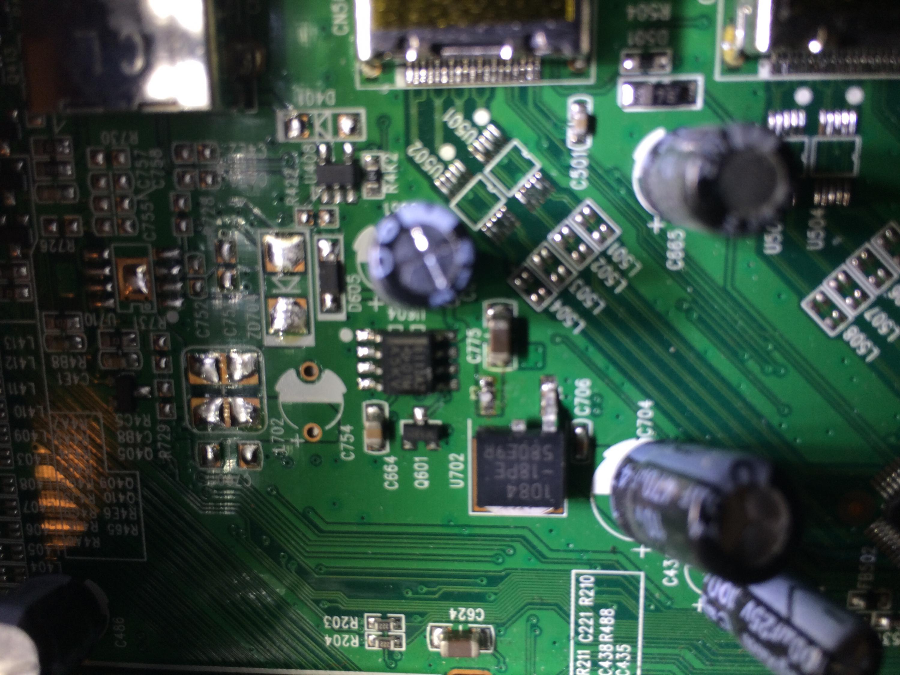

                    So I went to check for fuses on the Main Board. I didn't see any with a quick scan so I started looking for VR ICs. I cam across this one pictured. Obviously I know this will interfere with the overall operation but will this kill the entire board so NO voltage is present? Or will I have to replace it and find out. This will be a good test for me as I have not changed one of these yet. Hopefully it will not cost me too much.
                      Re: Hitachi L32S504 - Dead, No Power, No LED light
                      That U702 output pin (Left pin) is broken off? Someone must have worked on this board before.
                      • ryanfan03
                        • Apr 2014
                        • 45
                        That's what it looks like. I'll replace it if it's cheap enough. Hopefully the person just decided to give up on the project and this is all that needs to be done. How would I go about ordering the part? Just google the number on the part itself?
                        • lookimback
                          • Aug 2013
                          • 1489
                          I believe this is the datasheet for that VR. Checked Digikey and Mouser, no luck.
                          Ebay has some listed if you don't mind waiting a few weeks because they're in China. You should be able to substitute it though. It's a 5A low dropout positive adjustable regulator in a TO-252 package. The default output voltage is 1.8v.

                            I was just snooping around digikey myself. Came across this...would it work?
                            http://www.digikey.com/product-detai...GCT-ND/2122989
                            • lookimback
                              • Aug 2013
                              • 1489
                              Possibly. I'm not sure if the input voltages are the same. The data sheet I uploaded doesn't really say, unless I'm missing it. I think Bud is better qualified to answer this than I.
                                That is the correct one, it is 1.8V Fixed output regulator.
                                  I wonder why that input leg is cut, you should check the resistance of that pad where the missing leg is connected to and ground, also between the big tab and ground.
                                    OK I will do that right now. This would be unplugged I am assuming. And what should I be looking for 0 ohms? Be right back...
                                    • ryanfan03
                                      • Apr 2014
                                      • 45
                                      Just tested. Reading zero for both. Two things interesting though. First, after being curious I tested two other VRs. One (U703) read zero, the other (U708) had a reading of a few k ohms. And second I saw an open spot that looked like a cap was missing...looked closer and saw two legs sticking out of the holes. I don't know what is going on but now I have to find the value of that cap (C702).
                                        It should show >500 Ohms, that is what I expect, TV is unplugged.
                                        Zero means bad, so I think the person was cutting the lead off the regulator trying to find where the shorted circuit is by isolating it.
                                        It looks like the person messed up the board also, I wonder what else is missing.
                                        BTW, you checked the resistance with the TV unplugged, right?
