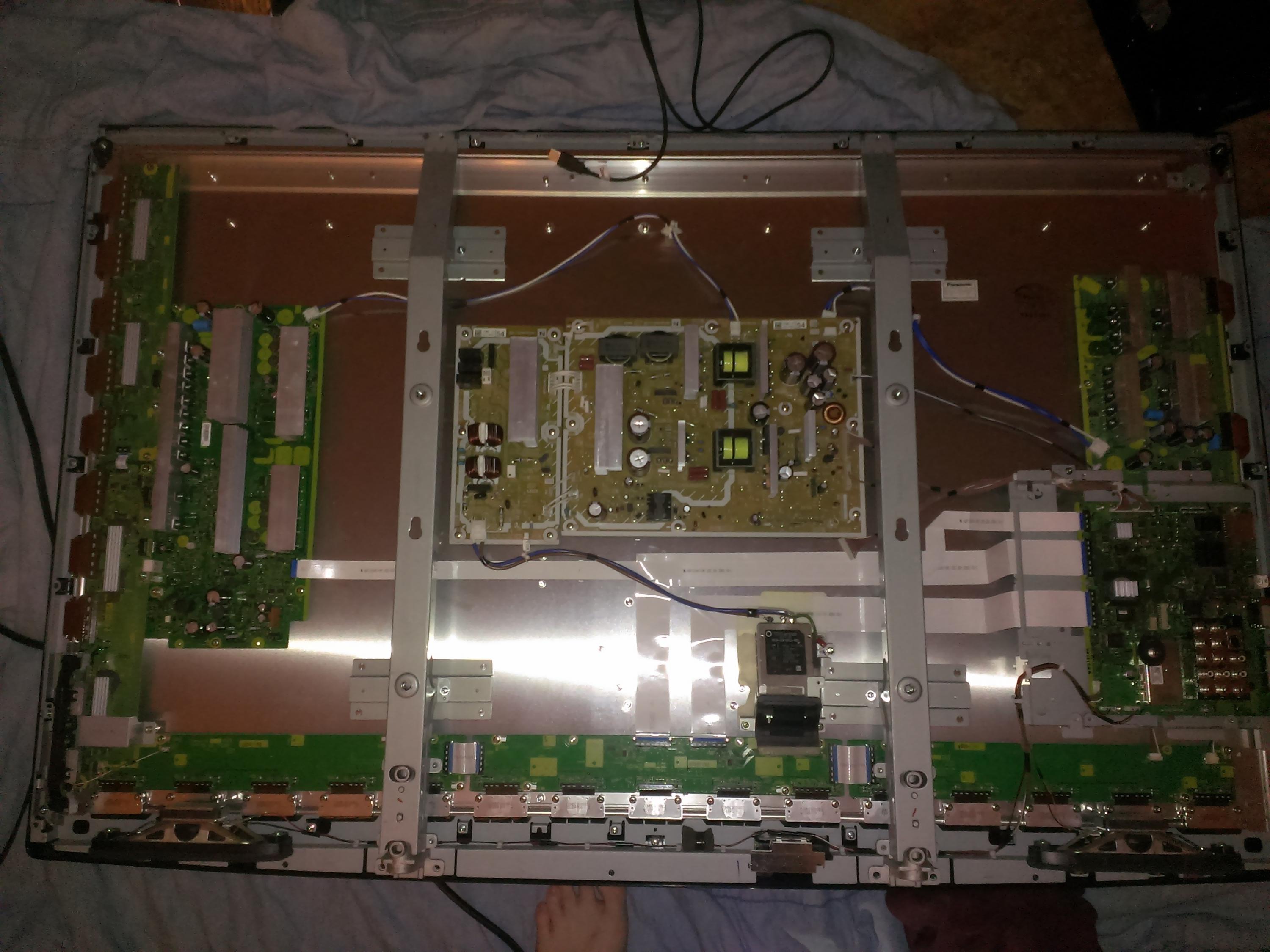

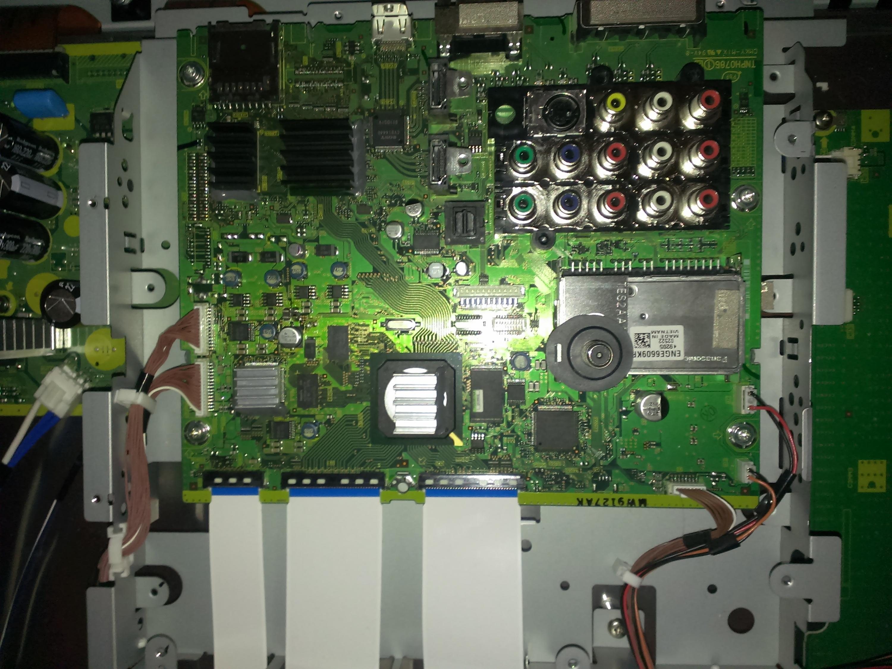

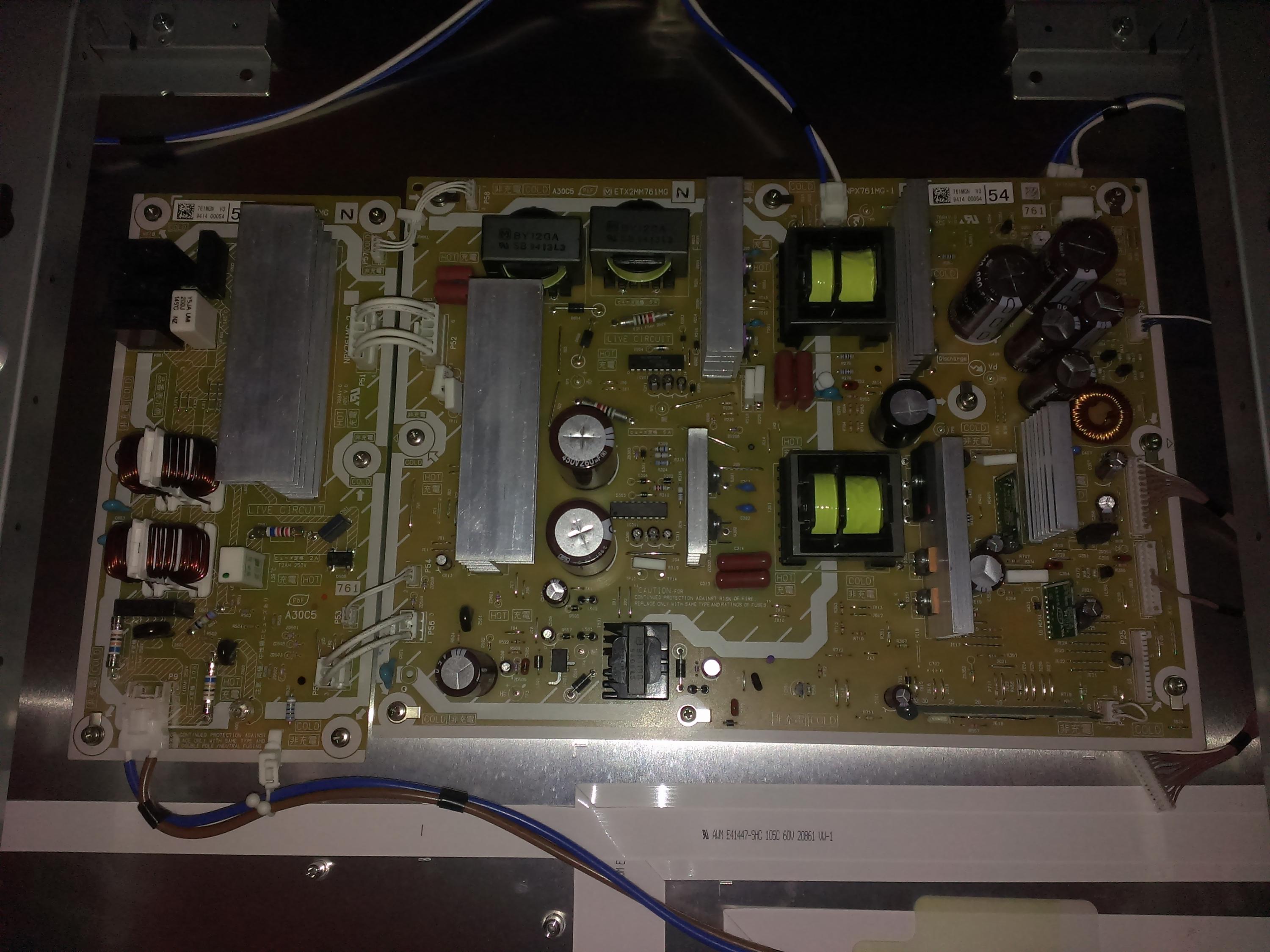

    Hi Everyone,
    I am receiving a 1 blink SOS upon power on for my plasma. I have read based on my bit of research that this is a general "catch all" error which means I have a bit of work to do. When I bought this TV I was aware that it was having problems and the person I bought it from said Panasonic had told him it was a power supply issue. I am however getting a 5v signal out of the 9th pin in p25 which seems to indicate it is a problem with the A board. Is there any info you can give me or steps I can take to help narrow down the fault? I would also like to avoid replacing an entire board as I am a bit low on cash at the moment so if it is possible to just replace components, no matter how much work, that would be greatly preferable. Thank you all!

    I don't know of any and self repair of the A board is pretty rare to read about. Guide does seem fairly definite that if you have the 5V as you state, then A board. they are not cheap to find usually and ModuslinkPTS does repair them but again not cheap but may turn out to be the only option if none used are around.
    you could try this just in case there's a slim chance a SC board has failed and shorted causing something unusual.
    disconnect SC2, SC20, P35, SS11, and the 3 white ribbons at the A board. turn the TV on and see if still 1 blink. Do not re-connect straight away SC2,SS11 and P35, there will be residual voltage that can spike and damage boards and or the panel. Give it 10mins or more or use avlotmeter to see if there is any voltage leaft on those leads. About 200v on the SC2/SS11, maybe 60V on P35.
    Obviously if little or no voltage is left it's safe.

      I disconnected the points you indicated and still received the 1 blink signal so it seems it is the A board. I did find a used A board for $120 but once again would rather wait to see if I can find a way to self repair. If it helps to diagnose the specific problem on the A board this problem has been getting progressively worse over the past 3 months. At first I would get full power on every 2 out of 3 times, after about a month I would have to try it 5 times to get it to turn on. Just these last two weeks it has accelerated to 50 turn on attempts to get a correct turn on (I would just leave it on.) Now it has simply stopped working all together. There doesn't seem to be any plainly visible damage to the board.

                                      I can tell you this first hand, I accidentally discovered a 1 blink can be caused by a bad EEPROM, was a 2010 model and it was the PD4 flash IC, panel data
                                      On this model it would be PD3 and IC9303 would be the equivalent .
                                      I have no way of helping you work out if it's that or something else unless you had another board of 2009 whose flash could be swapped for a test.
                                      And that is the depth of my knowledge. I got the same PCB , same resolution from a different market, different size and successfully swapped the eeproms to make it my old board except when i transferred one of the eeproms, the 1 blink arrived.
                                      And that's the trap with the eprom swap, you may end up with the same issue in which case if you know which one did it you would order a new one pre-flashed.
                                      good to see you're having a good read, just I have not gone that deep.
