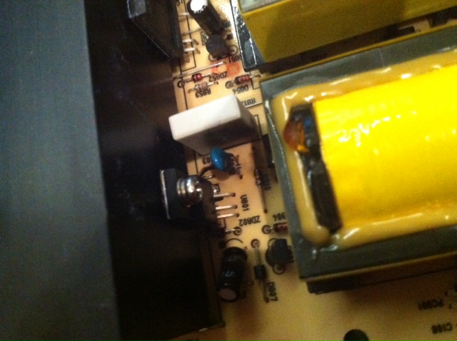

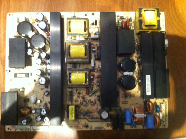

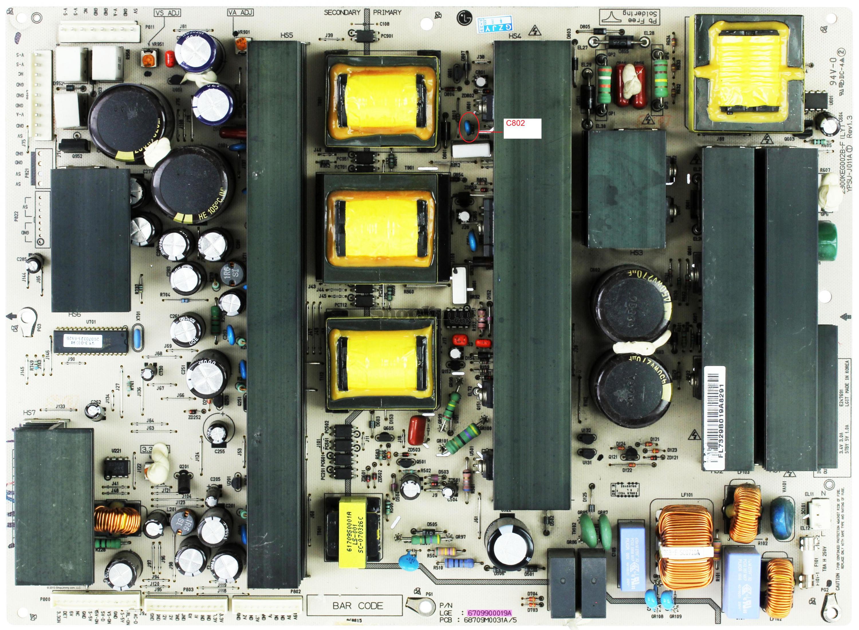

    The TV will not start, as a check on the power board missing 187V, a capacitor C802 is exactly broke, I need the wiring diagram in order to make the necessary checks, which I can not find .... I hope you can help me .. .

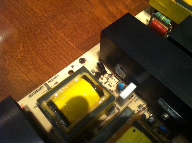

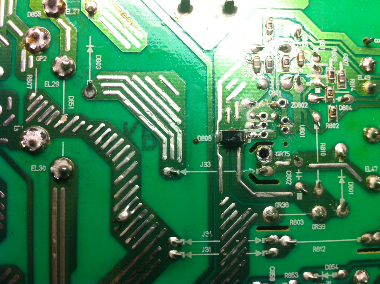

      I have already removed the card, and I found the open R810, C802 burned, ZD802 shorted, also from the solder side D808 and D853 in SMD both in short, unlike the D808 and D853 whose screen printing on both is (34 63) , for others I need to know what value to match, so I serve the schematic.

            thanks anyway, replaced the following members of the tv work again: U801 (MR4040) - C802 (470pF 1kv) - Q801 KTC3198 with 2SA1815 - ZD802 MTZ2JB15V diode with a BZY15v - R810 (10 ohm 1 / 2w) and finally the diode smd with initials 34 63 with a BA159
