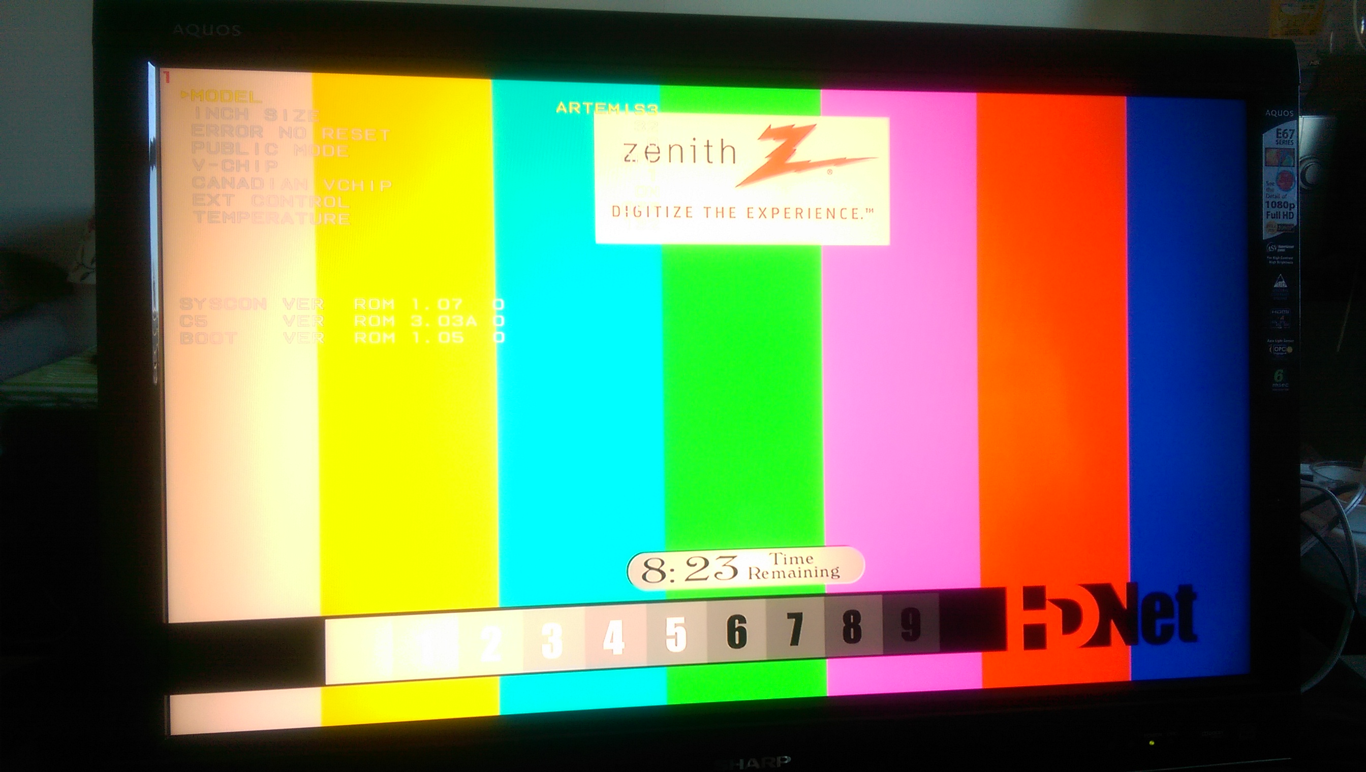

    I found this TV in the hallway of our building. It turned on but the backlight never came on. I replaced the power supply/inverter board with a brand new one pulled from a tv with a broken screen that I got from ebay. After resetting the error code in the service menu it operates fine.
    However, no matter which settings I change, whites appear yellowish. I suspect this may be due to wear of the backlight lamps, but since I have zero previous experience fixing LCD TV's I thought I'd better ask.
    I can't find a setting in the service menu that shows how many hours the tv has been turned on. I can however see image burn-in in the bottom left and right corner, which displays date/time and the word 'live' on the right. So I guess this thing has been wall-mounted (there's no stand) in some office with a news/financial channel on all the time.
    Would that explain the yellow tint? Changing color temperature, reducing yellow, disabling OCP / dynamic contrast etc etc only have a very minor effect, even on the brightest settings whites are still yellowish.

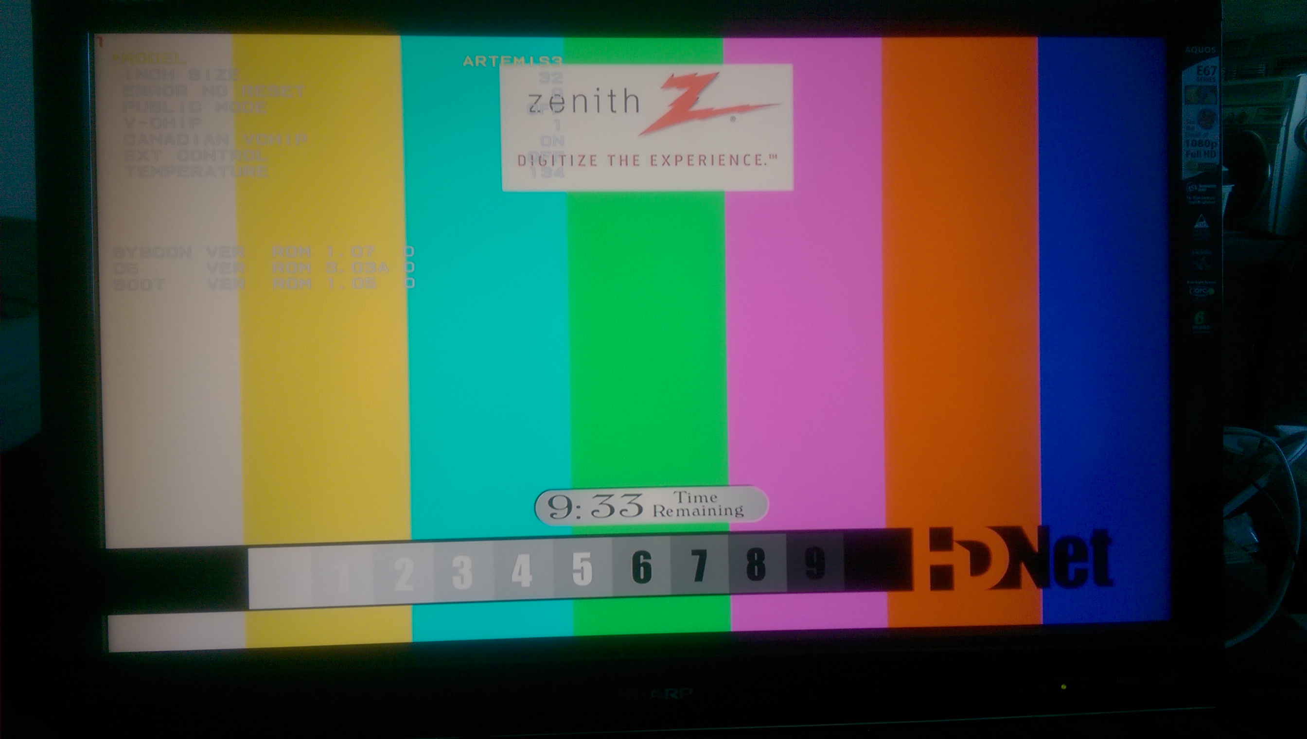

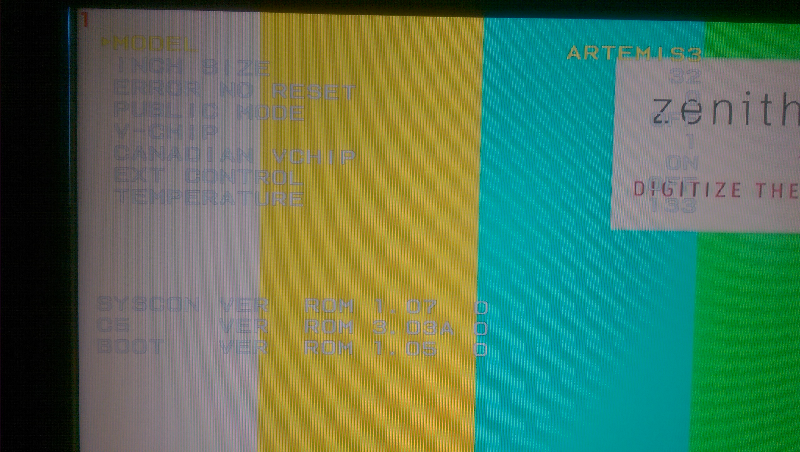

    See the attached pictures; the picture with '8:23' time remaining in it is most representative of what it looks like in real life, the other two are just to show the service menu info and overall color/brightness accuracy.

          Even with monochrome enabled whites are not white. Maybe yellow is not the right description.. the thing that has the most effect is color temperature. The higher that setting is, the whiter it becomes. But it looks like it would at least 3 more higher settings to actually look white. E.g. maybe it's just too warm (red)? Would that be a sign of wear?
