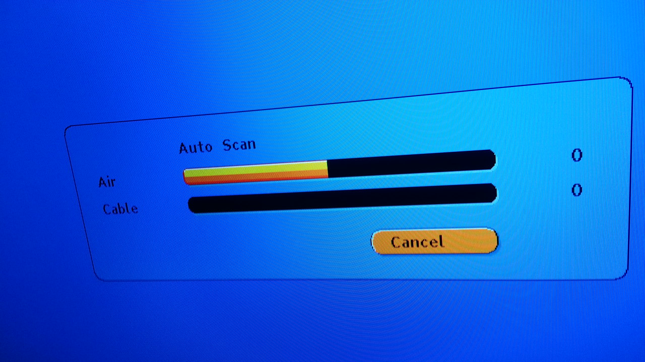

    Viewsonic N3752W Tuner Woes
    This tv was dead and upon inspection was found to have just about every cap in the secondary blown so ordered a kit and replaced them and now set powers up fine.
    When I do a channel scan there is two bars, one for AIR and one for CABLE. Presumably the first half of the AIR scan is for analog and the second half is for digital channels. The meter goes half way across and freezes at what is the beginning of the digital scan and never gets to the CABLE portion of the scan and so never completes.
    I measured +30v and +5v at the tuner module but am unsure how to proceed. Any help is appreciated.

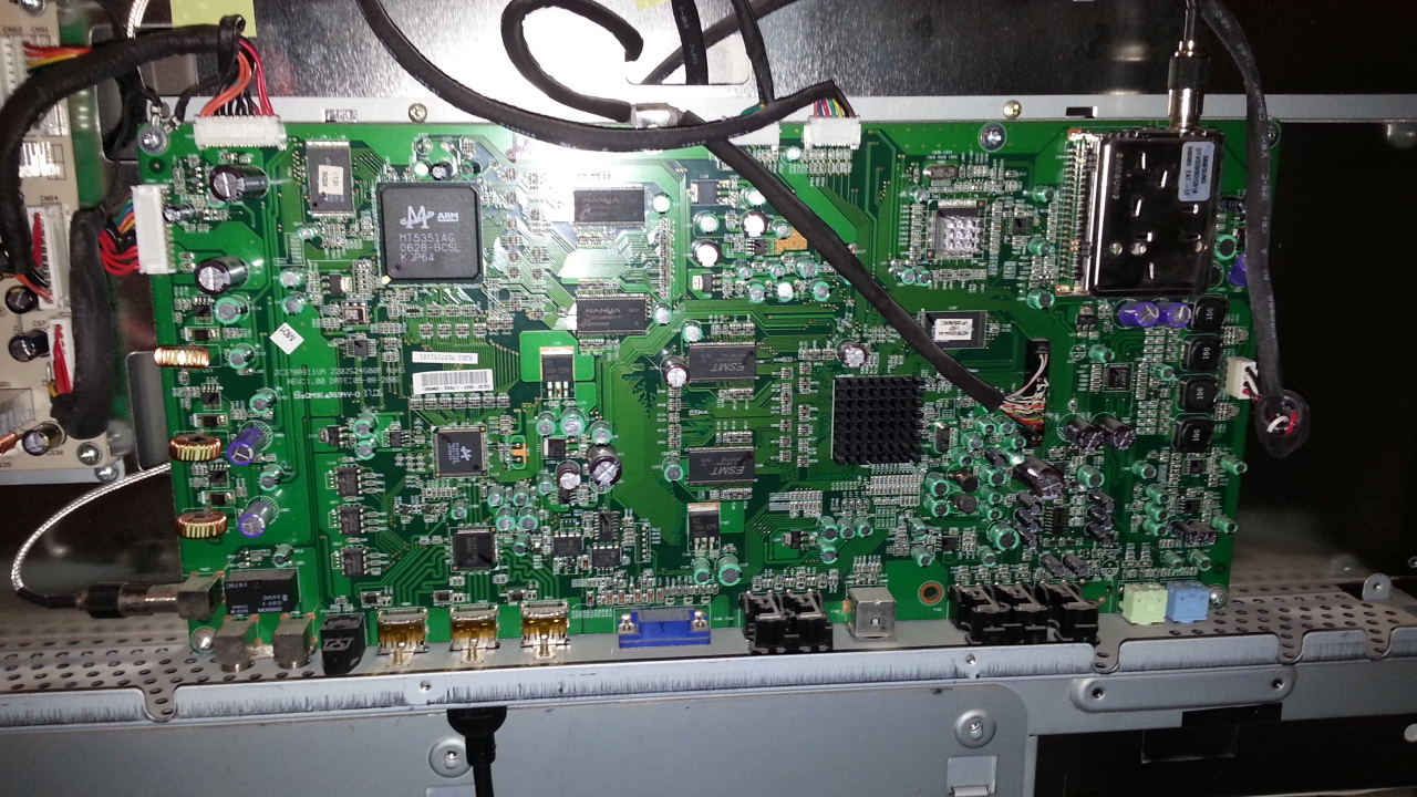

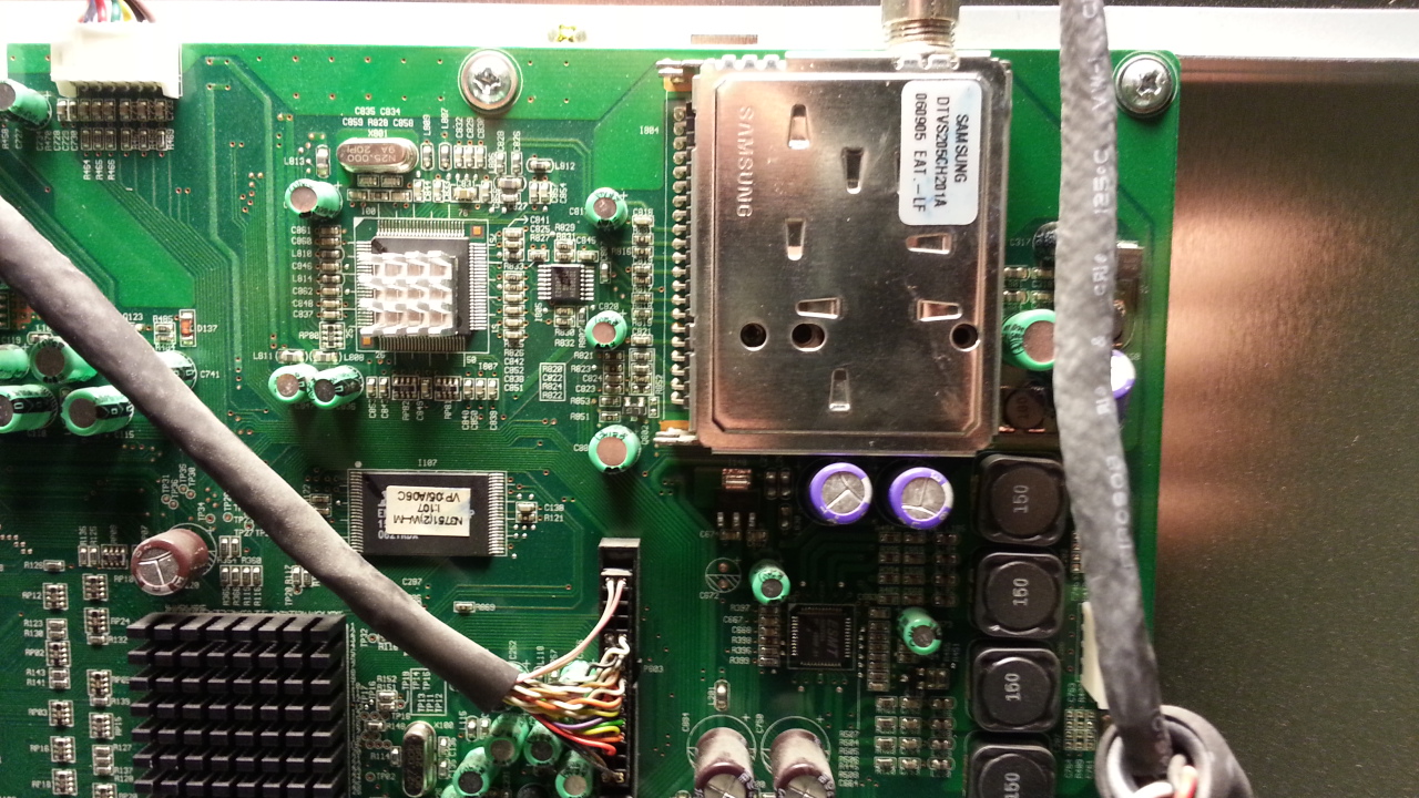

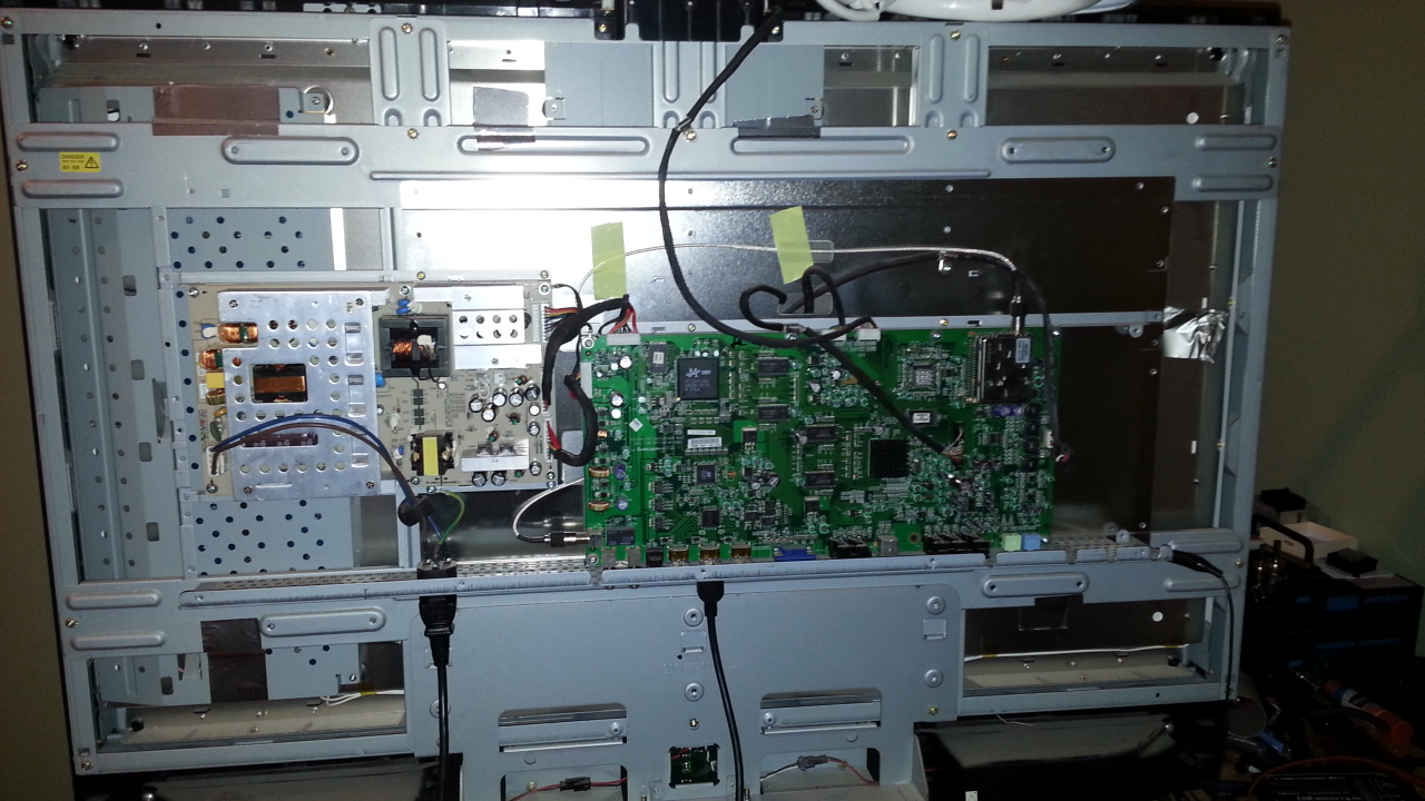

    Re: Viewsonic N3752W Tuner Woes
    Some pics...
      I have this same problem with the scan. The scan hangs halfway through the air scan. Did you ever get it fixed?
                Thanks for those tips. I'll try later. I did figure out the pink screen. Needed to change the resolution down to 720 compatible. Works good now with the laptop.
                I have a home made ota antenna that I'm trying to scan channels in with but it just hangs halfway like you said. I'll let you know if your tips help the situation. Thanks!

                      Ok so the analog tuner works. The channel was fed from the rf output of a sat box and was even found on the channel scan but froze again anyway at the start of the digital scan as before.
                      I think I need to find the atsc tuner ic if it is a separate unit as perhaps it has failed.
                      • mmartell
                        • Oct 2013
                        • 3189
                        The only things in between the rf input and the main processor are the demodulator ic and an mpeg2 hardware decoder ic. I would think that ic rarely fails (it's in millions of dvd players) so the demod ic (mt5112) is suspect. That or some serious ripple in one of the supply voltages. I can test for ripple but don't have another ic to drop in. Stay tuned
