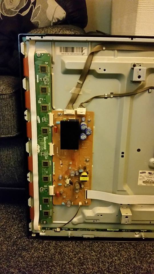

    here i have my samsung tv it all powers on and i get sound but need some help with the picture as its gone yellow and its pixalating abit
    Re: samsung ps43d450
    I'd check Vs & Va on power board are matching the panel sticker.
    Then Vscan & Ve on Y-main & X-main respectively.
    (Ve not marked but in the range of 90~110V)
    For reference:
    - pic 1 is X-main
    - pic 5 is Y-main with Y-buffer (green)
      vs on pinout of psu 206.8
      va on pnout of psu 57.7
      vsc on TP on ymain -185.0
      ve on pinout on xmain 95.2
        Ok, try set Vs to 215V and Vscan to -200V. Use adjustments on power board and Y-main to do this.
          yes that looks like its got it tom66 cheers mate
