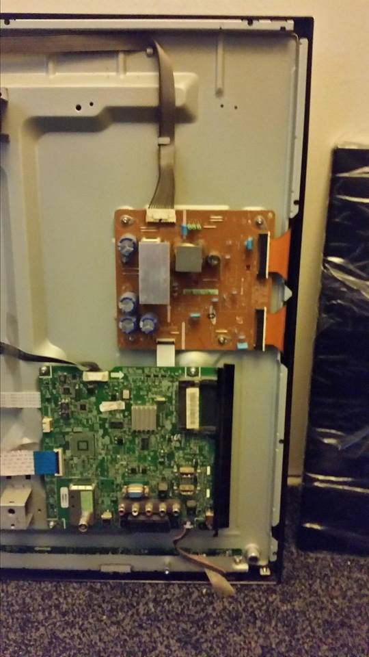

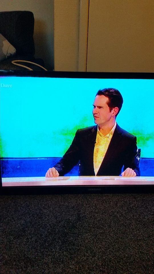

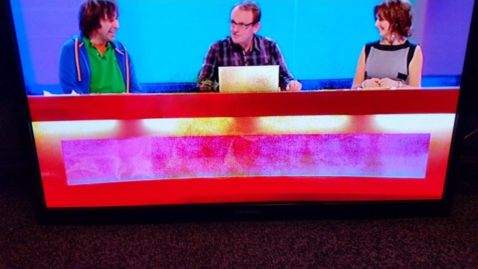

    samsung ps43d450

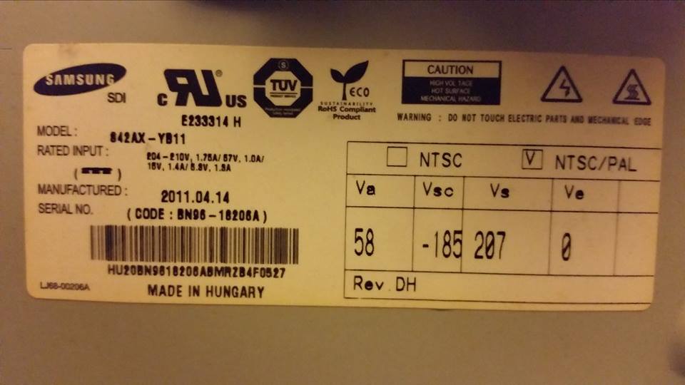

    here i have my samsung tv it all powers on and i get sound but need some help with the picture as its gone yellow and its pixalating abit

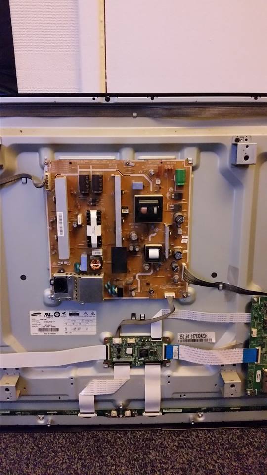

    Re: samsung ps43d450
    I'd check Vs & Va on power board are matching the panel sticker.
    Then Vscan & Ve on Y-main & X-main respectively.
    (Ve not marked but in the range of 90~110V)
    For reference:
    - pic 1 is X-main
    - pic 5 is Y-main with Y-buffer (green)
    - pic 7 is power board
      vs on pinout of psu 206.8
      va on pnout of psu 57.7
      vsc on TP on ymain -185.0
      ve on pinout on xmain 95.2
        Ok, try set Vs to 215V and Vscan to -200V. Use adjustments on power board and Y-main to do this.
          yes that looks like its got it tom66 cheers mate

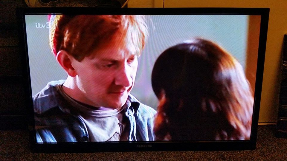

            this is the results tom66
              Cool, now go to the SAMSUNG website and download the latest firmware for this set, put it on a USB stick and install it on the TV. This will prevent the issue getting worse.

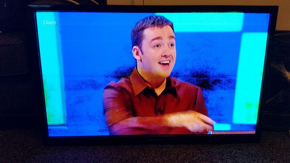

                  hi, googled for symptoms, and it brought me here.
                  at first there was no picture after approx. 1-2 minutes after power on, but sound was on
                  now it has picture, but it is gone yellow, and red pixels appear at larger parts of screen
                  same model, except on the sticker values are as follows:
                  Va 58
                  Vsc -180
                  Vs 207
                  Ve 0
                  Measured values are:
                  Va 81
                  Vs 320
                  Vsc -260
                  any help would be welcomed

                    Check battery in your multimeter. Black lead to chassis ground. If still high try to adjust voltages to sticker.
                      Tried with another multimeter, now I'm getting lower values
                      Va 58,17
                      Vs 207,29
                      Vscan -179,78
                        And tried to set set Vs to 215V and Vscan to -200V
                        Also solved it, now I'm gonna flash latest firmware.
                        What's the cause of this error, and what if it happens again, which board should I replace?
                        Thank you for help!
