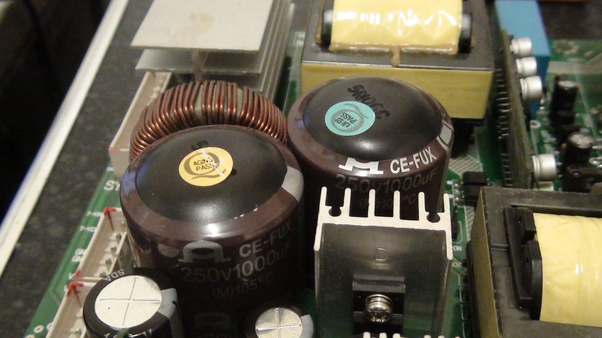

What might of caused these main caps to bulge so badly?
  • Dang
    • Aug 2013
    • 440
    As you can see from the photo they are much domed and as I result I believe this is why I have no VE, I've noticed by CN8002 that Diode D8044 has a resistance reading of about 3 ohms in both directions, I don't believe this to be normal as surely it should go off the scale one way and give a reading somewhere near 400 or so the other?

    Re: What might of caused these main caps to bulge so badly?
    Can you push the plastic dome down?
      Hi Tom66, yes, there's certainly air space there and I've looked on Ebay for a reference as to how they should look, all were flat as you would expect.
        Try cutting the disc or pulling it off and seeing if the actual capacitor is bulged underneath. It is sometimes common for the disc to bulge upwards as a result of heat build up in these TVs. Doesn't mean it's bad.
          Hi again, removed the domed plastic caps and indeed you are right, the cap heads are perfectly flat so I guess these are fine, which still leaves the question, why no VE? is that diode faulty?

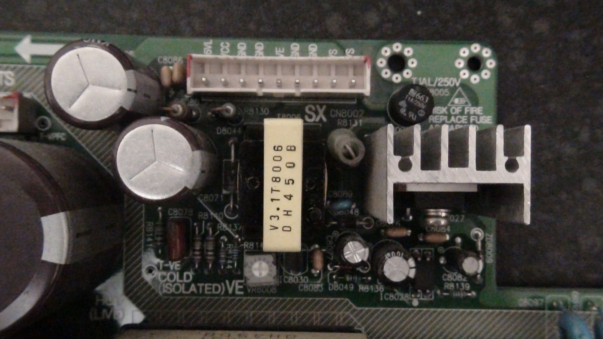

                Loss of Ve would not cause no image. It would cause pink/maldischarged/grey image. Is that what you see?
                Some of these power boards have Ve pin, but it's not electrically connected.
                Could also be shorted Ve on X-main.

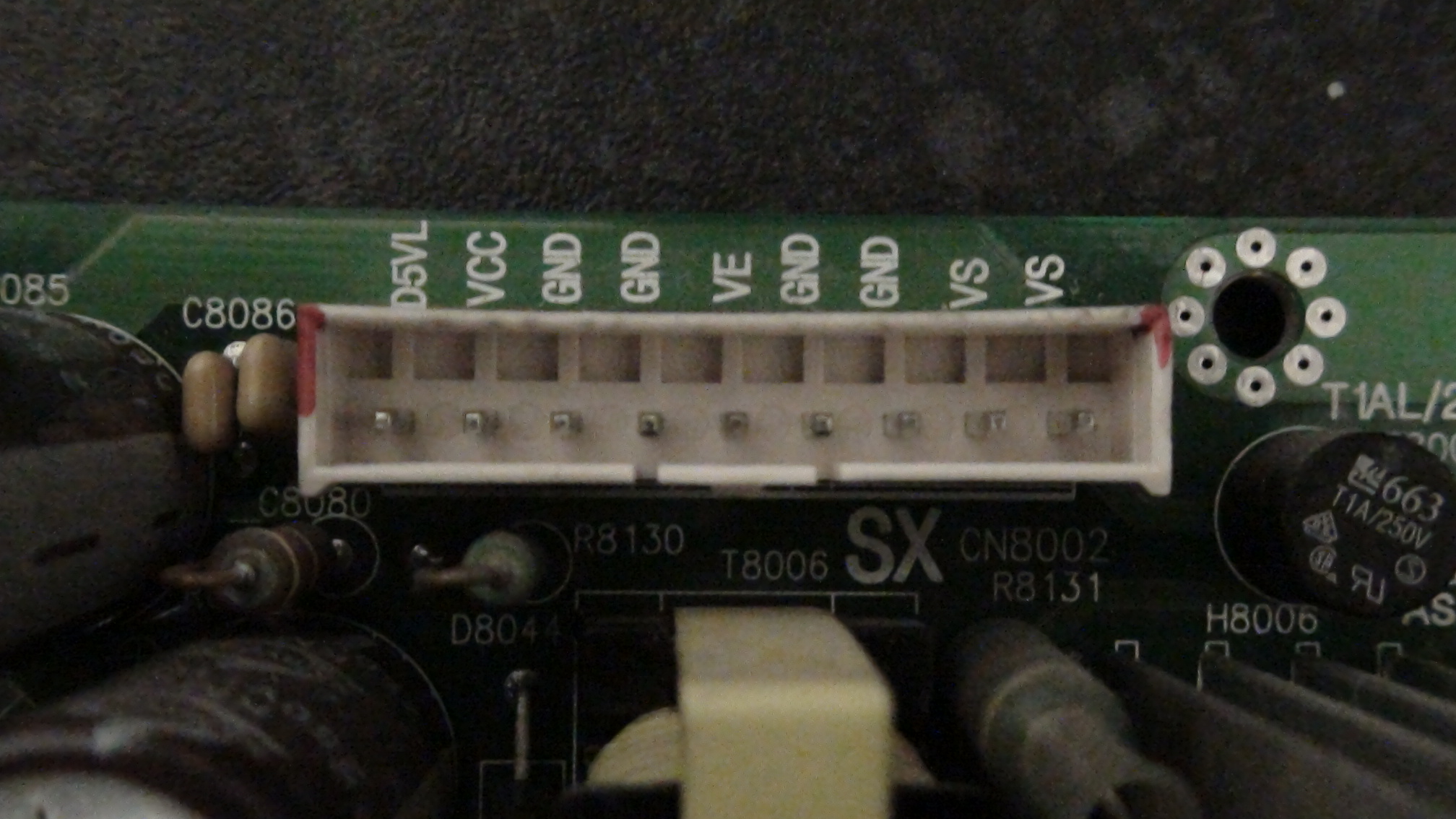

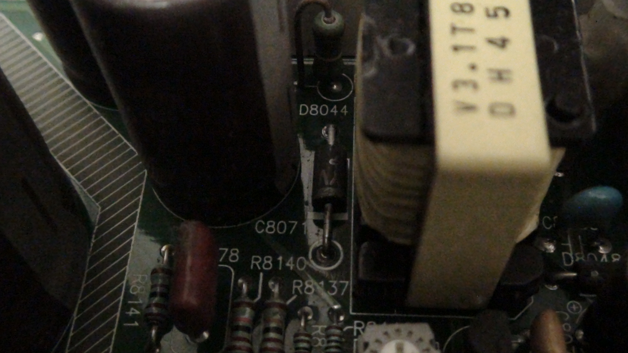

                  OK, I've tried tracing VE from the connector back to it's roots, as far as I can tell it disappears under the two main caps described above, where it goes from there I don't know. I don't see any picture but a momentary select flash of sparkles when it decides to turn off, I can see other flashes from time to time but it doesn't last long, just a few seconds.
                  I have disconnected all the obvious boards, one at a time, so the X-sus, the Y-sus and also the Z-sus, I've even had both the Y-sus and X-sus off at the same time, the power supply acted the same way with LED8001/LED8002 (LED8003 always stays on) extinguishing and LED8004 turning on red so I don't think any of these boards are at fault.
                  Can I go back to this diode, can I assume by a lack of response to this idea that all is perfectly normal?
                    The diode might be bad. May be worth removing it from circuit and testing it out of the board.
                      I see that diode looks a bit browned... could just be dirt on it though.
                        Hi again, OK, so after some research it seems the VE area of the board(pictured) is at fault, firstly the diode looks like it's blown short, the main capacitors are also suspect with one most definitely short across both it's terminals in either direction(C8071), it's the one right besides the aforementioned diode. Now all three of these I shall be replacing but not too sure what rating diode to use as a replacement and will two 250v, 150uf caps be OK to the replace the 250v, 100uf caps already present?
                        Thanks.
                        Just to add: It would seem a possibility that this shorted cap might be responsible for the two main caps bulging as it seems that VE originates from there, any ideas?
                          Again, the bulging of the disc is a normal thing for some capacitors to do - it does not mean the capacitor is bad.
                              So I've removed both caps and the diode, not really that surprised to see both caps measuring seemingly OK(DMM goes of the scale in diode mode), the diode on the other hand still measures bad, it's this one here: http://www.datasheetcatalog.com/data...BYV26EGP.shtml.
                                  If yours is RGP15M type yes.
                                      Thank you, yes, it's the RGP15M. OK, so here goes, be back soon and fingers crossed.
                                        Success, a simple change of the diode and all is working, for now, it's been about 20 minutes so early days but looks good, stable picture too.
