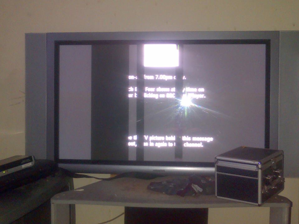

                                    Re: Another Sony with Tab bond failure. KDL-46S4100.
                                    Talking of hitach plasmas got one coming on Saturday with vertical lines down the screen I will try reseating the ribbons on the y sus I will make a thread if not successful.
                                    Here is a picture of it that the client sent.
                                    • Shinju
                                      • Mar 2014
                                      • 1239
                                      In my personal experience with full screen lines like that, its always been a bad panel. Looks like an older Hitachi since its got side speakers.
                                      • ReeceyBurger123
                                        Never Give Up !
                                        • May 2014
                                        • 7325
                                        • Britain
                                        Thanks for the reply, I have seen before that loose connections on the ribbons can cause this but as you said it could be the screen.
