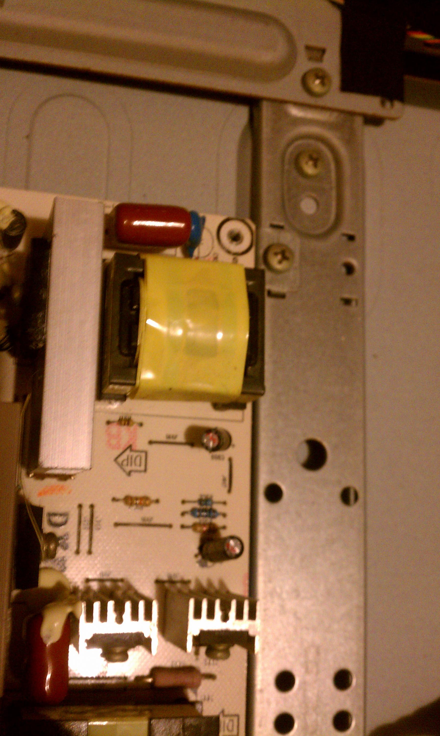

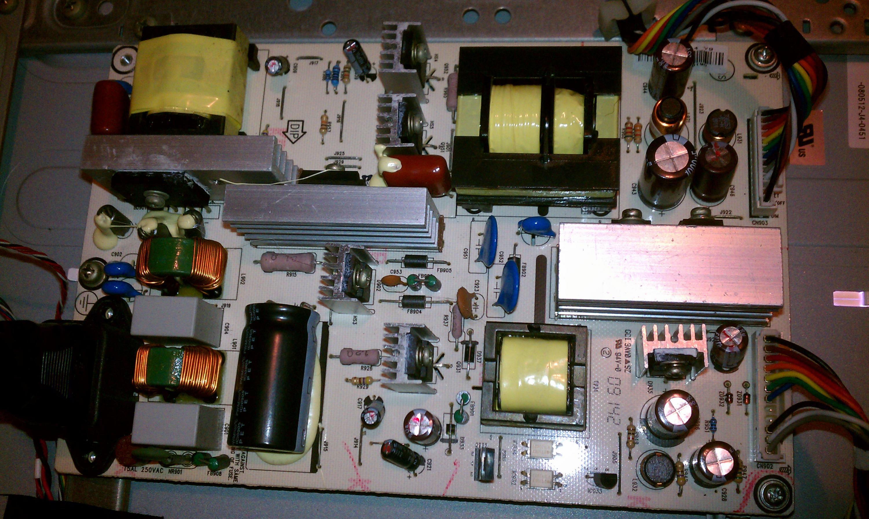

    aoc L32W861 PSU makes high pitched noise when turned on
    got this tv ive been struggling with...when i first got it, i diagnosed that the inverter board was failed and replaced it. but when i replaced the board i noticed that now the backlight and picture came on but i am hearing a really loud annoying high pitched noise from the power supply. so i replaced the power supply just today and apparently people on ebay dont know how to test anything before they declare its good and ship it out, because this power supply makes an even louder high pitched noise and only makes the backlights flash over and over again...it cant keep them on. so now i have to return this power supply...and im back to my original psu that works but makes an annoying high pitched noise when switched on
    i think i isolated the part of the psu that is making the noise. its the big yellow thing in the second picture.. is this a transformer? can it be repaired or replaced? i was hoping to get away easy with just buying a board for 25 bucks but if i cant even trust theyre going to work, i might as well fix it myself...never had this high pitched noise problem before. ideas anyone?

    Re: aoc L32W861 PSU makes high pitched noise when turned on
    it goes like EEEEEEEEEEEEEEEEEEEEEEEEEEEEEEEEEEEEEEEEEEEEEEEEEEEEEEEEEEEEEEEEEEEEEEEEEEEEEEEEEEEEEEEEEEEEEEEEEEEEEEEEEEEEEEEEEEEEEEEEEEEEEEEEEEEEEEEEEEEEEEEEEEEEEEEEEEEEEEEEEEEEEEEEEEEEEEEEEEEEEEEEEEEEEEEEEEEEEEEEEEEEEEEEEEEEEEEEEEEEEEEEEEEEEEEEEEEEEEEEEEEEEEEEEEEEEEEEEEEEEEEEEEEEEEEEEEEEEEEEEEEEEEEEEEEEEEEE
    real annoying
    Don't fear the repair...
      That's a useful description. Are you sure it's not more of a "WEEEEEEEE" sound? :P
      If you have a scope I'd test the 24V,12V&5V outputs for ripple. Also check the PFC voltage is ok. Maybe try adjusting backlight brightness and see how that affects it?
            The transformers hardly ever go bad. If you hear a transformer making an abnormal noise it is most often caused by some other component failure causing the transformer to be driven incorrectly\differently to usual.
            An exception is the flyback transformer\LOPT in a CRT monitor\TV which always makes an audible noise (If your ears still work past 15kHz)
                        That yellow transformer is the PFC inductor for the PFC Voltage booster, so as Tom said, does it change with backlights setting? It may be problem with PFC circuits or the main filter cap.
                            I had a torrid squeal like that yellow transformer i had to rewind it. I also had a transformer make a squeal/vibration noise come to find out the outter shell was cracked and if I squeezed it, it would stop, let go and it started squealing again.
                            Cheap and quick fix was to put a ziptie around it and problem solved it's still going!
