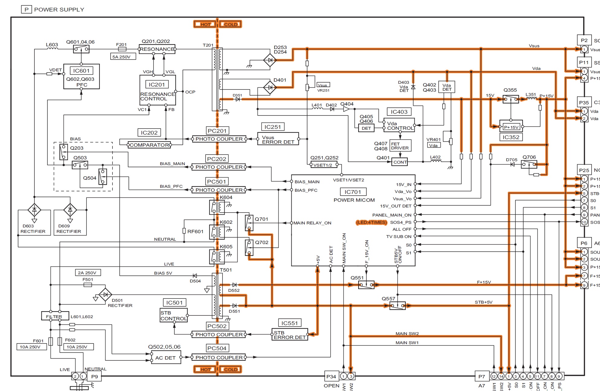

    I have a plasma tv that I'm trying to repair for a friend, the tv was working fine this morning when I turned it on for the first time, after 30 mins playing a movie it turned off, making a clicking relay sound coming from the P board.
    There's no blinking light and the TV didn't want to turn back on even after letting it sit for a couple hours unplugged.
    I opened it and I don't see any blown caps, no burnt spot, fuses seem fine on the P board. I tried unplugging SS and SC one at a time but no luck, only a clicking noise is heard.
    Apprently the power supply has been replaced already on this TV, could it be a blown main board?

    Power supply faults would be rare on these, I have not read any yet so maybe the PSU was replaced dude to an intermittent shut down which has now become permanent.
    the common fault with these is a shorted SC which shorts the Vsus on the PSU but from what you say it's sounding like A board.
    You would have to confirm what standby voltages are present, there is a good fault finding guide for this series.
    No LED or blinks does sound like an A board issue, with the SC faults commonly 4 or 10 blink.
    Try disconnecting, SC20, SC2, SS11, P35, 3 white ribbons at the A board. If you still have clicking, no LED or blinks etc, A board would be prime suspect. After you try that(on , no more than 30 secs) DO NOT reconnect any of those power cables for a good 5 mins or so as residual volatge may be there and spike a board or damage the panel!
    I'll find the link for the guide and edit this post.

                              This is the only thread I can find anywhere on the web with the same symptoms I am experiencing: Relays continually clicking, no LED at all, same TV: TC-P50G20.
                              I metered the fuses on the power supply board. I get 120VAC on the 2 lower right fuses, no power on either side of the fuse on the lower left fuse, and fluctuating 55-62VAC depending on relay state on the upper fuse.
                              I am not sure I can perform the other tests mentioned without the power supply working correctly. My fear is buying a new power supply board only to find something else is shorting it.
                              Anyone else have this clicking, No blink issue?
                              This is a great site so far! Thanks for being here!
                                Re: Panasonic TC-P50G20 clicking, no blinking led
                                somewhat confusing without actual fuse location numbers.
                                F602 is neutral line
                                F601 is active line
                                F501 is on the active line for the 5V STDBY cct.
                                F201 is on the PFC cct
                                Try disconnecting Sc2,SS11, P35, 3 white ribbons and turning it on. Don't reconnect sc2,ss11,p35 for 5-10mins after it's turned off as residual voltage will be there and can damage boards and panel if it spikes.
                                See if it still clickety clicks
                                    Still clicking with the connectors removed. Removed P6 and P7 and it no longer clicks. Reconnected all but left P6&7 disconnected. No clicking. Seems like A board?
                                      P7 is the one that makes it click. Looks like these boards are getting scarce. Does anyone repair them at component level? Yikes.
