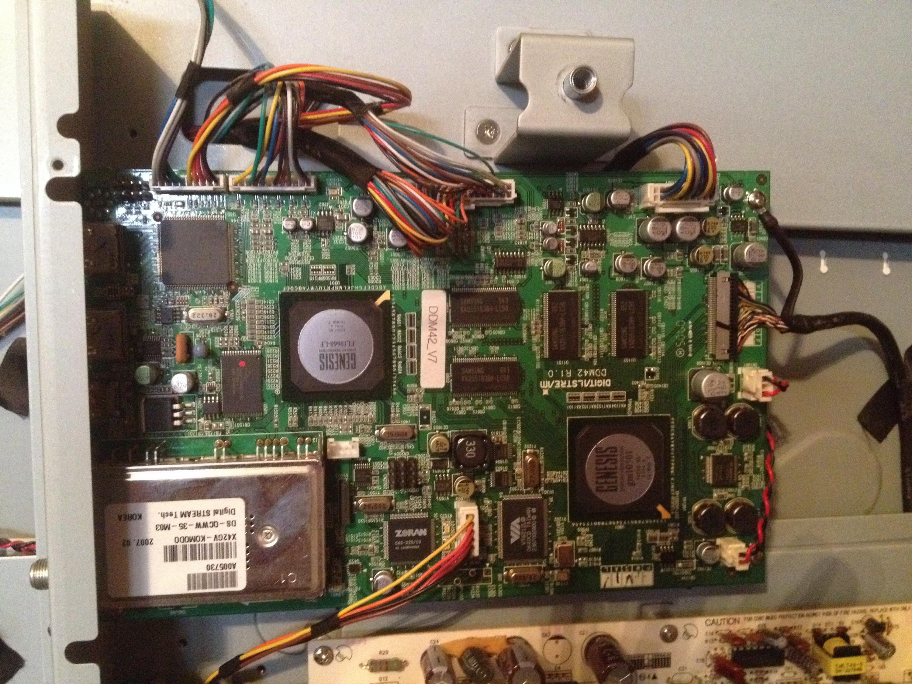

    Hello everyone. I have had this 42 sceptre for quite a while and never have had a problem. About a month ago sometimes a certain color would look slightly inverted or almost neon and then stop. Just the other day I turned it on and now it's non stop crazy colors.
    I have tried finding a way into the service menu on this set without luck.
    Based on web research, I have found other people with similar problems and they ended up replacing the main or tcon board with good results.
    I unscrewed the back and reseated all the connectors on the boards without any luck, including the tcon ribbons. I also wiggled connectors with the set on and noticed no change in the picture.
    I don't want to throw boards at it and need help determining where to go next.
    The main board is numbered DDM42_V7
    The tcon board is numbered T420XW01 V4

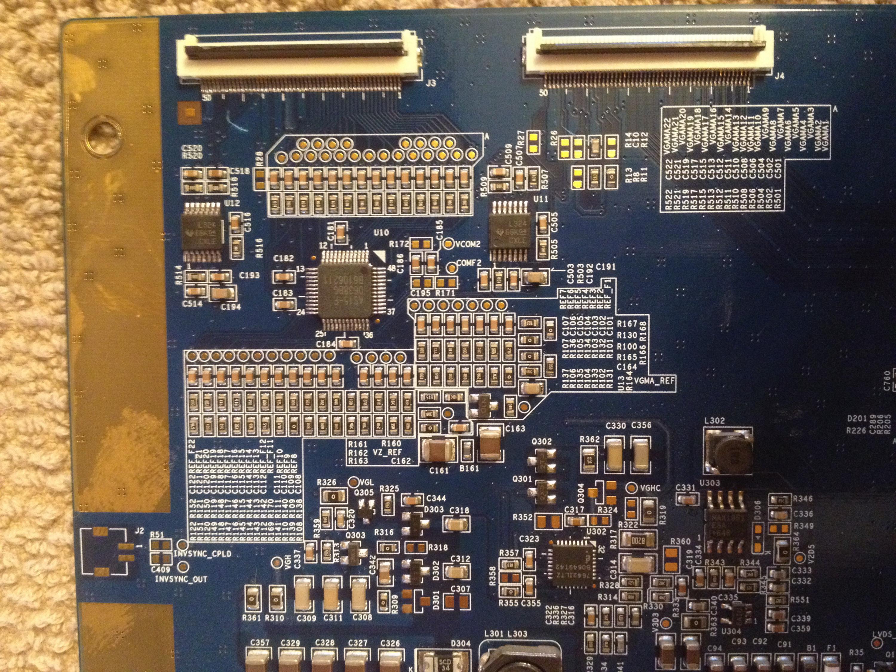

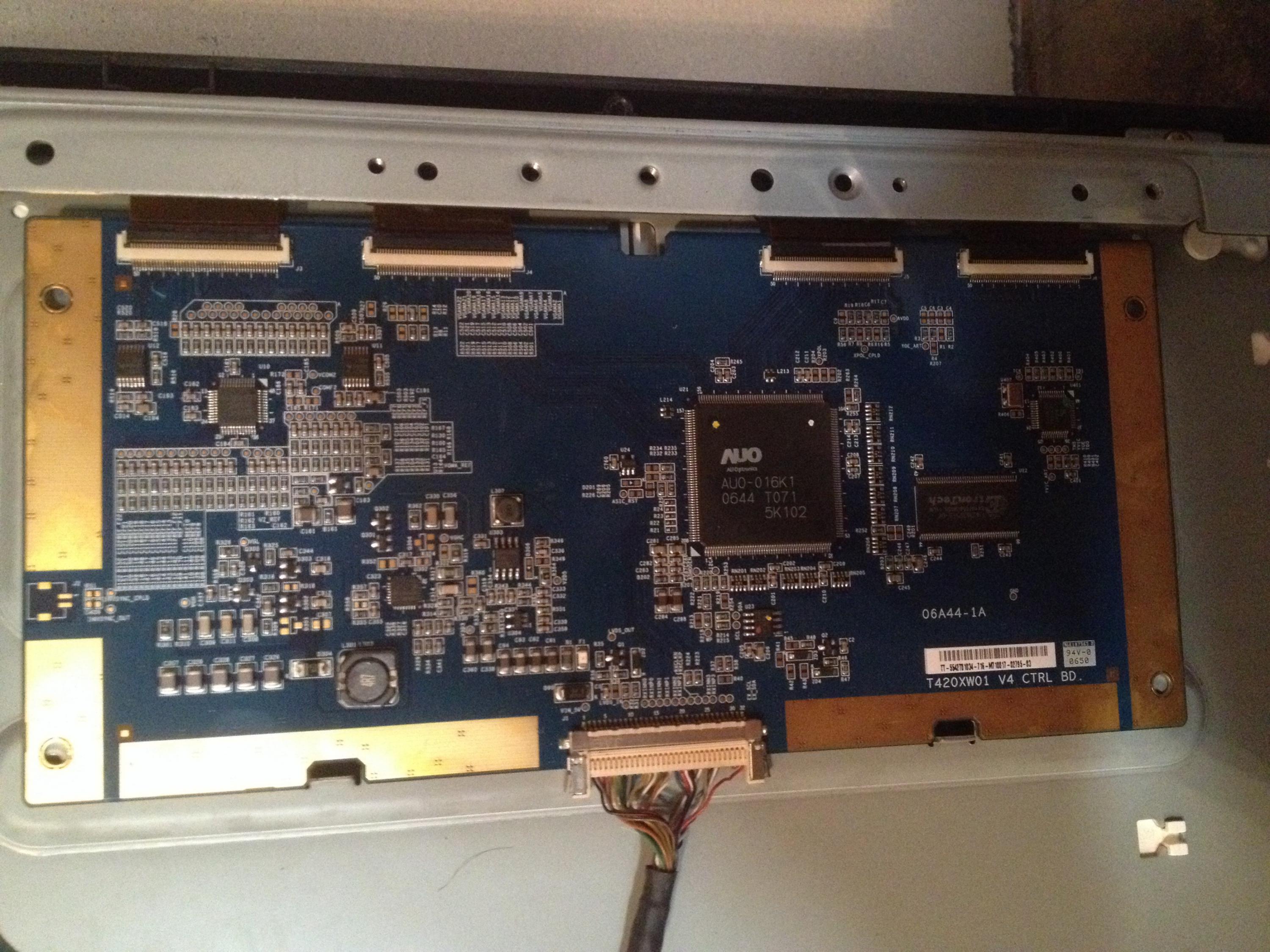

      Here's the tcon.. More to follow

            Pictures are not really clear enough for troubleshooting - I cant read the print on the
            tcon to advise you where to test - I can make out 2 banks of test points and they are most likely labelled.
            Just as an aside If that is yellow glue that that is going hard and brown on the power supply you need to remove it all as it is corrosive and becomes conductive.

                T420XW01 V4 AUO optronics t-con, can almost bet its going to be a AS-15 gamma chip failure!

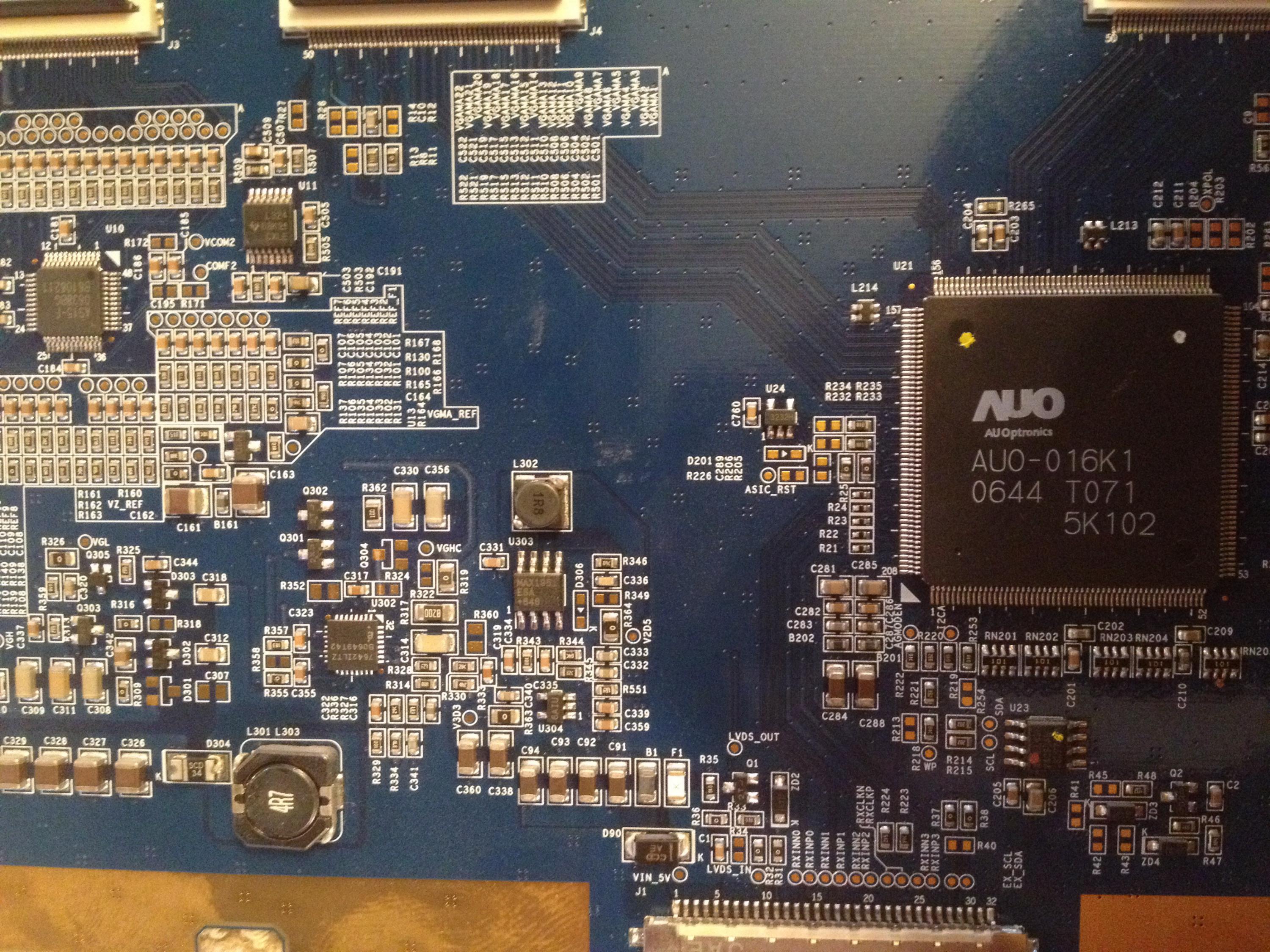

                  Closer pictures of tcon.

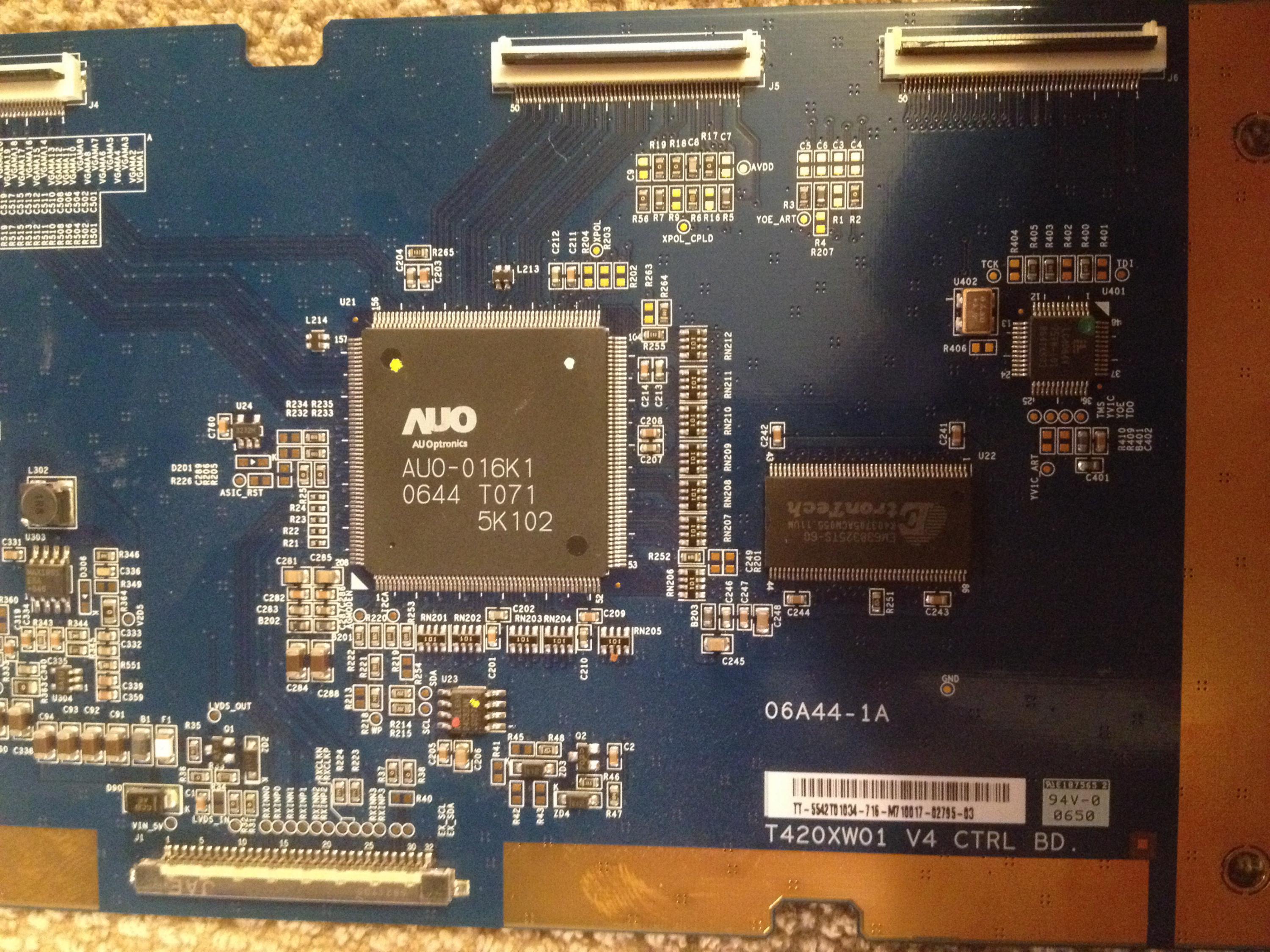

                    Another
                    • Addressrock
                      • Nov 2014
                      • 13
                      Re: Sceptre x42gv-komodo strange colors
                      One more.

                        Took some measurements on the tcon vgama points
                        1-22: 15.46, 15.25, 13.14, 12.06, 11.04, 10.79, 10.33, 10.01, 9.74, 8.45, 8.24, 6.55, 6.40, 8.31, 10.68, 6.37, 4.06, 3.52, 3.03, 2.60, 11.35, 0.35
                        Having some computer problems with the excel spreadsheet but from the reading I've done these numbers do not look good.
                        • mmartell
                          • Oct 2013
                          • 3189
                          Bad ic. Replace it or the whole tcon.
