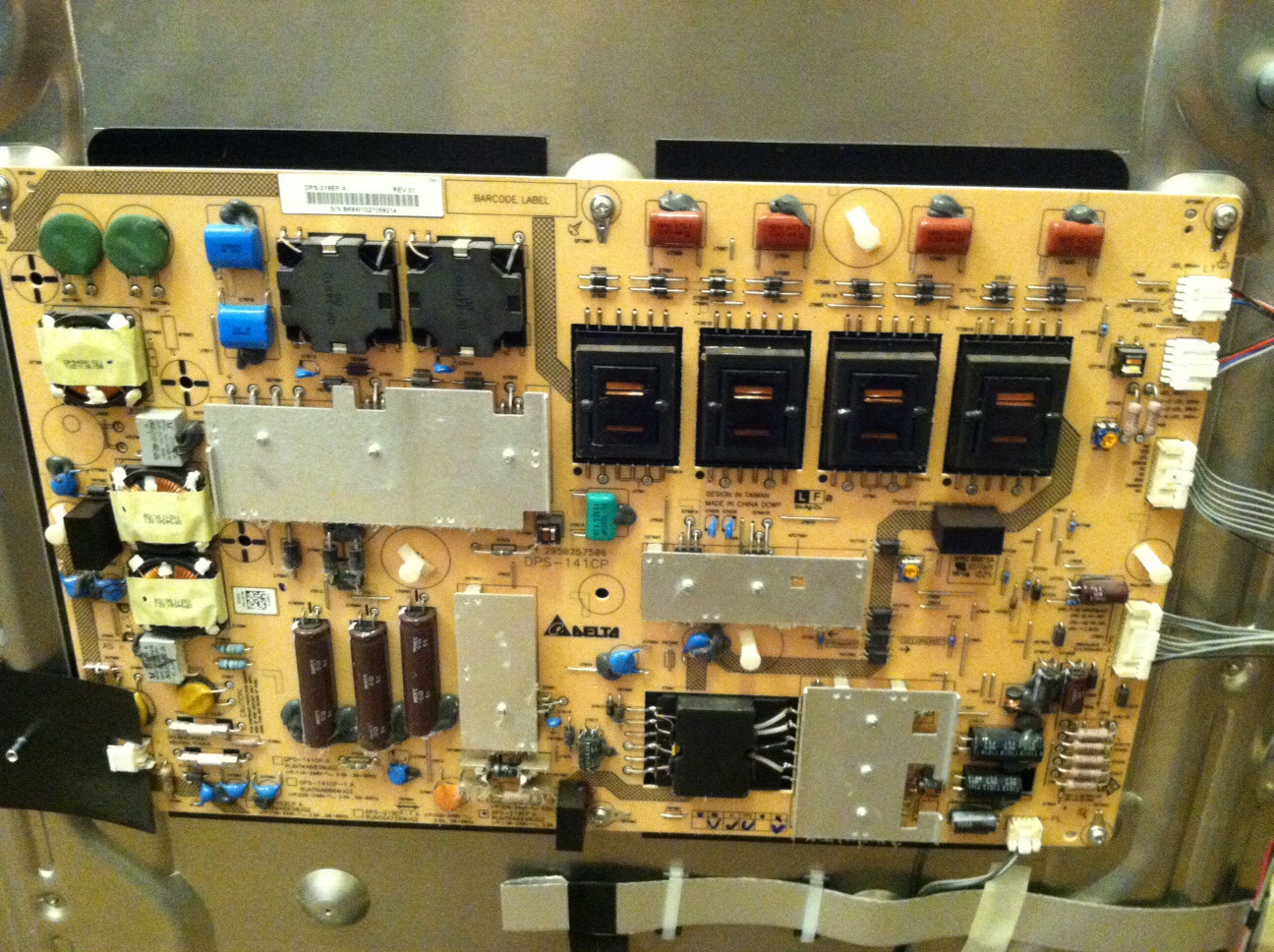

    Re: SHARP AQUOS 60" Won't Power On - LC-60LE810UN
    Power board pic

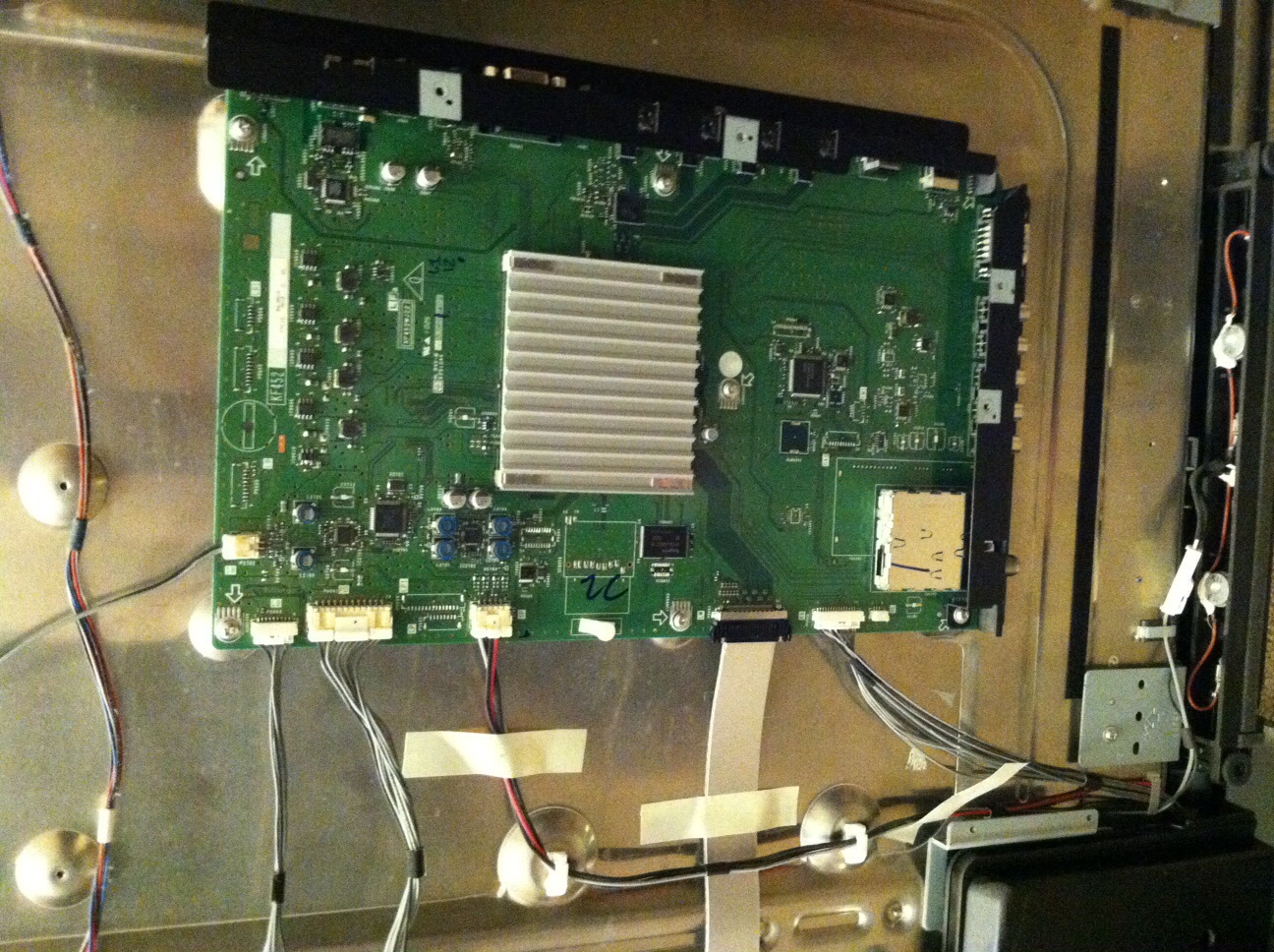

      Board 2 pic

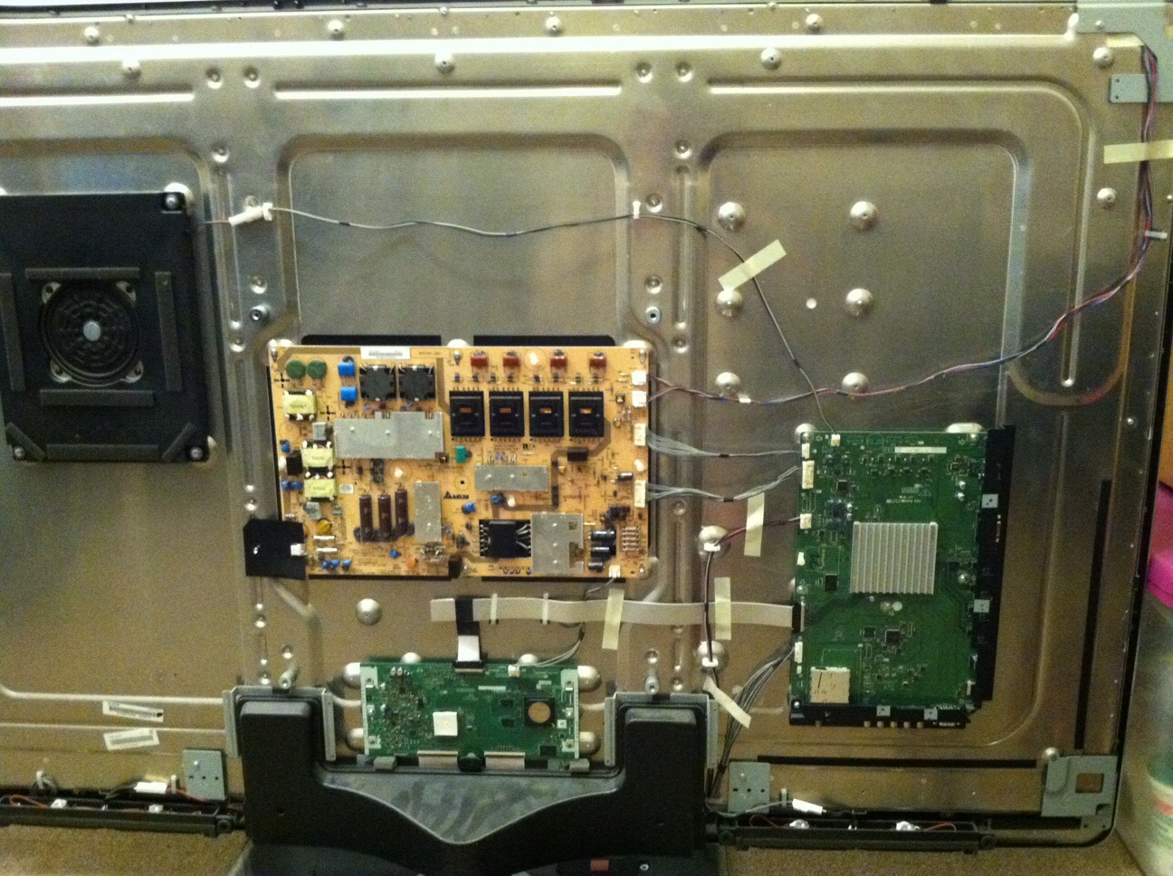

        Board 3 pic
          https://www.badcaps.net/forum/attach...4&d=1415407912
          OK, on the right side of the board, there white connectors with labels next to them, you will have to take the DC voltage readings on each pin when the TV is off and when the TV is on.
          Make sure to give us all the information:
          I.E.
          CN 11111:
          PIN 1, PS_ON, TV OFF= XXX V, TV ON = XX V
          PIN 2, ????, ??????, ????
          Just remember that we do not have the TV in front of us, so you have to give us all the details as if we have the boards in our hands to look at.

                • kburks1230
                  • Mar 2010
                  • 87
                  PD (bottom right of power board)
                  pins 1-10 are 0v
                  11 - 4.9v
                  12 - .12v
                  LB
                  All 9 pins 0v
                  L2 & L1
                  All 4 pins 0v
                  Those are the 4 white connections from bottom up on the right side of the power board. I can't get the tv to turn on to get ON voltages.
