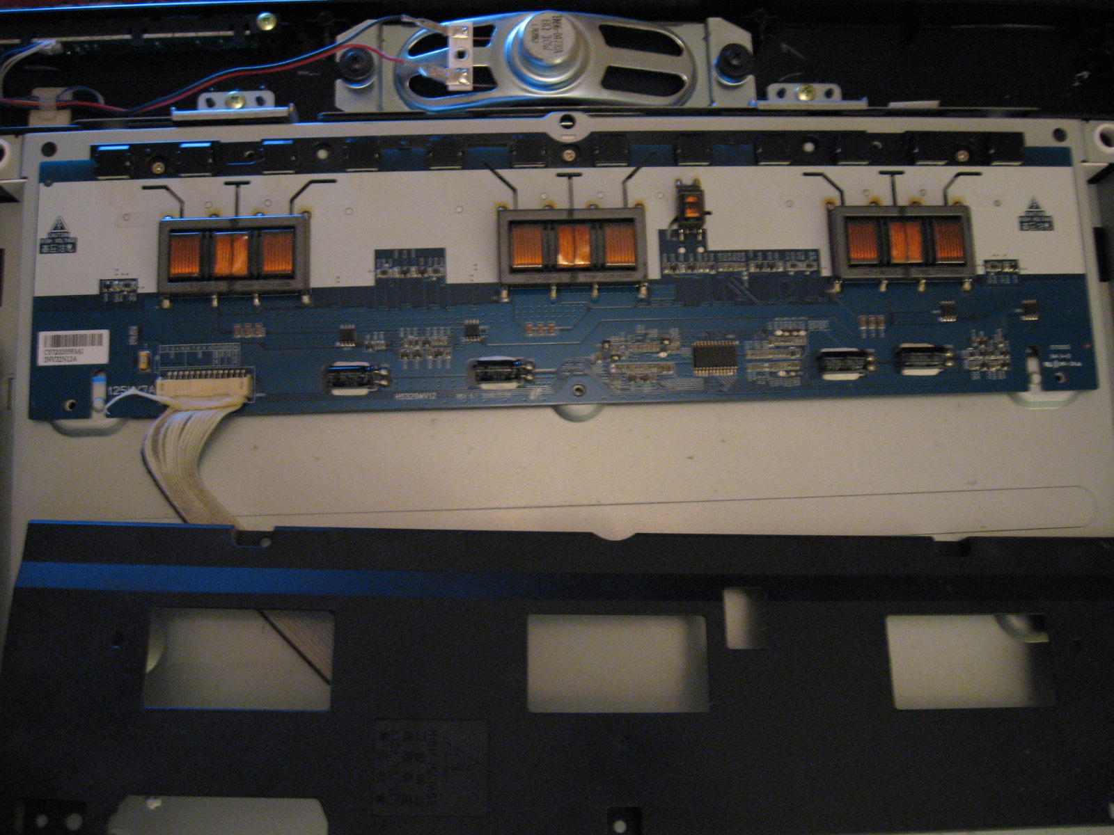

    I have an 'old' Samsung LN-T3242H LCD TV that occasionally works fine for an hour or more. However, most of the time it does not work. When it does not work, it fails in one of two ways.
    1) It powers on and never shows any lighted images.
    2) It powers on, shows a normal image, then after 10-20 seconds, the whole screen starts to flicker, starting at a high frequency of flicker, with a continuously lowering frequency of flicker, and always ends dark. If the flicker failure mode occurs, it always shows the frequency shift.
    The audio continues to work. I also believe that all other controls work, but I can't tell since the screen is blank.
    My guess (uneducated) is the inverter board, but I don't want to arbitrarily start replacing parts.
    I have read another long thread in this forum on a similar failure, but it seems my flickering failure mode is unique.
    Any insights/suggestions?

    Did you open it up and inspect the boards yet?

        Re: Samsung LN-T3242H black screen failure - flicker or DOA

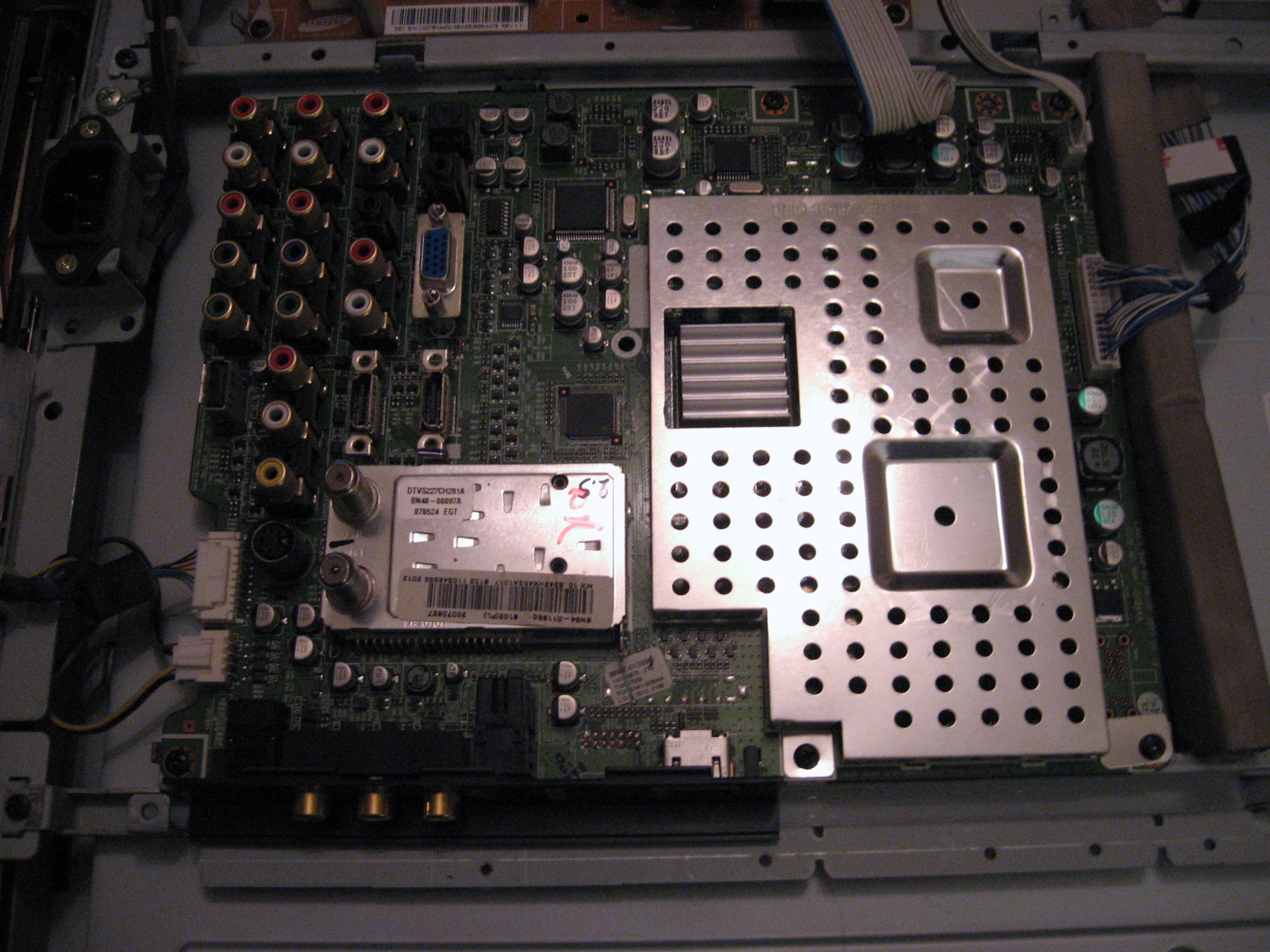

        Originally posted by budm
        Thanks for explaining that photos would be very helpful. I have done the best I can with my camera. If I need to shoot anything better or anything that is missing, let me know. I really don't what to inspect first.

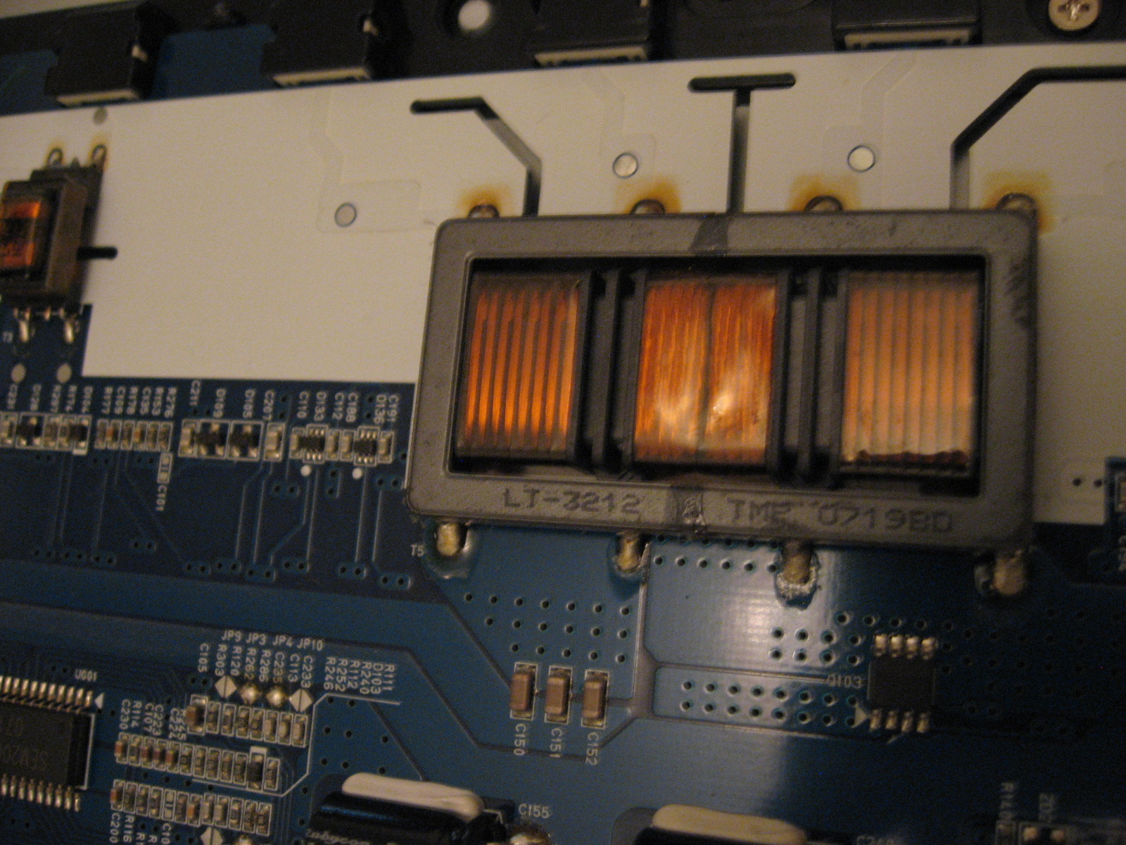

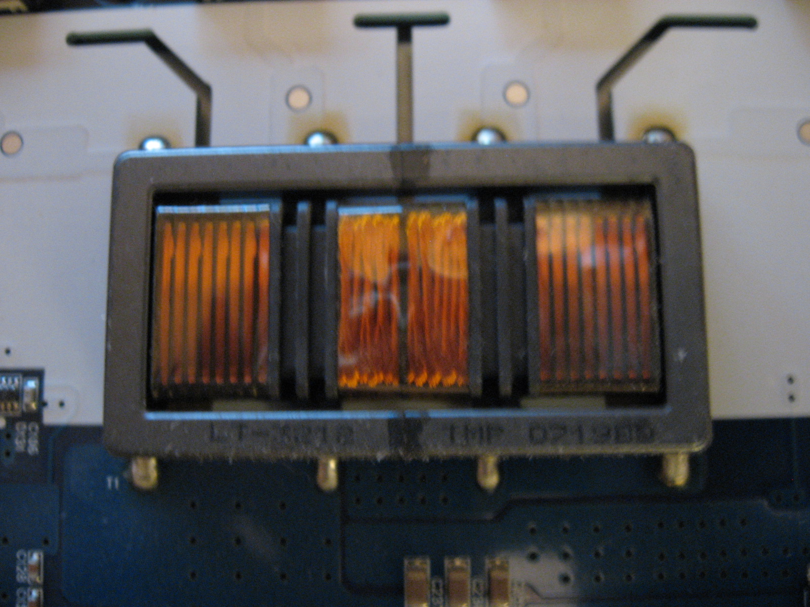

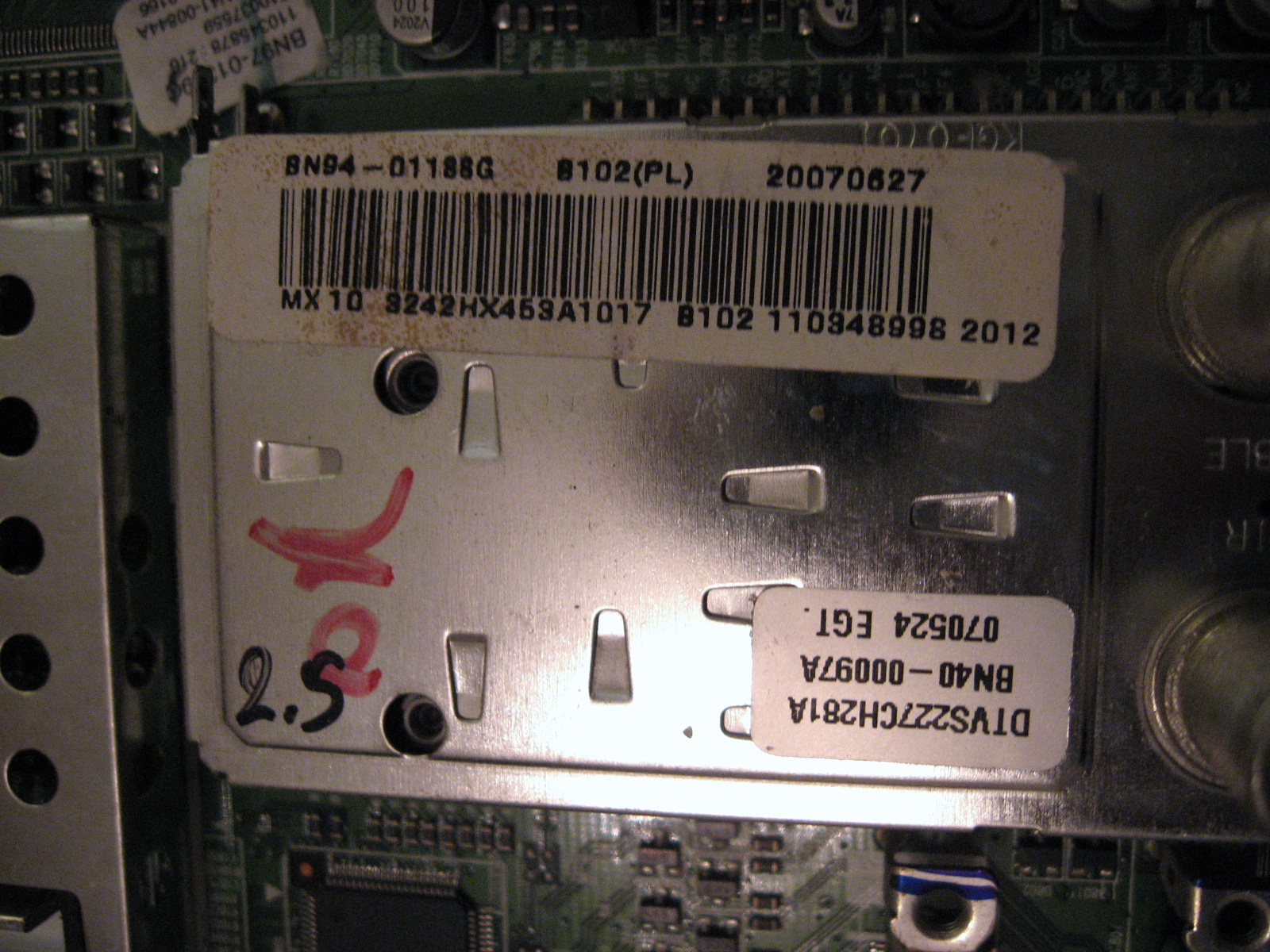

          more pics

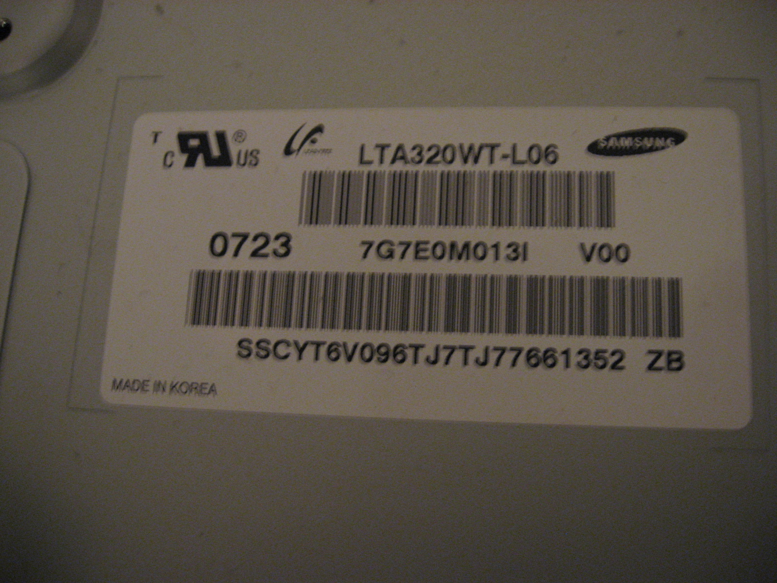

              I have added pics, as suggested (requested). I was hoping that my very specific failure mode would allow some of the more experienced members to shortcut my diagnosis by offering likely causes that I could investigate. Any input would be greatly appreciated.

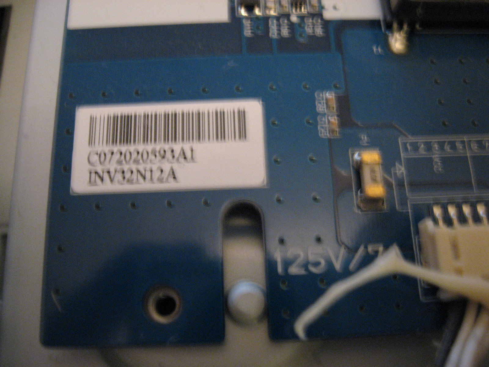

                https://www.badcaps.net/forum/attach...5&d=1415246636
                https://www.badcaps.net/forum/attach...6&d=1415246636
                Way out of focus. It looks like the caps have domed tops.
                  Sorry. I have two problems: no photography skills and a crappy camera. I will try to do better and upload again. Thanks for working with my images and making the suggestion on the caps.

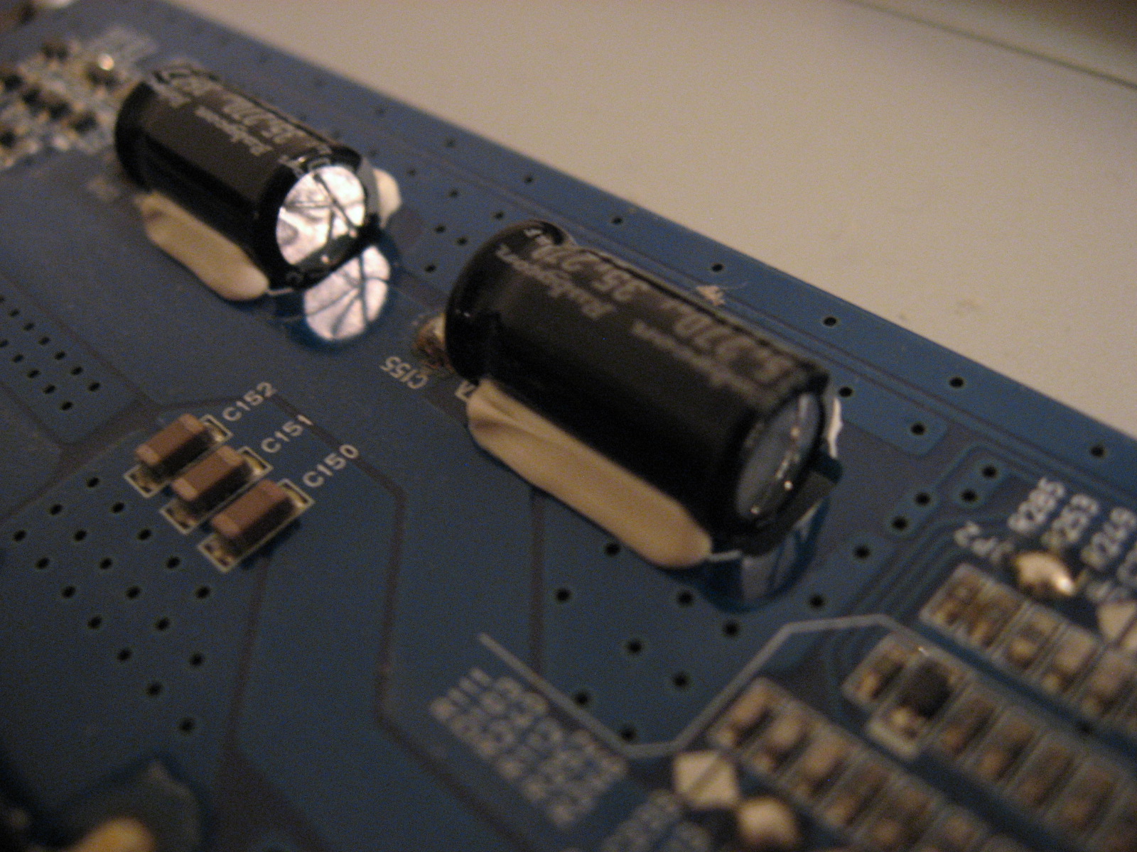

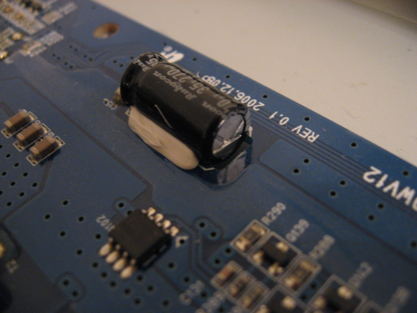

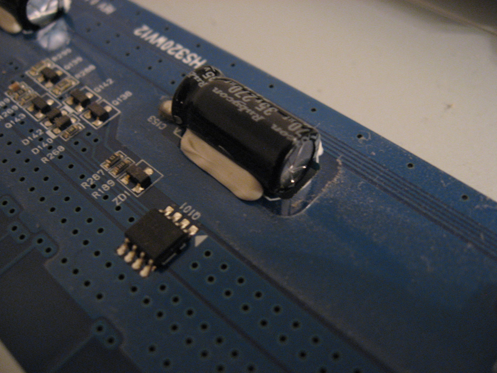

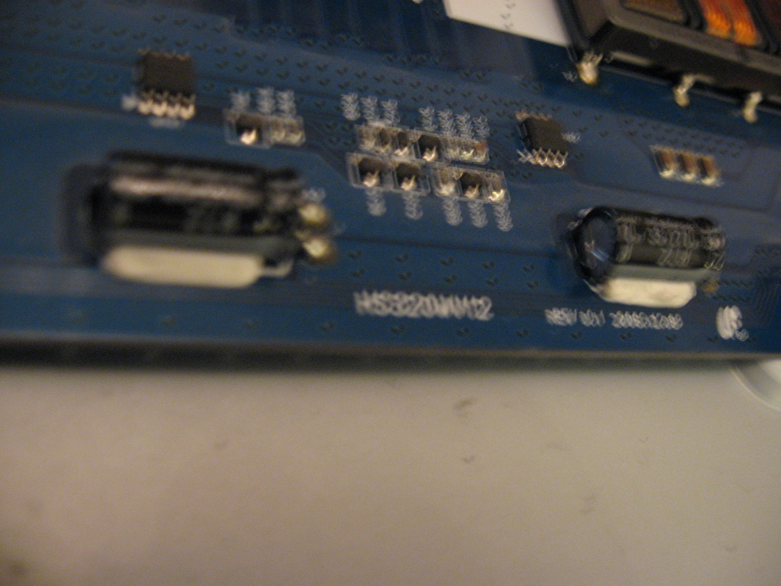

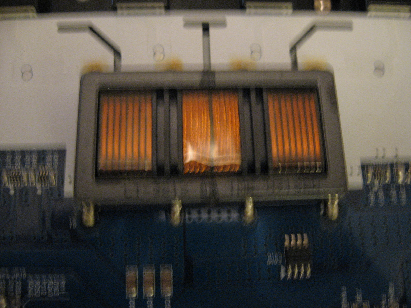

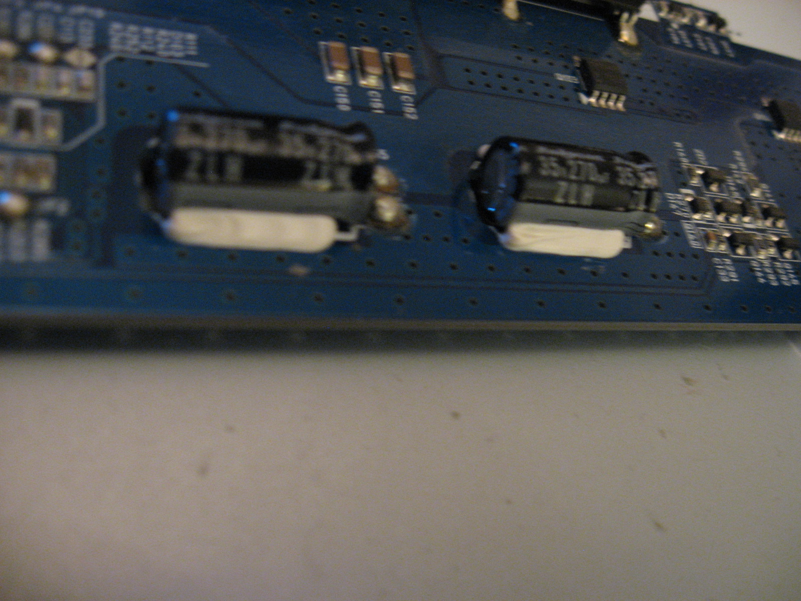

                    New pics of the caps on the main? and inverter? boards. They don't look domed to me, but I welcome others' opinions.
                      OK, little better pictures now and now I can see that the caps on the inverter boards do not have domed top.
                      What you can try is before turning on the TV, heat those caps on the inverter board with hair dyer for a few minutes, then turn on the TV and see if you can see the backlights flicker. Try looking at backlghts through the holes on the back of the LCD panel since we want to make sure the flicker is not due to the T-CON board.
                        Thanks for tip. I did as you suggested, but the TV powered on fine (it does this much of the time). I will retry the procedure after the TV starts failing again. I will be sure to let it cool before I try heating the caps and re-powering.

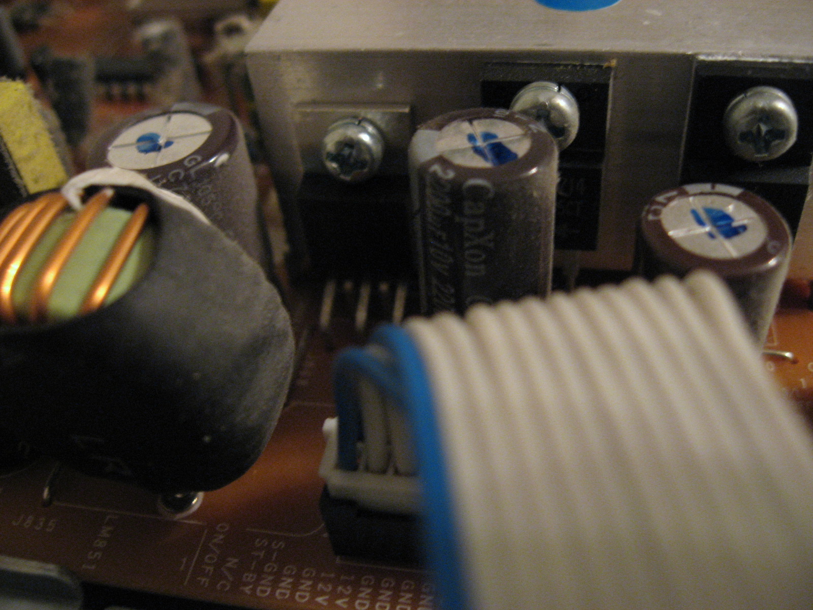

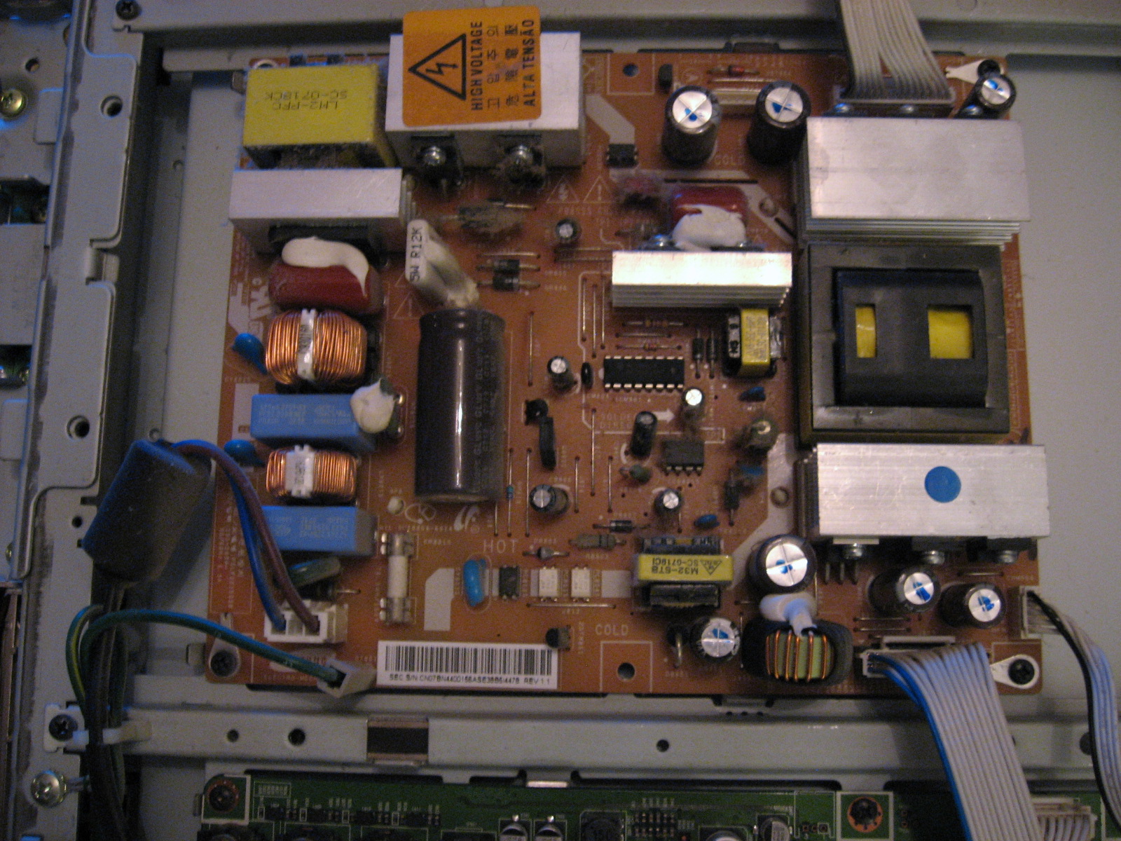

                          Might as well recap the power supply since you have it open if you havent done so already.

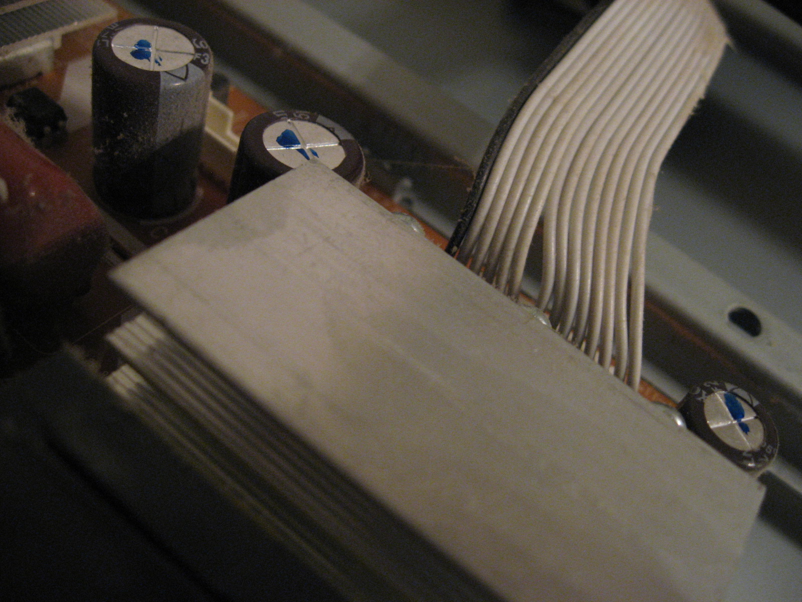

                            Should I re-cap even if they don't appear domed? Should I do both the power supply and inverter caps? Should I upgrade the caps when I replace them?
                              Bad caps can look normal but can have high ESR, or lost of capacitance.
                                If you don't have an ESR meter you can only replace them and hope it solves the problem. Since the PSU capacitors are CapXon brand (and which are quite awful in terms of quality) I would replace them anyway.

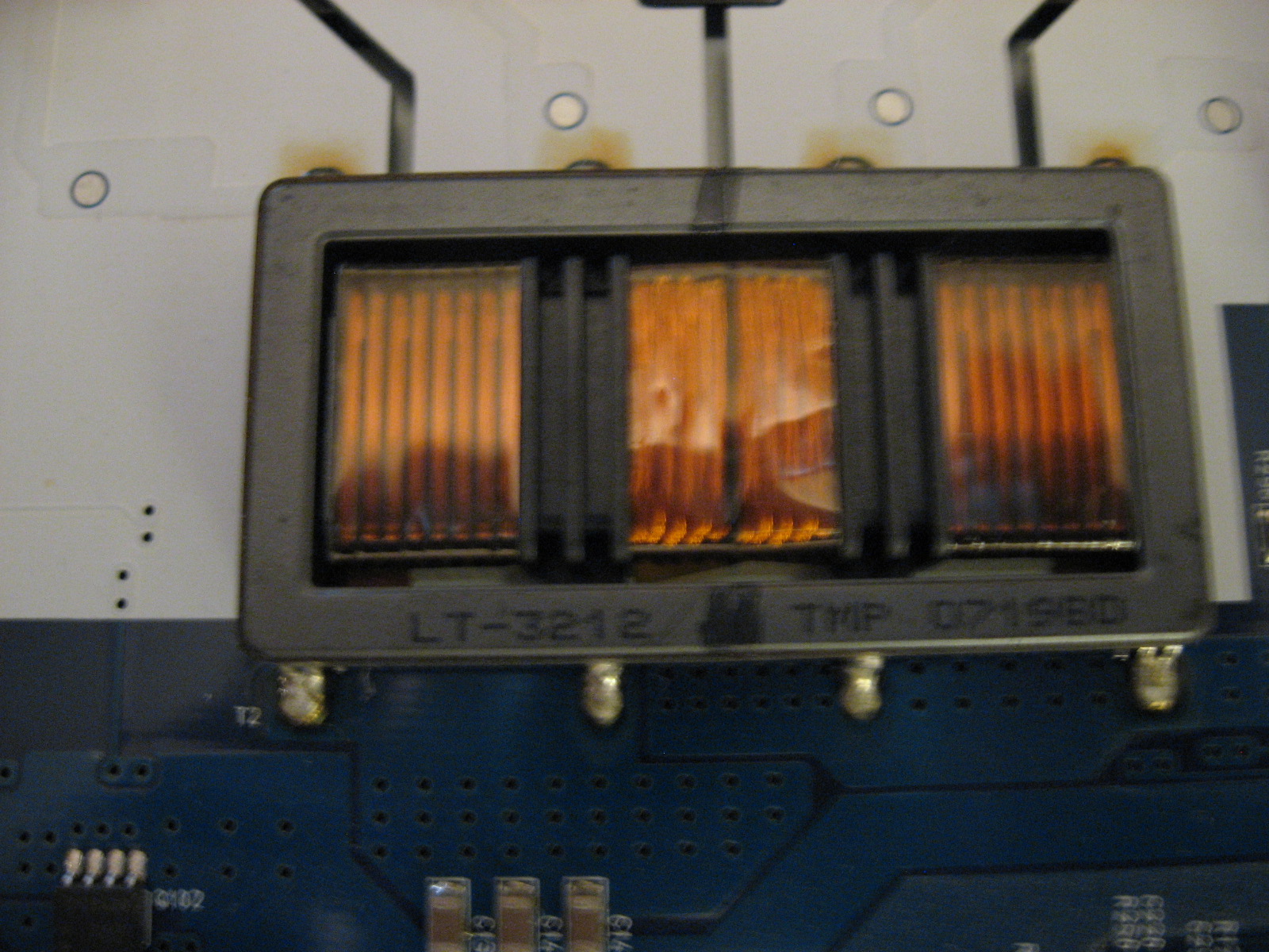

                                  I have an interesting development. The TV failed last night right after I turned it on. Since the back is off, I hit the inverter board with the hair dryer. The screen lit up immediately and the TV stayed normal all night.
                                  Tonight, it failed again on power up. This time, I only briefly and slightly heated the inverter board. The screen lit up, but the left side was a little dark. I used more heat and the screen became normal. It has been fine all night.
                                  I am thinking I have a bad cap (or caps) that do not properly allow some circuit to start up. After it is (they are) heated, the start-up signal propagates properly and the TV is fine until it cools and is subjected to another re-power.
                                  Based on the last two posts (thanks, guys) and my observation, it seems that cap replacement is the first thing I should do. Any specific recommendations on type and brand? Do I first just the inverter board caps, or do all of them?
                                    It certainly does seem to indicate that your inverter is heat sensitive. The situation you describe is classic of half-dead capacitors. Funny though, your inverter uses Rubycon which are a top notch brand and I would expect them to outlast the CapXons.
                                    You could replace the inverter capacitors and see what happens. If the problem goes away, great. Then I would pre-emptively replace all the ones in the PSU as well.
                                    For replacements, you are probably fine to use the same ones that were already in there - Rubycon ZLH. Make sure you get the same size\diameter and value etc.
                                    EDIT: That said... since these are Rubycon, it's possible they are perfectly fine and you have some other heat-sensitive component on your inverter board.
                                      I use PANASONIC FM/FC/FR for all my repairs.
                                      Your problem is similar to this inverter board:
