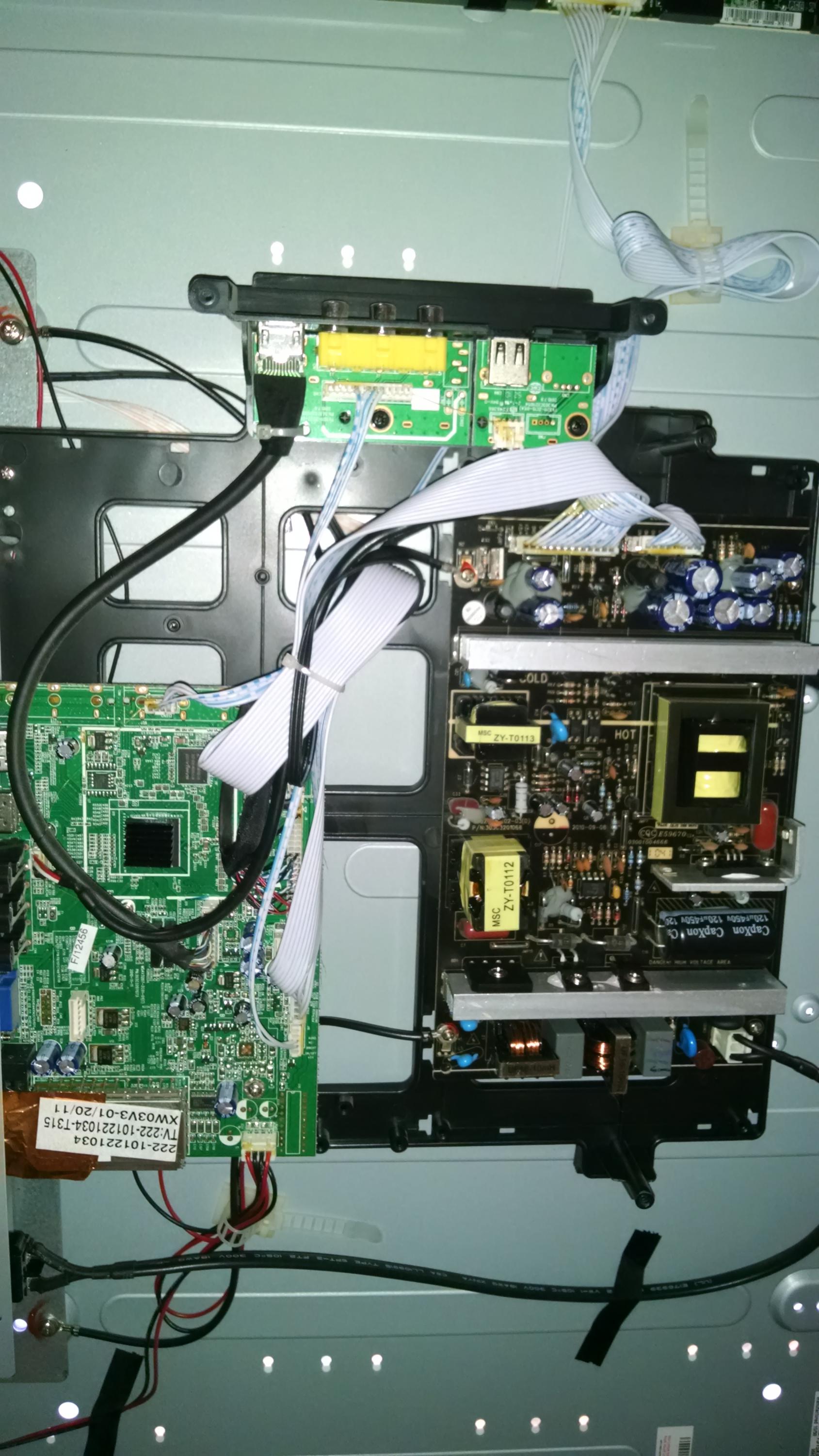

    I have this I symphony LCD where the owner says it shuts off he mentioned after 15 min to an hour. Caps look good. I do see a wire that brown where it may have gotten hot.
    Any ideas? Thanks

      Check the processors on the mainboard (the ones with heatsinks on top) and see if any get hot while the TV is on. After several years of use, they age and use more power. On some TVs bigger heatsinks on the processors may be necessary.
