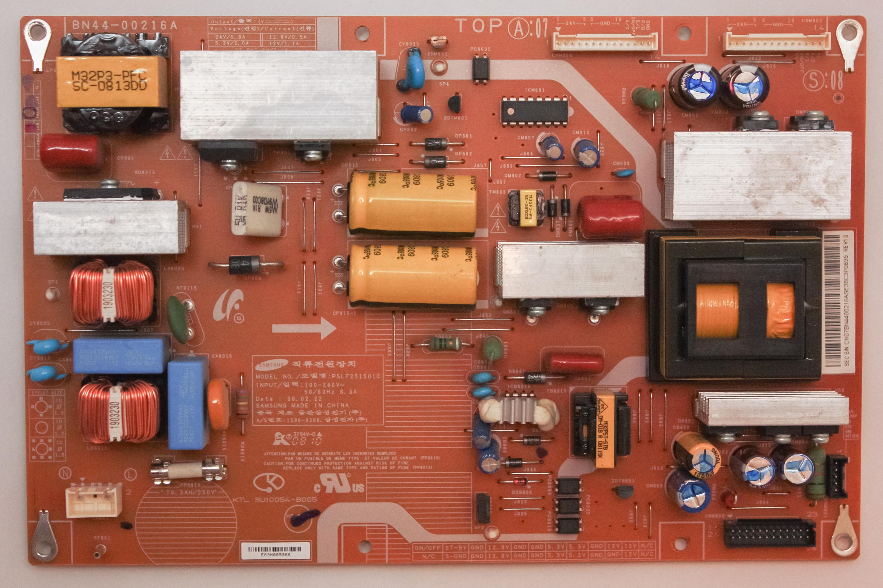

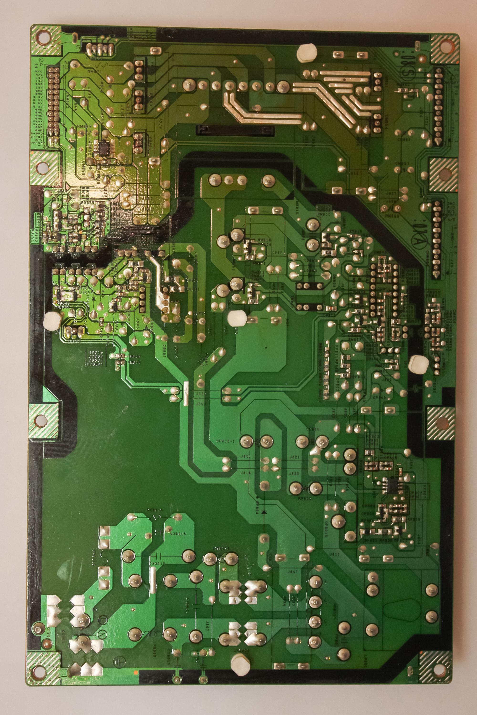

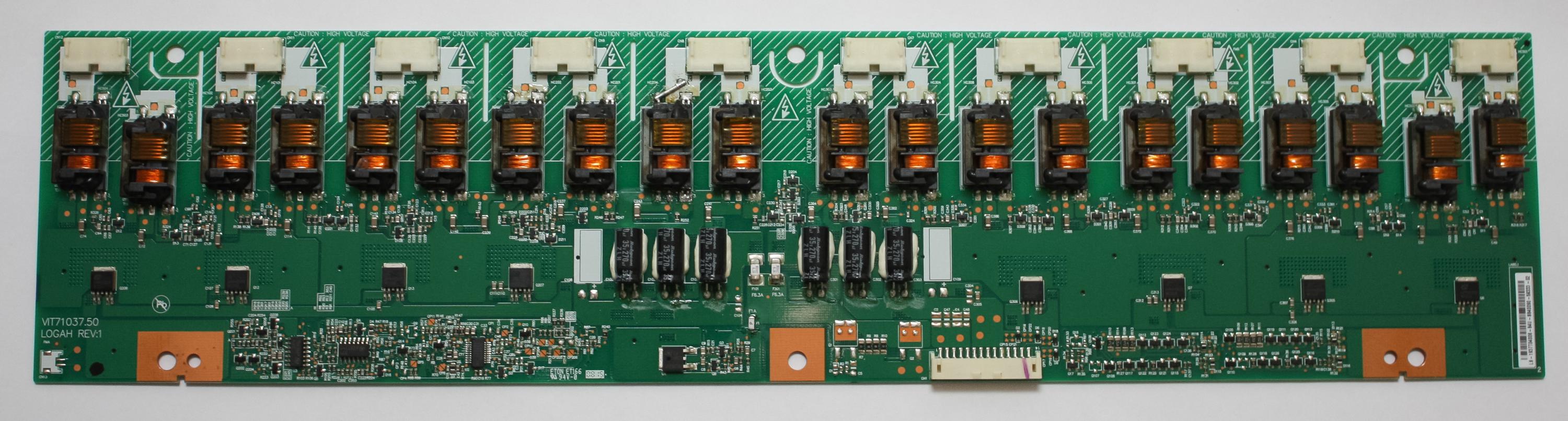

    Hi everbody,
    I have a problem with a Samsung LE37A659A1F, similar to https://www.badcaps.net/forum/showthread.php?t=37809.
    When I turn it on, the LED blinks five times. The backlight does not fire up, but there is sound.
    I suspect the inverter board (Logah VIT70037.50) to be defective: Fuse F1 was blown and replaced, and a pad from one of the transformers was loose and disconnected, so I just soldered it to the plug (see image below).
    The measurement on CNM 803 from the power supply (BN44-00216A) to the inverter board is as follows.
    24V on pins 1-5
    A/D - 3.5V
    B/L - 5.1 V
    ON-OFF - 0V
    The latter should be 5V I think. Would the ON-OFF signal be generated by the linear regulator below the fuse F1?
    What would be a good approach to find out what's the problem here?
    Re: Samsung LE37A659A1F - No Picture, only Sound
    The ON/OFF signal is generated by the main board. You can try using 1kohm resistor to 5V supply to turn on ON/OFF signal.
