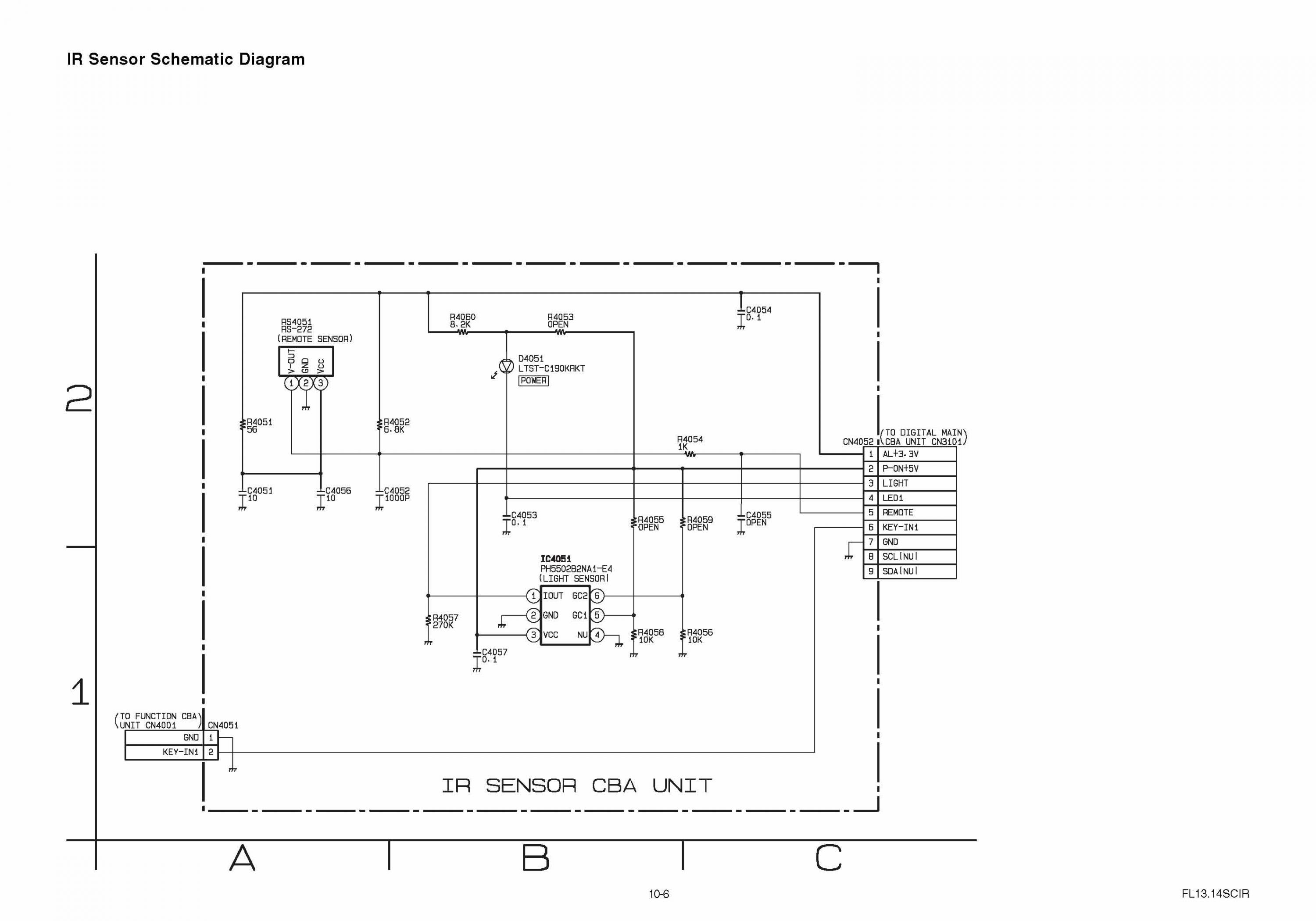

    Can anyone help me trouble shoot a magnavox 46me313v/f7. I am very much a novice when it comes to tv repair but have fixed a couple for myself and friends. Original issue was when u plugged in the indicator light would flash continually so I suspected bad components on power board. I purchased a used power board and when installed the tv would then start up as soon as u plugged into power would stay on 10-15 seconds then power off and repeat until power was disconnected. The only way I could keep it from continually powering off and on was to disconnect the connector for the ir sensor board. If i disconnect then reconnect it goes into standby mode. If u hit power button it starts doing same thing. Any ideas as to what could cause this issue?

          I will post pics asap, in mean time I do have schematics. They should be attached if they upload properly.

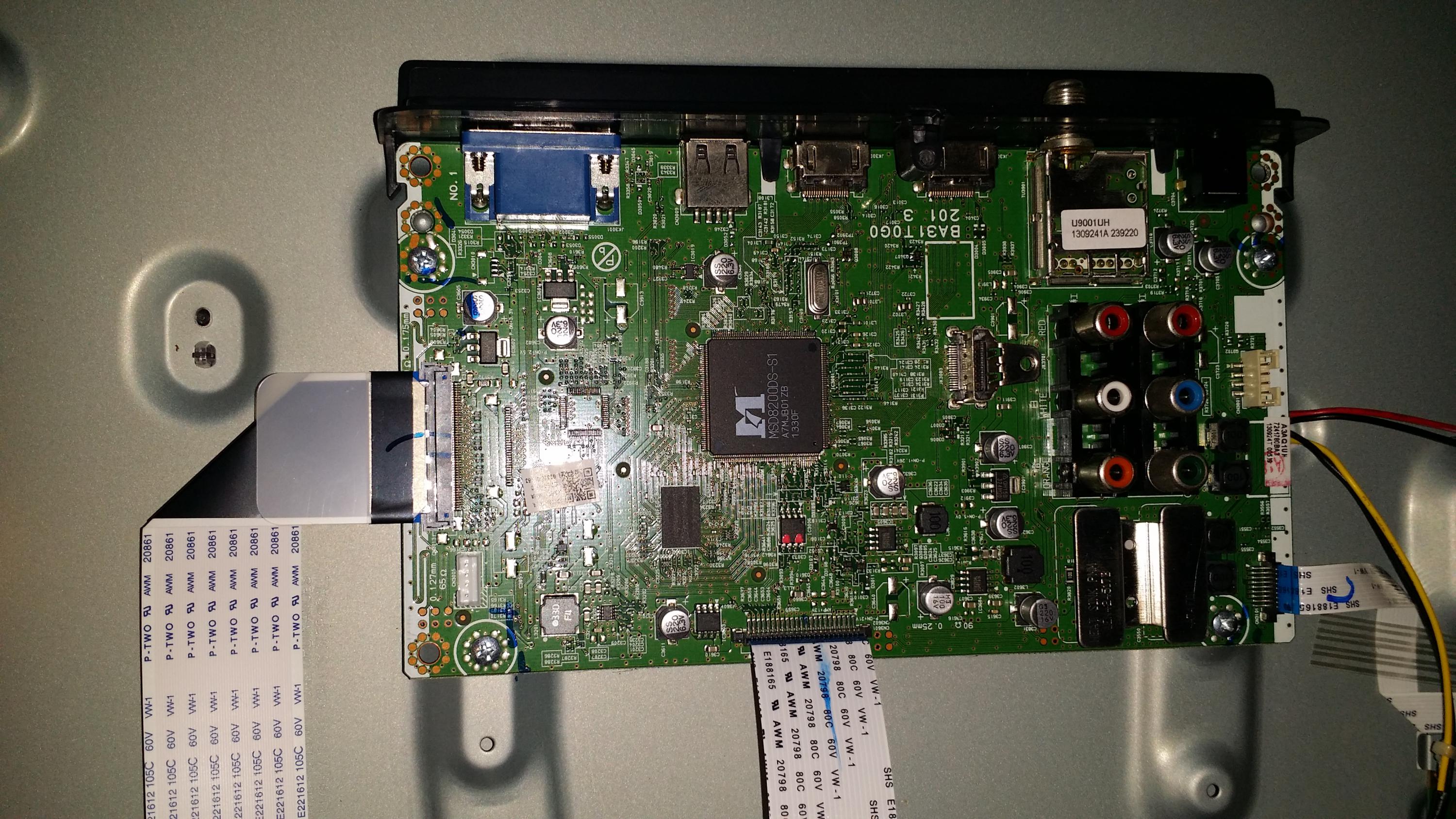

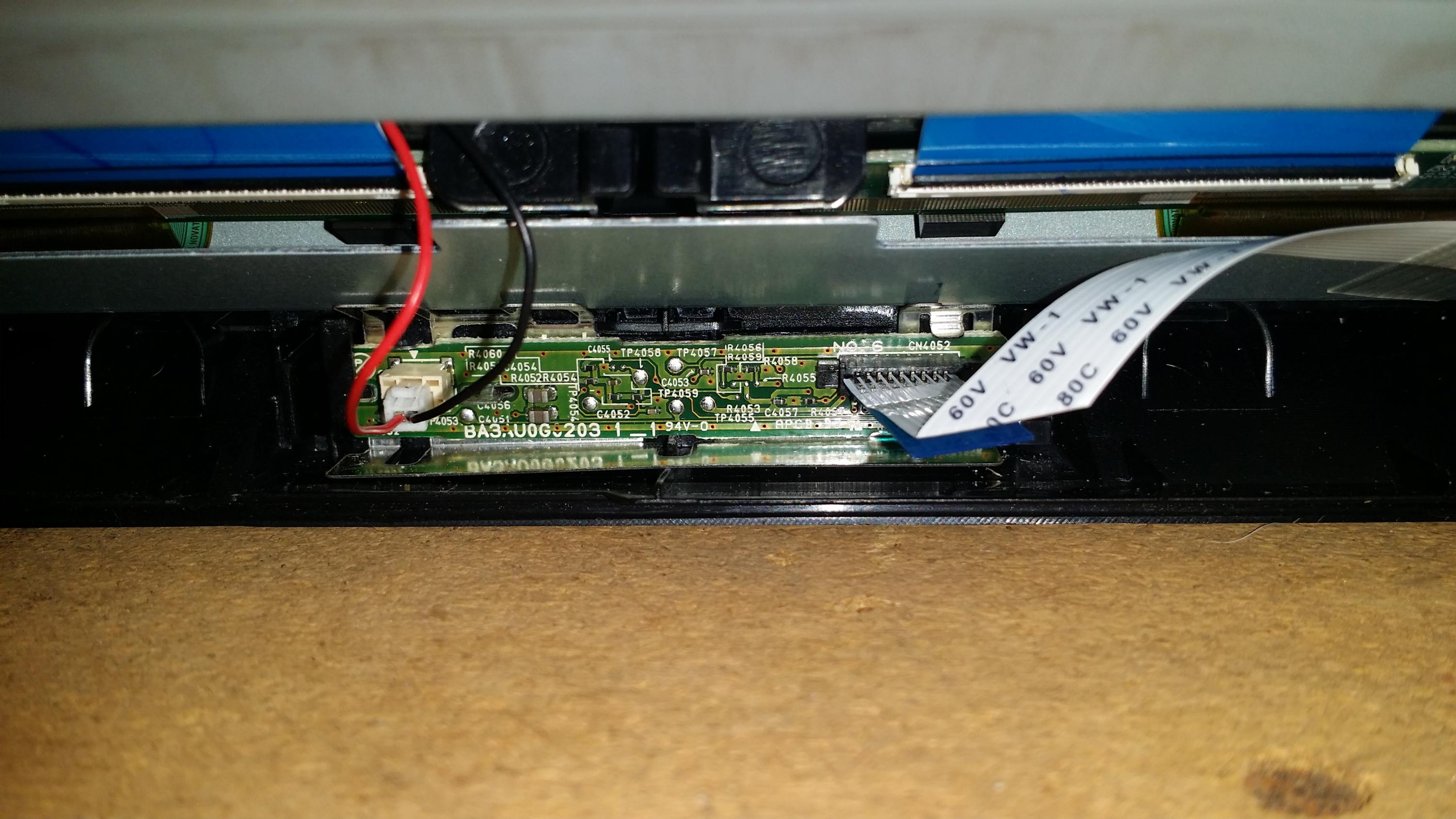

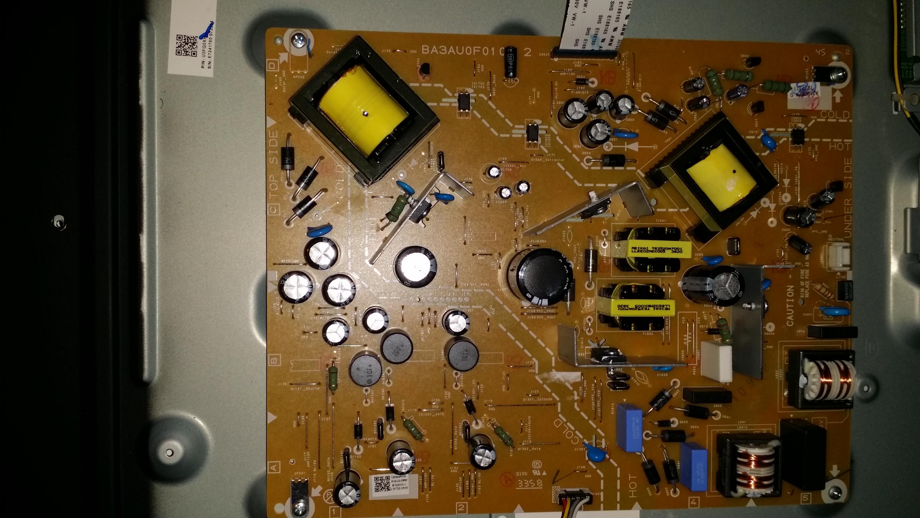

                Here are pics of boards

                  OK, we can try killing the output signal for the IR receiver output by shorting pin 1 and pin 2 of the IR receiver and see if the problem will go away.

                        Shorted pins 1 & 2 and there was no change. Continued to power on and off
                          Re: Magnavox 46ME313V/F7 powers on and off
                          OK, check the resistance between pin 1 (3.3V) and pin 7 (GND) to see if it shows low resistance, the check the DC Voltage on the same two pins to see if it shows 3.3VDC.

                                      That means the resiStance at pin 3 (VCC) of the IR receiver MUST BE <1 Ohm. Check the resistance on pin 3 and ground of the IR RECEIVER. Cap 4051, or 4056, or the IR is shorted.

                                        Pin 3 is 268 ohms
