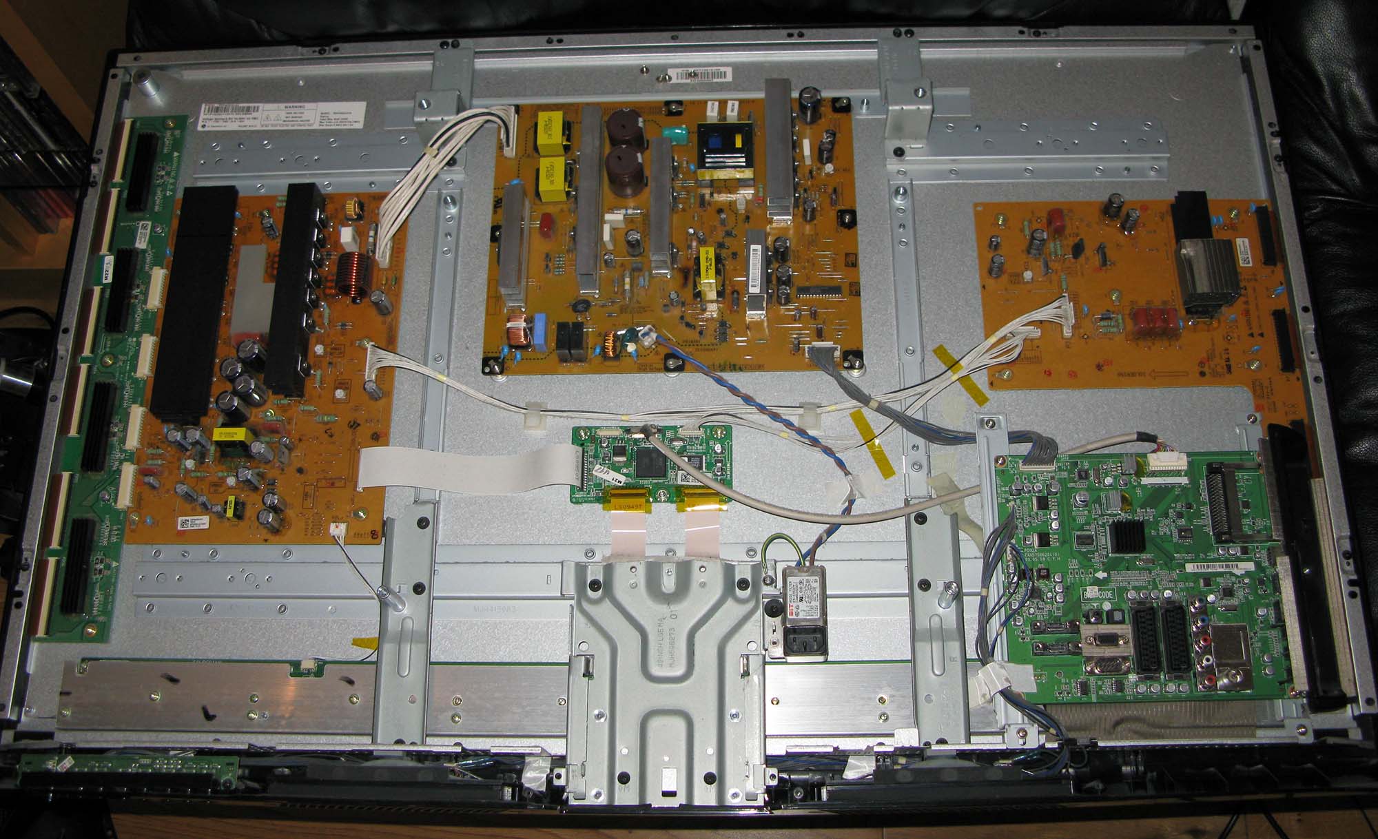

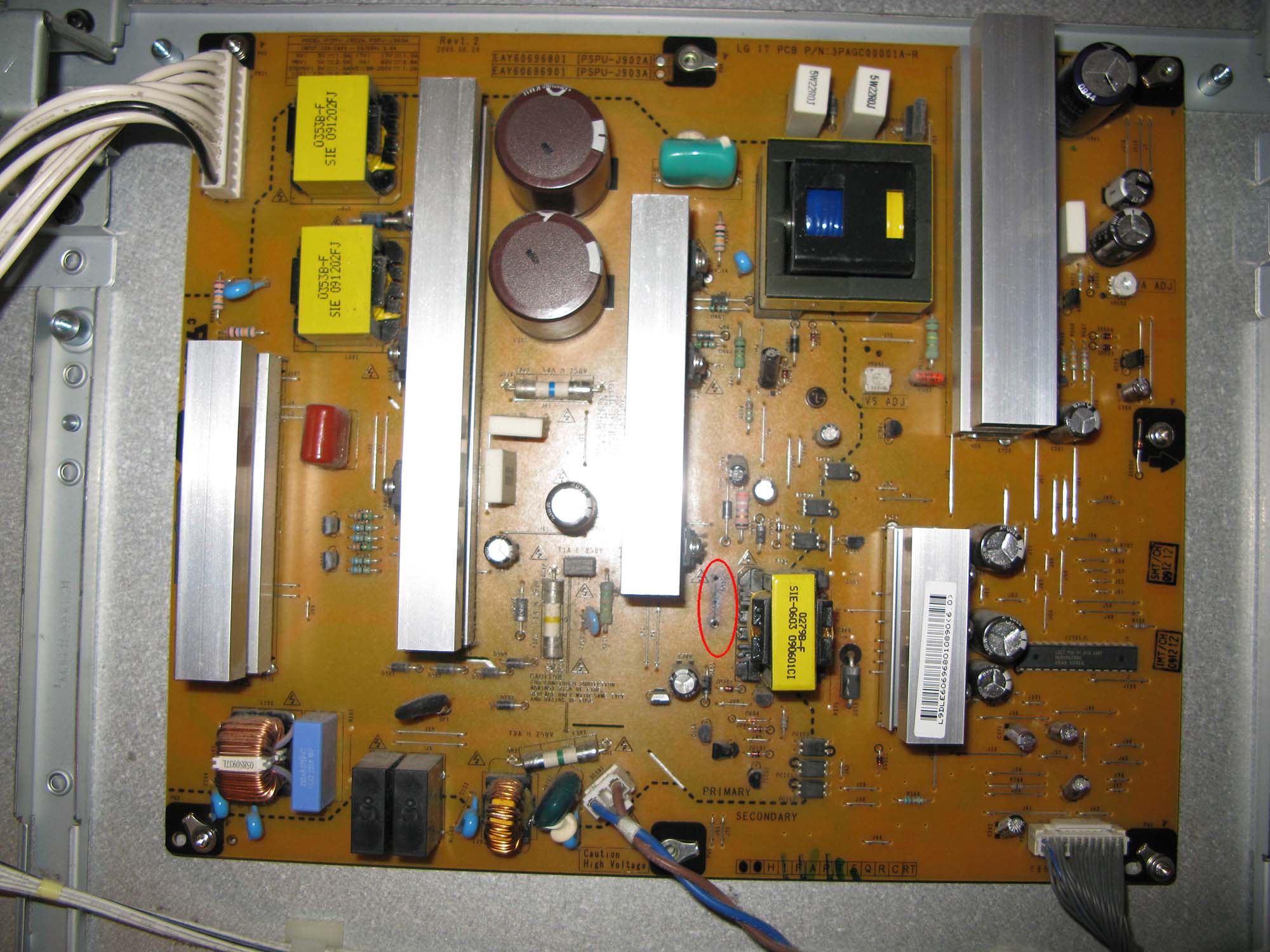

    Hello all
    I've got a LG 42" plasma TV (42PQ3000) that won't start. Relay clicks for about 30 seconds with a red flashing standby light. I've isolated the X & Z sus boards with the same problem. Upon closer inspection I noticed a fried diode (highlighted in red) which I removed for identification (1N4007). Is it likely the IC (W6252) beside the dead diode on the heat sink is also faulty and is there and easy way of testing with a multimeter. Thanks for the help.
    Mark

    Re: LG 42PQ3000 Plasma TV Not Starting (clicking relay)
    I got the exact same problem but my diode is not the problem....
    Im going to test the 22 Ohm resistors this afternoon see if they are ok.
      Yes I tested the 2 x 22 Ohm resistors at the top of the board and they tested ok.
        Start checking if the standby rail, 17V, Vs and Va are working.
          Hi Tom
          Thanks for the help again. I'm getting 5v on the standby pin, getting no power at all on both the 17v pins when switched on. Can't see the VA and VS test points, can only see the VA and VS adjusters ?
            Check Vs/Va at connectors to Y-sus...
            Check all fuses on PSU board.
              All 3 fuses on PSU good, fuse on Y-Sus good. No voltage at all on both VS and VA on the Y-SUS connection when switched on.
              thanks
                Check the control signals from the main board then, see if it's sending the turn on command (VS ON, RL ON, M5V ON etc)
                  Getting very erratic readings
                  In the off position
                  STBY_5V ranges from 0.5-3.5v
                  KEY_ON ranges from 4.3v-5v
                  M5V_ON 0v
                  VS_ON 0.0v
                  RL_ON 0v
                  In the on position
                  STBY_5V ranges from 1.8-3.9v
                  KEY_ON 0.3v
                  M5V_ON ranges from 0.05 0.1v
                  VS_ON 0.0v
                  RL_ON ranges from 0v-2.4v
                    The bouncing STBY 5V should be investigated.
