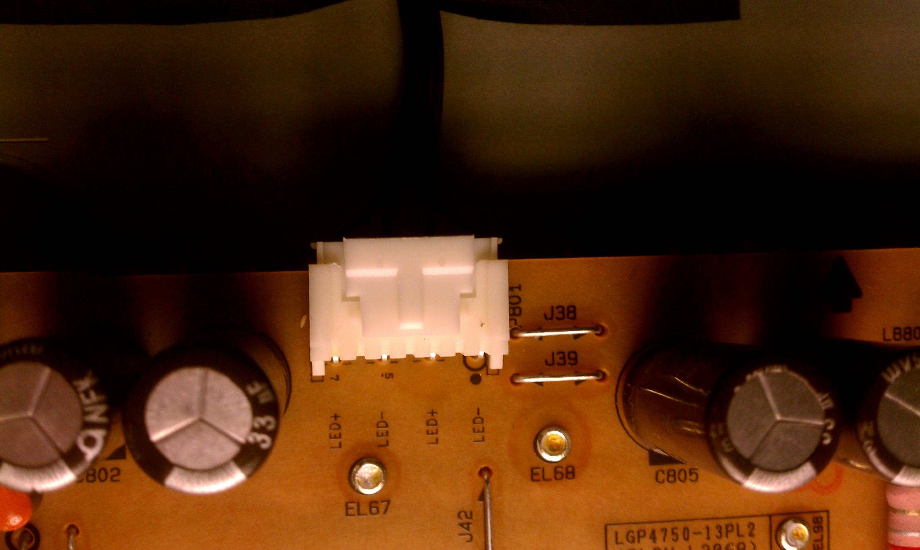

    i came across an LG tv with a busted screen so i took everything apart down to the led strips. im thinking i should be able to use this to plug into other tv's that have the question: "is this LED driver problem, or LED strip problem?"
    which is hard to answer it seems...without opening the panel which is a big deal.

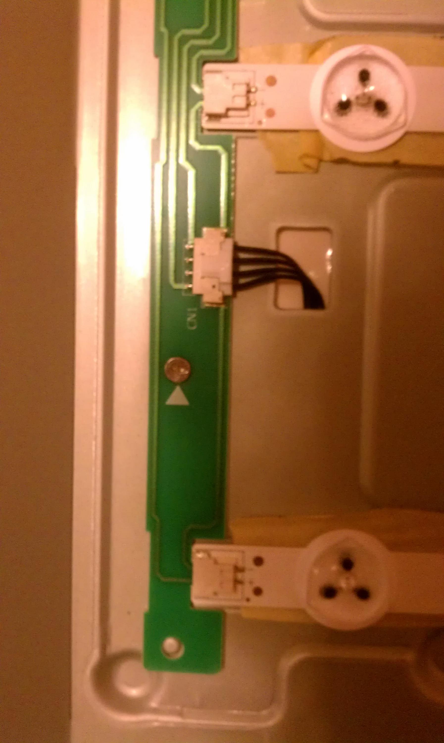

    upon closer inspection i realized that the strips are split in the L and R but each L and R are combined to make one long strip
    the 4 pins coming from the power supplys LED driver are 2 pairs of + and - for the led's
    each +- pair drives 3 of the strips in series

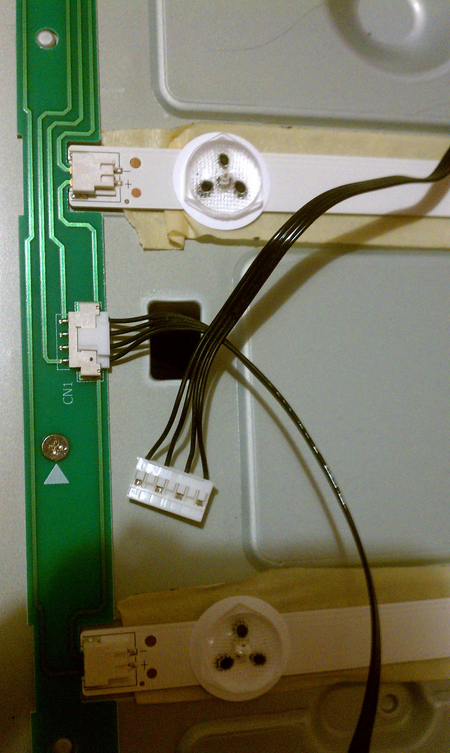

    i guess i just want to use this as a tool for learning and diagnosing other TV's but im still foggy on a few things. or uh...a lot of things.
    if i unplug one of the strips, the circuit is not completed and the rest of the strips only just flash for a moment and turns off..as to be expected...
    but if there are 2 pairs of the +- and they are each driving 3 strips on a separate circuit, why do all the strips go out instead of just the 3 that were on that circuit?
    something in the driver notices all the strips arent on, so shuts it all down, i guess?
    if i just took a wire and bridged the circuit where i removed one of the LED strips, what would happen? would they all come on, but they would use more power than they were supposed to and then burn out?
    like if it was meant to run 6 strips but i bridged all but one of them, that one led strip would receive all the power meant for 6 strips and then blow up?
    and ultimately...how can i actually use this device to test other TV's LED strips? specifically this one for the sony bravia 55 inch:
    https://www.badcaps.net/forum/showth...t=39670&page=4
    but on that one i have 4 sets of +- pairs .... how would i go about rigging that up?

      on the sony bravia 55 inch there are 4 negative pins on one connector and 4 positive pins on another...so 4 +- pairs...if its anything like this one i have (the LG i stripped down to psu and backlights) then each of those +- pairs drives a certain number of LED strips in series. do the numbers have to be equal? im not so sure, because they are in series you could hook up odd or even numbers of strips... for example on this LG there are 3 strips per +- pair but i dont see why they couldnt have been 4 on one, and 2 on the other... but then the psu would have to give them
      different voltages?
      am i correct that the voltage coming out from the LED driver circuit cant be tested with my cheap multimeter?
      just like the voltage coming from the inverter boards going to the back lights?
      if you were asking if the voltage for the led driver in the sony is the same as the voltage in the LG, i dont know that either because im afraid to just try testing volts there

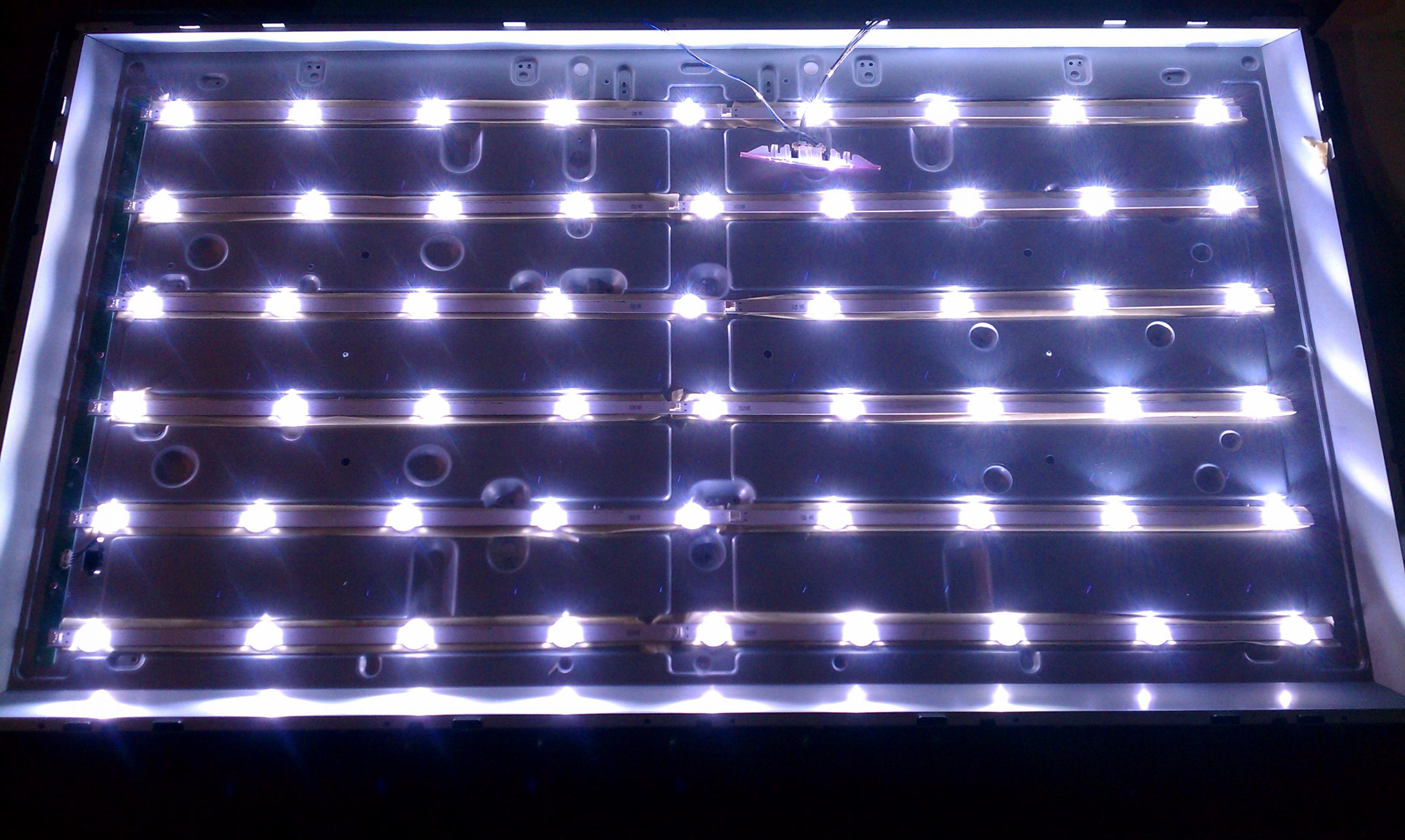

        Exactly. I assume most use a fairly standard voltage (eg: 12v), if they do, probably you can swap them.. otherwise, maybe not (or you may burn them out)
        Of course, since it's just LEDs, not something complex lile CCFL with strking voltage, surely any dummy load made of resistors etc would work to test the LED power supply? Then again, maybe they do have some trickery to their operation and I am wrong.

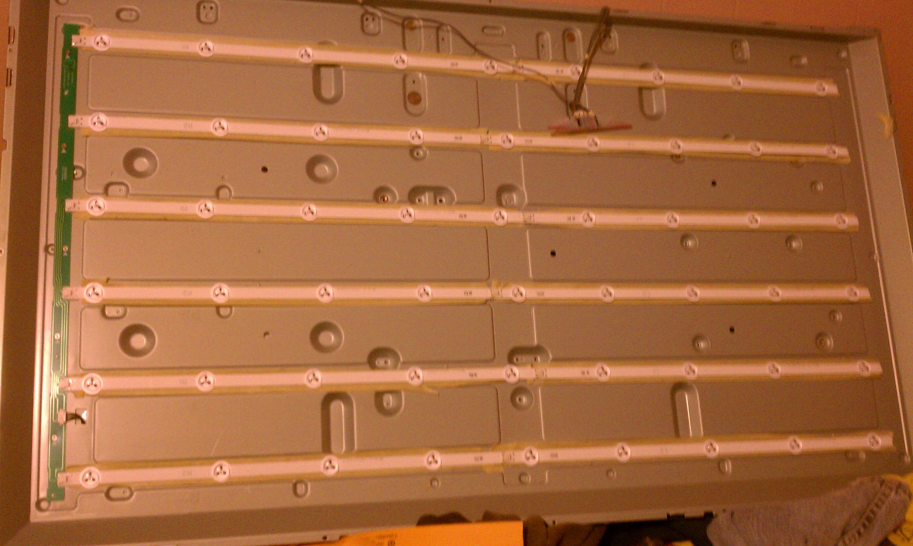

                  yes in the LG that i have stripped down to the PSU, panel plate, and backlights there are 6 strips. each strip is actually 2 smaller strips that fit together to span the whole width of the screen.
                  but i think when they are connected like that u count them as one strip, right?
                  so yes 6 strips.
                  there are 4 pins going to the strip-board. labeled +-+-
                  one of the +- pairs runs 3 of the strips in series
                  the other +- pair runs the other 3
                  how can i tell the driving voltage coming from the psu? can i measure it myself? or do i have to just look it up?

                              i did trace it... there are 2 +- pairs and they each drive 3 led strips in series
                              we call those 3 strips in series a string?
                              so yes it is 27 per string...27 per +- pair
                              so its safe to check those voltages? and amps too?
                              Don't fear the repair...
                                Re: use spare led backlights from one tv to test the led driver of another tv?
                                27 LEDS x 3.1V (or 4V) = 83.7V (or 108V) so measure the Voltage at LED + LED -, the Voltage reading will not show up as calculated since the are may be PWM driven. So check the voltage to see what you get. Getting the IC spec sheet will give you more details.

                                  How about using a 20-40W 120v bulb in place of the LED to see if the supply runs it....?
                                  TELEFIX
                                    40W cold resistance will have cold resistance around 36 Ohms (Hot reistance will be 360 Ohms) so the current sensing circuit will cause the power supply to go into shutdown mode due to current of of over 2A @ 83V at first power applied.
