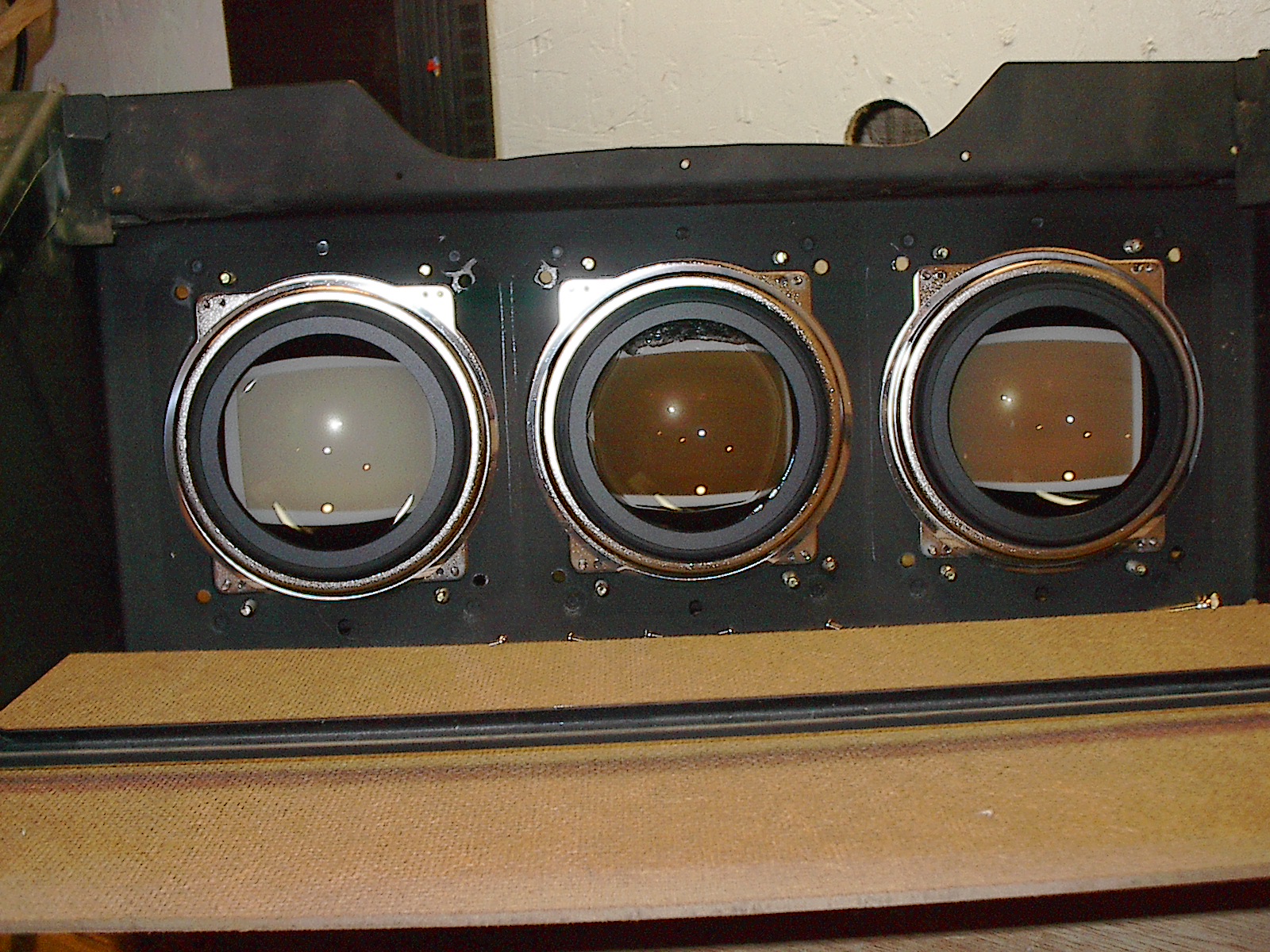

    Oh, so those three large 'lightbulbs' are actually CRTs? I've always wondered how the older video projectors and projection TVs worked (before LCD). I've seen projectors that have red, green and blue tubes to project onto a wall-mounted screen, and I've also looked inside a projection TV and seen them (with a mirror to get the image onto the screen).

        Yep, they are actually just 3 small monochrome tubes, one for each color. They are liquid cooled because they get very hot.
        That one was not out of an arcade machine, but I do have some that are. It only takes a few months to burn the phosphors when the exact same image is on the screen 24/7.
        My guess about the tubes in the pic, is that someone watched tv all the time, and had the tint adjusted too green. The green tube is in the center and has by far the most wear. The white ring around the outer edge of the tube face is unused phosphor.

        Regular CRT's can be burned too, it just takes longer. This is how they look after 25 years in the same game...

              I remember seeing that pic in one of my older threads as well. That one is burned in really clear! There must have been pretty good electronics in the monitor not to have any drifting of the picture for that long.
