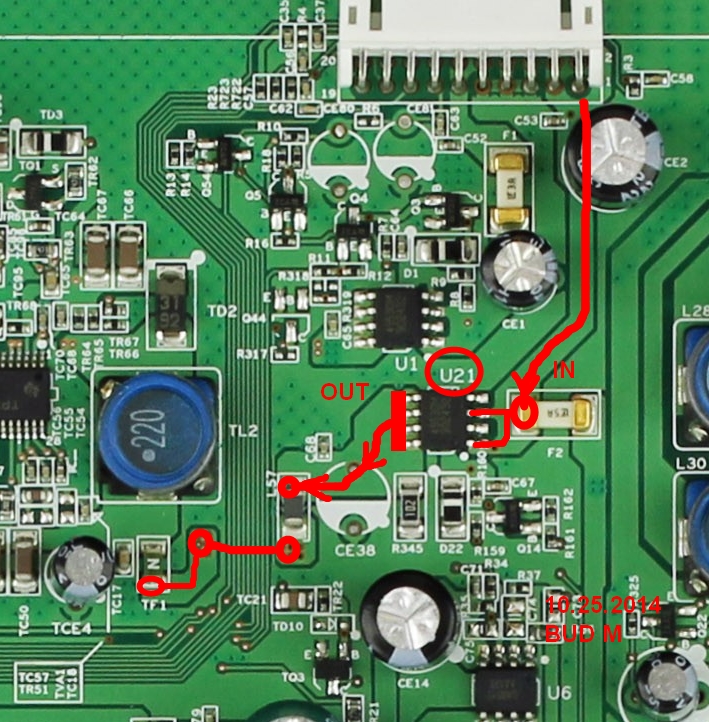

        OK, if I traced out the board correctly I believe U21 is the switched MOSFET that supplies the Voltage to the fuse.
        So use Ohm meter to check the resistance between the fuse and the out pins of the U21, it should show < 1 Ohms or so, if it does, then check the DC Voltage on the Input side of U21, should have DC Voltage on it, then take the reading of all the pins of U21 when TV is OFF and when TV is ON. I also need the P/N of that U21.

          It also looks like F2 is a fuse on the input to U21. If nothing is coming out of U21 check F2 to see if it has continuity.
            Re: Vizio 32" VO320E Intermittent Issues
            Fuse F2 left terminal is directly connected to the connector so as U21 input so it is not used for feeding Voltage the input to U21, if I remember correctly, that is the fuse for 12V which feeds the 7805 IC and the audio circuits.
              If this were a game of 'hot and cold', I'd say we are near fire! When I checked the resistance between the fuse F2 and U21, on the inputs I was getting '0's on the pins that I'll call one and three (the ones that budm's drawing did not show connections to) and 0.58's on the other two pins. When I checked the output pins, they rapidly were increasing in resistance. They would start around less than one and rapidly climb. Not knowing if that was right or not, I turned on the TV and the voltage on all input pins was 12.18v, same as the fuse 2 voltage, and the outputs all had 0! Similarly, all components down the line in budm's drawing had no voltage either. U21 PN is 4953_M, 932154. The underline represents a number I could not read, it looked to either be a 0,6, or 8. The 'M' was printed very close to that number. Is this our smoking gun? Also does anyone know the part number for Fuse F2?? It's a 5amp.
              Also, I have been reporting that sometimes the backlights turn on and sometimes they don't, well I am starting to see consistency. The first time I plug in the TV and hit the on button, backlights will come on. Anytime after that, not the case.
                "the ones that budm's drawing did not show connections to" I do not show that because you can clearly see that the input is connected directly to the left side of the use and goes to the white connector. Do not worry about the fuse, we know that the fuse is good otherwise you will not have 12V feeding the 7805 regulator.

                  To BudM in your picture you have F2 connected directly to U21 pins 1&3 also, you have pins 5,6,7,8 connected together. That only leaves Pins 2 or 4 which I do not know if they are connected together, but one would seem to be gnd. It would help if there was a part number of U21 so we could look up the function. Perhaps it is an inverter, when input is high output is low. I do not know?
                    #29
                    That is the dual P-CH MOSFET, so there are Gate pins on it which we need to find out if it will change state when TV is off and when TV is on, if there is no change of state, then the processor is not sending the Gate drive signal, if the Gate drive signal is present, then it can be the bad MOSFET.
                    It is the same MOSFET 4953 as used in the other thread I have the link to.
                    Input pin 1 and 3 are the Source pins, pin 5~8 are the Drain pins, pin 2 and 4 are the Gate pins.

                      So my understanding is the D to S voltage in this case is 12.18 volts and when the G to S voltage gets to 10 % of -12.18 volts the MOSFET conducts and then there is a time delay for it to trigger on fully and stays on until the G to S drops to 90% of -12.18 volts turning off the MOSFET which again has a time delay to fully trigger off which is the state this MOSFET is at present? Should there actually be a pulse train of timing signals coming out this MOSFET or is this like a one shot condition?
                          The MOSFET is just being used as a simple switch, it is either on to provide the 12V to run the T-CON circuit or off to kill the power to the T-CON when the TV is off or in standby mode, the GATE gets steady state, in this case it is P-CH and the Source is at 12V so the Gate will have to be pulled LO toward ground, no pulsing, it is static state either HI or LO signal to turn on the MOSFET. WHen TV is powered on the processor will send out the signal to turn on the the power supply, the inverter, the T-CON.

                                  Well, from the voltage readings, the MOSFET is not being turned on, the Gate Voltage has to be at least 2~3V lower than the Source pin.
                                  I do not know what happen as to why you now have new problem. You did not accidentally connect the jumper to the Gate pins?

                                        F2 is not used for feeding the Voltage to the U21, it is used for feeding the 12V to the 5V 7805 regulator and power amplifiers circuit.
                                        "because if I understand it right, it's not even getting power to it since I have no 12 volts at the power supply and none at F2." and that is because the main board is no longer sends the PS_ON to turn on the 12V power supply, and you can tell because the Vizio logo did not turn white.
