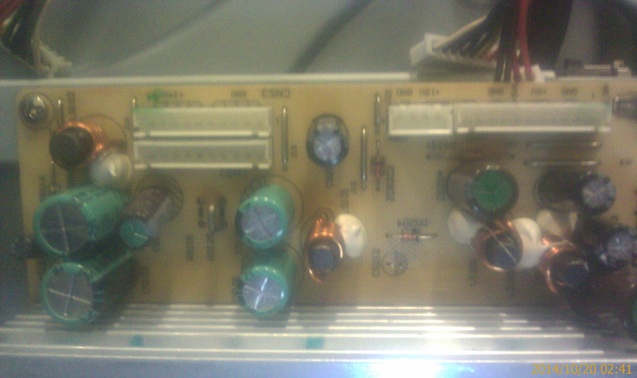

    got this tv for free....wouldnt pwr on.....when pwr button ht....the front light blinks red fast......
    i took apart saw 3 caps bulged 330uf...1000uf and 220uf
    replaced with good panasonic fr digkey....still no pwr...red light just blnks when hit pwr button
    i do get 5v standby...actually 4.97v
    no other voltages....this bd has a pwr on pin....should i try jumping it with 5v?
    any ideas?
    thank you

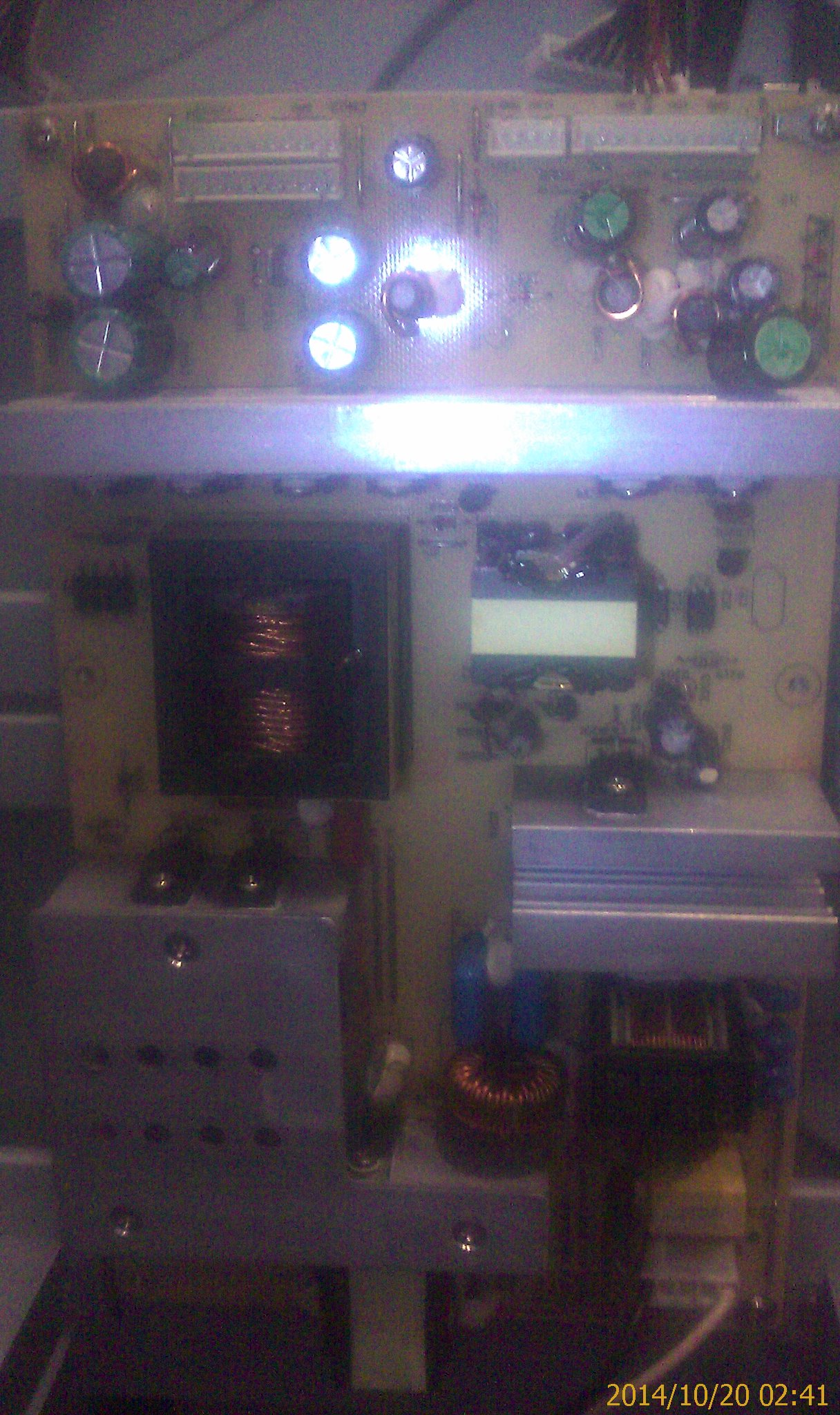

    here are some pics ..
    i figured it was a ps issue since it had 3 bad caps....but that didnt change when i replaced them...so not sure now...cant believe it would be a main board issue in addition to the ps issue with the bad caps i replaced....but im hoping someone can assist me here

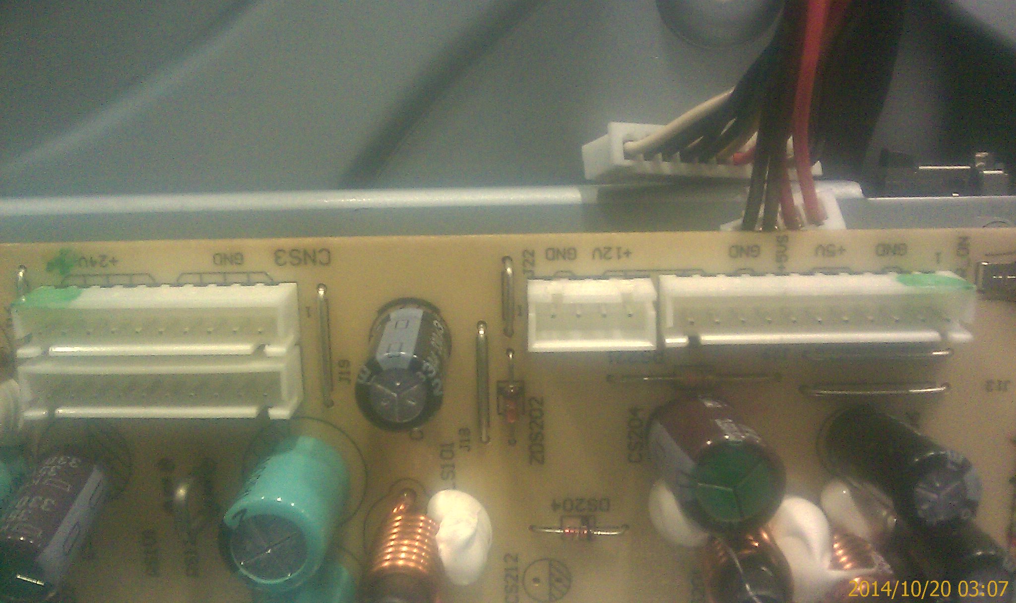

      not sure why pics are so blurry will try again

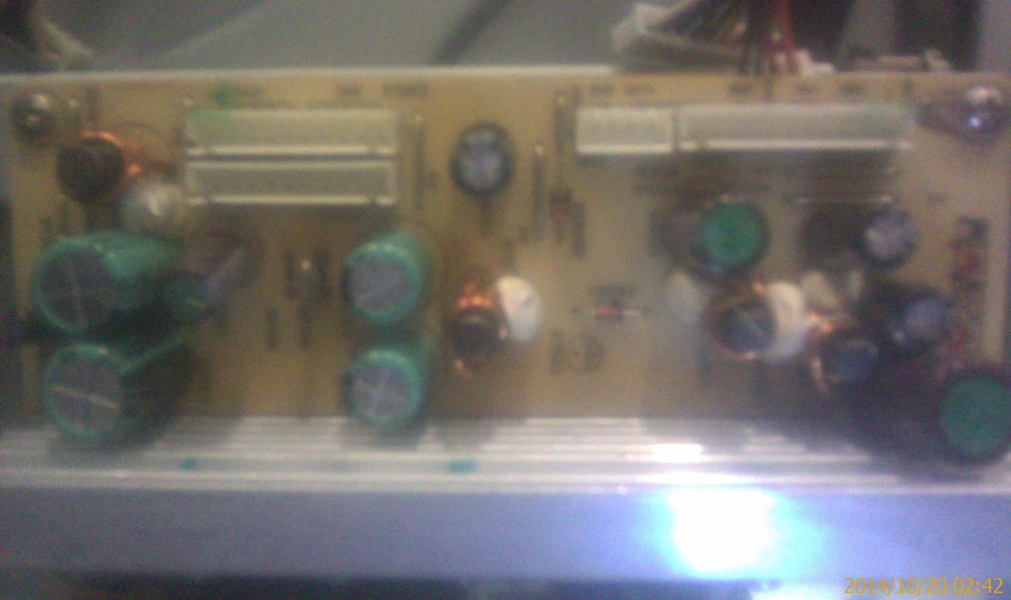

        hope this is better

          i get 5v at the 5VS pin only..i do not get 5v at the other 5v pins

            well i thought esr meters check caps in circuit accurately..apparently i was wrong..they dont...even though the other caps looked good and tested good in circuit i removed them all and found out there were 2 more bad ones...located in center of board ..33uf....220uf...both are right next to each other...right next to Q201....i repl the 220 but have to order the 33.....maybe this will fix the ps issue......maybe these are startup caps?.....im hoping they are imporyant and will fix tv....
              Re: sceptre x420bv-f120 lcd tv wont power on
              What do you get at the power on pin?
              BTW, we need better pictures.
